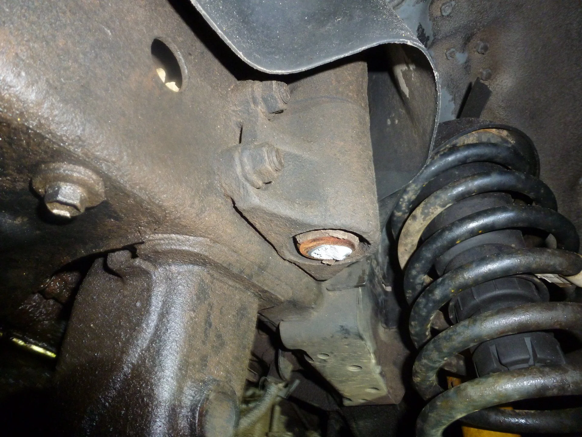

Looks like I'm in the market for this upgrade. Wife was pulling out of a parking spot night before last and 'heard a pop' and lost steering control.
Curious to know if this component was ever in a recall or service bulletin? We're pretty lucky this didn't happen at highway speeds on a corner.
No bulletins or campaigns. In fact the "upgrade" is unoffical. A sanctioned repair would use original parts.
The rust pattern indicates it has been working at it for some time.
Good to know, just a 'coincident' that they designed a beefier part that's backwards compatible.
Yes, the rust indicates it's been cracked a while. Not sure why/how it cracked in the first place.
