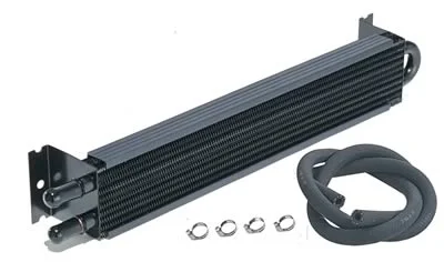

I thought of something like this, but I don't think it will cool as well, and they're about twice the cost.

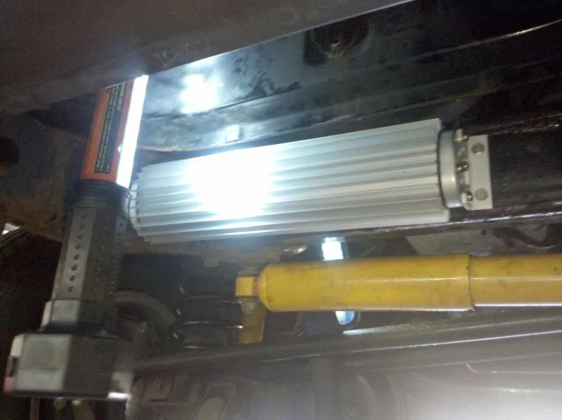

I use a Setrab ProLine Oil Cooler mounted above the winch. The location maximizes the cooling and I've had no issues in over 10 years since installed. Yes, I’ve used the winch since installing the cooler without issue, but I haven’t had to rescue a Jeep in some time. I also have a synthetic winch line.

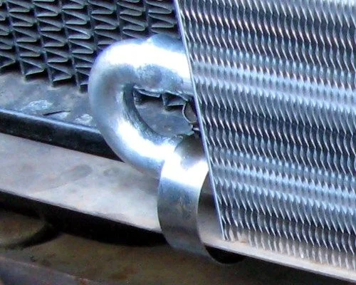

I used a 4' piece of mild steel brake line, bent into a loop about 1' long by 4" wide. This piece is attached to the driver's side inner fender just behind the radiator. I sawed off the brake line ferrules, and left the flares on the line itself to better grip the 1/4" fuel line used as a return line. I'm running 33x9.5s with minitruck PS, so I don't need much cooling.

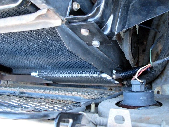

Got what they had at the Kragen's. $30ish. This is the 401 model. Sawtooth has a 402 model which I would've got if they had it, but I waned it done. I'm pretty happy that it clears the front screen and the radiator so I can pull the bib or the radiator without dicking around with the PS cooler.
I didn't even have to cut the existing return line and I had another short piece of the plastic tubing wrap that was just the right length. It came out great for a short little project.
I sprayed a squirt of black at the shiny tube at the top so it was less noticible. The black spot on the screen is hardly noticeable other than with the flash.

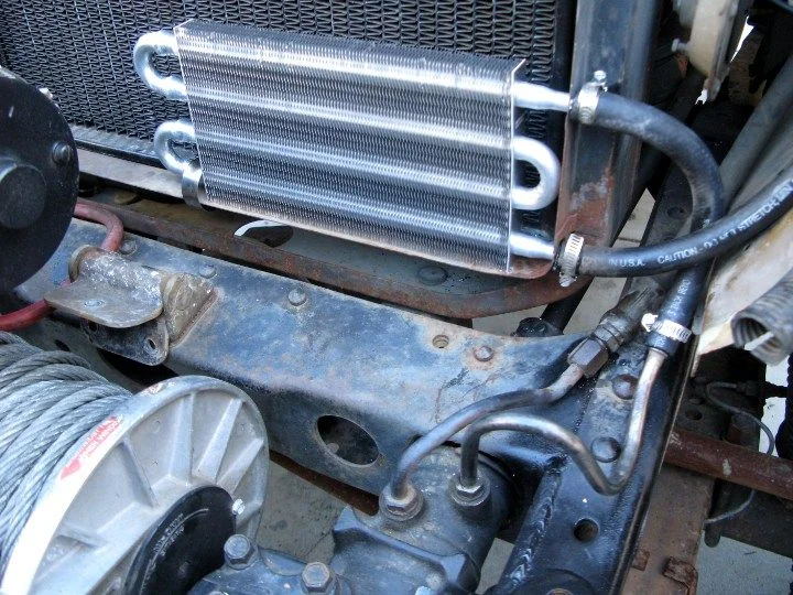

I used a Derale Power Steering Cooler - D12200. I purchased one through Etrailer.com for $26.95. So far, the temps seem great. Waiting for summer and warmer temps. I also attached the cooler to the screen in front of the radiator instead of the radiator itself.
Specs:
  • Inlets: 11/32" hose barb
  • Overall dimensions: 12-1/4" wide x 2-1/2" tall x 3/4" deep
  • Core length: 8-3/4"
  • Distance between inlets: 1-1/4"
  • 1-Year warranty
