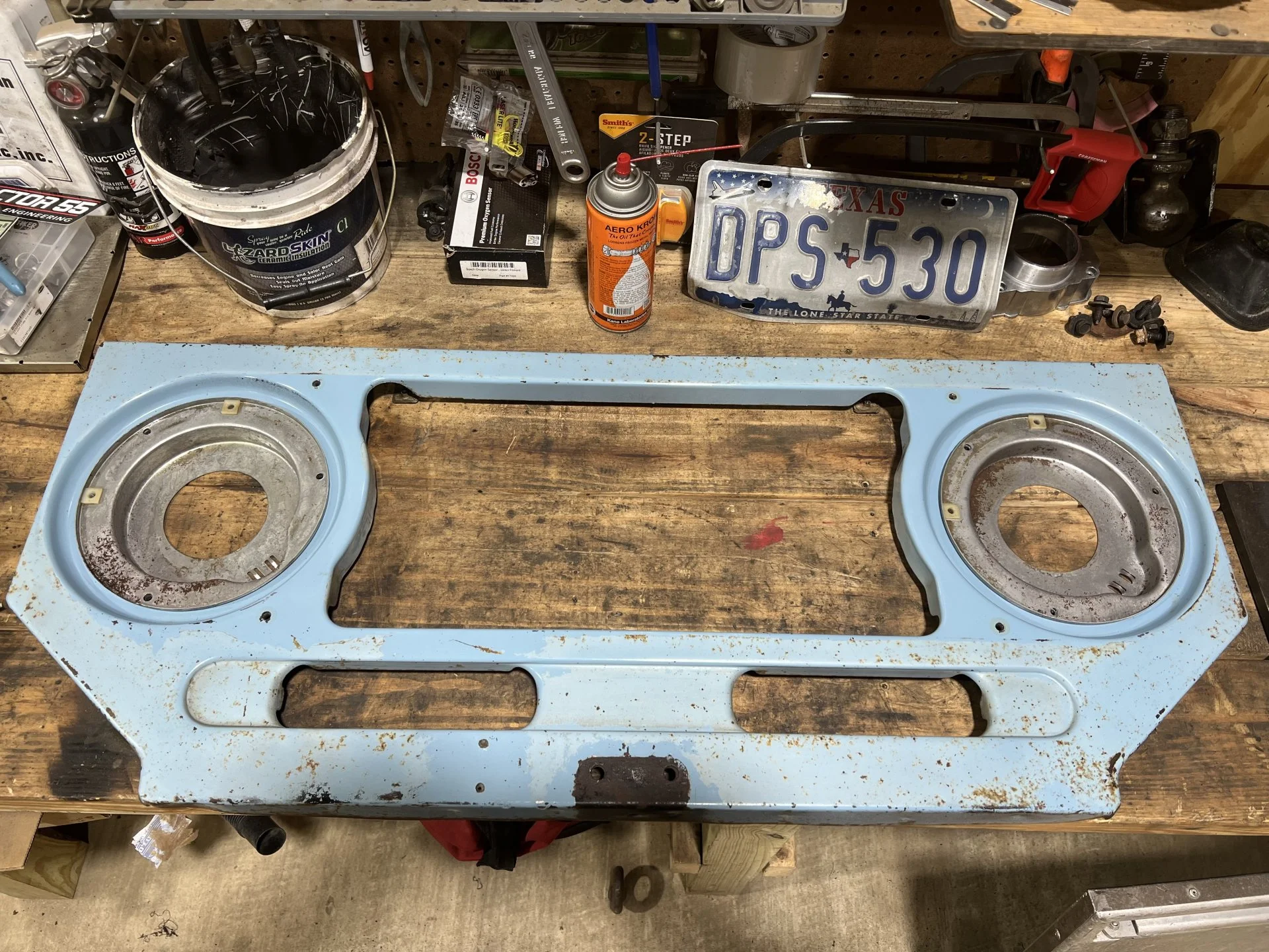

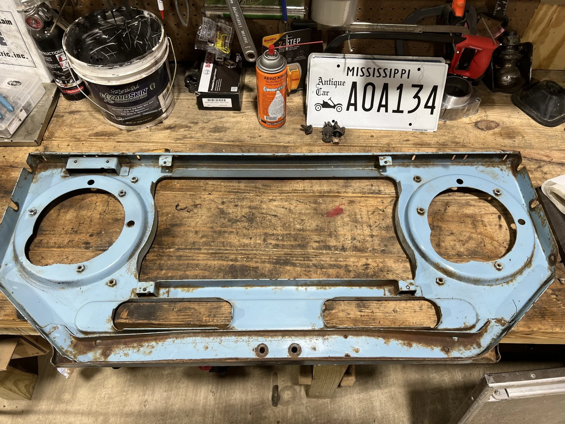

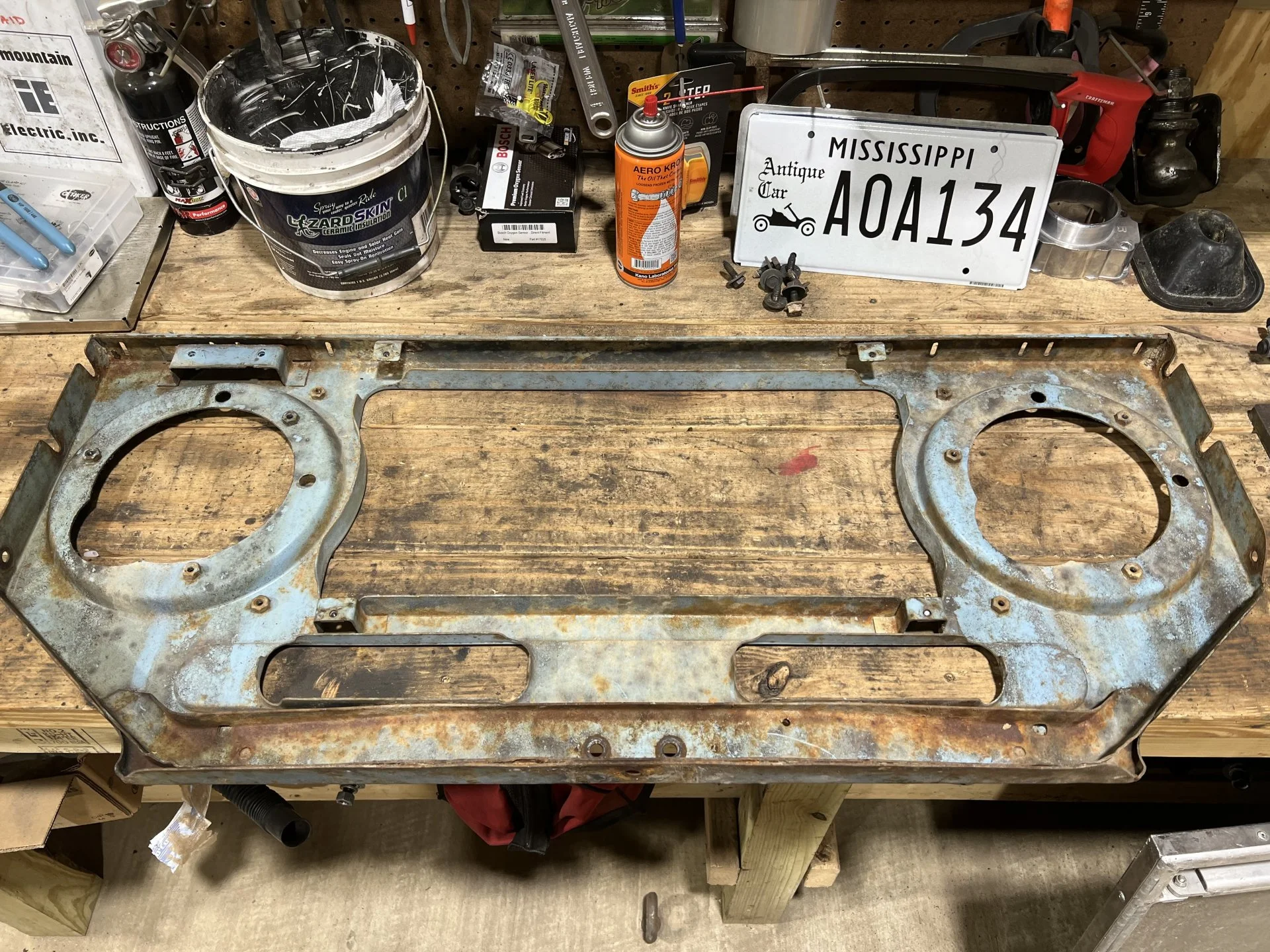

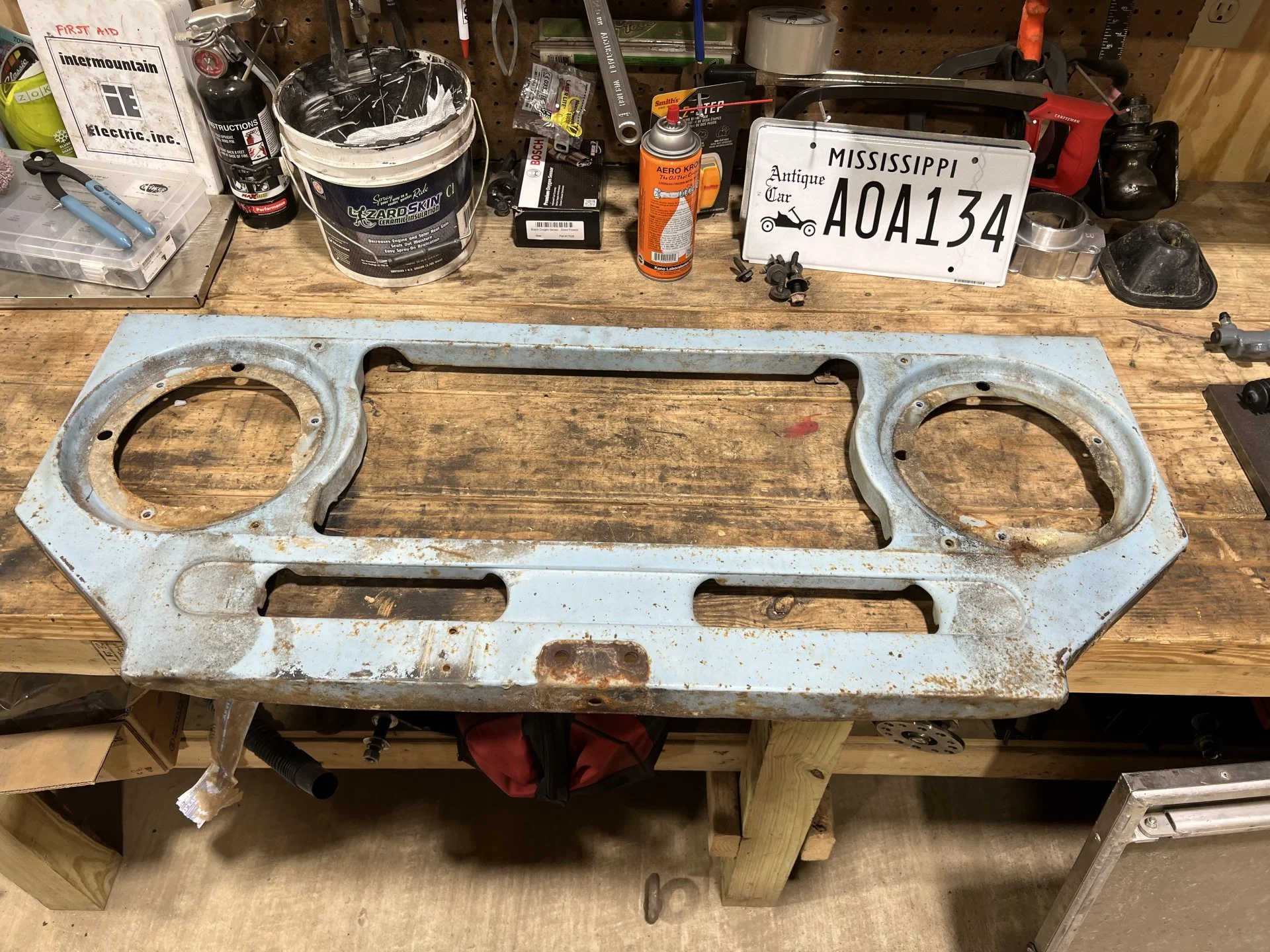

Moved to the grill. This thing was gross.
Before
After ….. treated the rust with some Fluid Film
You can really see the clear and how it faded dull. This is why I 100% vote no on clear coat over patina like all the keyboard cowboys suggest.
After ….. got it smooth though like the rest of the body
Added the proper Koito H4 and a CCOT bezel with spacers. The mesh is at powder so no full shot yet

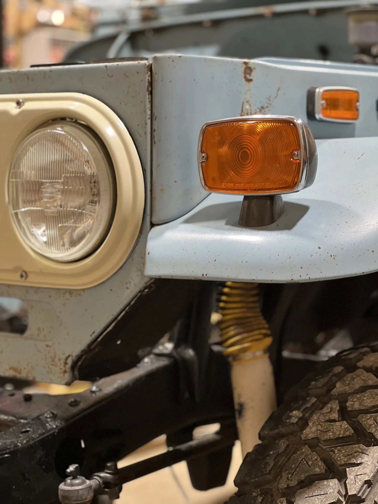

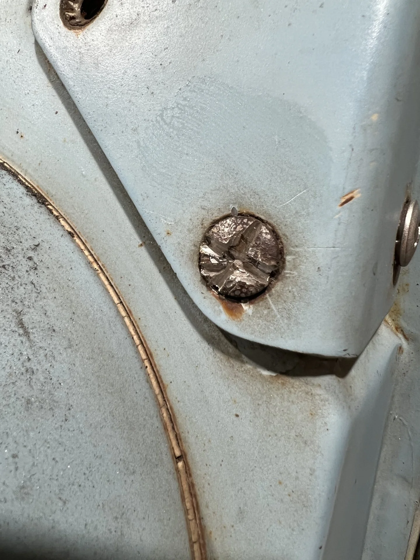

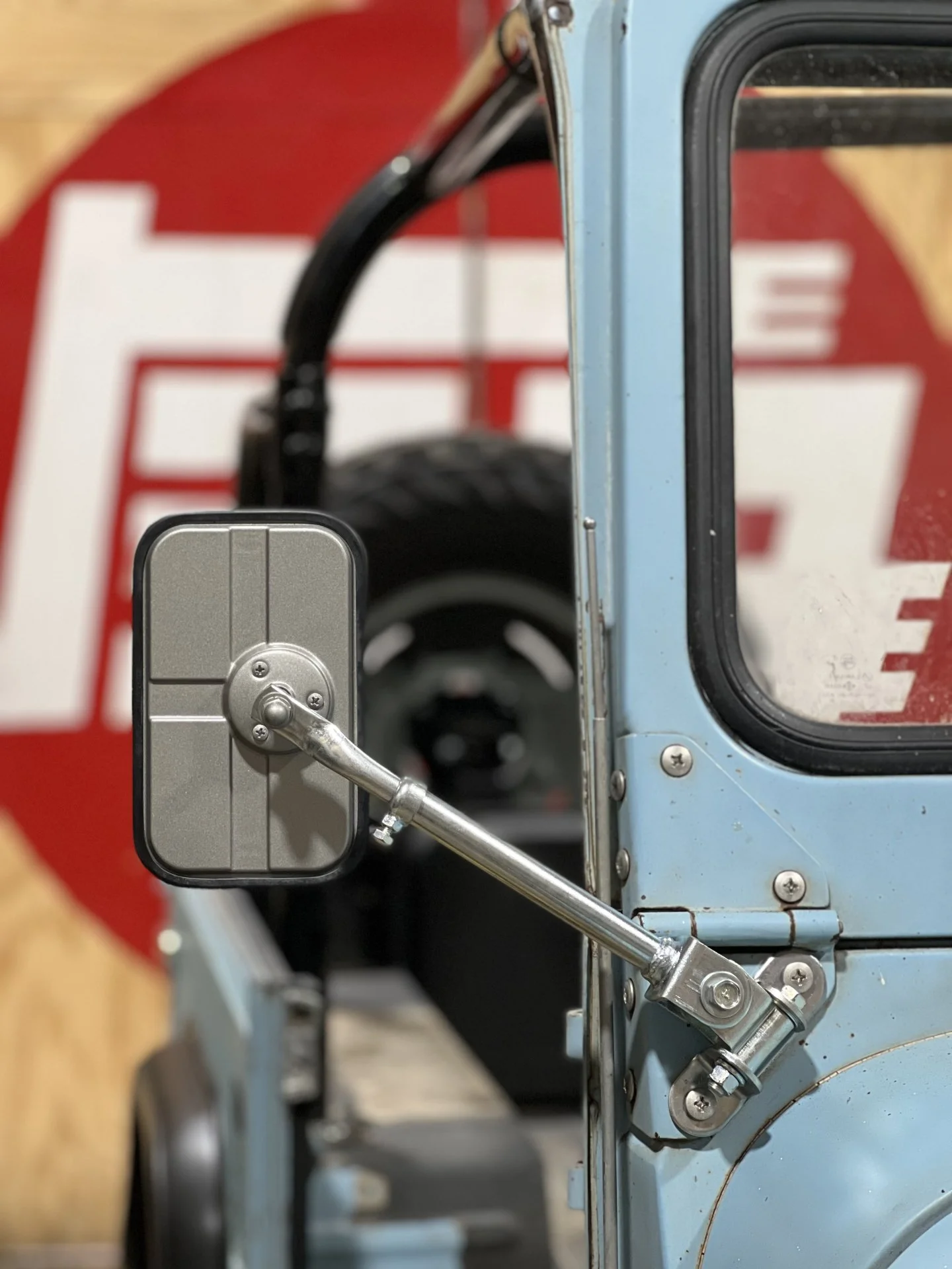

I got some Overland Metric hinge screws and installed some proper mirrors and arms.
This is the tool for the job. It’s a screwdriver for an air hammer.
Problem is if it’s a real tough screw it might shatter the bit. Luckily it only happened once and it broke free first. This was my fix
They look so good though
BeforeView attachment 2829043

Looks amazing as usual. Where did you get the mirrors? OEM? I’m having a hell of a time finding a driver side OEM mirror arm for my 77 under $300 😳

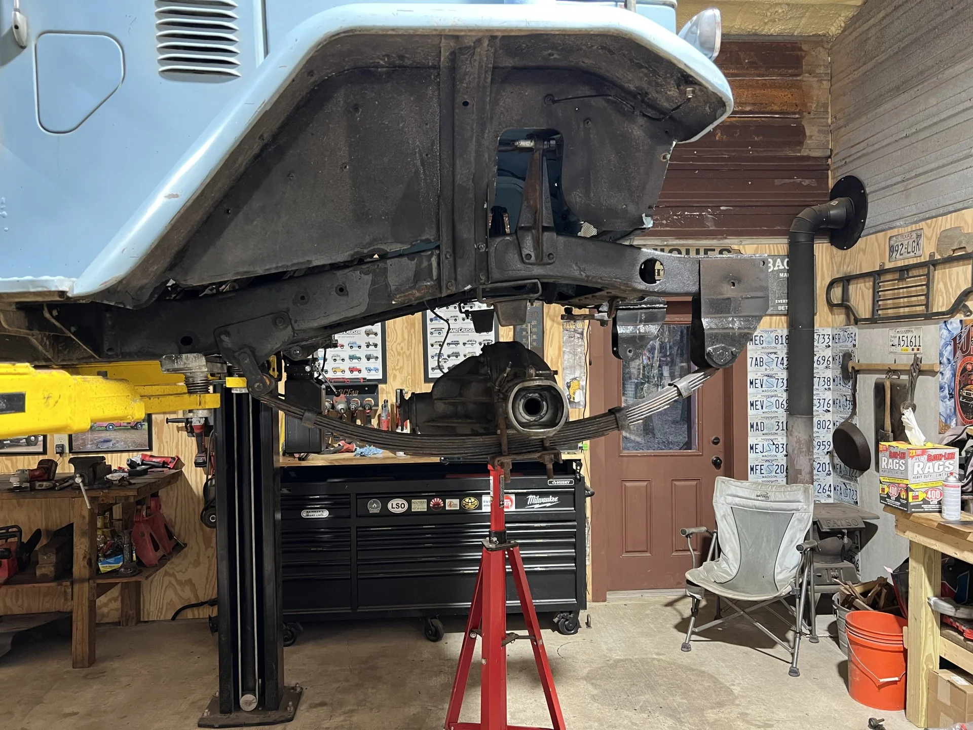

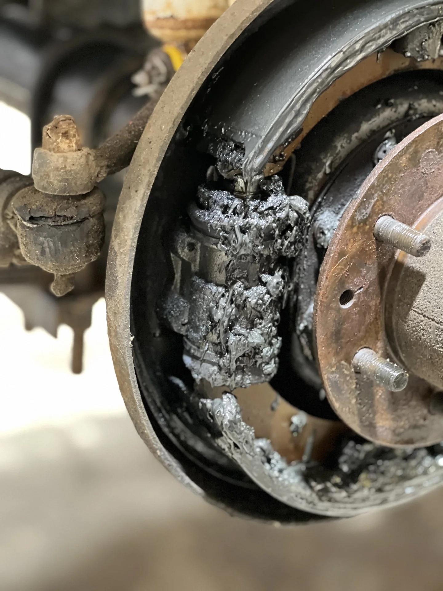

More tear in. This side was not leaking so he had one brake at least

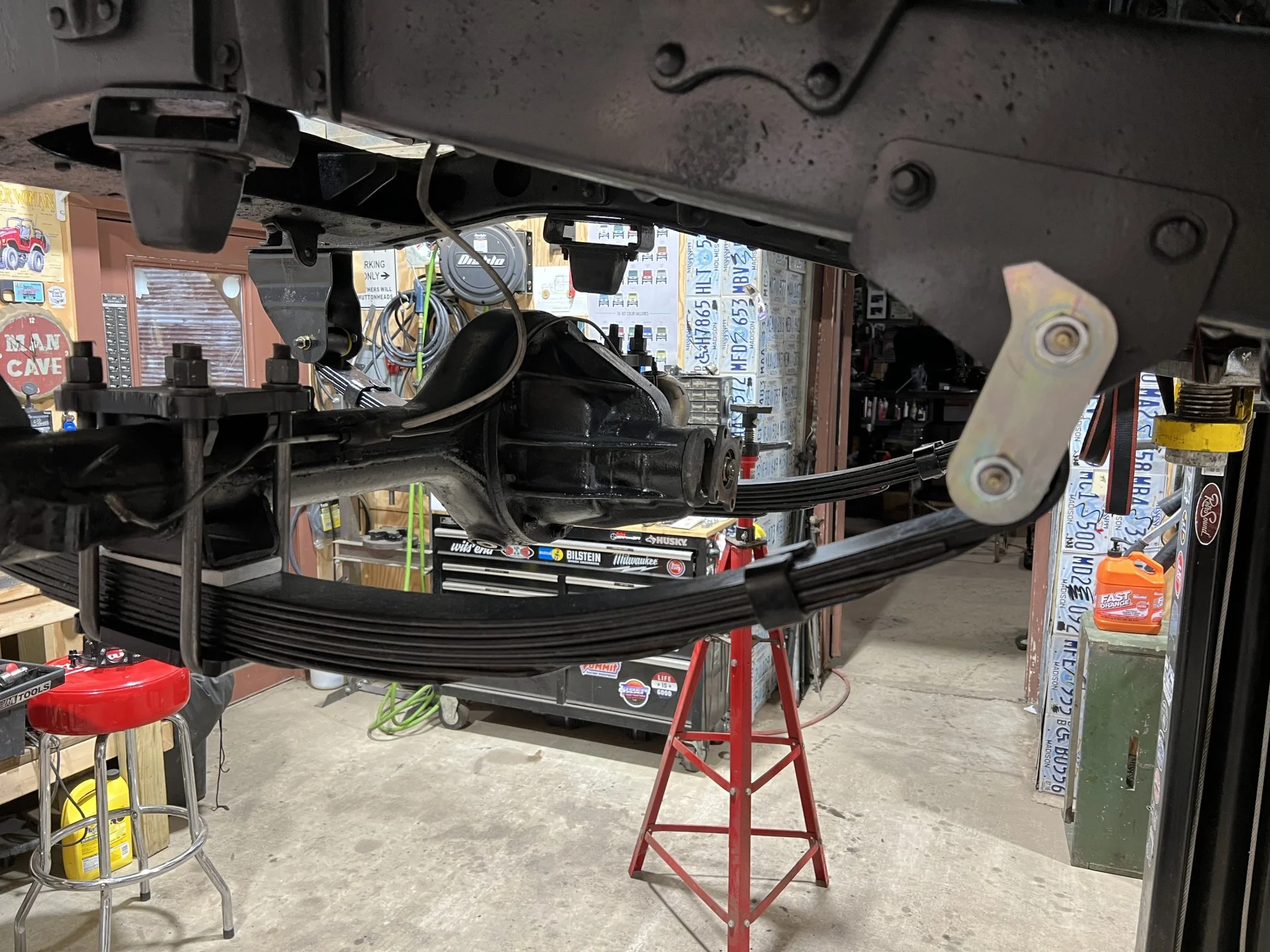

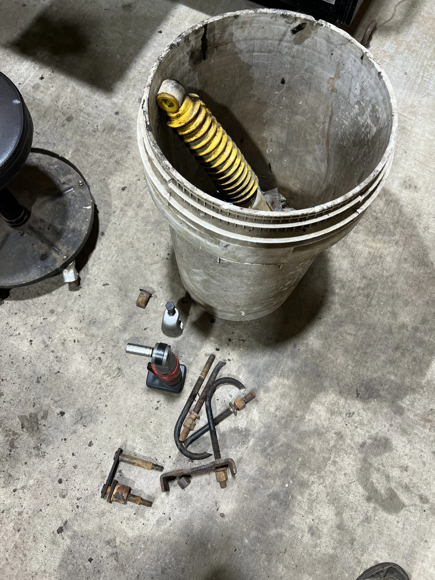

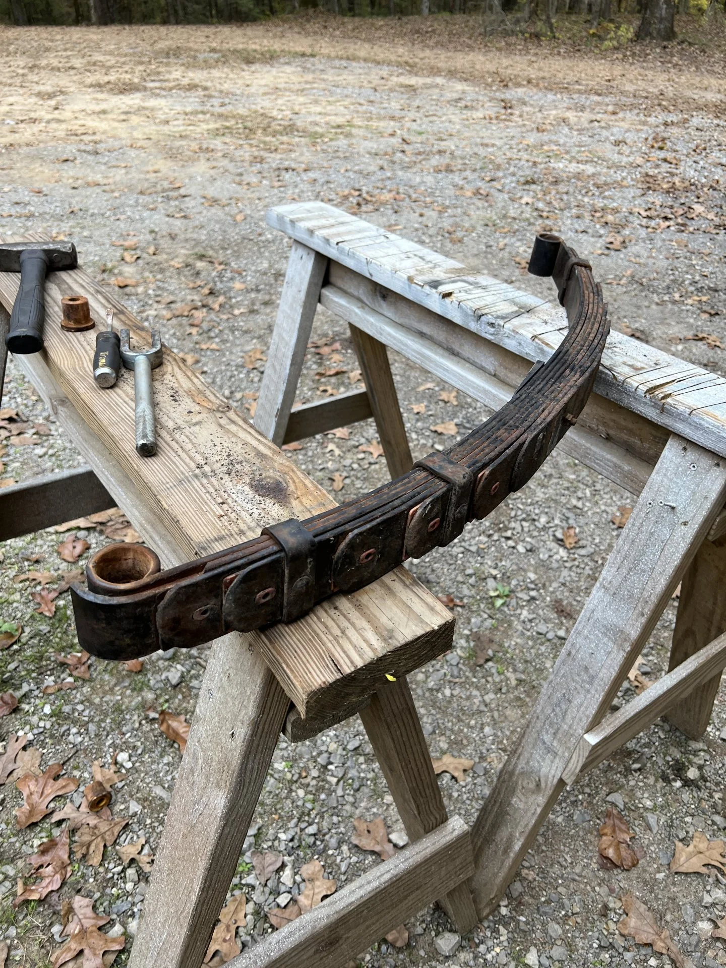

Springs are some OME combo with the shackle reversal. They are in good shape so they are being reused but all the end pieces are getting replaced and the 1984 Heckethorn shocks are goners

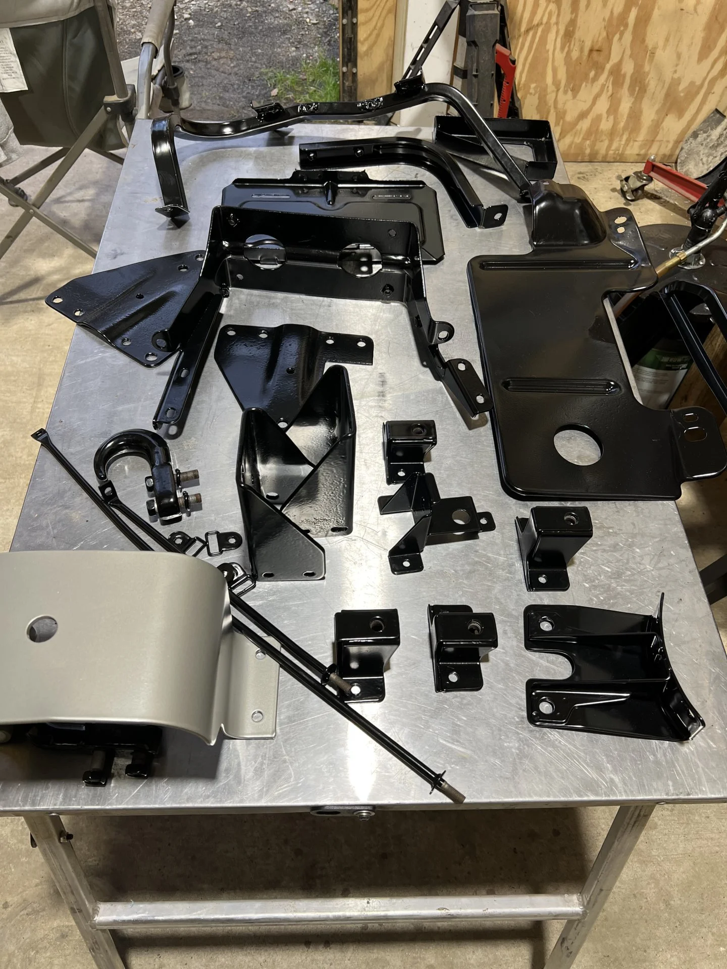

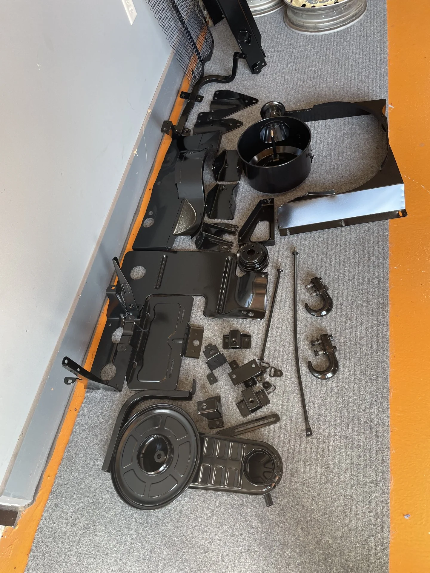

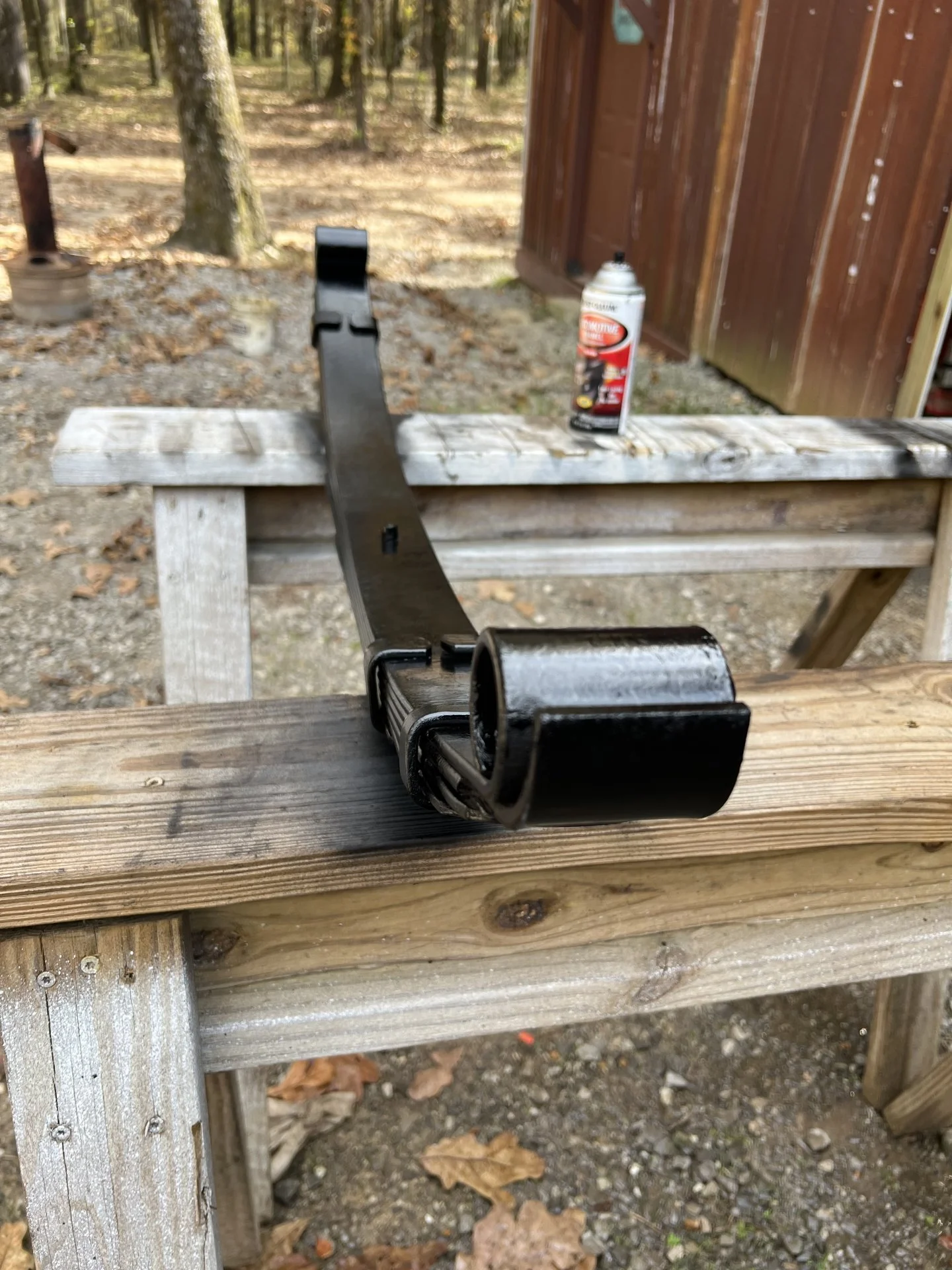

I got one pack fully cleaned and painted.
Nothing real fun going on here but gotta document

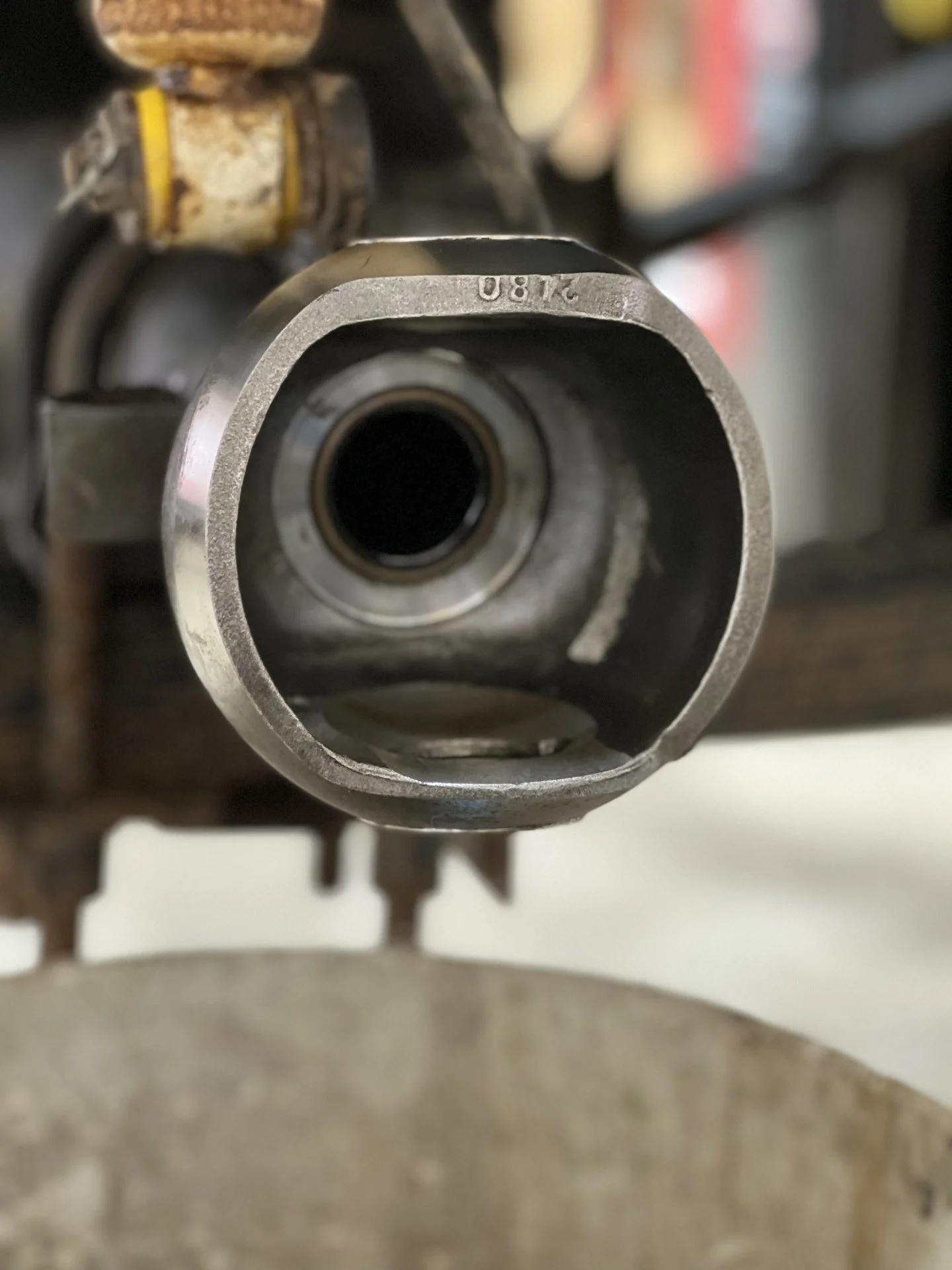

After soaking overnight I blasted this stuff and now it’s getting painted

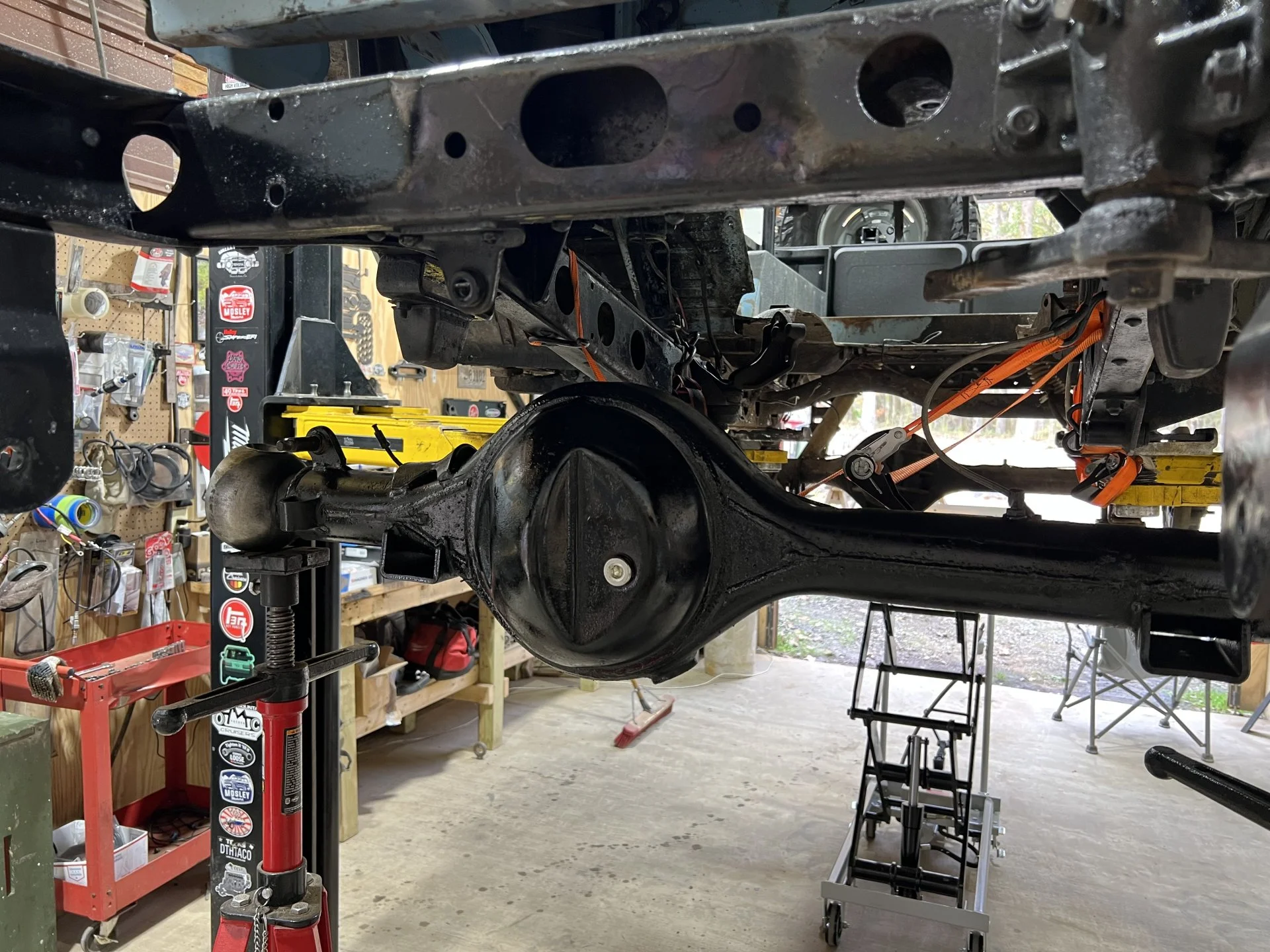

The other spring is out and the front housing has also been cleaned up and painted. Waiting on UPS for my bushings today and I’ll button the front back up
Got the center arm pulled off and everything for the front axle is painted and stuff is drying tonight. I’ll have a front end tomorrow hopefully.
