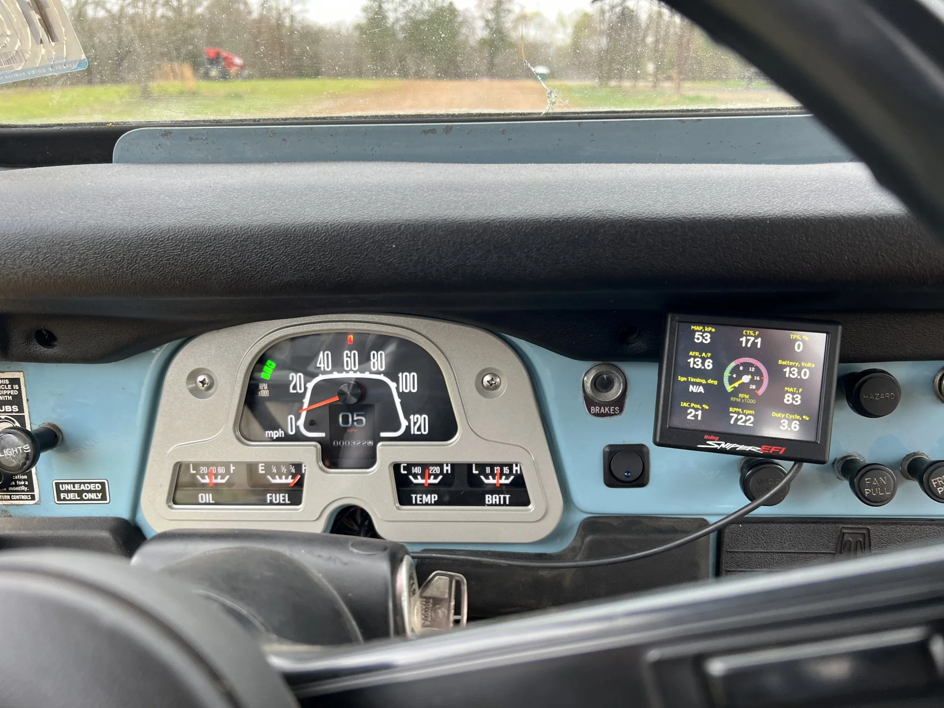

I mainly did it because I was tired of dealing with leaks, cables, etc. The GPS is so easy, plug and play. And on the first one I went ahead and did the GPS with gage install.
I tried and tried the tcase pulse thing. It started reading once backing out of the drive then quit when I was calibrating the handheld GPS. That was my third or fourth try. I gave up and ordered gps unit. Still finalizing wiring but I agree, go gps to save the headache. Not sure how to cap the speedo gear yet. If you find a screw on cap please share.
To close the loop on this.
Dakota said turn the cable by hand with the key forward. If the needle moves it’s Tcase to Cable interface.
I made sure my speedo gear was not obstructed and it was indeed turning.
Second suggestion was to see if the brass tang they provide to interface was getting a good seat into the square cable.
It was not. One side was not very square.
I crimped the sides tight on to the cable and boom. Fixed.
Now to get the rain gone to calibrate it and be done with this truck for now.
Owner loves it. Super happy.
