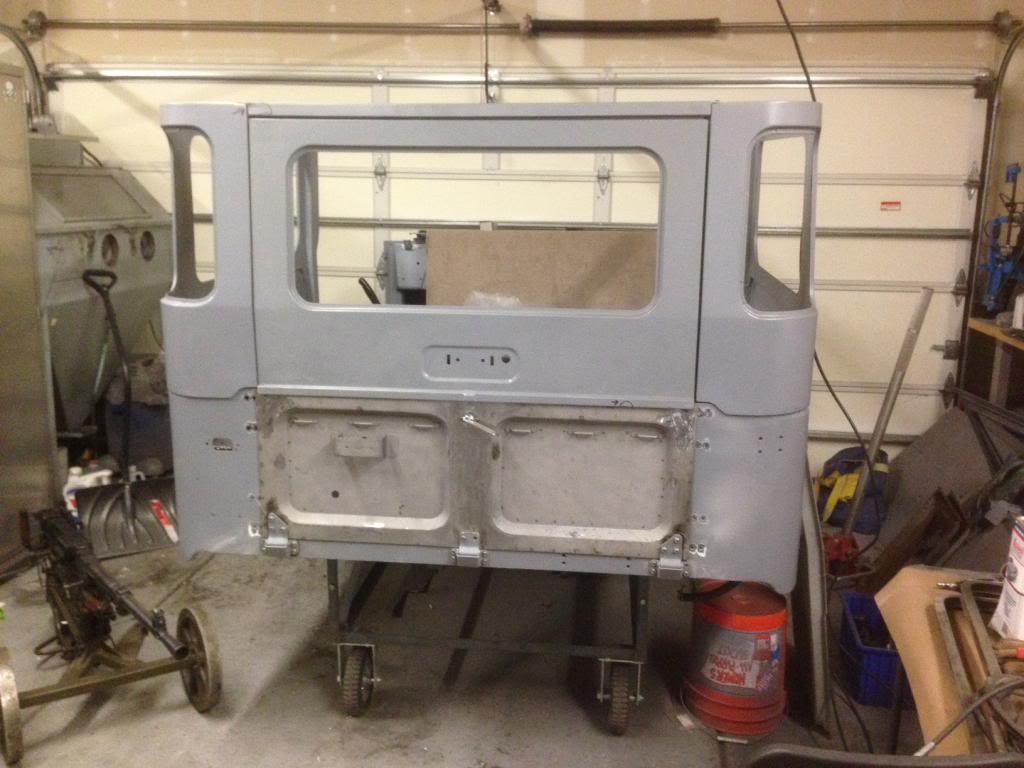

I worked on the strikers tonight.
Since there's going to need to be some adjustment once the weatherstripping is added, I needed to add some adjustment range to the positioning of the strikers. I accomplished this by taking some bits of flat stock and threading it for the M6 striker bolts to make floating striker mounting plates, similar to what the factory used.
The real trick was getting to the area where these striker plates needed to be positioned. I had to open up the boxed section in order to make a hole in the bottom to get the plate in position:

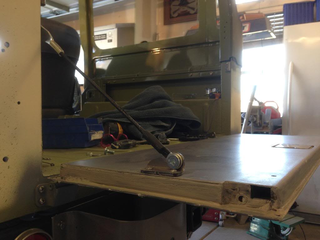

On a related note. Does anyone have any input as to what position the handle looks best? I can mount it horizontal or vertical.
Here's a short video of all the exciting tailgate action!

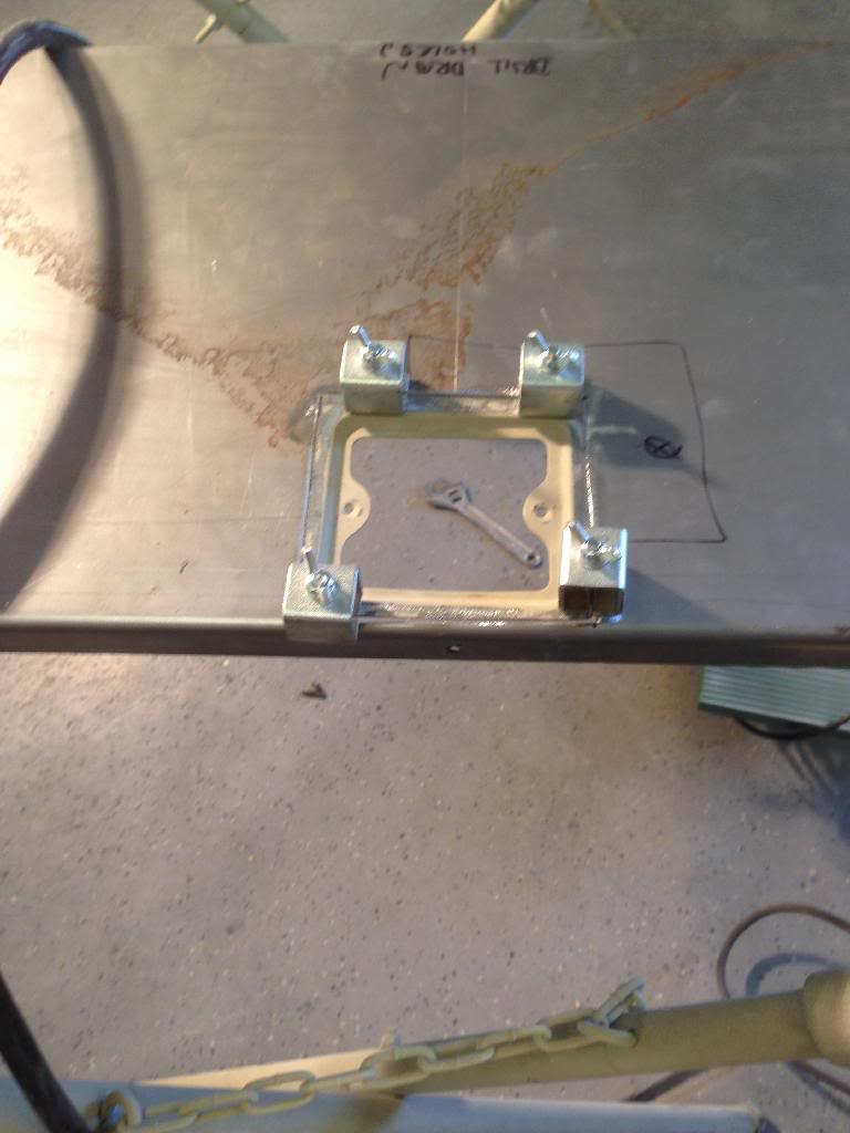

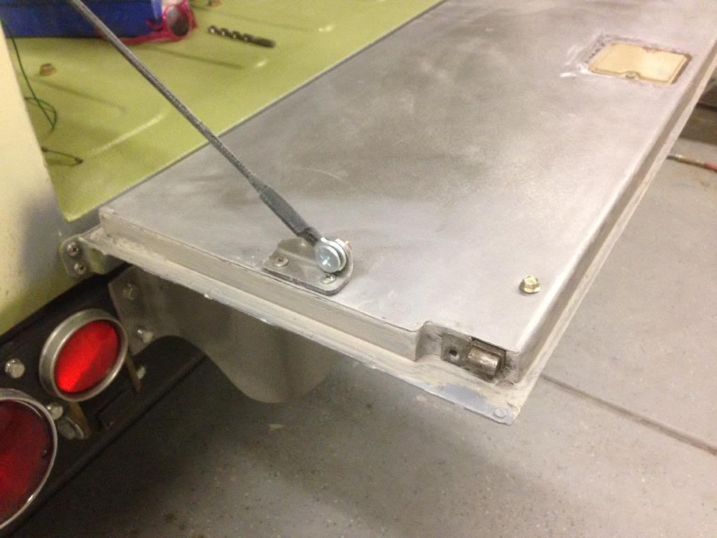

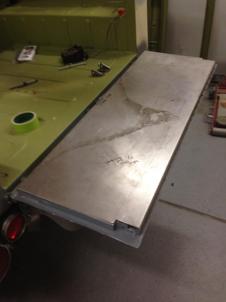

I cam very close to finishing up the tailgate project today. I had a local fab shop bend me an 18ga sheet to form the rear cover as I didn't have access to a brake large enough to accommodate this thing.

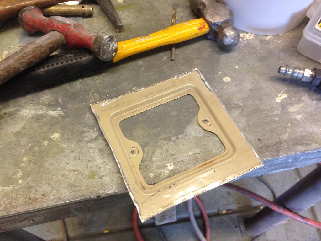

I needed to come up with some sort of access panel to get at the latch mechanism so after some thinking, my best 'cruiser buddy donated a FJ60 rear hatch to the cause and I salvaged the small panel off of it.

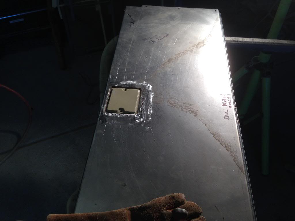

After some some grinding, hammering and welding I got it installed to my satisfaction.
Then I was able to finally weld the back onto the box frame. I drilled three holes in the bottom to serve as drains, should any water ever get in there, then seam sealed the whole thing with some 3M seam sealer.

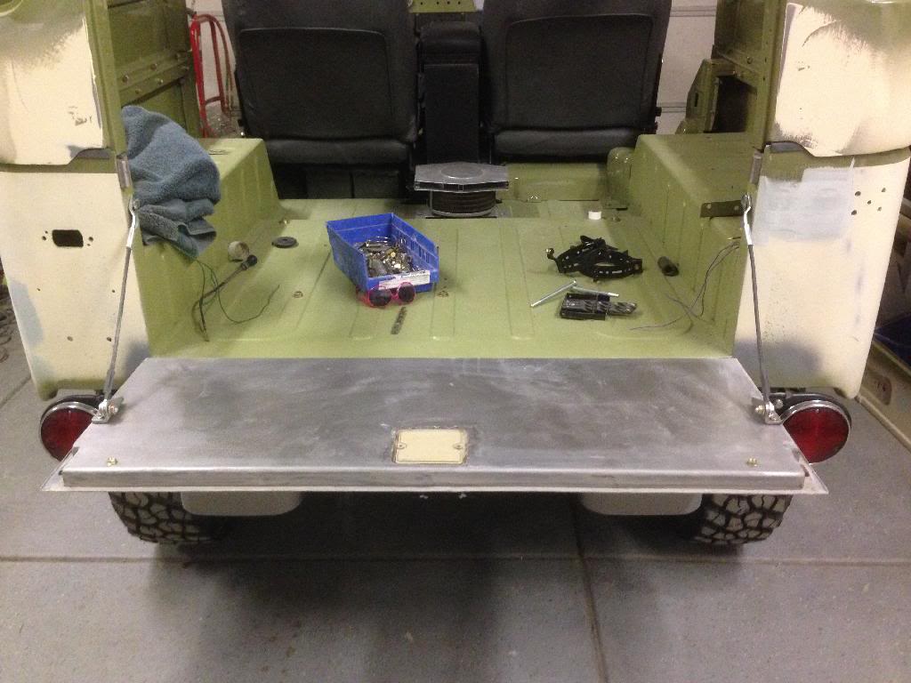

I picked up a pair of FST style tailgate brackets off eBay and found a pair of GM tailgate straps that worked out well. Some measuring, drilling, a couple riv-nuts later and, zang-a-rang, I've got a working tailgate!
Right now, it's drying after being shot with two good coats of DTM primer and tomorrow I will start sanding for paint/rock-it liner prep.
