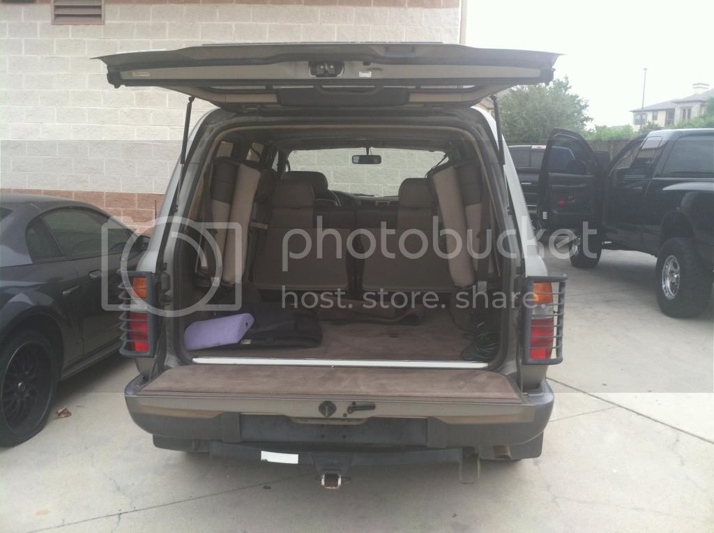

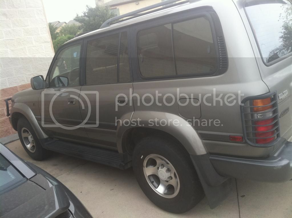

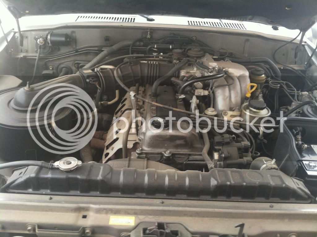

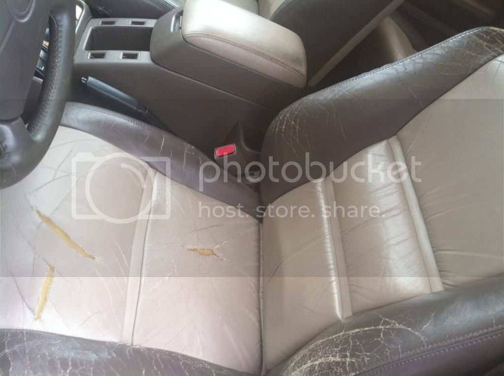

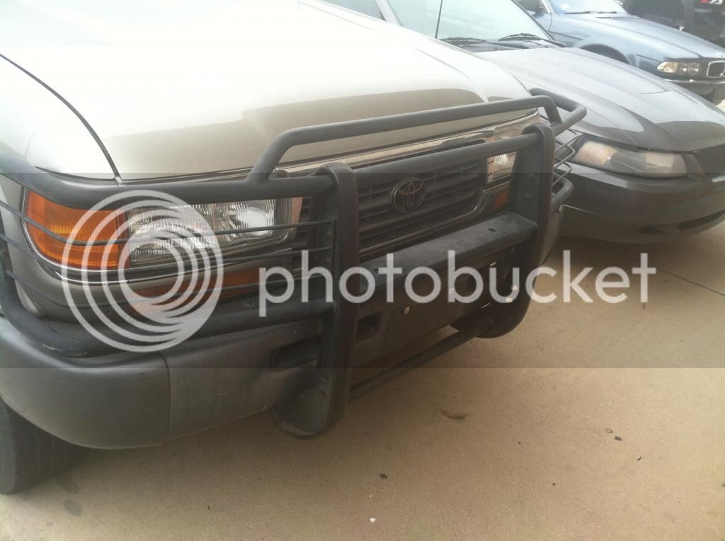

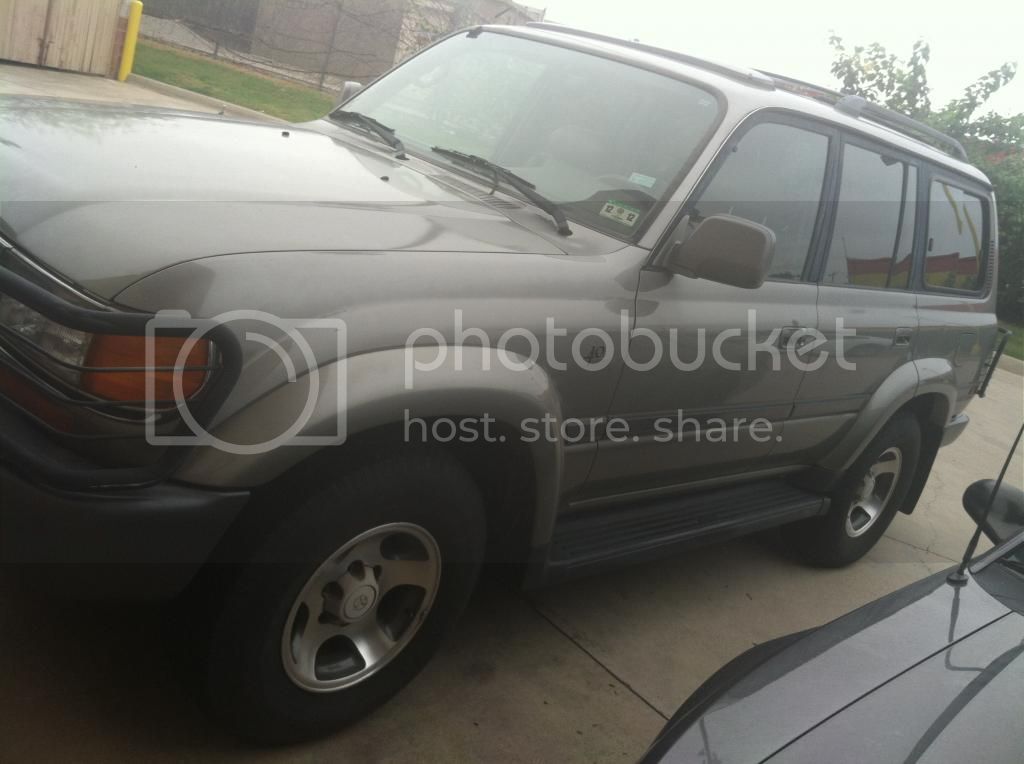

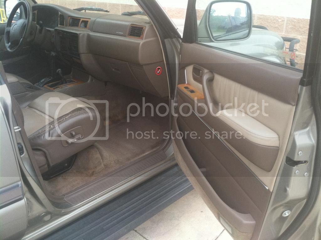

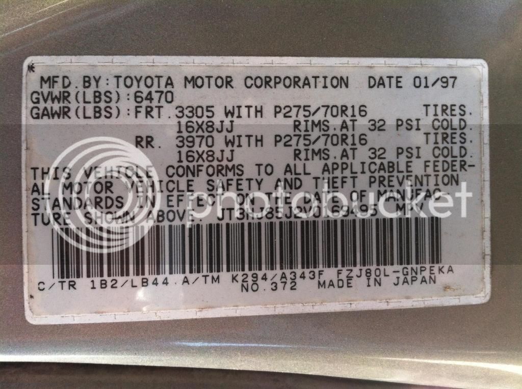

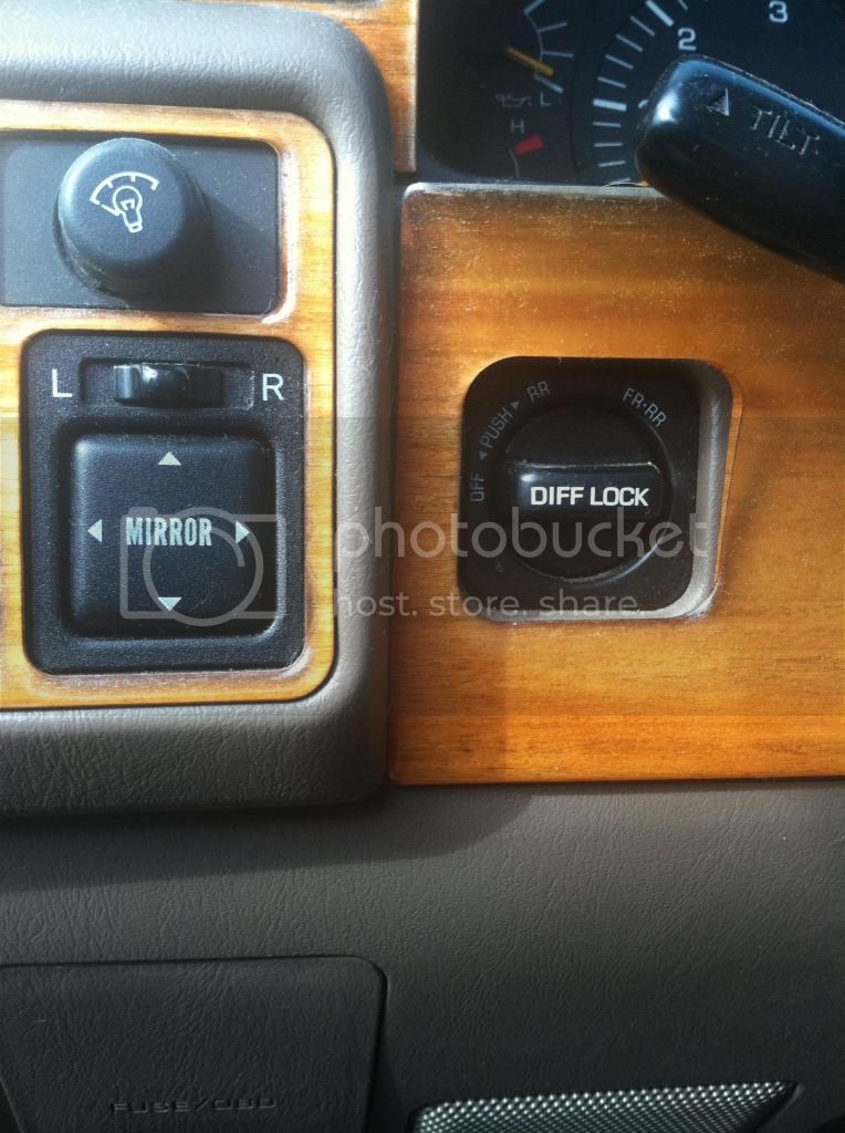

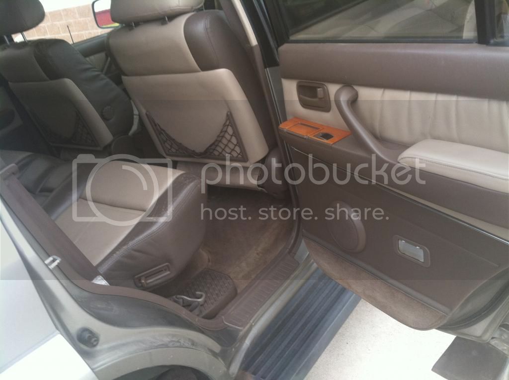

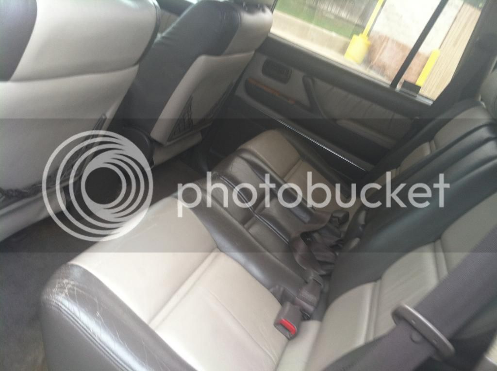

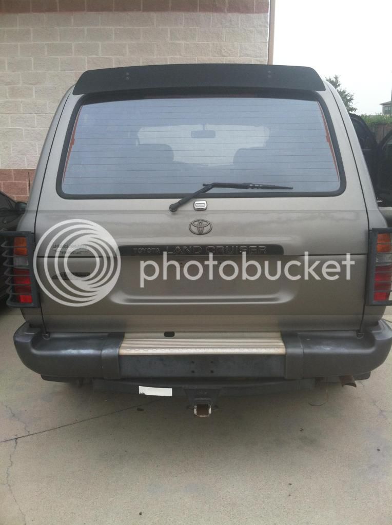

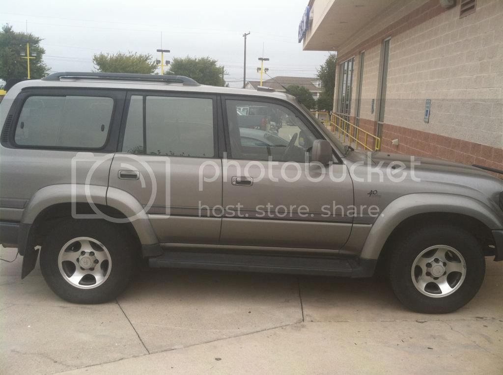

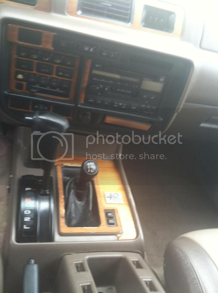

Is 5500 too much for a 210k 97 locked fzj special edition. Mechanically sound cel light is on from bad catalytic converter driver seat has cracks and slight rips. Slight stains in carpet. Front brush guard is bent slightly. It's a one owner with maintenance records for everything clean carfax
No that is a very good price. The carpet can be pulled and cleaned. The brush guard needs to come off anyways. Check the coolant overflow for bubbles when he revs it to 2500-3000rpms. Check the front knuckles as well for any leaks.
OK trying to get it around 5k it's a 4hr drive the guy says it's easily reliable and in good enough condition to make the drive back to Houston. Might head out there and pick it up
Wasnt able to take off work. If the guy still has it this weekend Ill make the 8 hour round trip and snag it up.
210k miles
