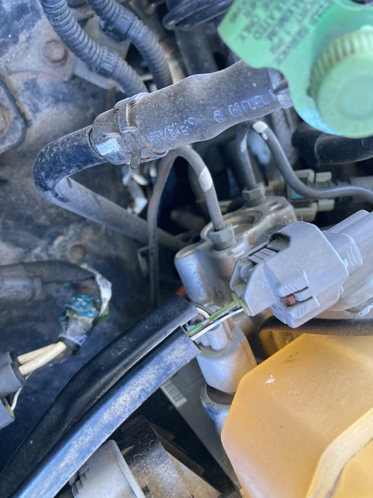

Seeing the brake light on, finding low fluid, and adding properly. Next day, observe leak on inside of left front wheel. Looks like a leaking caliper.
5 weeks go by, needs more fluid before family takes it on road trip. I didn't fix the caliper.
Family makes it about 10 miles down the road and then the lights and alarms. They turn around and make it about 3 miles before total loss of brakes. They coast to a stop safely, and now it's in my driveway as I save money for the parts, and try to learn to diagnose myself.

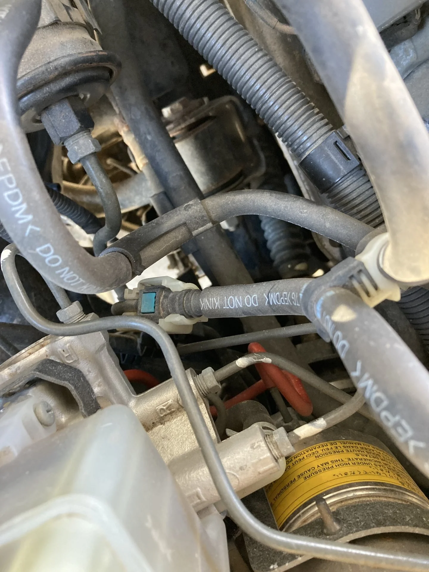

Would be good idea to post up clear picture of brake master reservoir, each caliper including hoses and lines, and leak you have found.

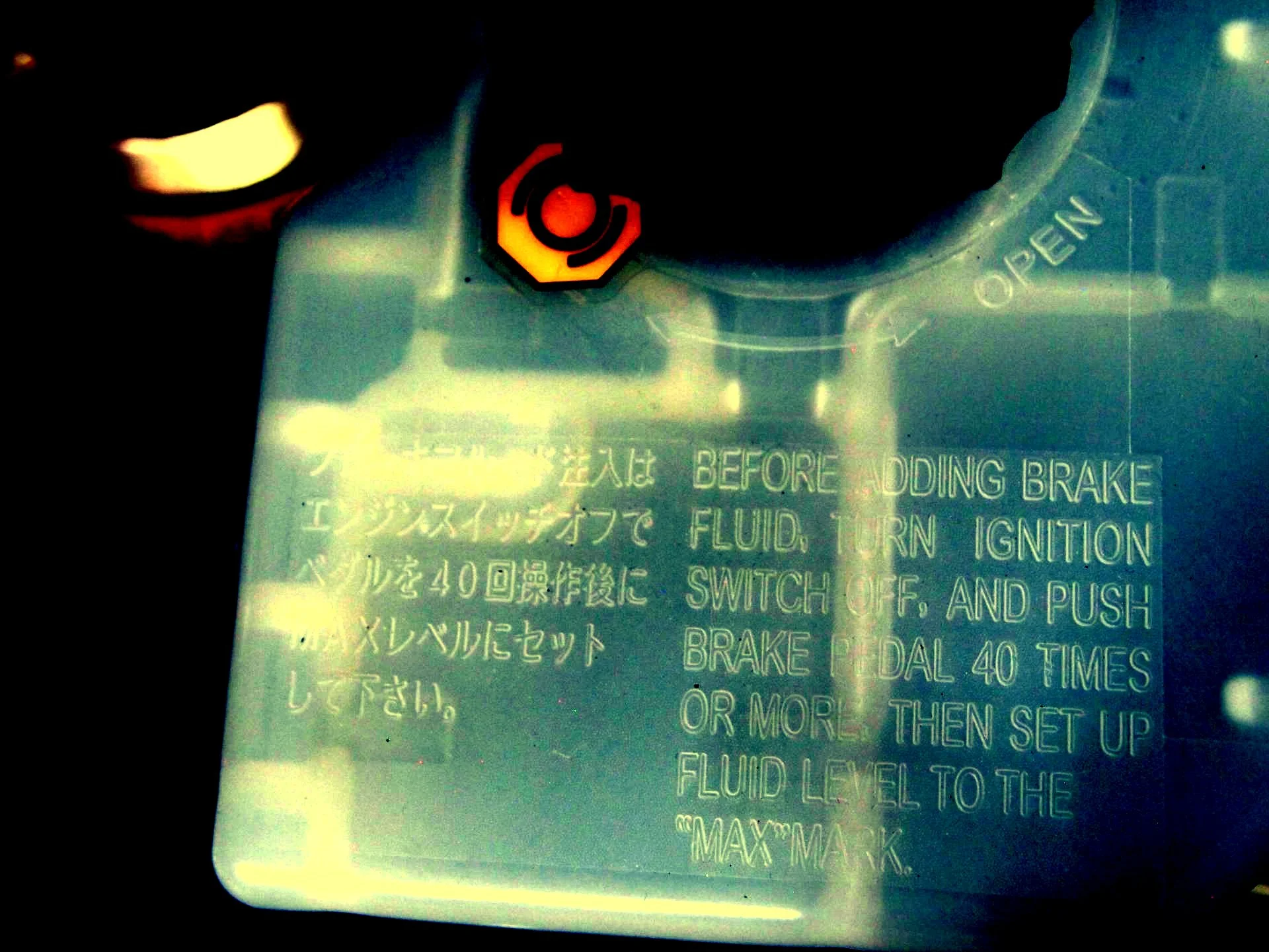

Did you read top of reservoir before topping. NO, You're not alone. Even shops don't.

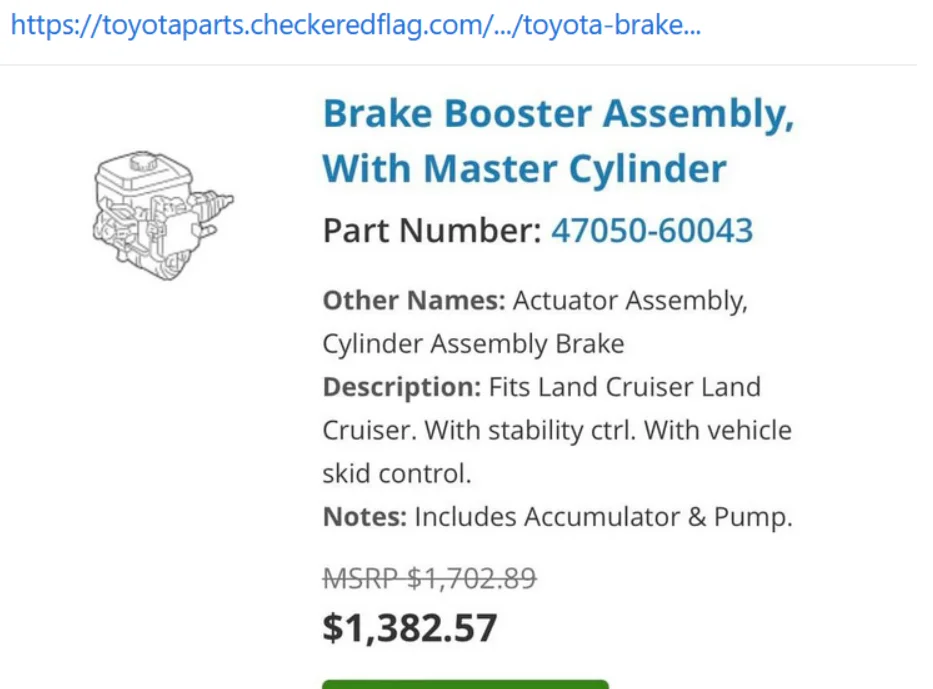

All that being said, the brake contraptions for the 2003-2007 models have definitely come down in price. One example below (accumulator and pump don't appear on the illustration, but the description says they're included) This is headed in the right direction for regularly-scheduled maintenance items.....just not quite there yet

I do not see wrench marks on hard line flare nuts. So IMHO, it has not been replaced.

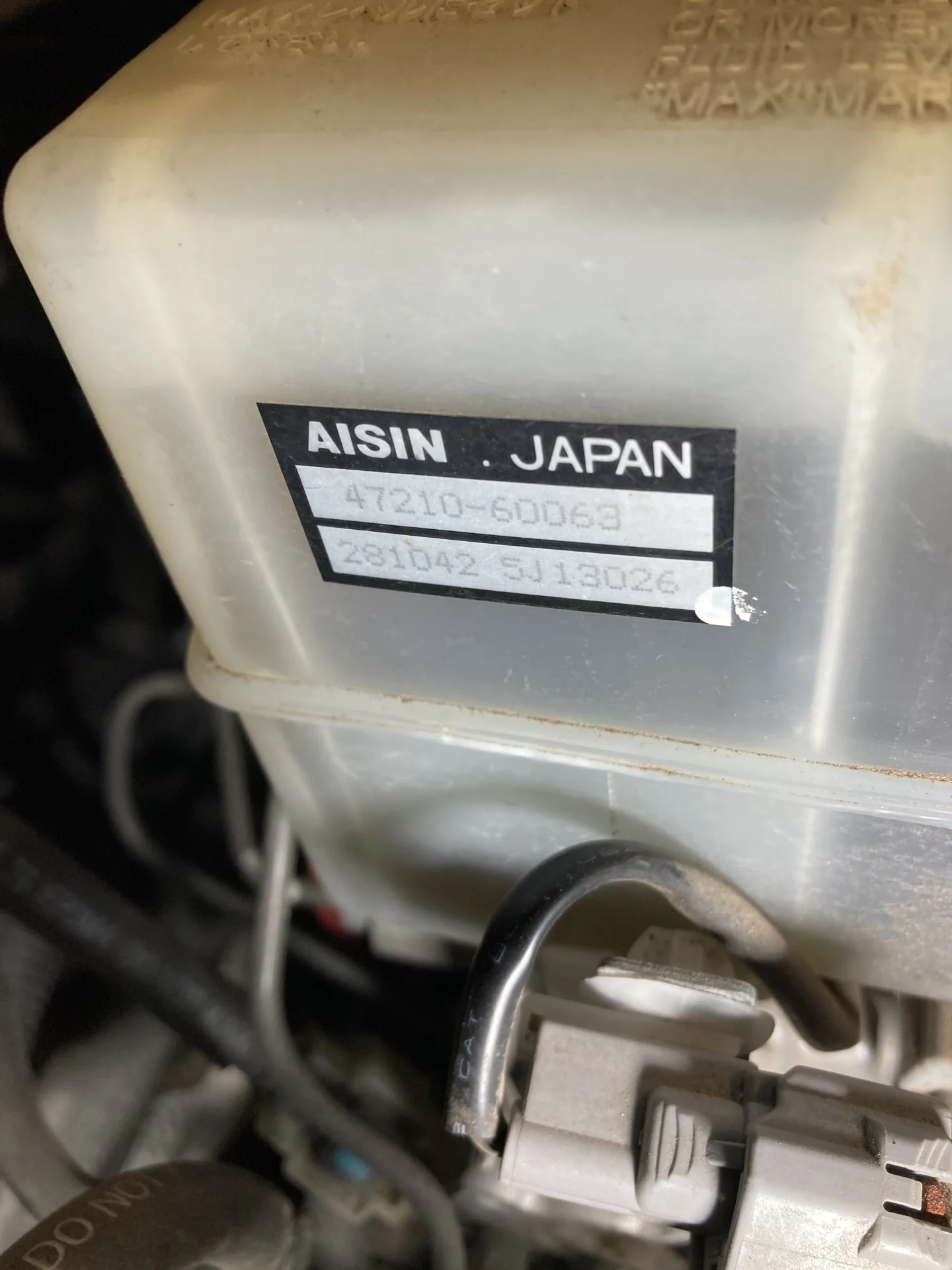

After reading many posts on this forum, especially from @2001LC, it seems like the only solution is to replace the whole brake master assembly (47210-60063) with a new one. Is this correct?

It's important to use your VIN # to detriment which parts to buy.
@txslg Likely the high pitched sound has been happening this whole time intermittently. Which is a pressure loss from a seal in the "brake master". Over time this pressure loss increases in duration, as seal(s) in the master become damaged more and more. The increase in duration causes pressure sensor to signal booster motor to run until pressure come up. Booster motor are not designed to run long duration. So likely both Master and booster motor are now damaged. Master can not be rebuilt, booster motor can be. When I google the PN# 47210-60063 you posted. I get used master w/ booster assy. Where I would in your case buy the whole assy w/booster. I would not by used or rebuilt. Especially not off ebay.
If your VIN # shows 47050-60043 which is a Brake Master w/booster assembly for USA models w/VSC 03-07 LC/LX. I'd buy it, and only from Toyota Dealership.
iH8mud is read globally. Toyota has many configuration of the 100 & 105 built and shipped globally. Using VIN # when ordering parts is a must.

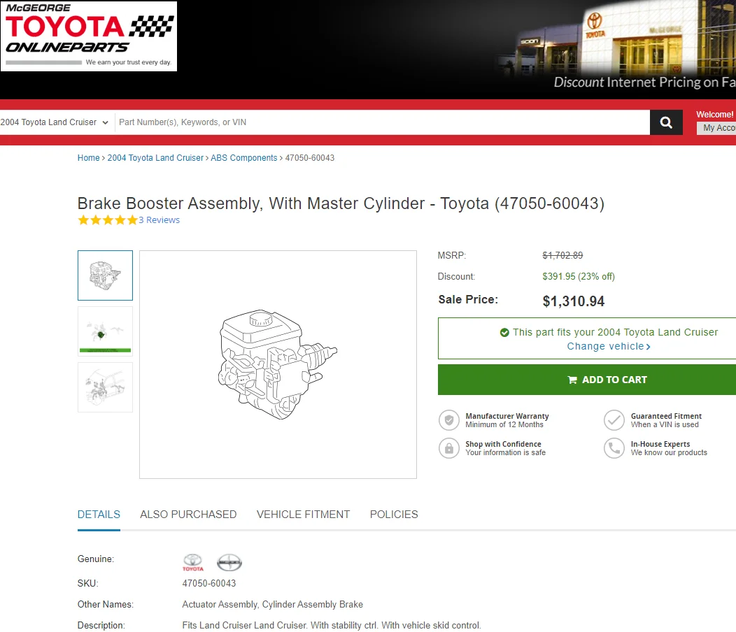

On McGeorge Toyota website, it shows part 47050-60043 fits my 2004 land cruiser.
Is this the one with the whole assemble with both Master Cylinder and Brake Actuator?
The price does drop a lot. When I first got this issue around 2019, I remember the online price for the whole assembly is around $2500, now it is $1300.
