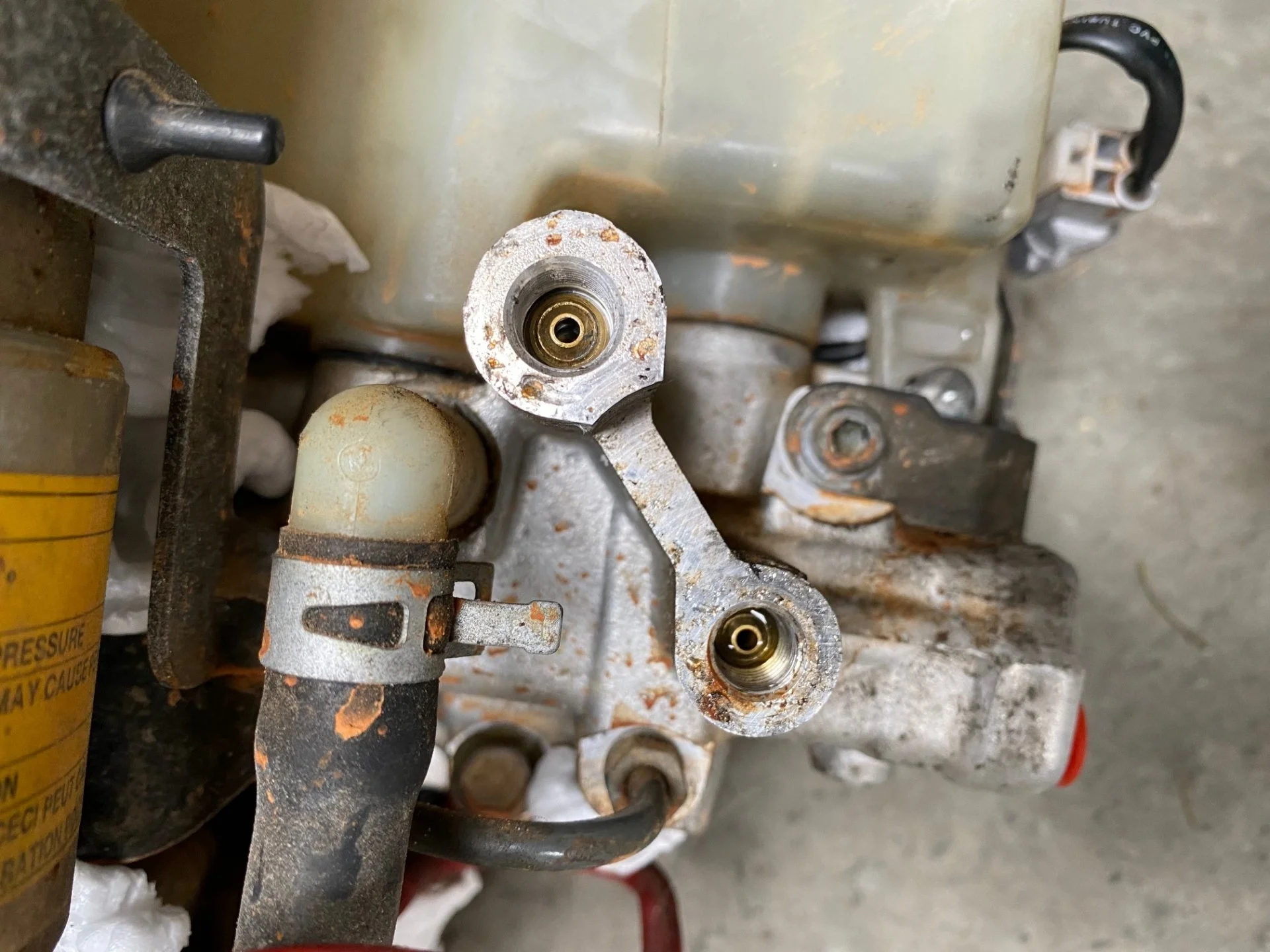

Here is what the threaded openings look like on my original part that was removed from my '02 LC.....top opening def seems larger?

Still confused here....I posted another picture of what the ports look like on the original part that was removed from my LC. Would love to know the proper part number if it's not the one I bought! Thanks again, all.....
Your PN's don't jive. From what I can tell, it should be 47050-60042
Interesting.....I will look into it further. What is frustrating is that when you put 47050-60012 into any online Toyota dealer parts page, and enter 2002 LC, it says "this part will fit your vehicle" :-( the part you mention seems to be identically priced as well, and diagrams online look the same......I know sometimes Toyota "supersedes" part numbers. I wonder how I can guarantee I get the one with the wider top opening.......

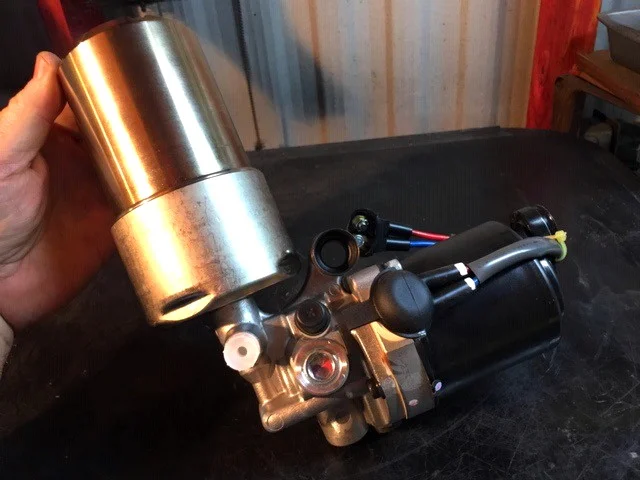

Mind you, this isn't just the motor, it has the accumulator as well, figured might as well replace both if I am paying someone to replace it.
The route I went also.

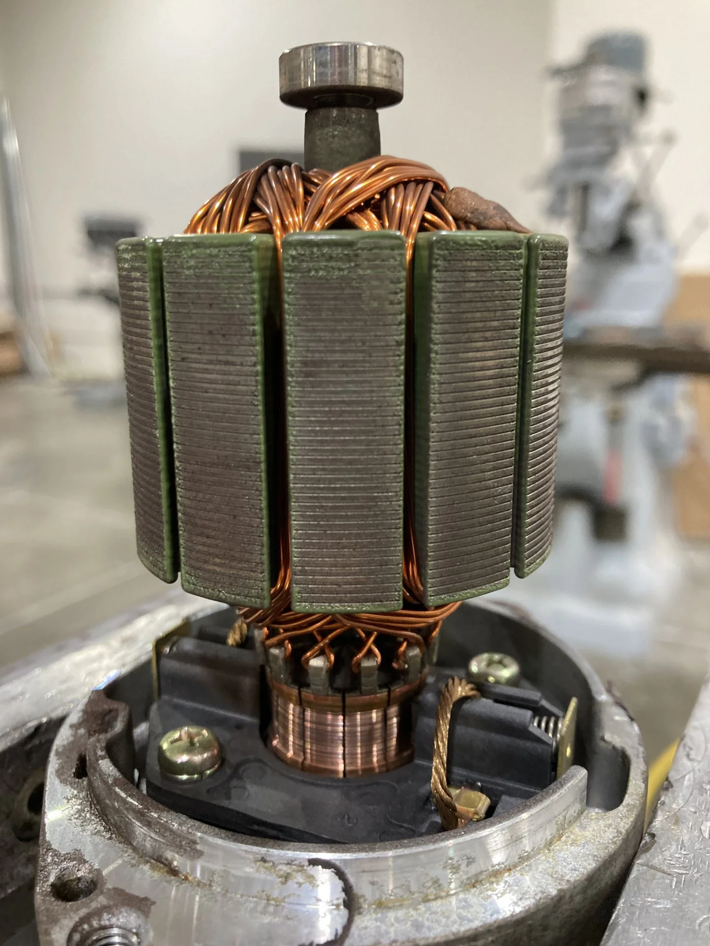

Voted. I won’t say it’s a complete failure, but after getting the screeching seagull a few times I would say failure was imminent. I replaced the whole brake assembly. Here’s what my motor looked like, I think I broke the magnet on removal but I didn’t feel a big break so idk.
