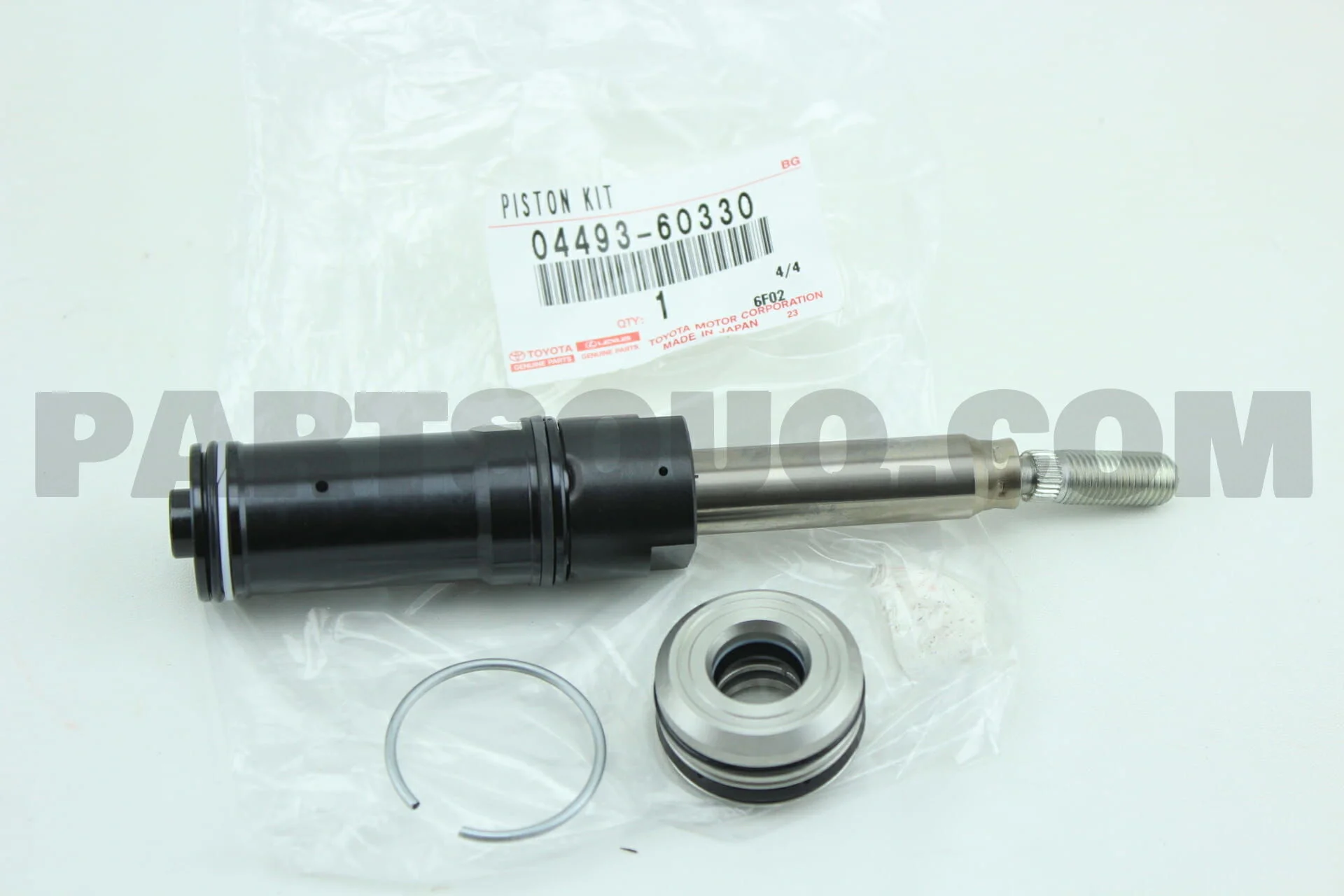

I rebuilt mine. You just pull it out and replace the plunger. 2 :banana::banana: job.
My fluid is clear. I see agitation in fluid as the segul is screaming lol. There’s a guy who offers rebuild service. Including rebuilding of the master cylinder. Is this service legit?
To my knowledge, no one has perfected the inner seal replacement. But perhaps someone has. Most are just replacing plunger, which comes with it's seals. Replaceable plunger is not the issue here! IMHO!
back or closes to pedal Plunger w/seals is available from Toyota.

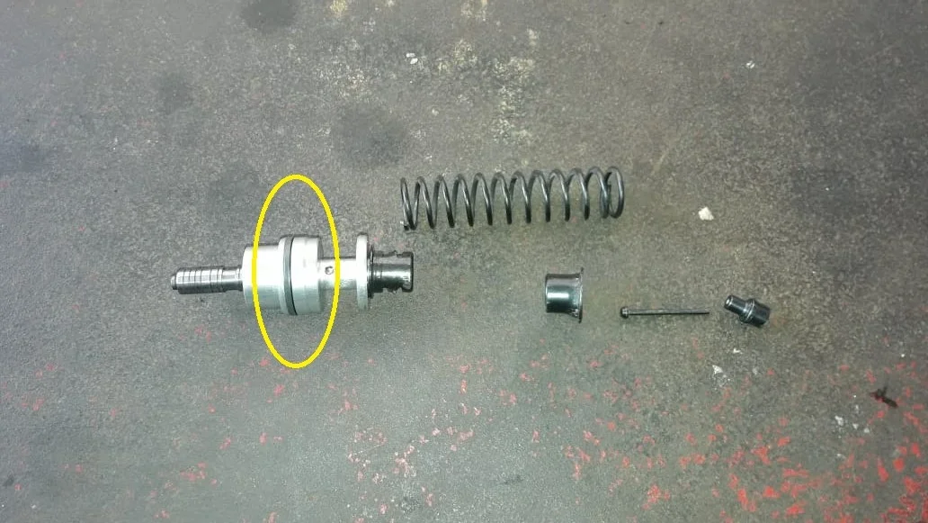

But this is a different seal I suspect causes "dying segal" w/associated bubbles in reservoir, that sit behind (forward of) replaceable plunger. We just see a little rod in the hole once plunger removed. It's important when replacing plunger, rod is lines up with plunger. Some force plunger in w/out lining up rod, an damage them.
Here is a picture of internal plunger rod, spring and seal. Someone posted it after being removed busting the rod. I've tried to pull them out, no go. To remove them, is too bust them. There may also be another seal deeper in behind this one.. One day I'll cut open a master and see. But for now, I can't rebuild.

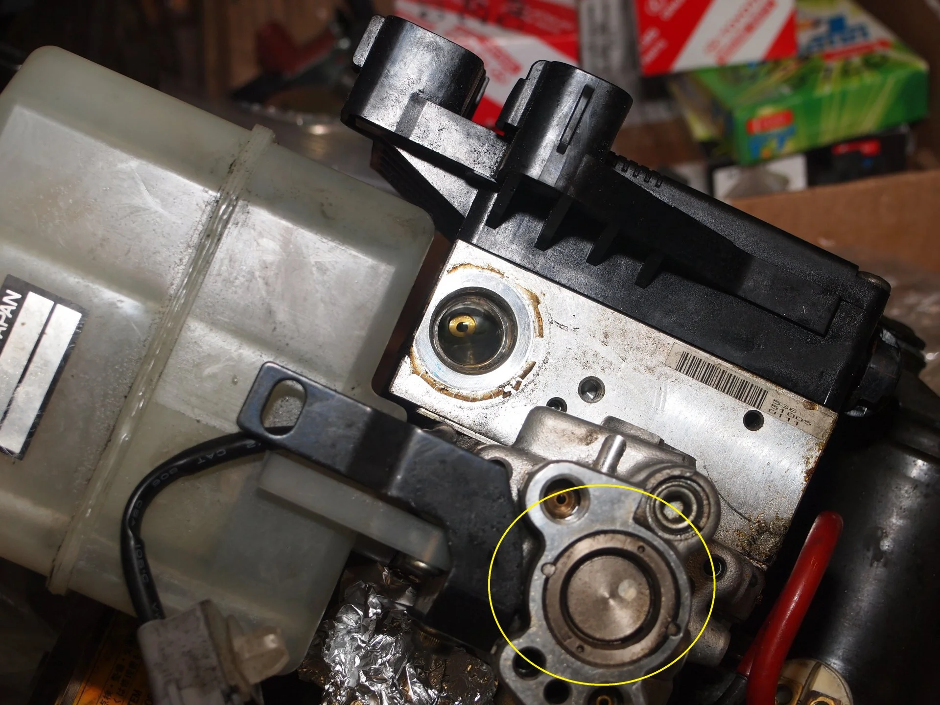

It may be possible to get at seal from forward end of master. But factory set-up, as non serviceable, by cripping housing over what appears to be thread plug (circled in yellow).
