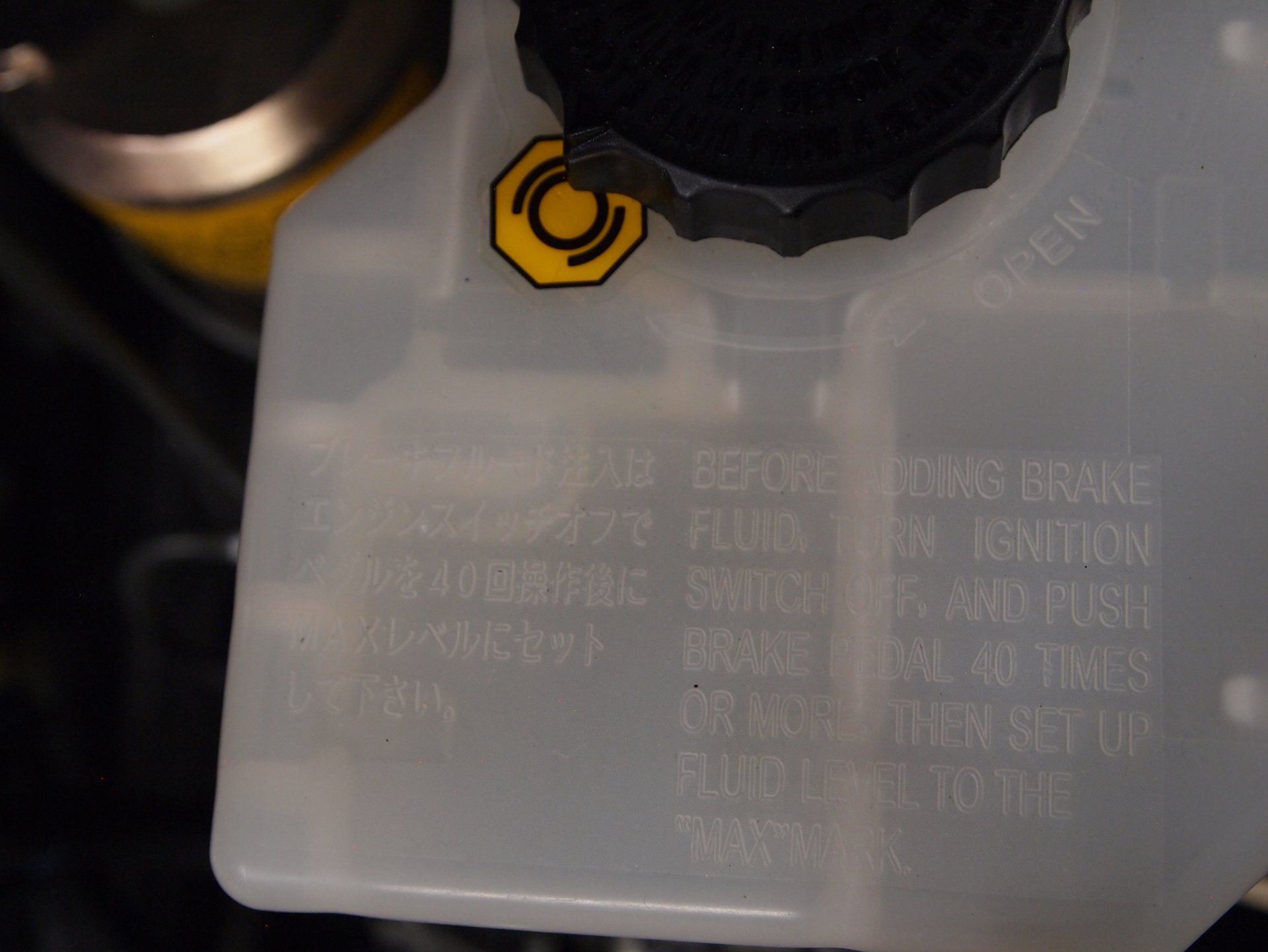

Here one screeching that I barley caught on film. Watch very close as you hear the screeching at ~1:10 minutes into video. You'll see bubble come up in reservoir. Time to full pressure on this was was only slightly over spec, at 43 seconds. Then after short pause motor started up again. This indicates pressure drop WHY! Then we hear screech and see bubble in reservoir:hmm:. In this one it took 38 pumps of pedal until feed back pressure dropped off (reaction force became light).
Also notice how reservoir is over filled. FSM is very clear, do not over fill. Overfilling does not cause accumulator failure, but has some very bad affects.
