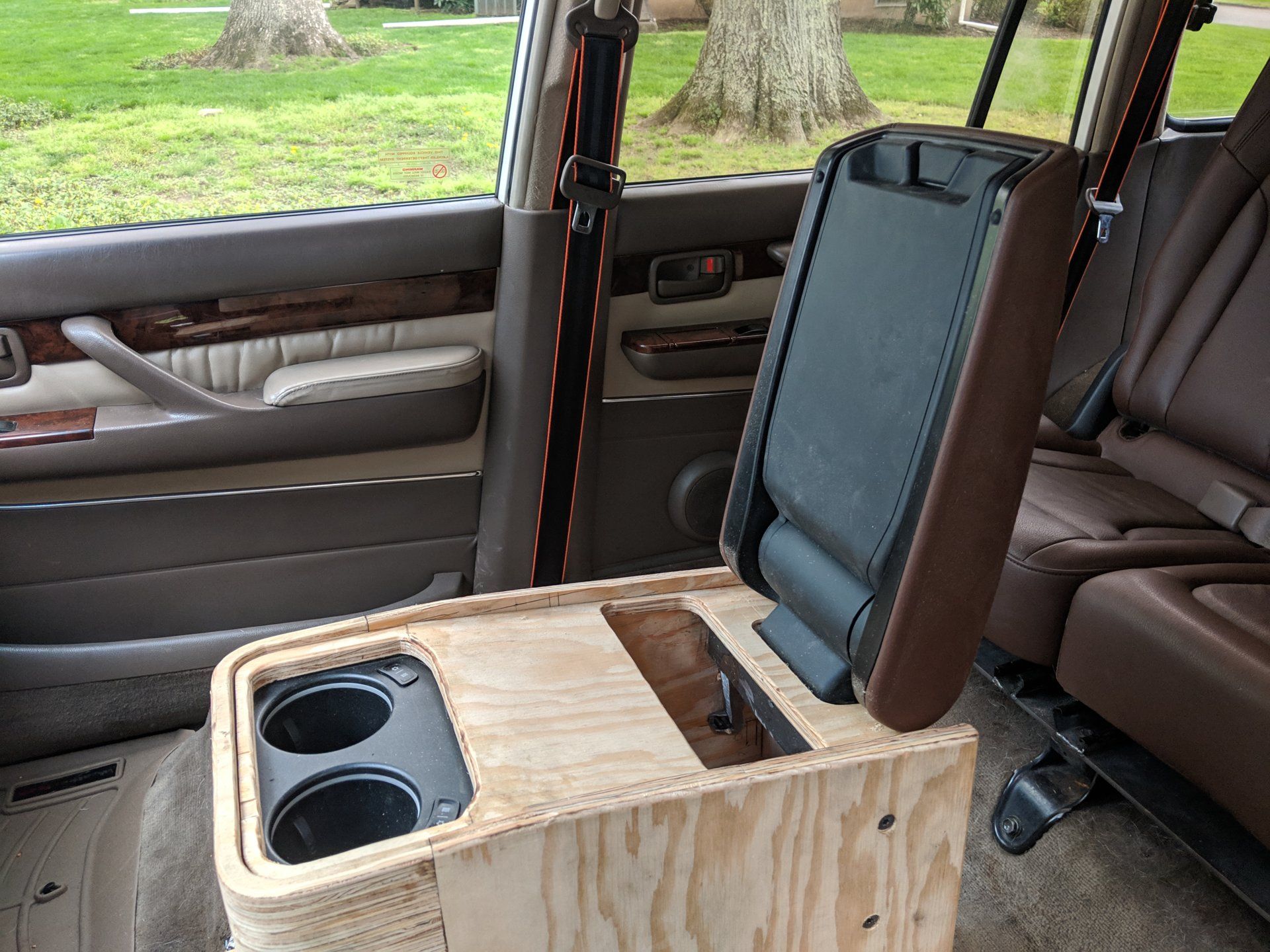

I finished fabrication on the center console. I'm going to fabricate the shifter console, then I'm going to clean up and upholster both.
My replacement carpet arrived during the week, so I'll swap out my destroyed carpet before I permanently install these consoles.

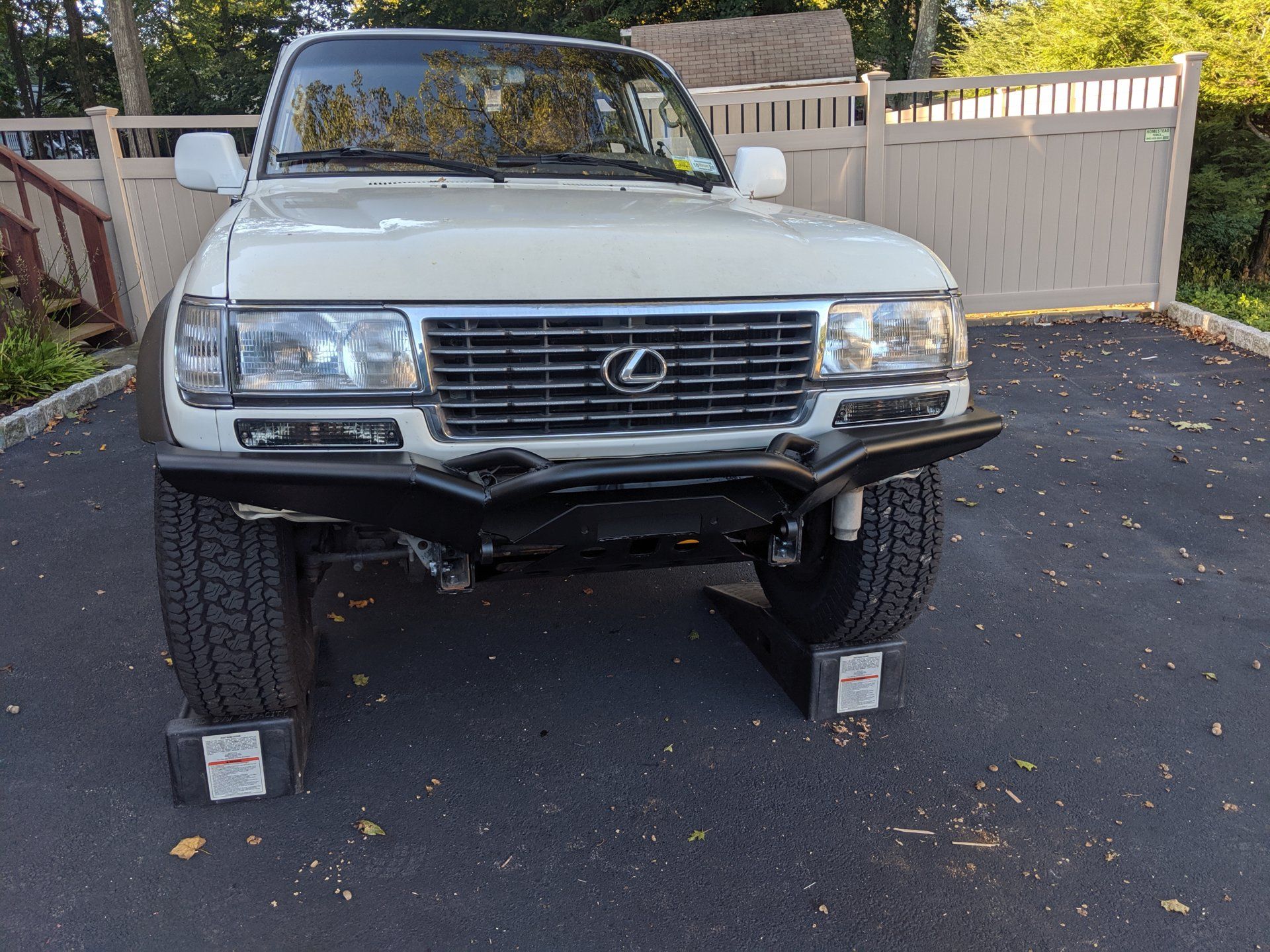

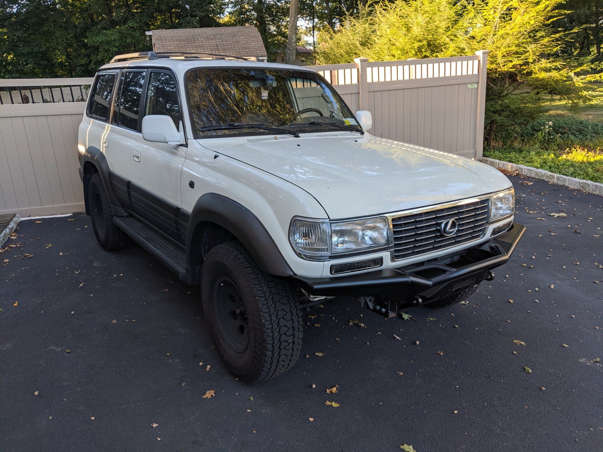

I upgraded most of the front lights on my Lexus this weekend. You can view the process at the embedded album below, or click on the album to be taken to the full version
Cheers
Did you paint the plastic cladding too? Looks a darker grey--really good with your front bumper!
