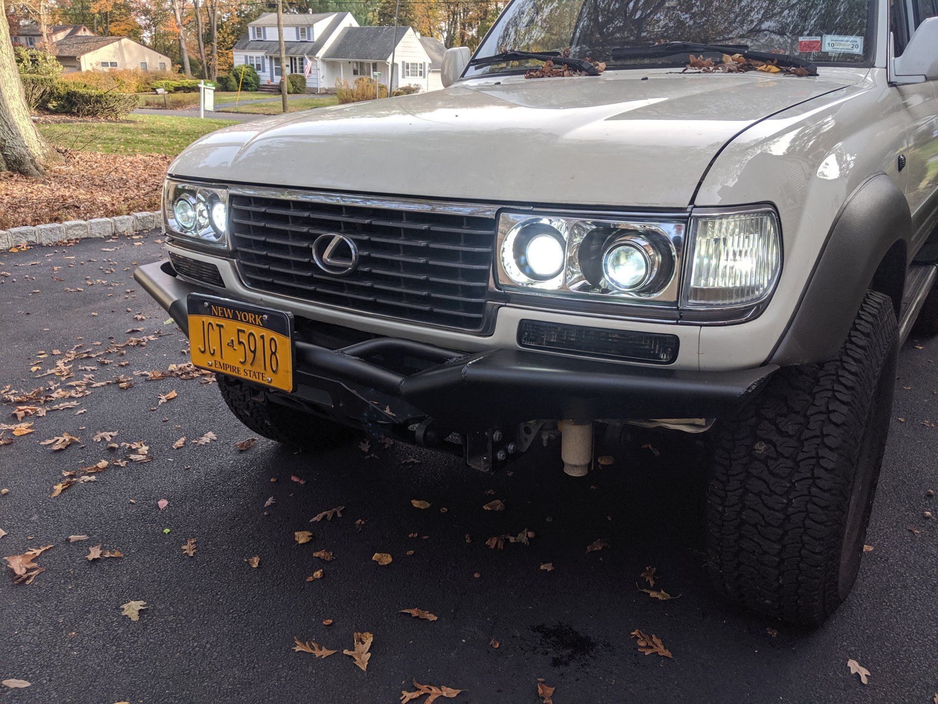

In anticipation of the looming NY State Inspection, I mounted a license plate bracket to my newly installed 4x4 Labs front bumper. I bought a pair of light mounts for tubular bumpers for $10, a licence plate bracket for $6, and some hardware to attach the bracket to the mounts for about $3, all on Amazon. I'm happy with the end result, but I'll monitor the noise and the engine temps to make sure the location is good.

Why not mount the front plate in front of the winch mount? I believe you can even get a fairlead with a mount that flips up out of the way.
Good question. I haven't decided what type of winch I'm going to get yet, including not having yet decided between steel or synthetic cable. I'd rather not buy a fairlead that I may not be able to use. Plus, I needed a quick solution to get the inspection over with. I may yet get a fairlead license plate mount, but I'll be NY State legal in the meantime this way.
