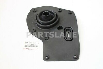

I replaced the shift lever boot because the old boot was torn and crumbling, leaving me with a gaping hole where the shifter linkage goes through the floor. The Toyota part number is 33555-60071, it's still available new, and the replacement took a few hours because it requires quite a bit of disassembly to get to the boot.

And don’t lose the little metal crush sleeves for each bolt, they are hard to find!
