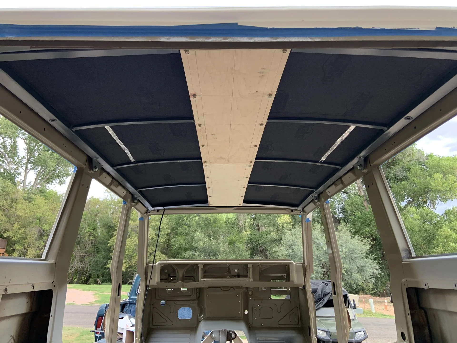

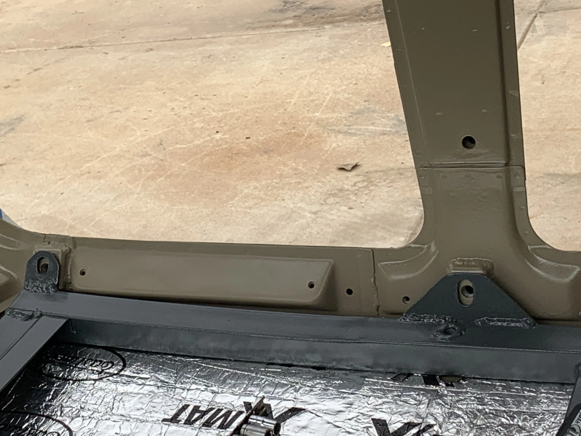

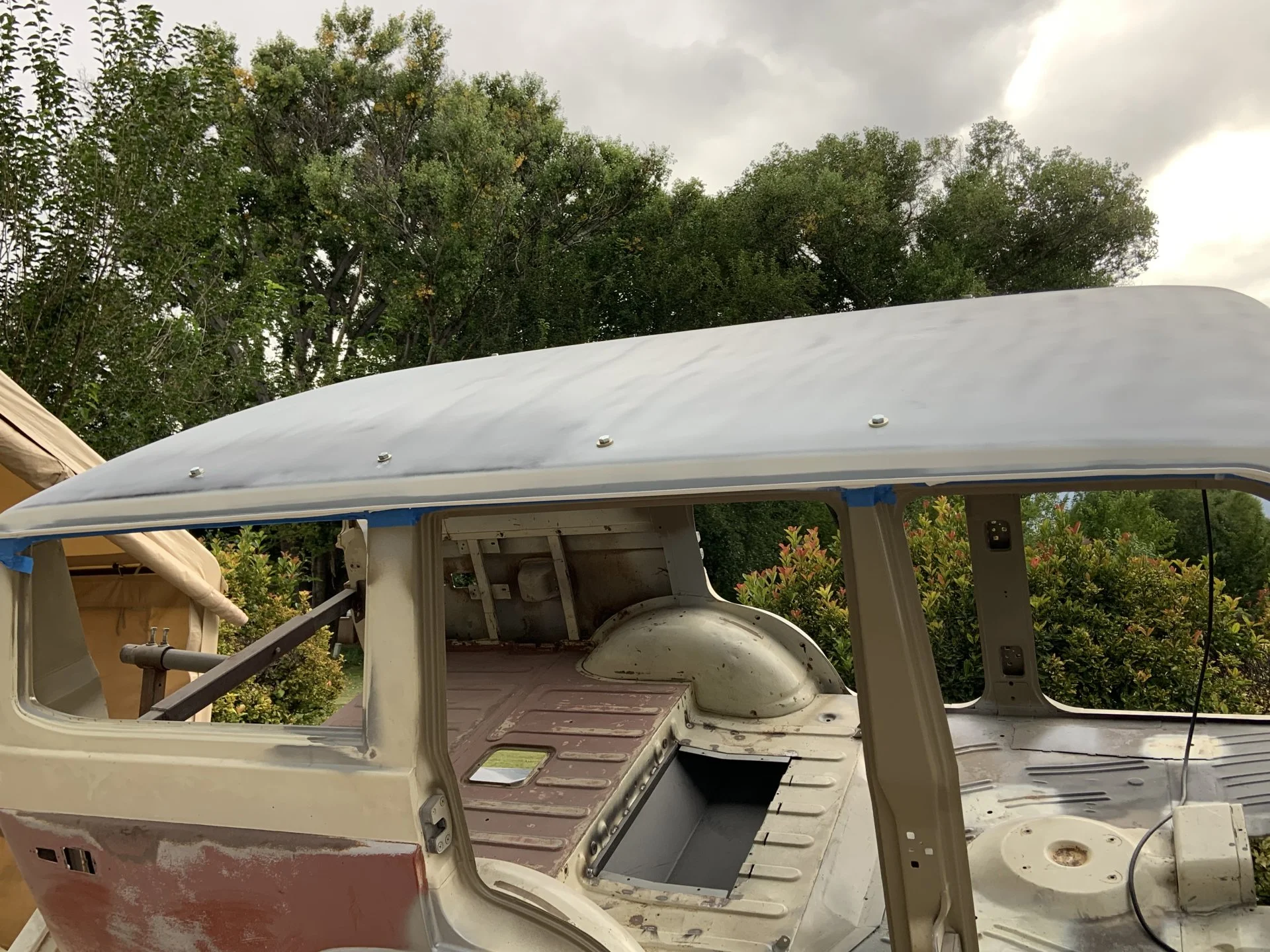

I built an interior rack inspired by the one Ron built for his. Then I welded some long coupling nuts into the outer length-wise runners to serve as mounting points for a roof rack, inspired by what Jim did to mount his roof rack.
I don’t have the greatest pics depicting the specific idea, but you can zoom in on these pics and see some of what I’m talking about.
The Ron inspired roof support system is golden. Saw his live at the PP and it was glorious!!
Thanks Man! It turned out alright for a guy shooting in the dark. I really like the idea of Rush's combining the two setups. There's a lot of weight sitting on those gutters which aren't the greatest to begin with. As always, if I had it to do over....ah hell, I'd still screw it up. :)
