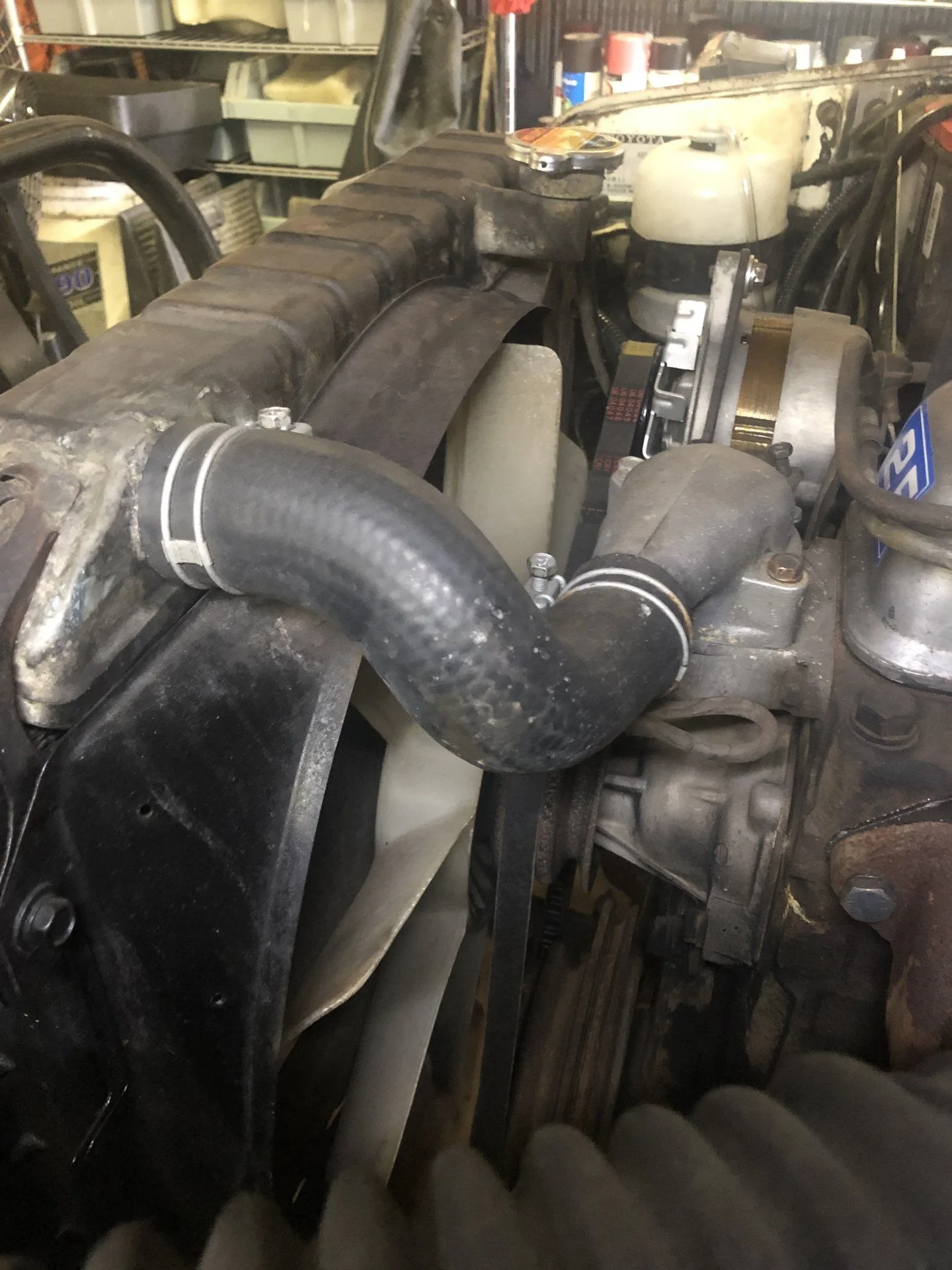

Snap a quick pic of your current pump/fan and I can get you set up

Too bad, I was going to chime in that I got the 3FE clutch fan to work in my engine bay, but it was also attached to a 3FE. That might be more work than you want to take on for a clutch fan...
I did shift the radiator forward in the mounts to buy a little more room. No shroud - so far, so good!

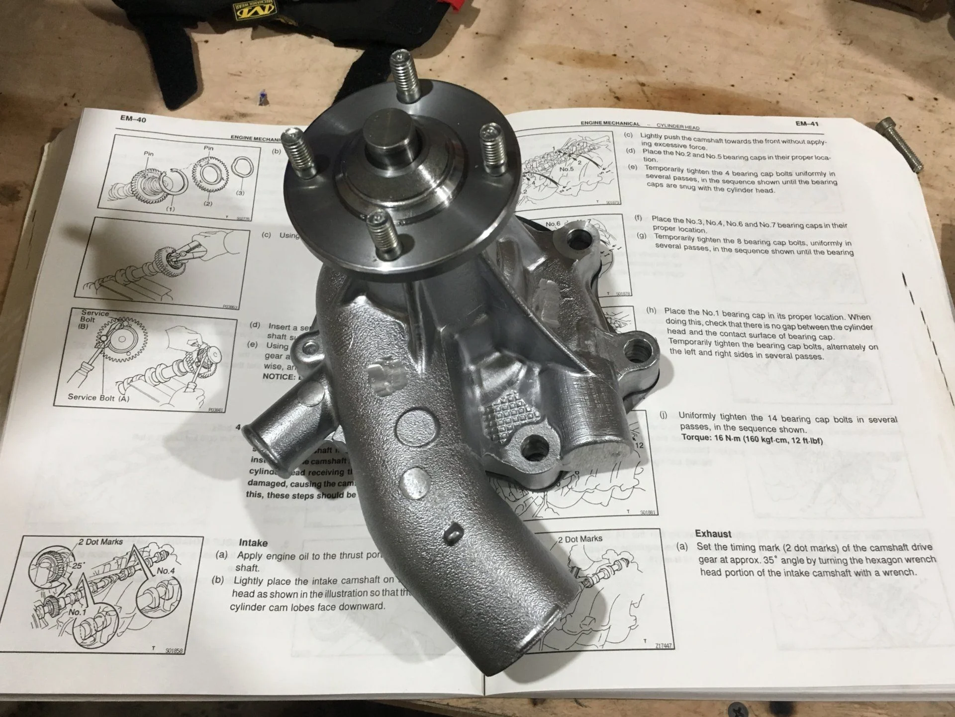

I realize my current water pump won’t have the proper holes for a fan clutch but the new one I ordered does. @FJ60Cam used the same one when converting a F equipped FJ40 to 2F

@cruiseroutfit wpt-063 is the pump we got.
If you can stack the fan clutch and fan on one of these pumps and get a depth measurement please.

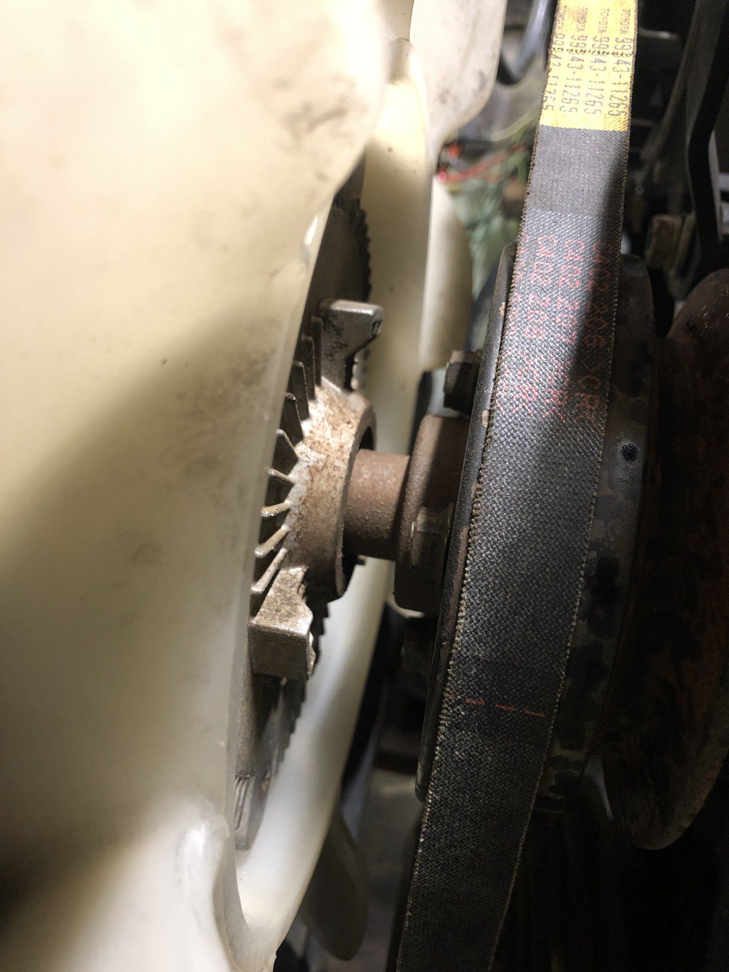

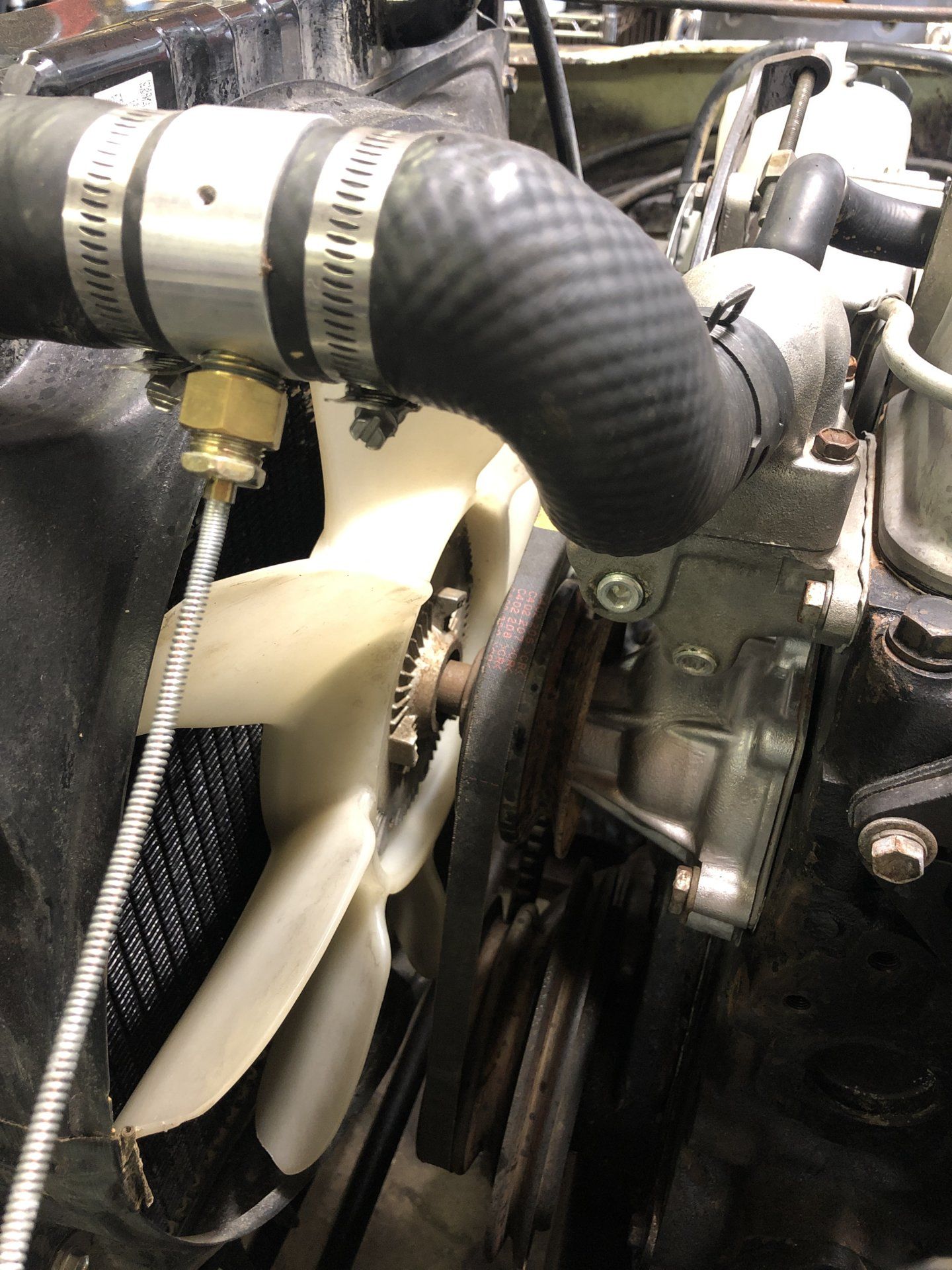

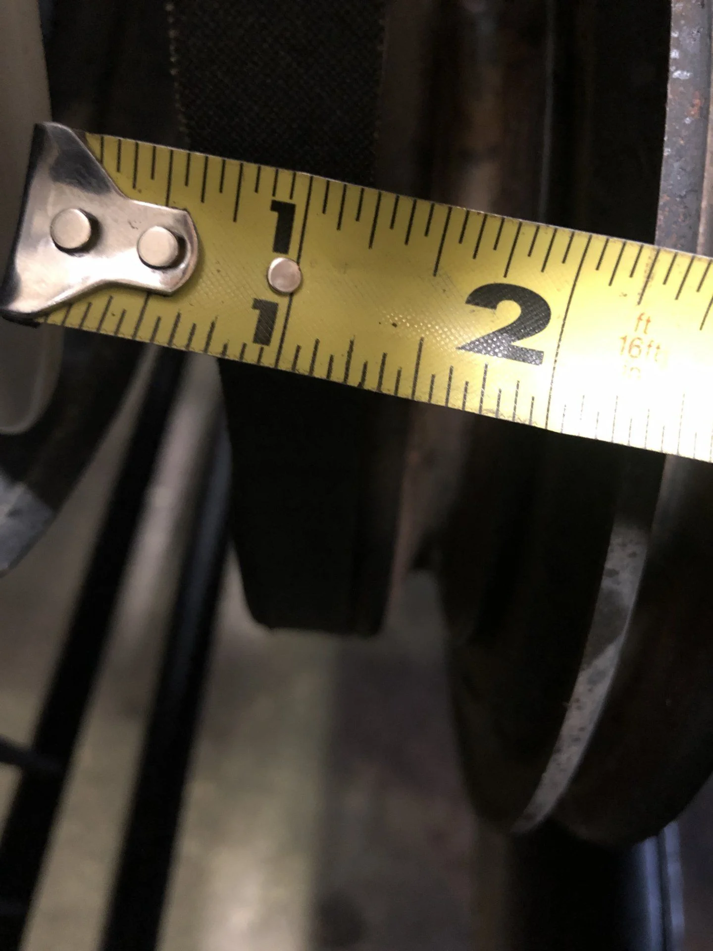

I pulled around my 1968 fj40 with a 1984 2F to pull the fan clutch numbers.
From the front of the block to the radiator is 9.5”
I have the 60 series fan and fan clutch on the truck.
I have 1.5” from the front of the fan to the radiator. (We had to grind down the ends of the fan to fit inside the 40 shroud)
Looking at my numbers on the FJ55 if I use the exact setup I’ll have 1” from the fan to the radiator which should be fine.
1/2” clearance from fan to the belt

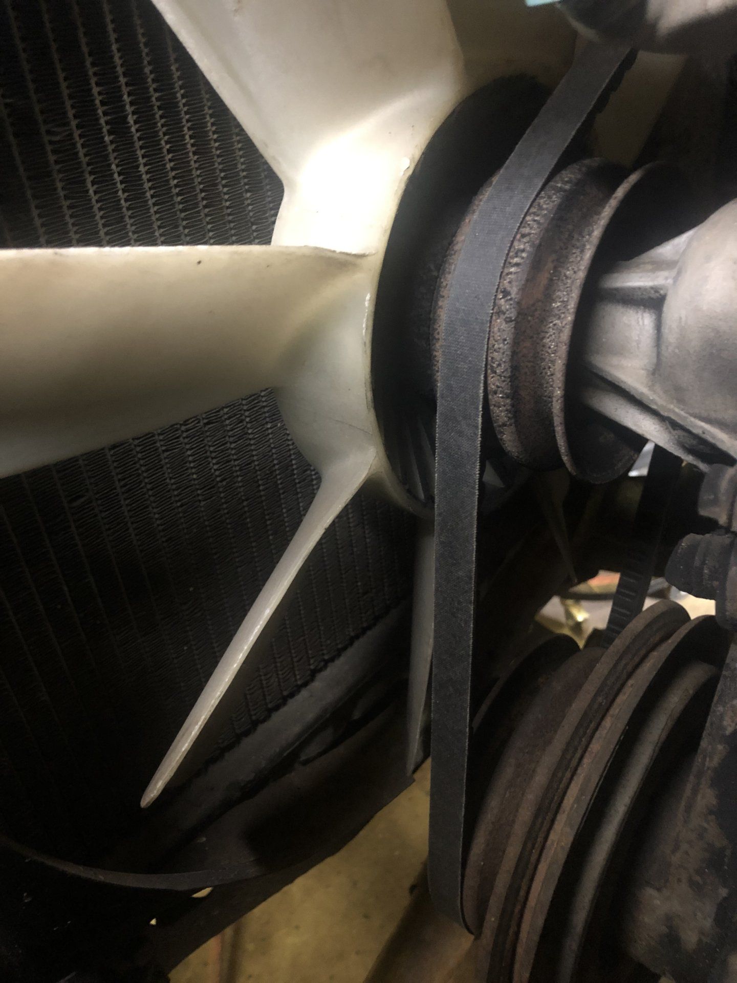

Fj55 radiator to block distance tighter as you noted. With your water pump, meant for a fan clutch, you should be able to squeeze it in there. I ended up not going this route on a project a while back because it’s *so* close.
Not fan blades touch the radiator close, but b/c I couldn’t take the fan and clutch off the water pump studs, or get a fan belt off. For me, It really wasn’t worth the trouble at the time.
Caveat: Kurt may have a fan blade that sits deeper on the fan clutch than I had available at the time(later fj40 fan with clutch), which might buy you 1/4” to 3/8” which would have been just enough.
I would keep in mind the fan blade to crank pulley clearance. It gets tight.
