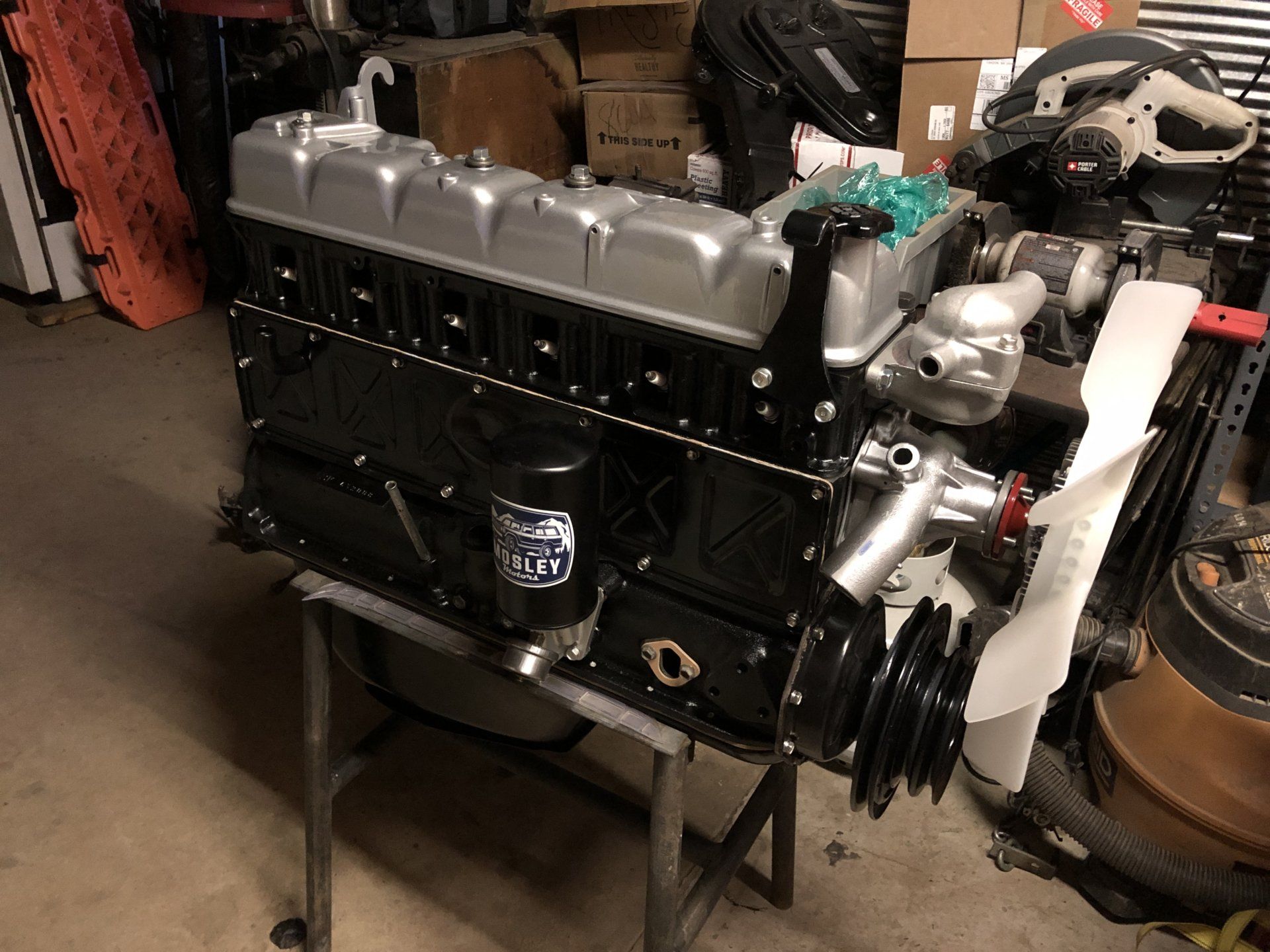

So a 60 series pump with oil cooler and this clutch and fan blade will have same dimensions as the without cooler pump? This is great work, guys. I had given up on a clutch option for the pig...
The ‘with’ water pump is exact the same as the ‘without’ pump, only it has the oil cooler n!pple.

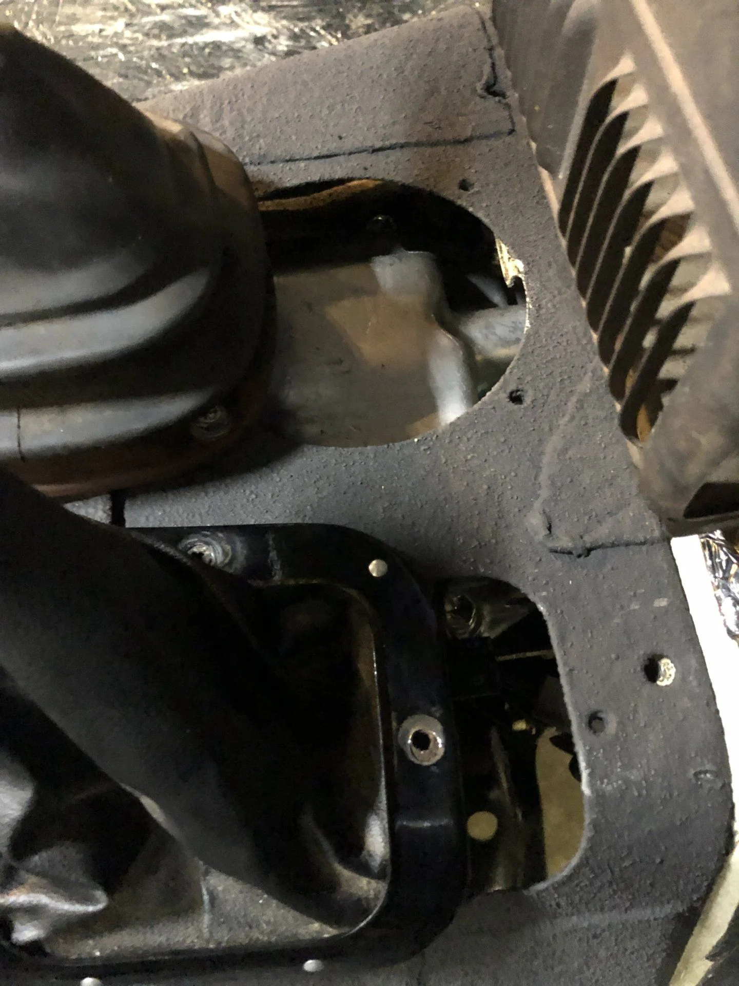

The shifter holes look like this

Playing around with some options, I can get us to 7-3/4" overall height (without the pulley). Even with the thickness of the pulley flange (1/8") we are still well shy of the 8" mark which would give you an inch on the fan to radiator. That is using FJ4x parts with an FJ60 fan blade. I've got more of the FJ4x variant fan blades themselves coming but while they have the correct OD, they have more offset (1/2") so they would kill room. If you're good with the FJ60 fan blade trimmed, easily done with all new parts.
To close the loop on this I got the motor and I have the fan clutch and fan and it’s dead on balls 8” head to tip of the fan.

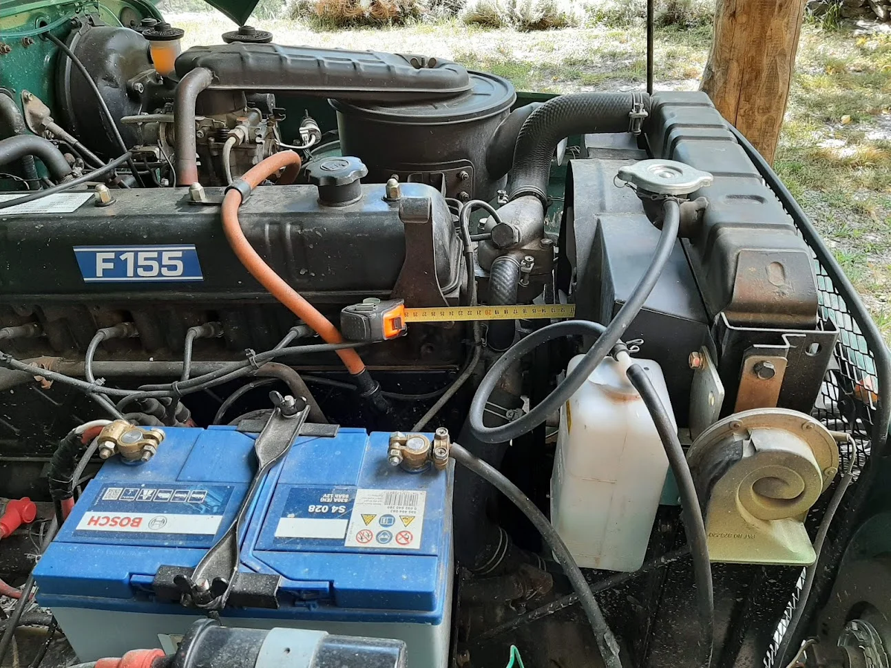

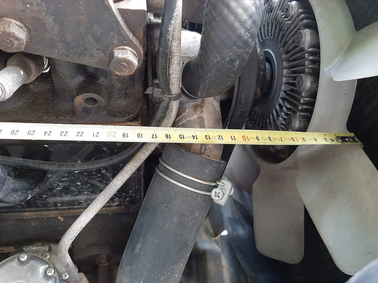

I got it measured on my 1974 FJ40 (not sure if it's supposed to be the same than a FJ55) the stock setup I have and I find :
Engine block -> front of fan : 18cm (7.1")
Engine block -> back of radiator : 23.2cm (9.1")
1” to spare. 👊
Based on your 8" measured once added the pulley that would be about right for me too. But clearly It would move a lot more inside the F funnel and my fan is already a bit too much inside for my taste so that would be way off on this point. On the 55 did it aligned well with the funnel ?
And based on the topic I came from, is 1" between the fan and the radiator really enough to avoid any contact ?
