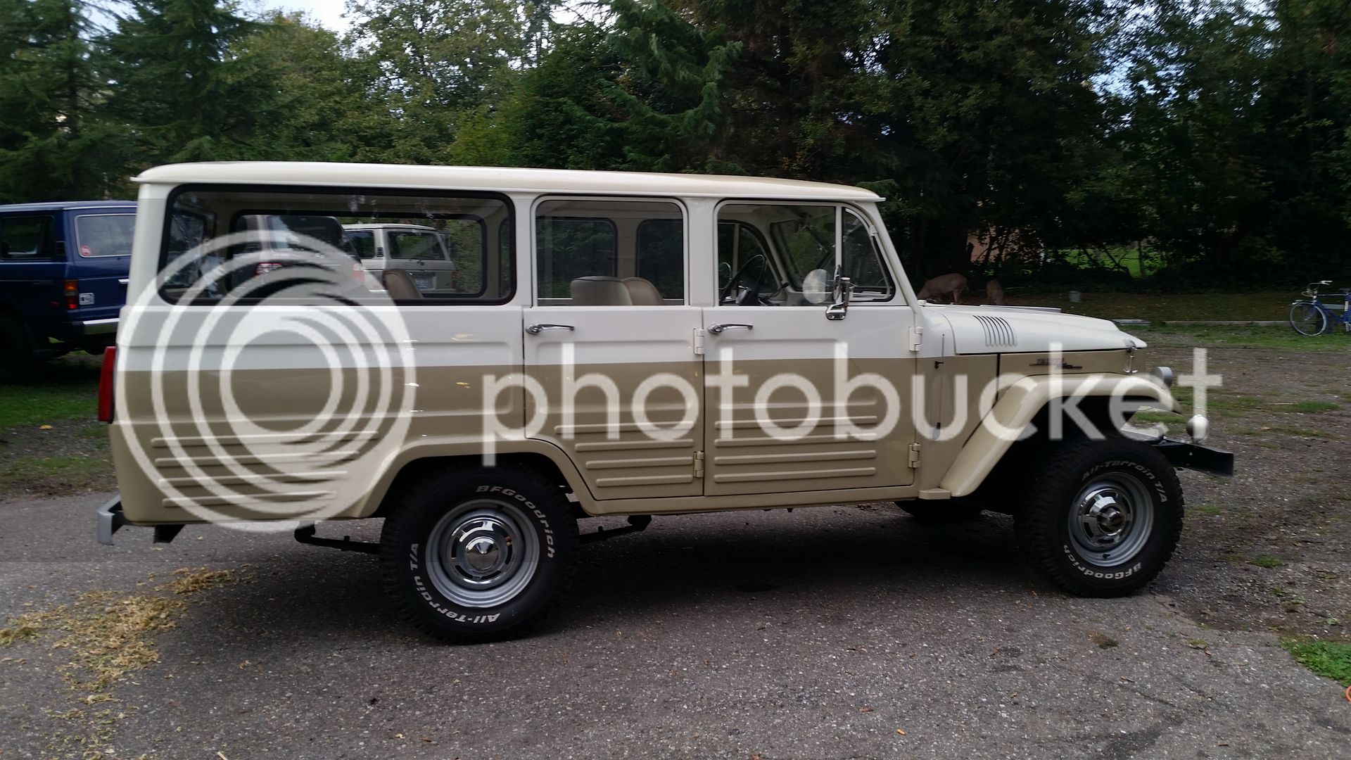

I hope this helps
Not the best angle, ill try to find another one if it will help. This is what i have, 2.5" shackle lift, stock springs, 31/10.5 " Mudd Terrains. I haven't had any rubbing issues so far. FOUND BETTER PHOTO

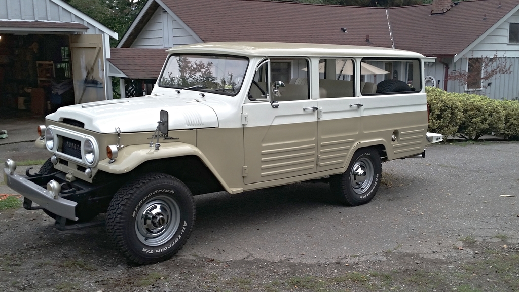

33 x 9.5 x 15
Old Man Emu suspension
I had them made. Stock inners welded to new 8" wide outers. Cost about $100 each done locally here on Long Island, NY (I had the stock rims already)
Swampers make anything look good! But I agree, nice look...

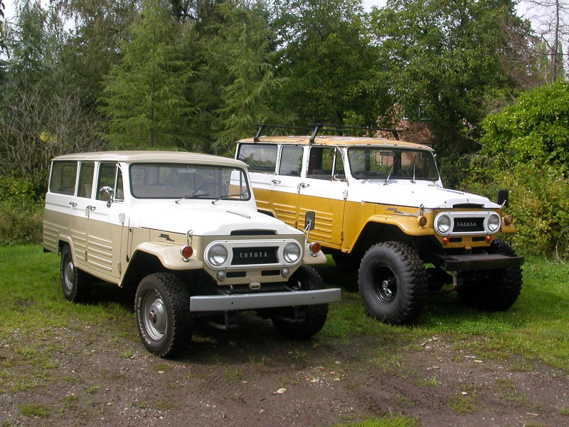

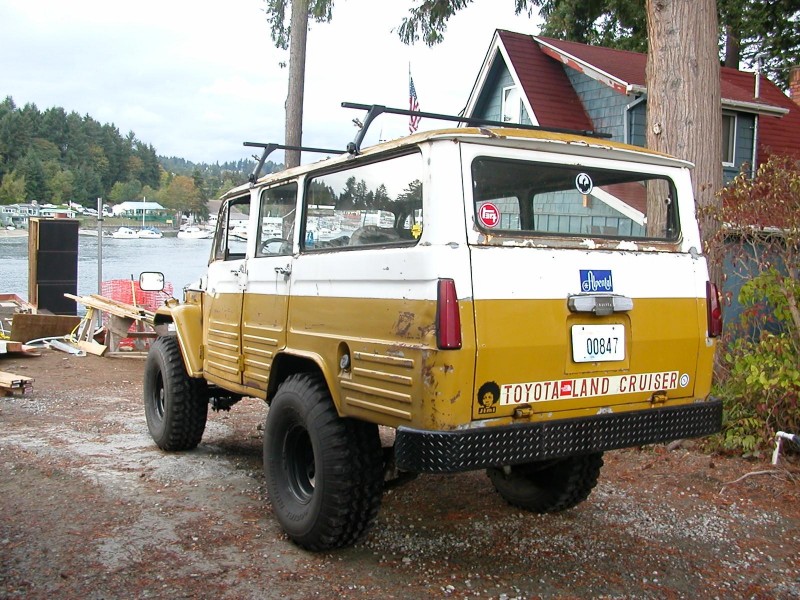

that was mine, pic is in my yard ;)
it had crazy custom spring packs, still under the axle, no body lift, all in the springs and shackles, tires were 36(maybe 38) Gumbo(or Buckshot) Mudders I think...
saggy original springs, longer shackles and 28"(or whatever the metic size is, 235/??)
