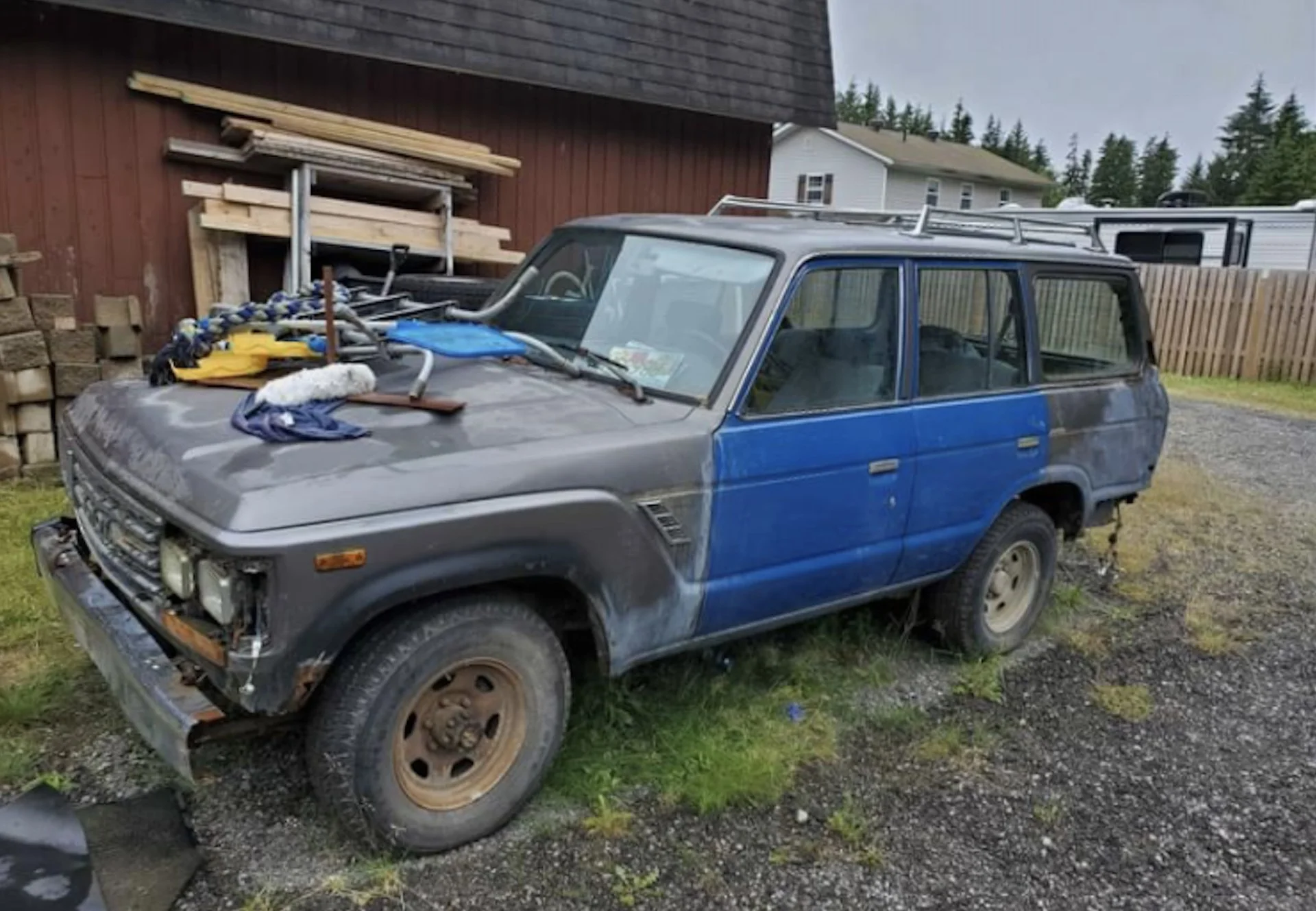

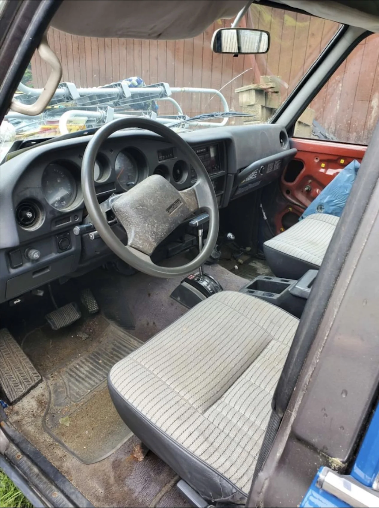

oh, I should've given you guys a timeline .. that trip ain't happening until early December .. which is why I was asking about buying parts ahead of time .. I'll make sure to keep you posted with reports and pictures .. I fully expect a major goatshow .. for now I'm compiling a list of tools I'll bring, address where I can buy stuff, what stuff to buy etc .. definitely going through all your posts too to see what you recommend .. stay tuned .. this'll be good ;)

That ol' gal has not had an easy life! Props to you for rescuing her.
Land Cruisers are pretty simple machines, but the EFI system in the 62 relies on wiring in decent condition to run properly (clean grounds, no mouse-chewed leads, etc.). If you get lucky there, you are likely to get yourself home.
BUT
It looks like you're based in Victoria, and the truck is a BC truck. I'm guessing that means you're going to be crossing a few mountain passes in this thing. In the wintertime. Through some pretty remote areas. Lordco isn't going to have parts in stock for anything that you might need to replace. So unless you have pretty deep knowledge of these vehicles, access to a factory service manual, a good set of tools, and clear weather...trailer it. I'm all for adventure, but there's your own safety and that of other motorists to think about...not to mention that of any first responder who has to help you out.
My advice is worth exactly what you paid for it. Whatever you end up doing, I wish you only good luck.
