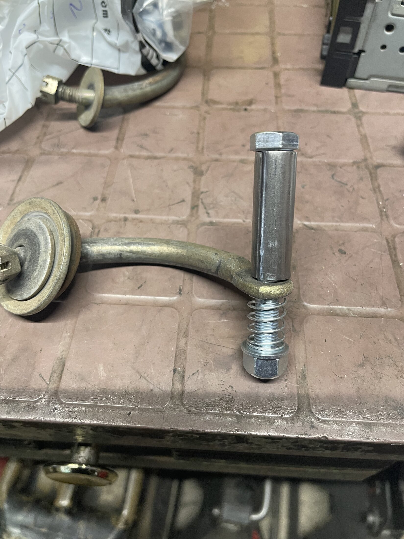

Couple of tech items for today. The doors have had a bad habit of flying wide open since I got it, mainly because the door brakes had torn completely off of the doors who knows how many years ago. In a moment of inspiration (and frustration) last night, I came up with the following to pop into the holes in the door left by the torn bracket. I kept the brackets just in case down the road I want to put them back, but this works a treat for now.
The springs ended up being not necessary, since they caused the bottom bit to be a little too chonky to fit through the hole in the door, and the bolt just sits down on the spacer anyway. But if I ever need to get them out, I can just slide the bolt up and tilt it out. The bottom nut is a stover nut so it won't come undone. I also recycled some rubber bumpers from a set of sway bar ends from my BMW project as the end bumpers for my door stops. Took all of about 30 minutes but damn if I hadn't been trying to figure this out off and on for a year.

Installed pic needed.😉
All too happy to oblige! Passenger side. Bolt had to be long enough to get above the top of the hole when sitting on the spacer.
Driver's side. Note bumper from BMW sway bar end.
IMO, that’s one strong gust away from an even bigger hole.😱
Thirty years ago I welded three plate washers together, two at a right angle to the third, filed them down and welded them into the door of the karma cruiser for the PO. They’re still there.😉
Yeah, I thought about that. The metal there is fairly thin. I can make it a temporary solution until we have a chance to meet up and have you glue some metal?
When Tony first brought the karma cruiser to me, someone had taken a small piece of a leather belt and attached it to the A pillar and the inside face of the door with sheetmetal screws. :hillbilly: , but it worked.

Where I work there is no shortage of broken sway bar links. So I did what you did and grabbed a couple of bushings from a set getting replaced anyway and use those as door stops, limiting bushings

I still like my hack, but it's going to bend the inside of the sheet metal making it tougher to do the welding bit and eventually, yeah, it'll tear. I am constantly reminding Charlie to be careful with the door. I also still have the brackets to glue back in, but it'd probably break again.

Spector sells repair patches for those limiters for $50 each. Makes repair easier than trying to graft the old tabs back into thin metal that is already fatigued and gives a much larger surface area for attachment.....I get the "done is better than perfect" principle, but just brining to your attention if you weren't aware these existed.

Thanks - I hadn't seen these. I was going for the "don't mess up the door patina" angle but it may not be possible. The metal in that spot is rusty and thin, so getting to good metal would basically take out the whole area that this patch covers.
