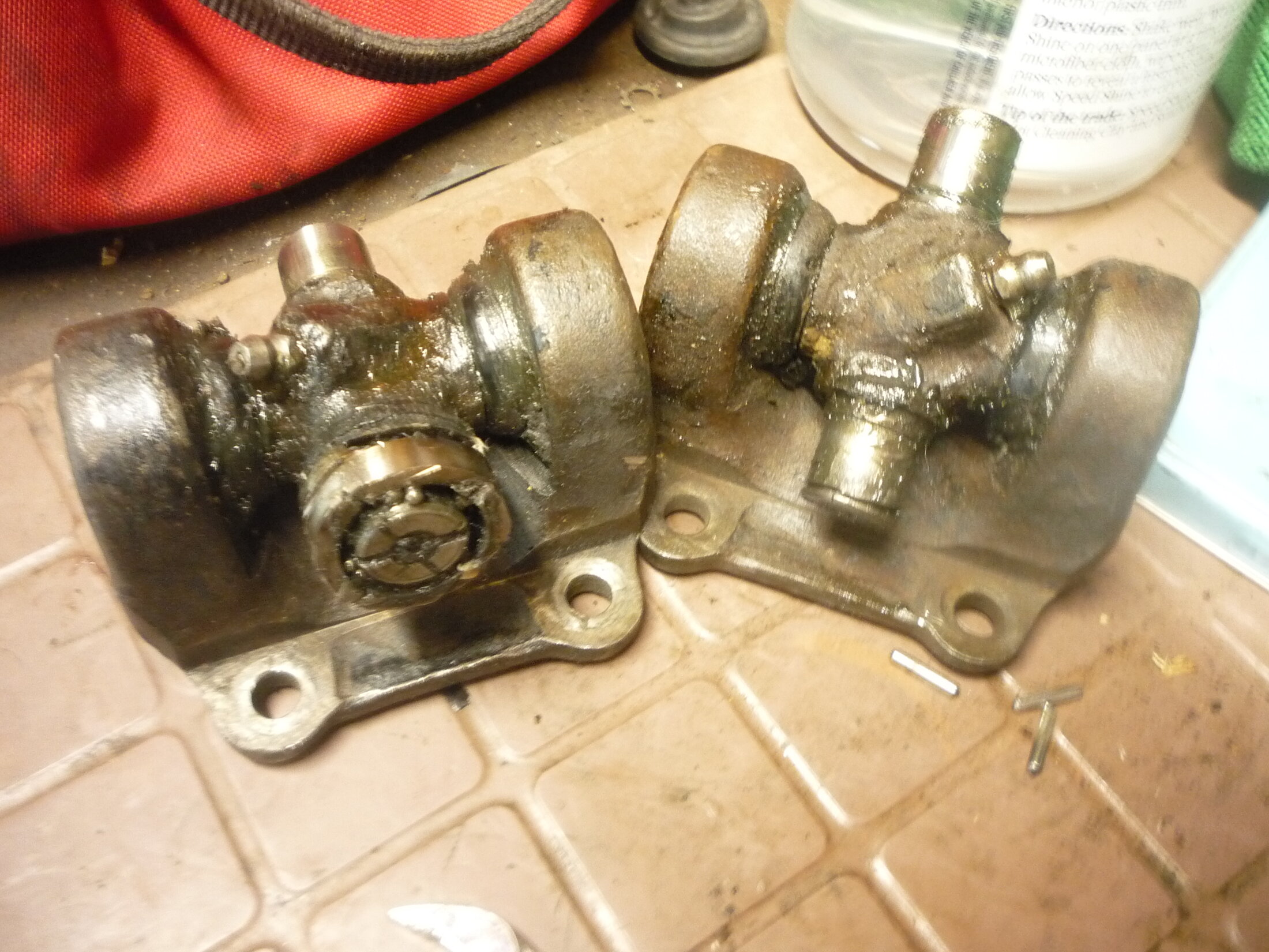

Fun stuff yesterday and today - decided to get in touch with Mark @65swb45 to see about getting a new throttle cable and possibly a different e-brake drum. While on the phone with him, I got under the rig and just happened to tug on the rear driveshaft, and found some play in the slip spline. No bueno.
That keyed up a conversation about new driveshafts, etc. He kindly suggested swapping the flanges from the '72 shaft over to the '68 one that I had on the shelf, to see if that cleared up the vibration and leak. The u-joints are only a few months old, pulling the old ones off the '68 shaft was a total pain.
And the '68 flanges. Got the death wheel out for this one, but turns out I didn't need to.
Spent 2 hours taking one of the new ones off the '72 shaft, and then once I got a procedure down, the second one took 3 minutes. Fantastic. Basically just need to bang one side out as far as it'll go, then support the sides of the flange in the vise to push the other side out as far as that side will go. At this point, both caps should be poking out of each side by about 1/2" or so. Then, pull the inner part of the u-joint to one side, which will give you enough clearance to get a punch behind the opposite cap to bang that one out all the way. Be sure to catch the cap and watch for flying needle bearings, that was fun.
