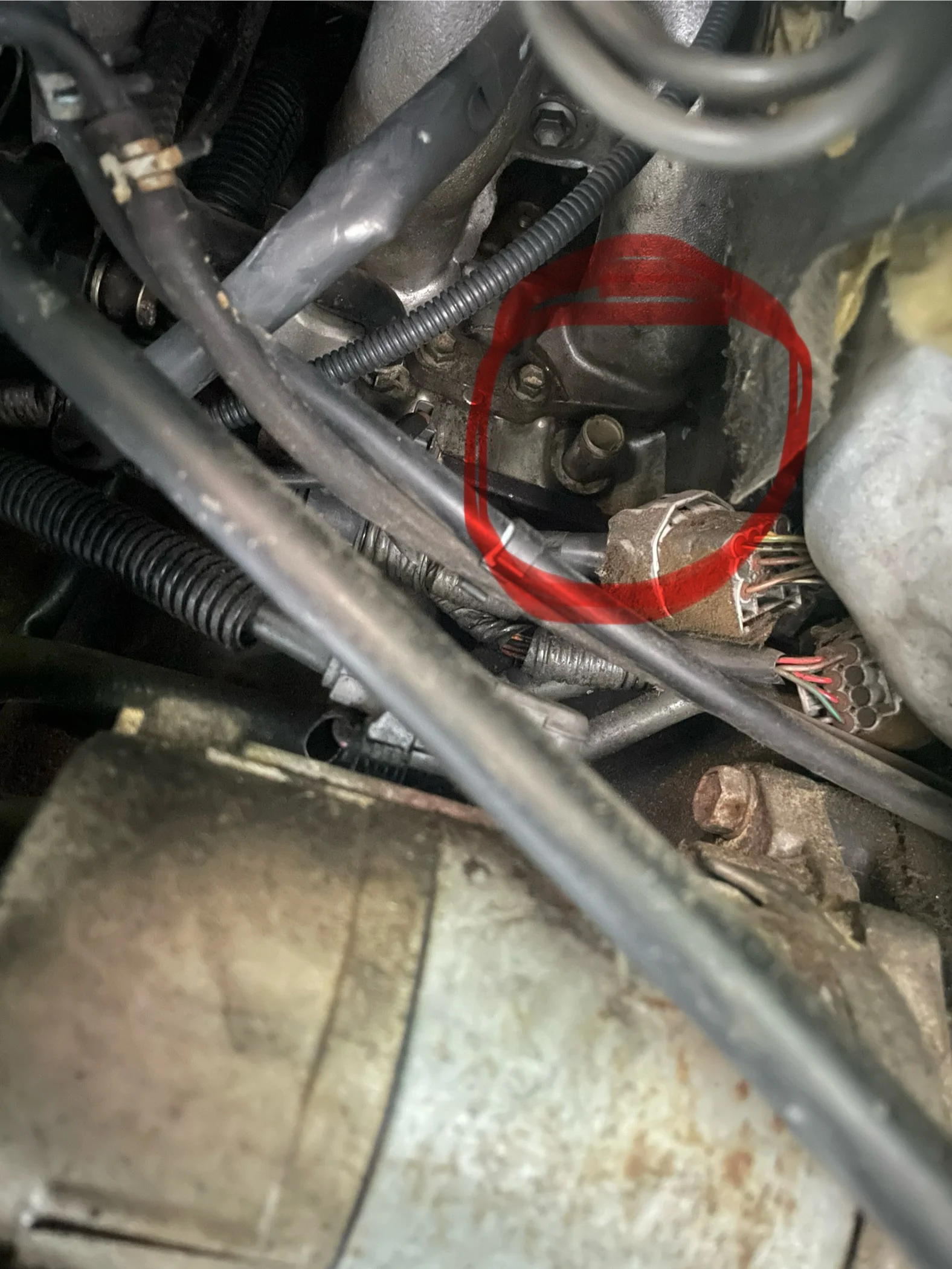

I have looked at every photo on Mud and the web. To be specific - the PHH comes horizontally out of the block, just below the head at the back, driver's side, correct?
There are other tired vertical hoses in the area that likely also need to be replaced, but I don' t want to miss this one, of course.
Thanks - Steve
Thanks - Steve
I was in the driveway so it eas easy to grab a picture of mine.
That

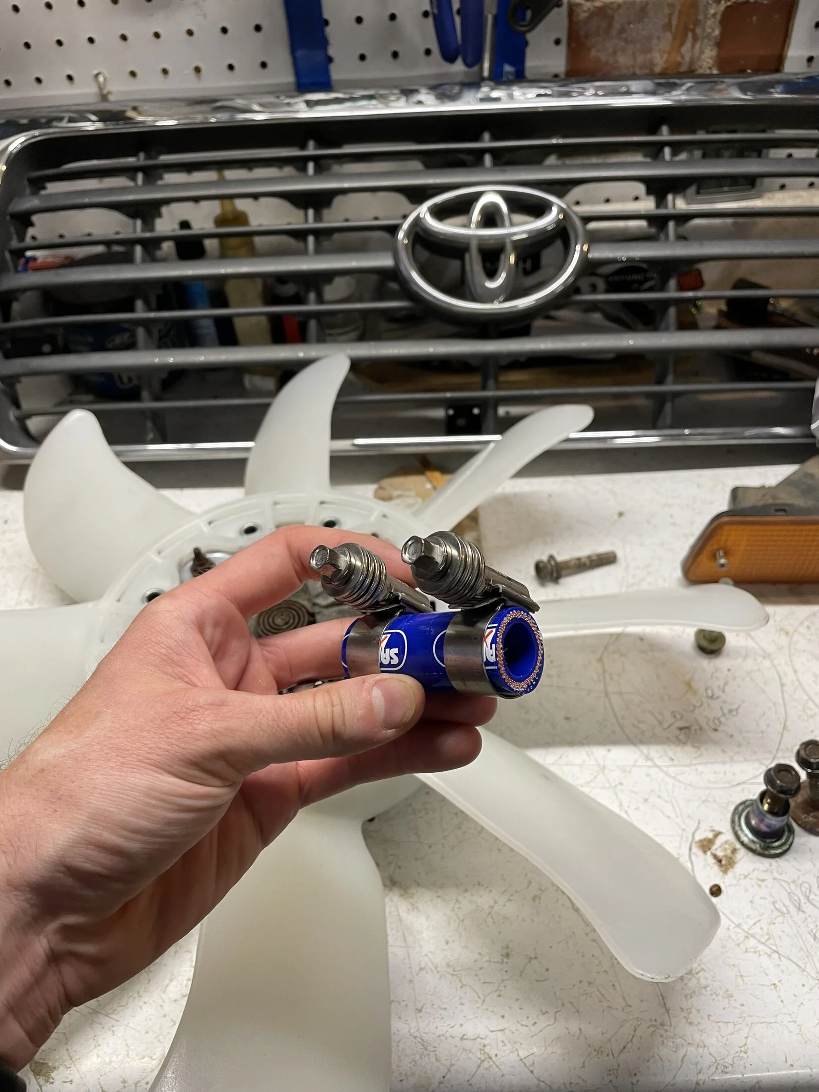

Also, a PHH gift just arrived in the mail:
That will be the gift of having to do it again fairly soon. The silicon hoses are known to let go sooner or later. I used the same thing on my first PHH foray but had to do it all again about 5 years later. Second time round I just went with Mr. T hoses.
I've mentioned this before, but FWIW I compared side-by-side the hose that comes on a new OEM PHH pipe/hose assembly to the GATES Green Stripe, and the Green Stripe hose had thicker layers. And then comparing the OEM hose that came on the assembly to other OEM heater hoses and the PHH hose felt even a bit wimpier (more easily squished). So wondering if the vendor who makes the OEM hose/pipe assembly is using a different hose than the manufacturer of the other OEM water heater hoses?? IDK
FWIW 15+ years ago one 80 got the Gates Green Stripe with Breeze constant torque clamps, no leaks since. On another 80 I used Green Stripe with GATES Power Grip SB clamps (heat shrinkable bands), no issues there either.
Tip: There are a few advantages to the GATES Power Grip clamps/bands: they squeeze down on the hose and pipe equally 360' around the OD eliminating cold leaks and they never need re-tightening. Also, IME, the two thick thermoplastic clamp/bands (3/4" wide each) almost completely cover the short section of hose for the PHH so it's now pretty much indestructible IMO. Main disadvantage to the Power Grip clamps/bands is getting heat to them in tight spaces; it can be done with a bendable pipe/nozzle attached to a full size heat gun, or by using one of those small flame-type heat guns with the diffuser.
That
Oh wow - good to know. Maybe I’ll look at other hose options and keep the clamps.
