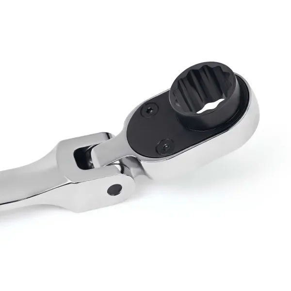

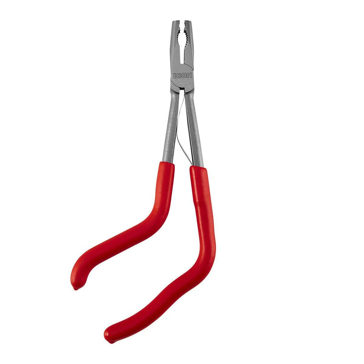

Once I have all my angles I'll buy a mix of pivoting wrenches, long reach pliers, a hose clamp tool, and anything else I can think of. I'm planning on using the specified 90467-22003 clamps, which I expect to come pinned open. If I struggle to position and close them appropriately I may try options like the images below. Any recommendations on specific tools that worked well is helpful.
