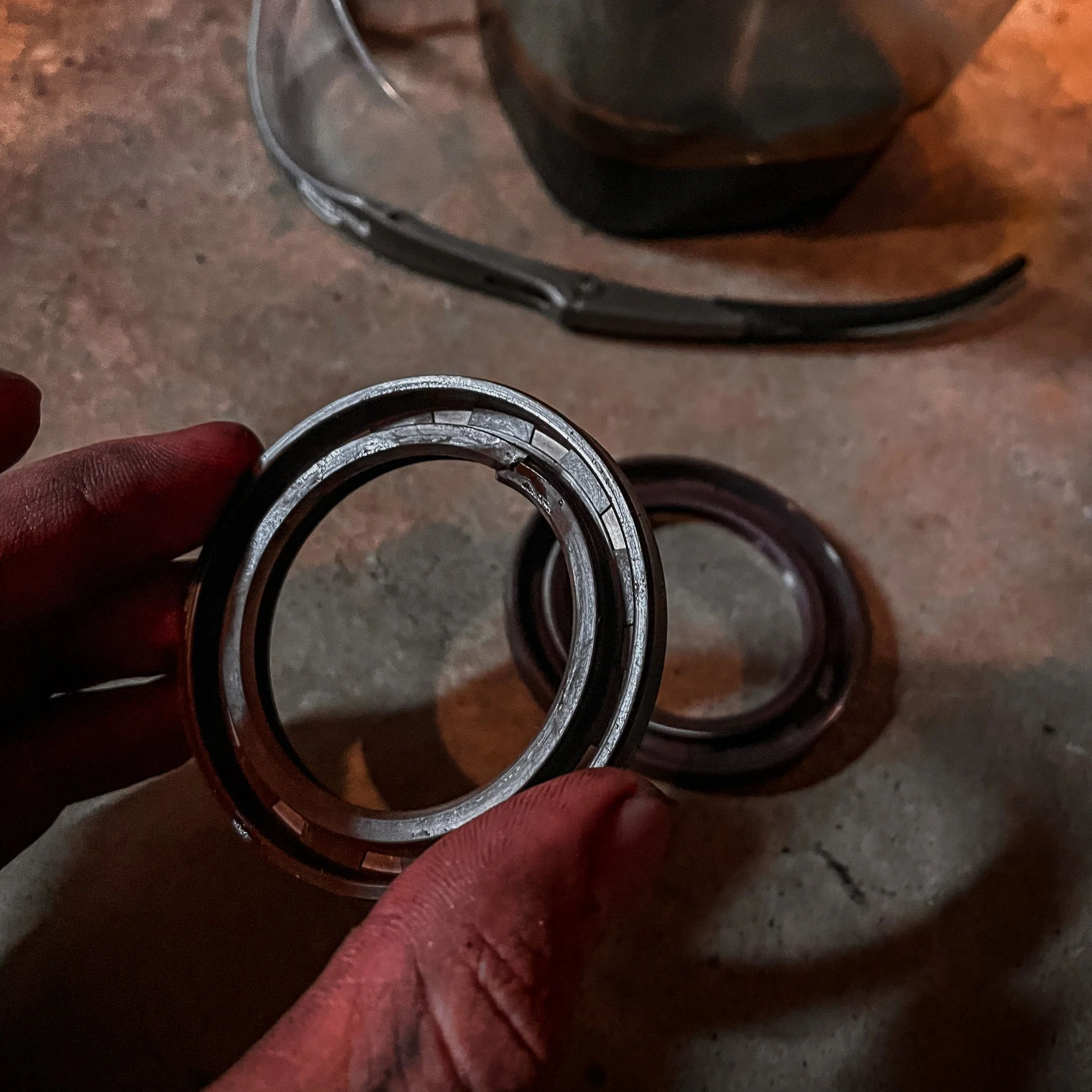

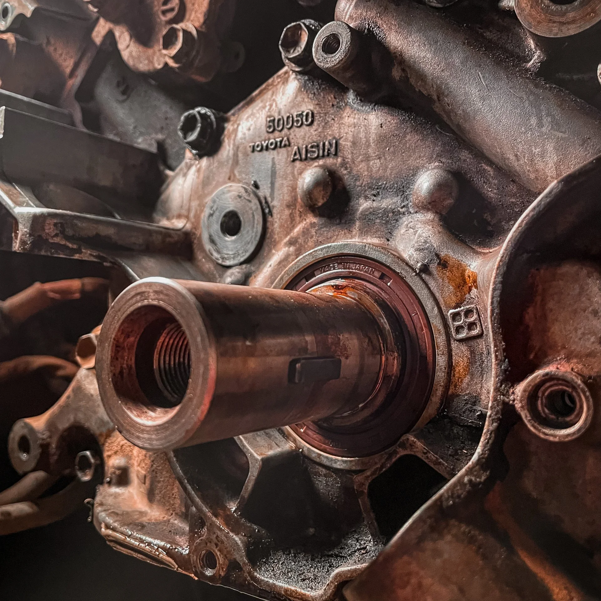

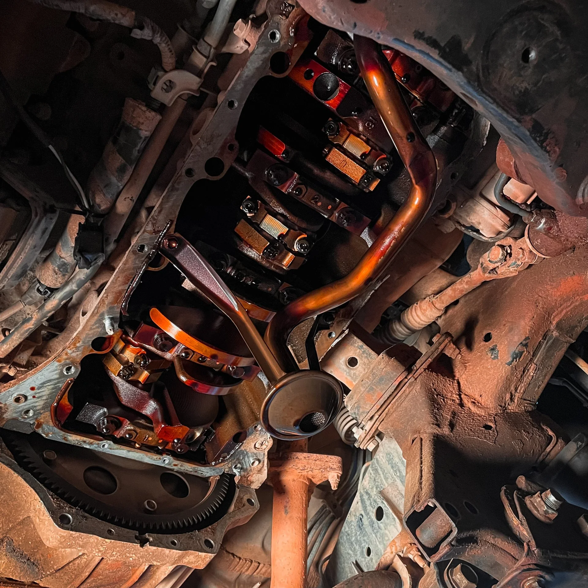

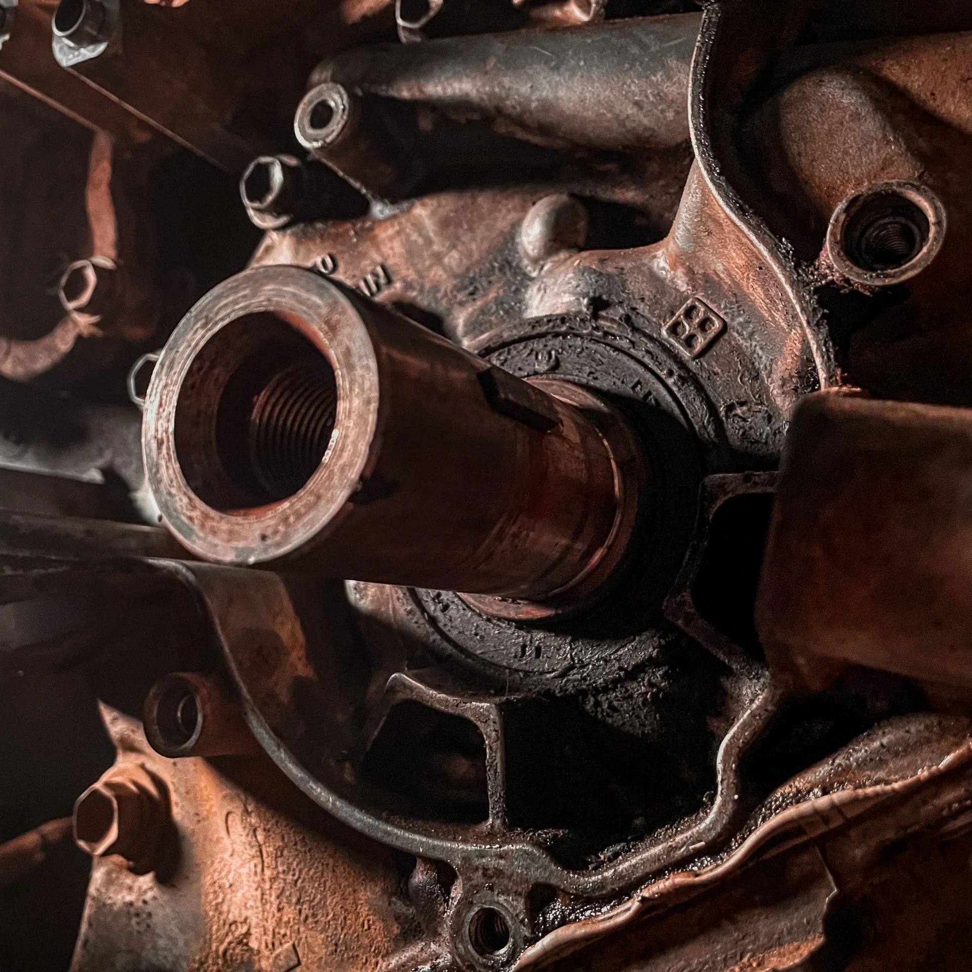

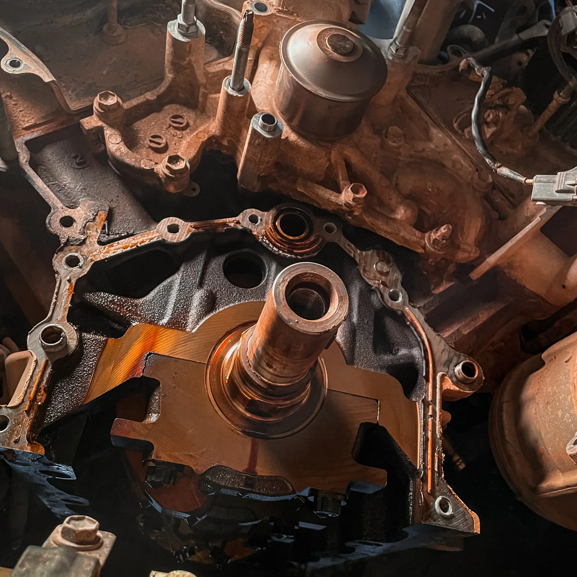

I finished the labor intensive part of fixing this oil leak. But i have a long way to go…

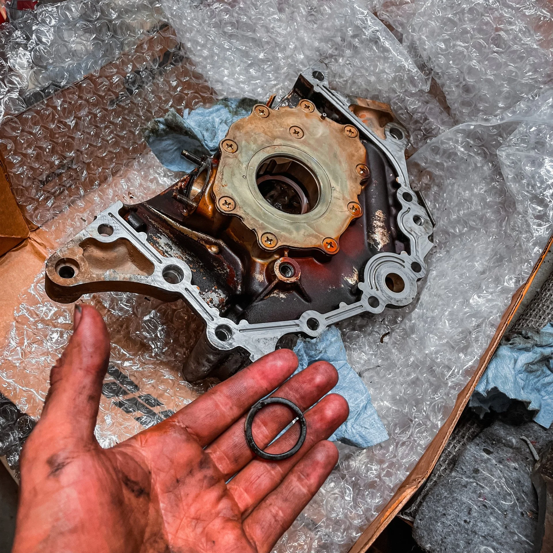

There’s an o-ring behind the oil pump on the block that over time shrivels or cracks, letting oil seep past it. The symptoms for me were oil drips forming on the oil pan and draining out of the wheep hole on the crank timing cover.
Here are the steps in this repair ($4 for the o-ring)
1. remove front diff and crossmember
2. remove timing belt
3. disconnect AC compressor from block
4. remove crank pulley
4a. remove oil cooler and dipstick

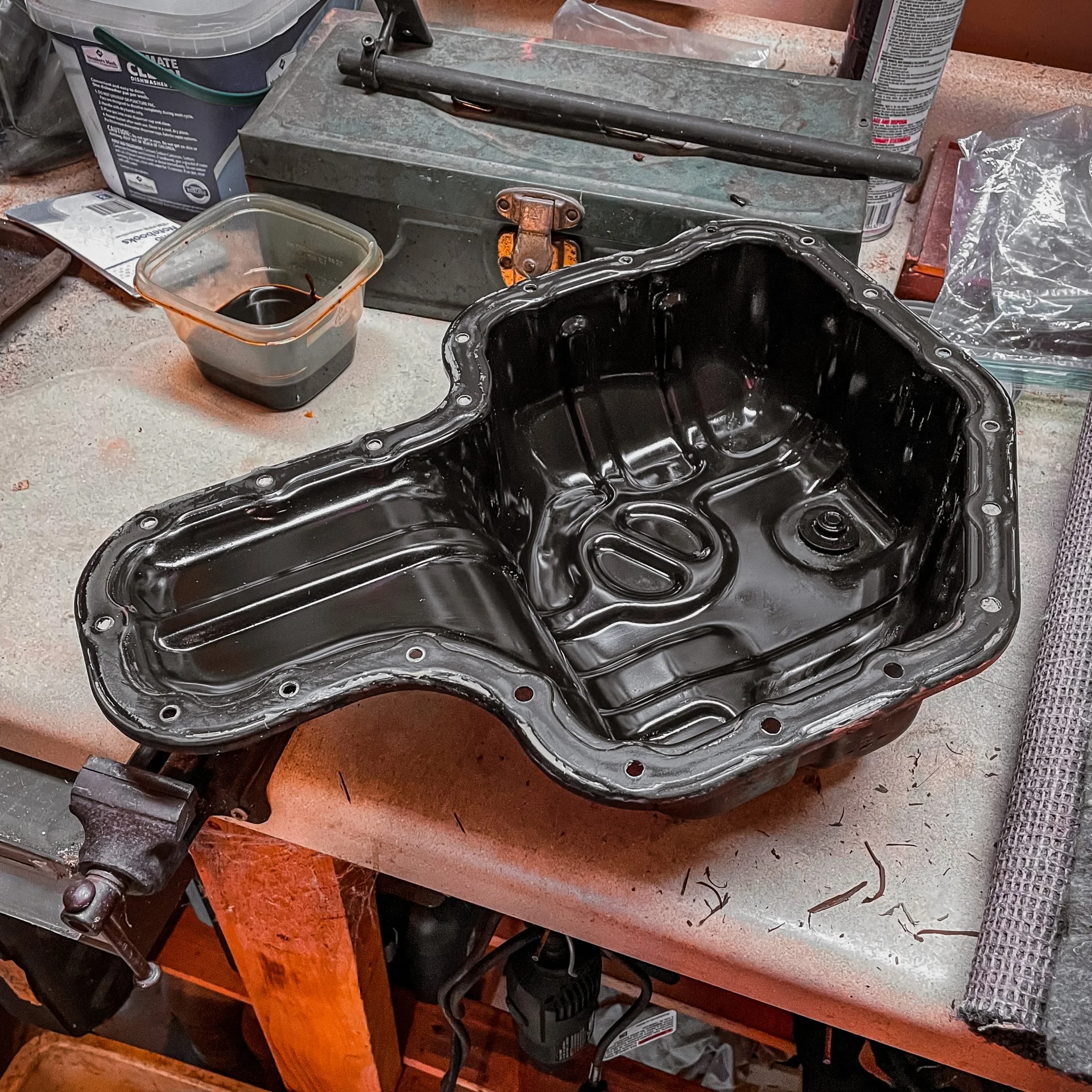

5. remove no.1 and no. 2 oil pans (fipg)
6. remove oil slinger (gasket)
7. remove oil pump (fipg and o-ring)
8. replace o-ring, reinstall oil pump, install new crank seal
9. reverse process
Just curious, is this job also done by pulling the engine?
Nice work Patch- I’ve heard of oil pump o-ring R&R with out removing engine- but haven’t known anyone directly doing it- we’re you able to keep the gasket surface clean of dripping oil long enough to reseal effectively?

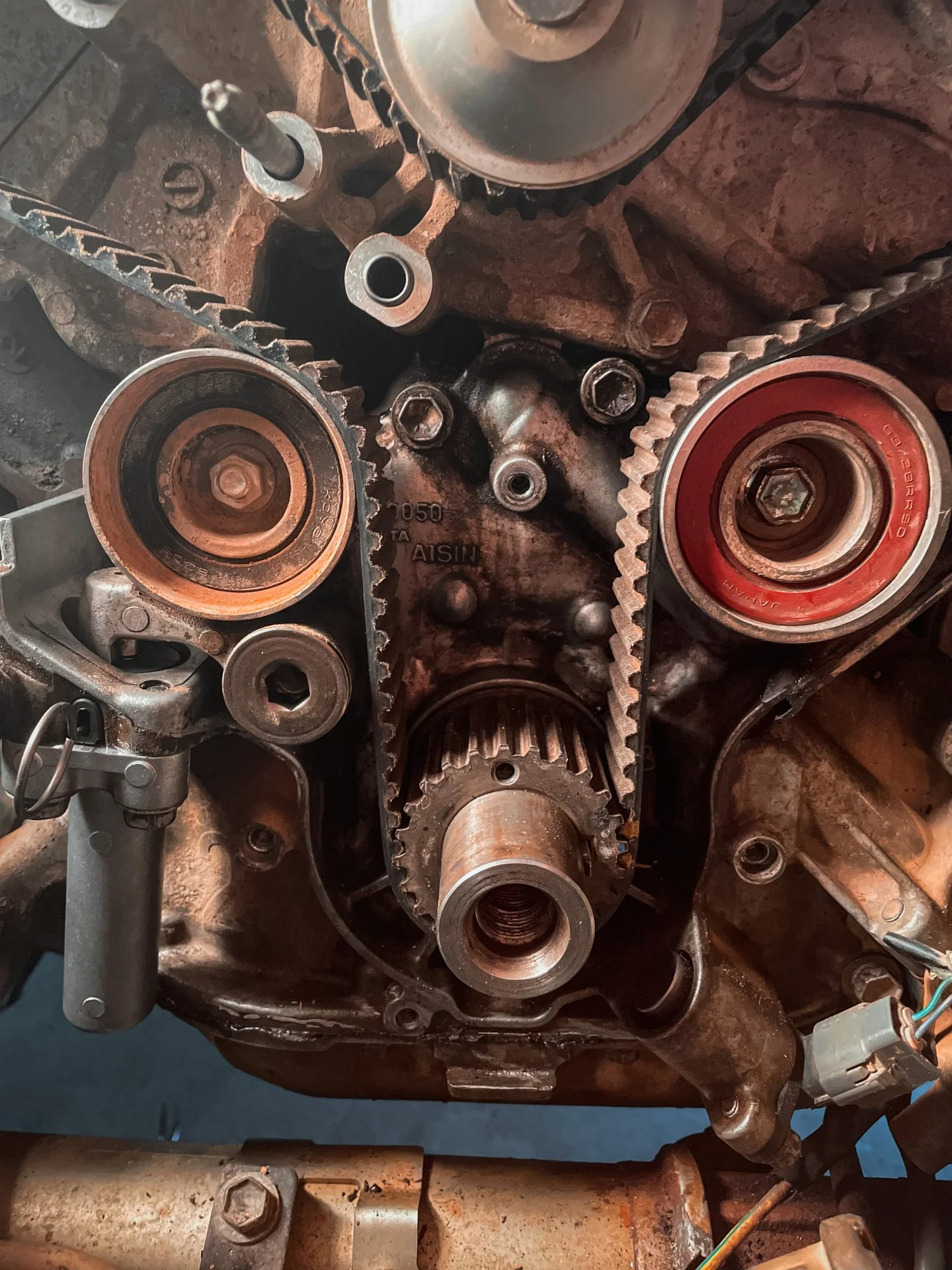

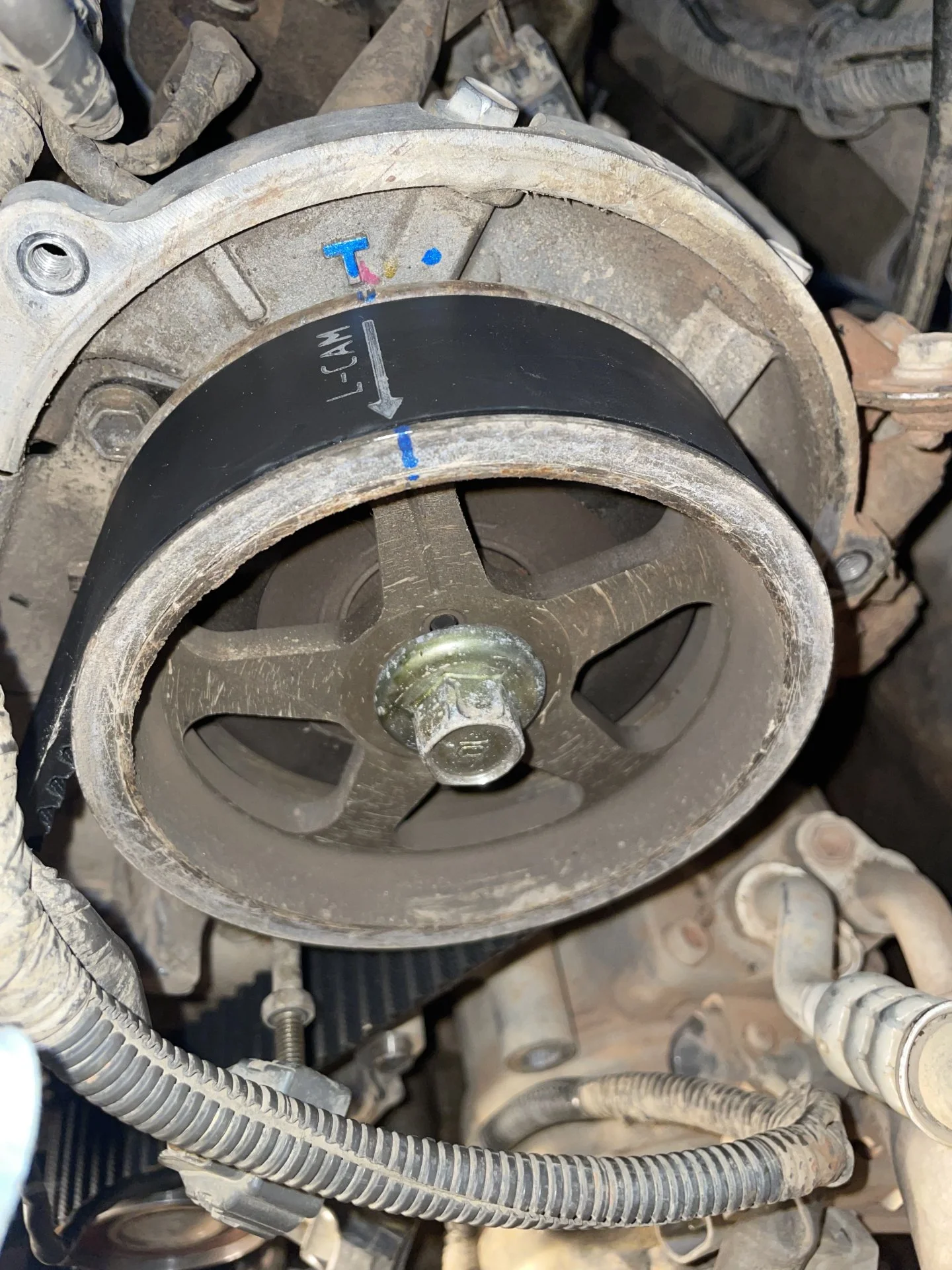

Looks like you brought a fair amount of Utah home with you- mud clay dust into your timing belt area. I would be a little concerned by the amount of dirt and grime on the timing belt and pulleys- concerned for longevity of the belt, pulleys. bearings under those conditions. While you have it apart- you might consider thoroughly cleaning that area, and replace the belt.
Did you guys get it figured out?
@2001LC

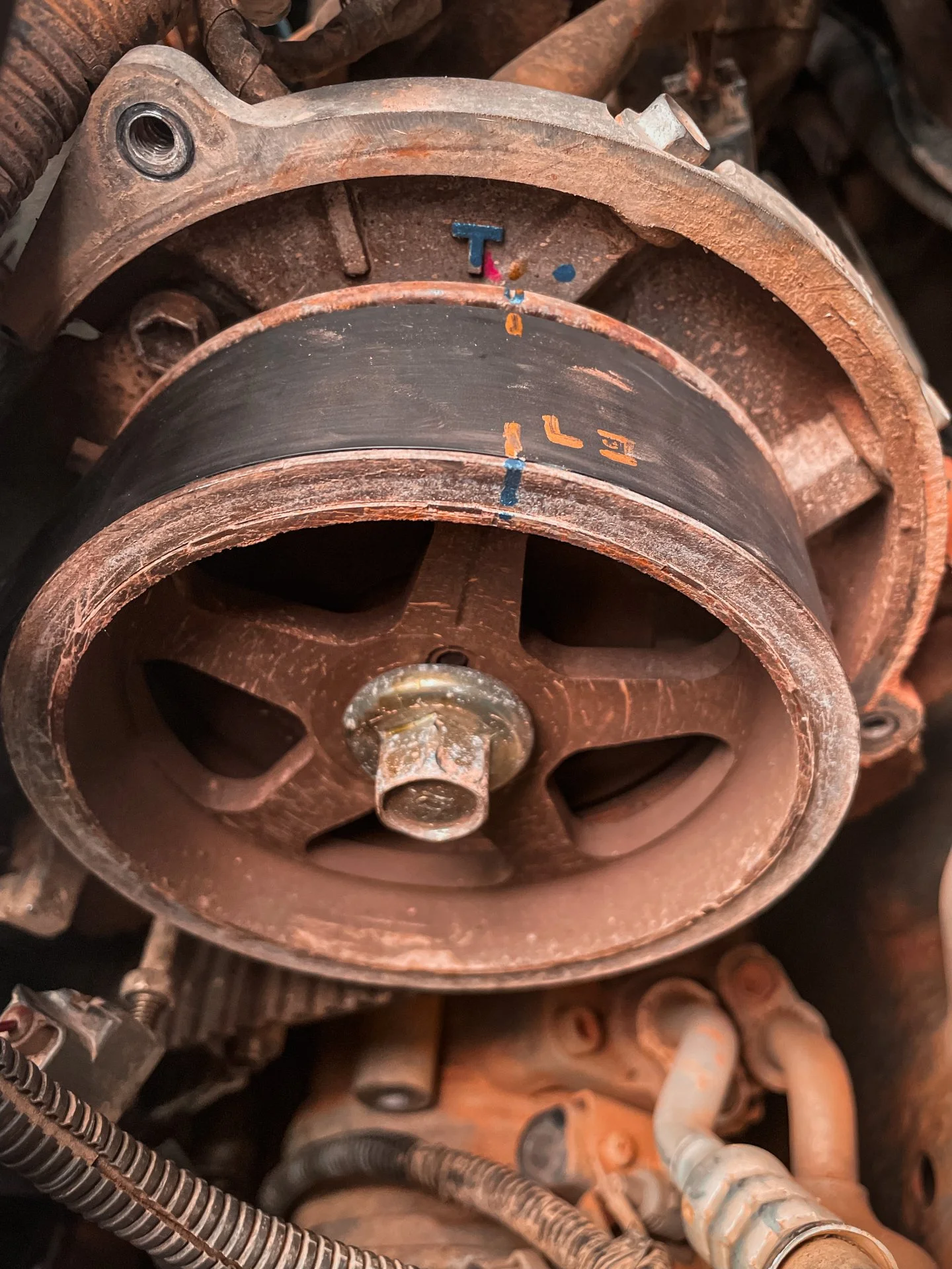

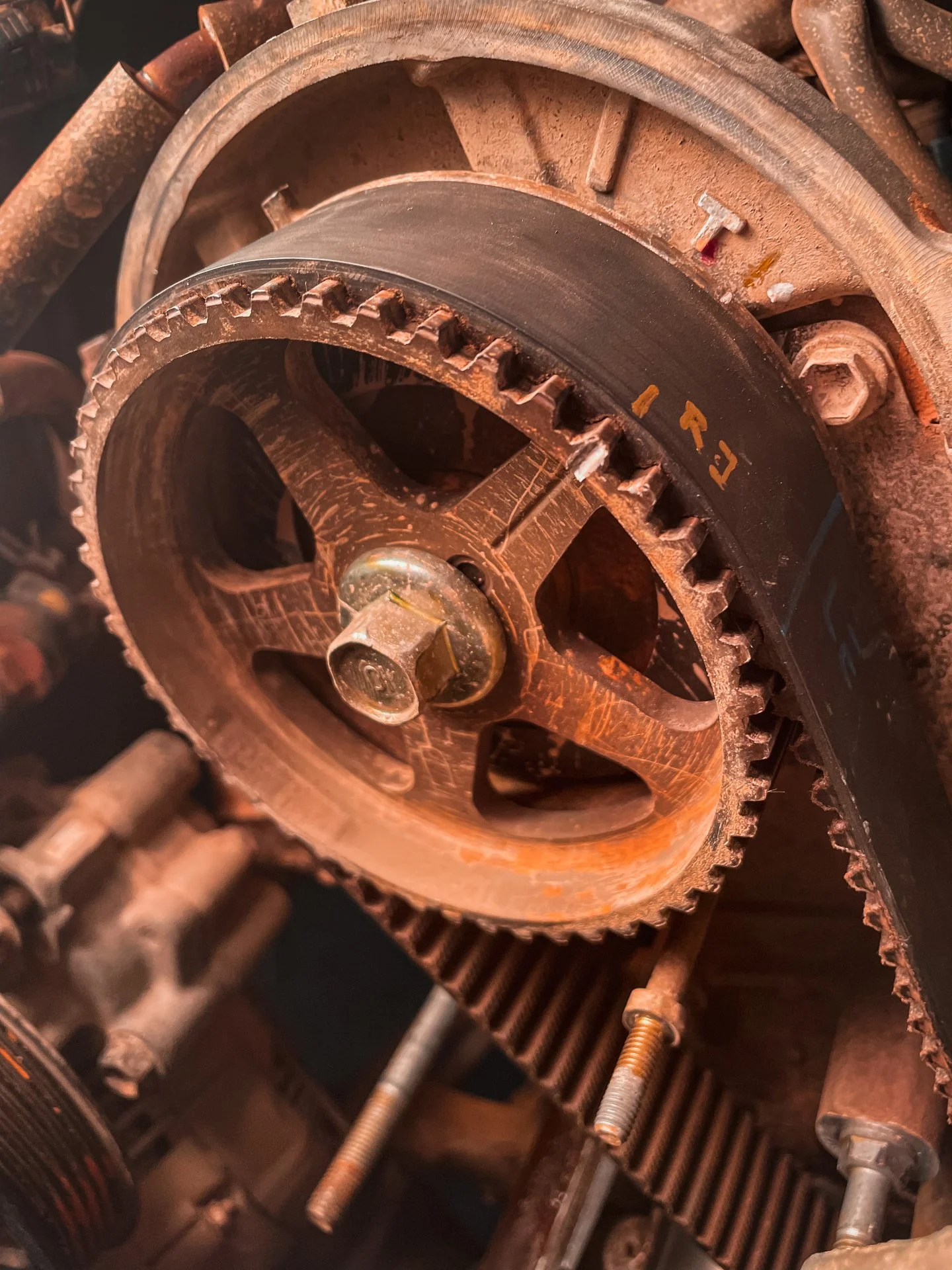

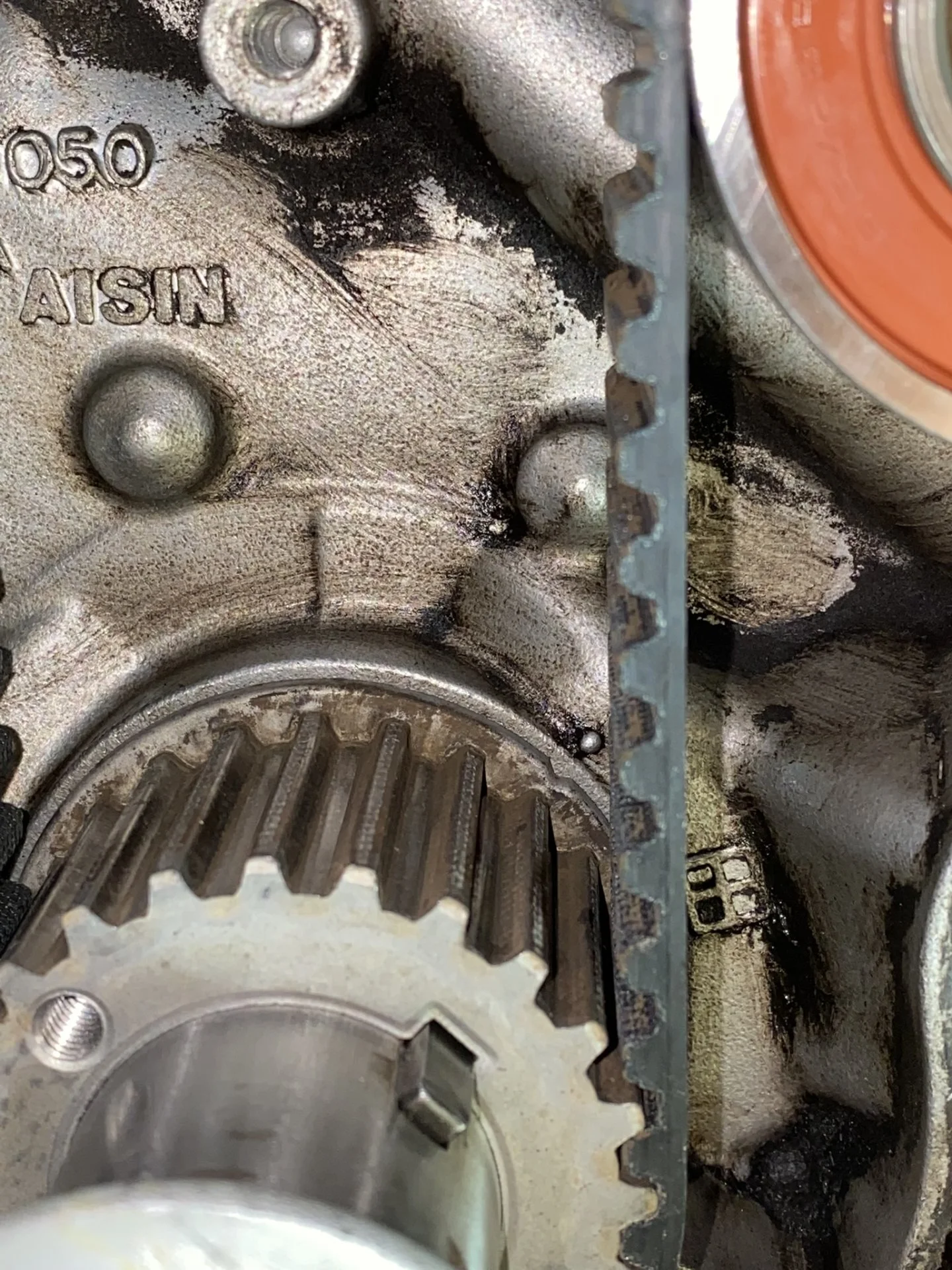

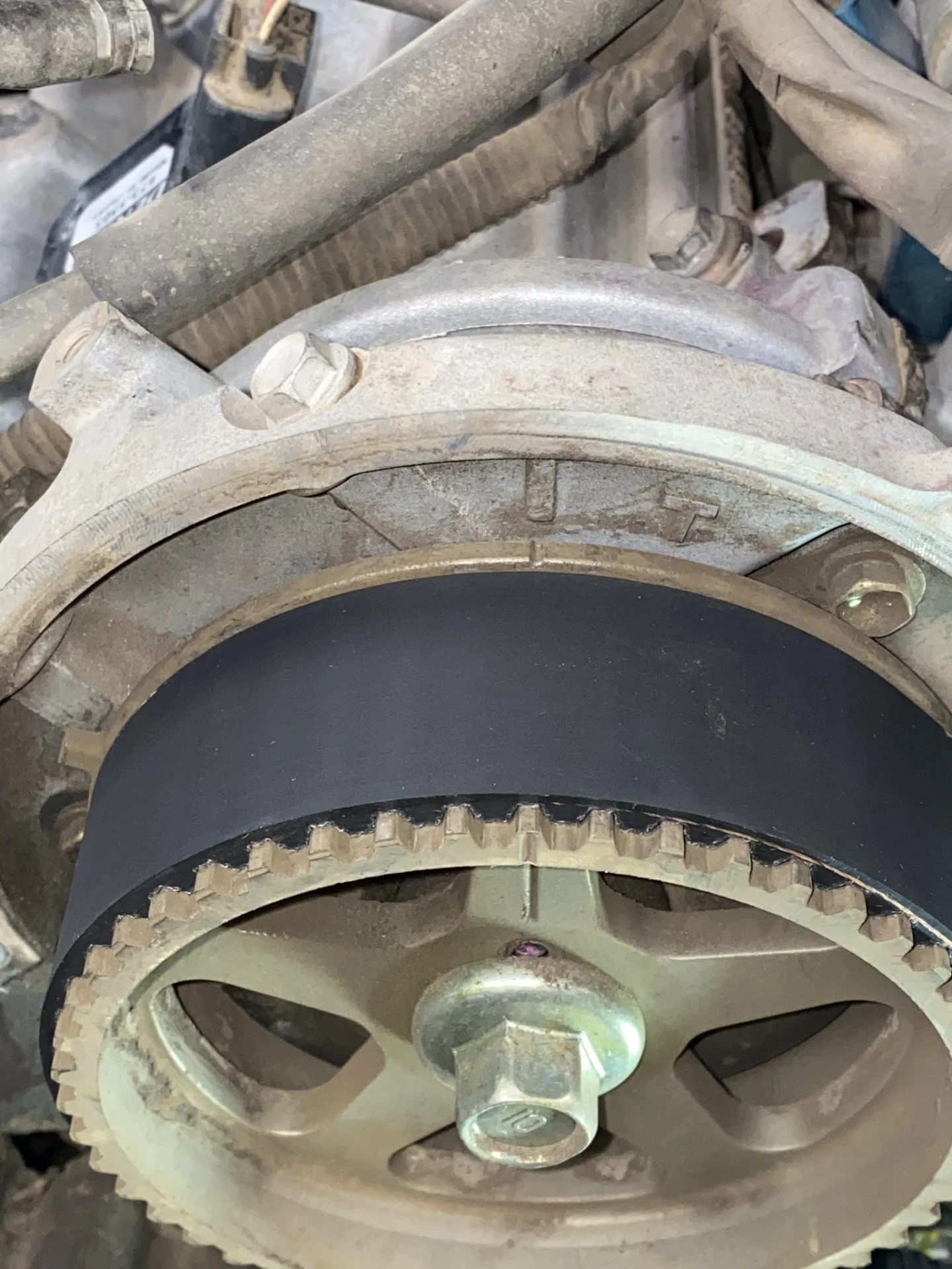

I replaced the tensioner twice thinking I had a bad one. I’ve done four or five of these TB jobs before and made sure to replace the washer behind tensioner pulley. I knew that was not the issue.
Yesterday I decided to spend the $60 on a new belt just for the helluvit. Sure enough, my AISIN belt with 15K miles on it shrank so much that it did not have enough slack for the tensioner piston to extend at all. Crazy!
New belt fixed the problem.

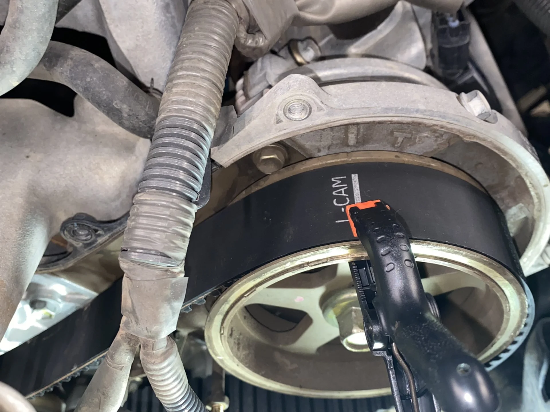

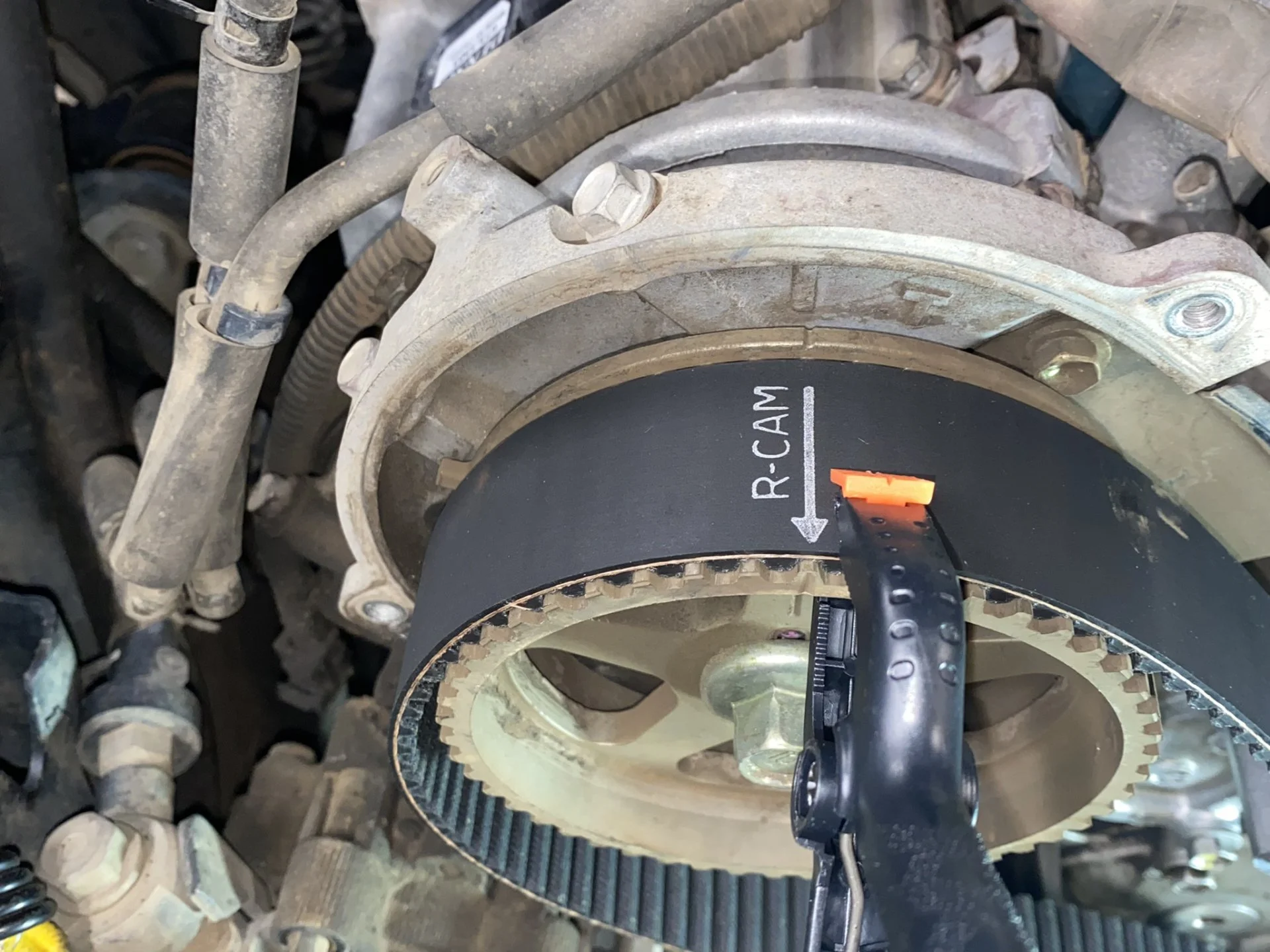

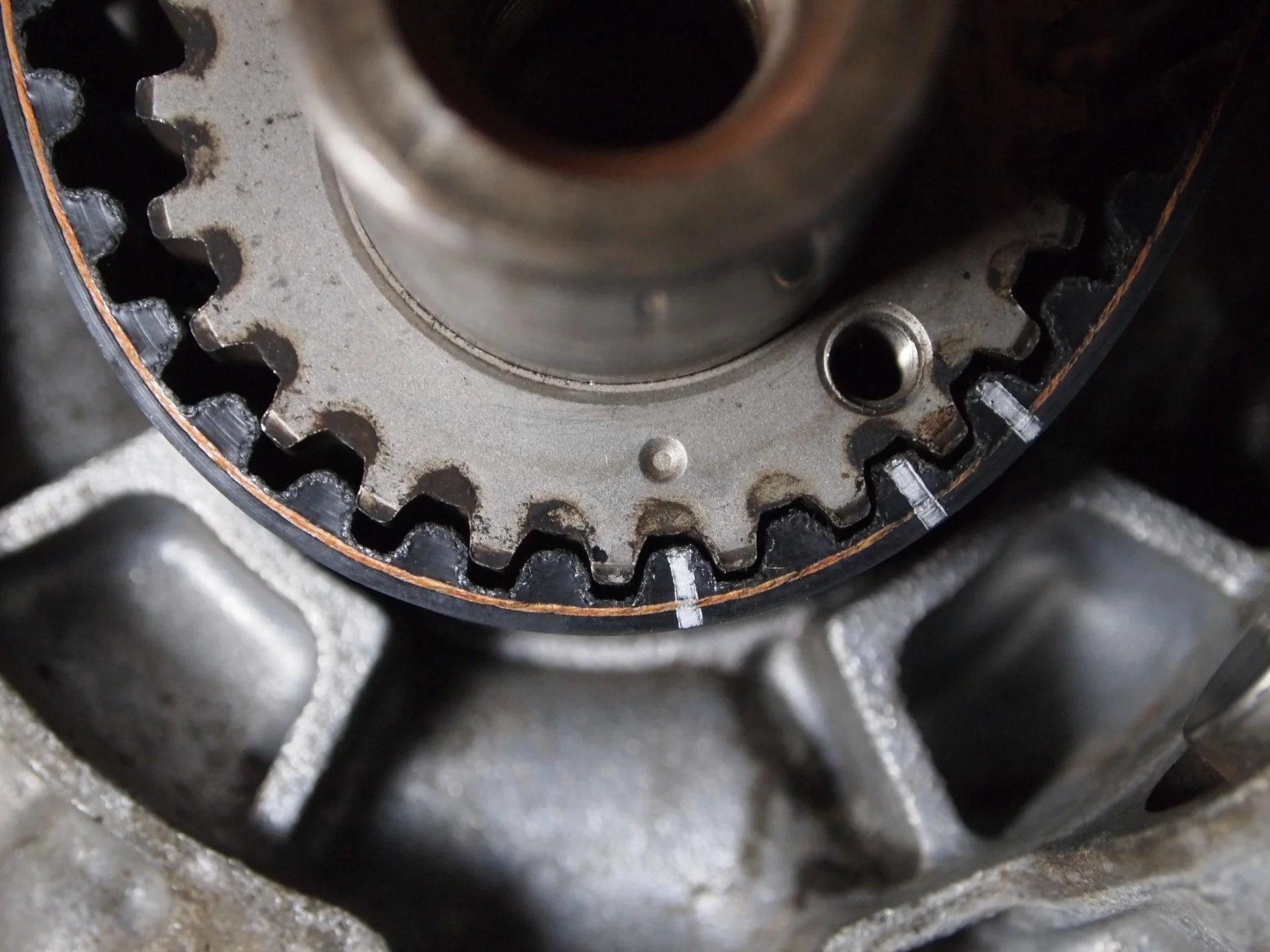

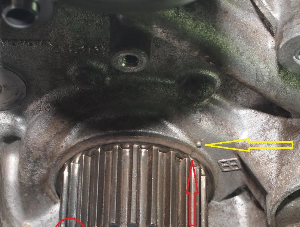

I use the ‘T’ marks during service/R&R, then check timing with ‘|’ marks and TDC ‘0’ on timing cover. Everything is perfectly in time
So since you're sure you had belt, pulleys, washer and tensioner on correct. You must have had bad/wrong belt on. Likely a China made knock-off, and not noticed it 15K ago during install.
Note: Testing the tensioner, it takes up to 2,205 lbf of pressure to fully compress push rod, to get in the pin.
I bought the previous OEM belt from Cruiser Outfitters so chances of it being a chinese knock off are slim to none.
I still don’t understand it, quite honestly, but it was too tight (allowed for no movement of the tensioner pulley) when I slipped it back on.
I bought an OEM replacement and it fit perfectly, allowing the tensioner pulley to rotate with enough slack in the belt that the tensioner actually engaged.
I trust your experience more than most online, and I’m telling you I agree that there’s no way this happened but it happened somehow
I believe rubber shrinks in heat which would explain a slight shrinkage, but that’s the only theory I have come up with…
Well that is strange! Did you match up length, of old belt and new?I bought the previous OEM belt from Cruiser Outfitters so chances of it being a chinese knock off are slim to none.

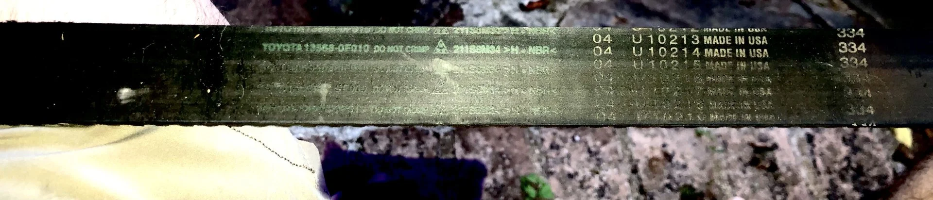

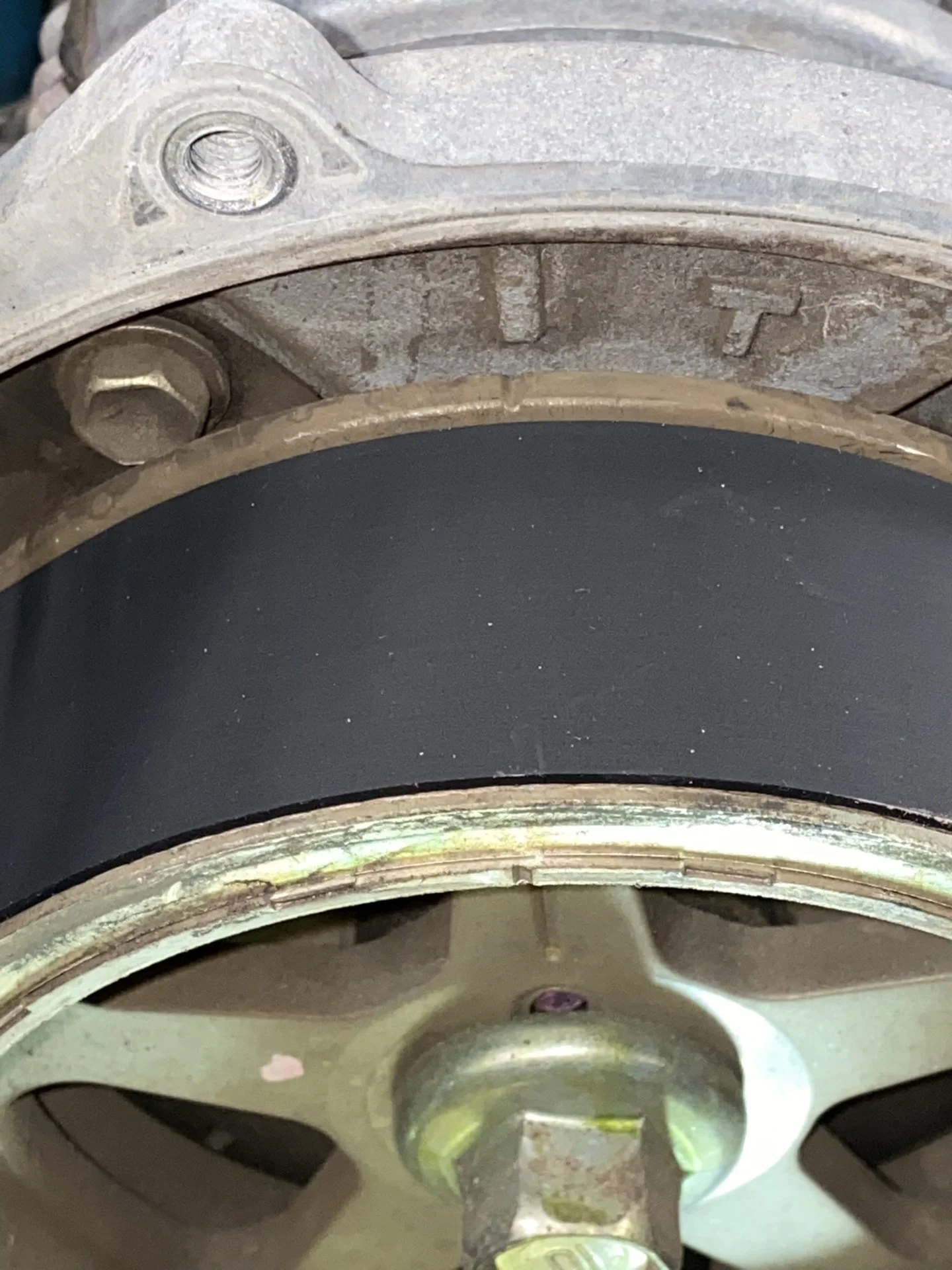

Any pics of the logo on the belt?
forum.ih8mud.com
If still available buy the OEM parts, then source used if necessary-
As for the belt- it would be odd that the printing had worn off in just 15k miles- here’s a belt with 90,000 +miles 10yrs
