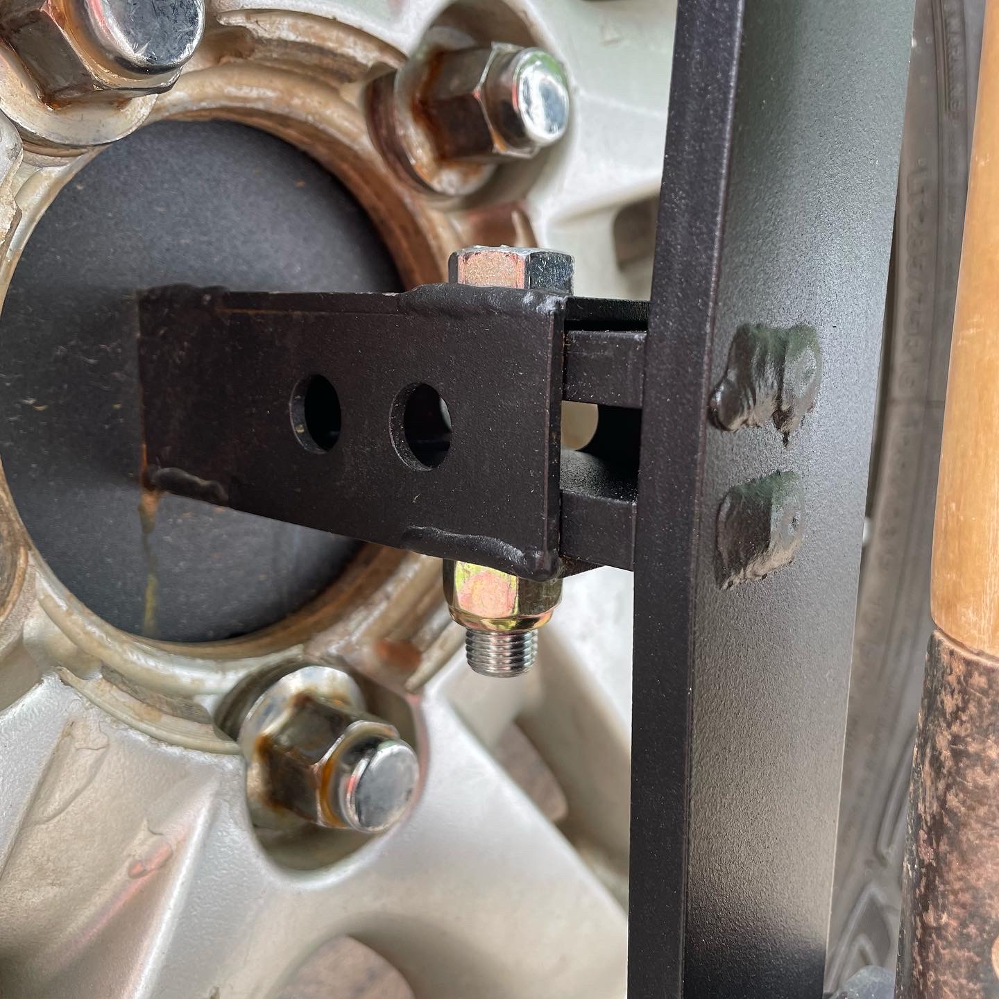

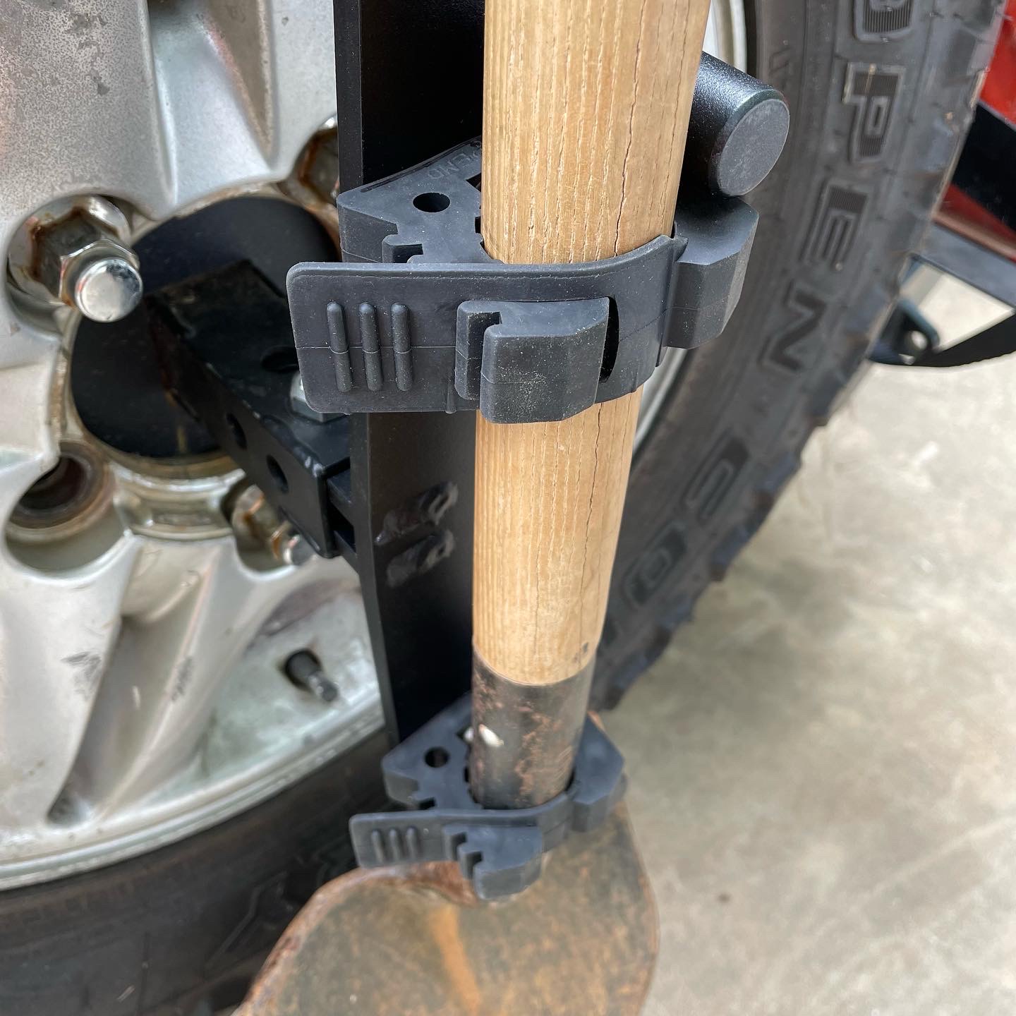

Today’s task was simple: build a shovel mount for the spare tire carrier accessory receiver.
I bought a liquidated Bomber Products tire carrier accessory mount for $5 on ebay a while ago. It was intended to be used with traction boards but I don’t use them.
I drilled some holes and mounted two quick fists (two pack for $10 on amazon) on the mount.
I’ll switch the lock nut and bolt out for a cotter pin more than likely for ease of access to the spare tire.
Judging by the sloppiness of the welds, I can see why Bomber went out of business.

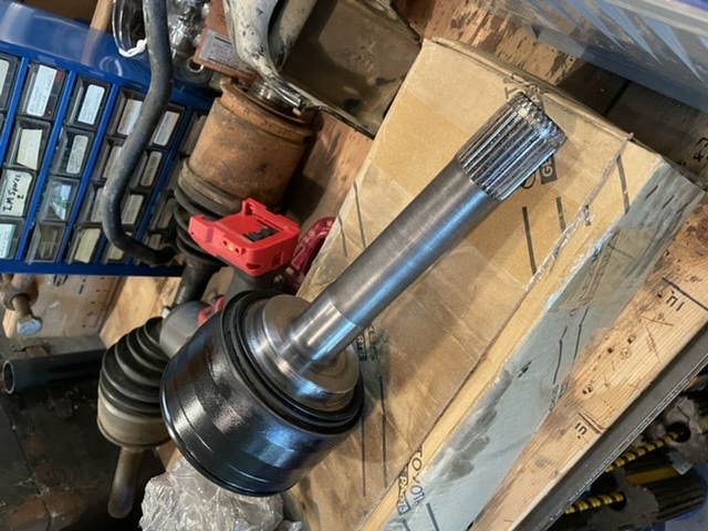

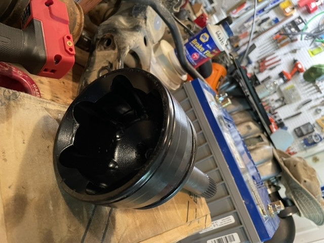

Something I’ve been working on recently is preparation for the inevitable front differential explosion. There’s a lot of mud here in Georgia and I just replaced my CVs and my bearings.
I would like to be absolutely certain that I do not contaminate my hubs upon exiting the trail after a failure.
The solutions I have seen all involve removal of the snap ring and flanges from the hub. If the inside of the hub is not sealed by the snap ring holding the CV in place, dirt could enter the hub from the back.
I used an old CV axle I had lying around and cut out the outboard tulip so that it is free from the inboard section of the axle. The idea, assuming the balance is not thrown off for highway driving, would be to remove the front driveshaft and quickly exchange the new CVs for my “2WD outboard CVs.”
I will test my theory somehow or another before committing to it on a trail, but the logic, at least to me, seems sound.
This solution would certainly save time on the trail so that stranded 100s only have to swap axles and remove the driveshaft. The front diff will be blown anyway so it wouldn't bother me if it became contaminated.

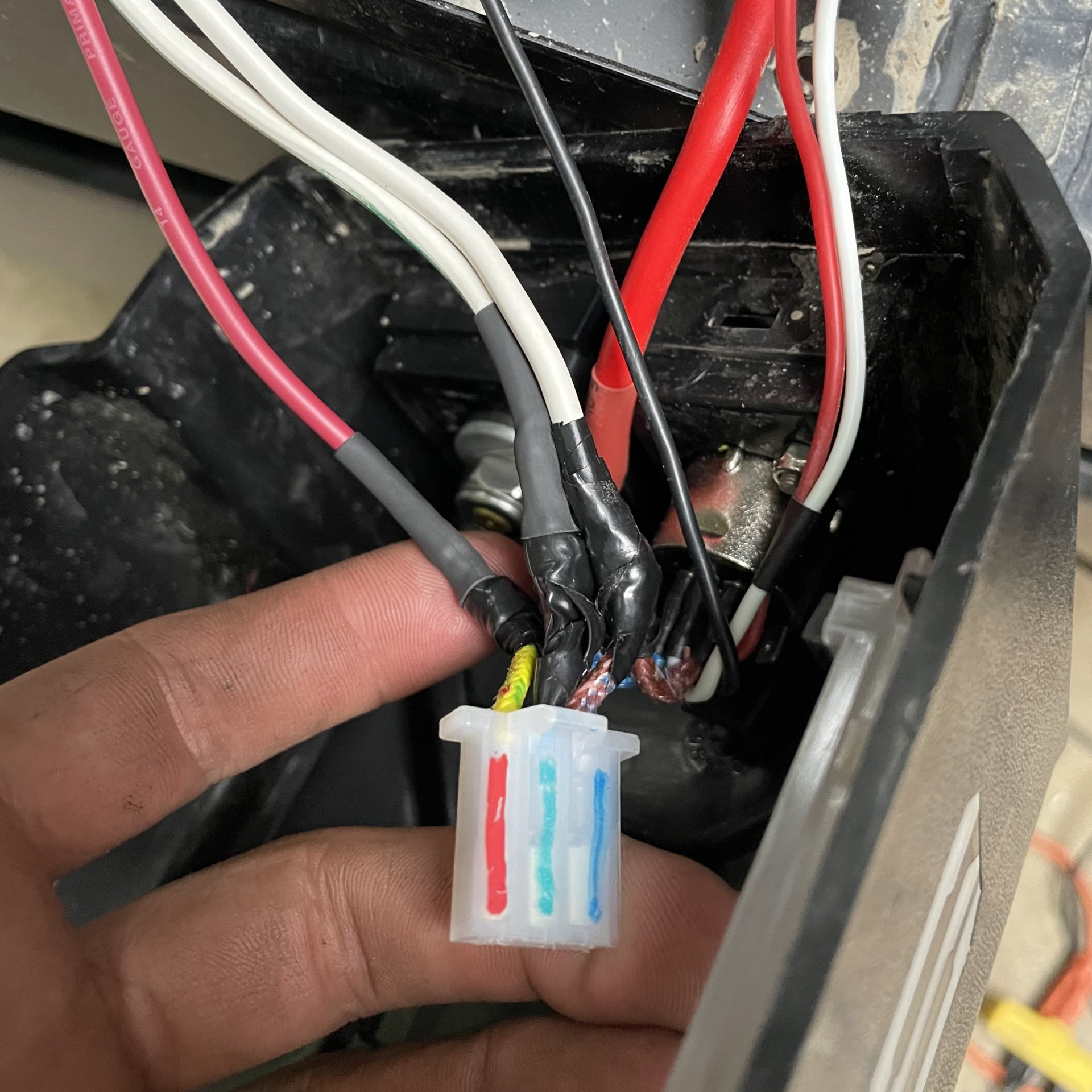

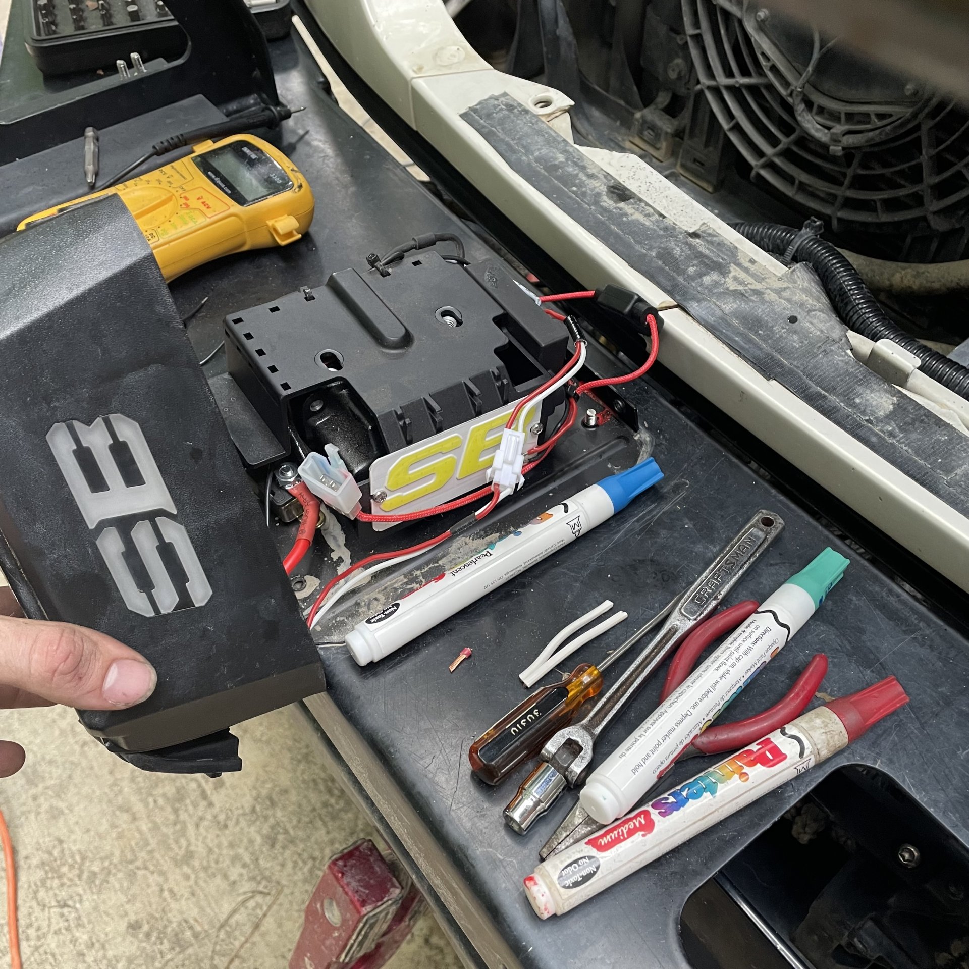

In hindsight I should have started by opening the control box but I decided it would be fun to short out some wires and see what happens. I blew the 3A fuse inside the control box. Oh well. Could have been worse.
Once I had finished dicking around I used my tools for their intended purposes (wow!). The control box is easy enough to open with a T20 star bit and some patience. There are four bolts that hold the cover on. Two short (rear) and two long (front).
Above: control box opened. See inline 3A fuse holder (ATM type, small blade) at rear.

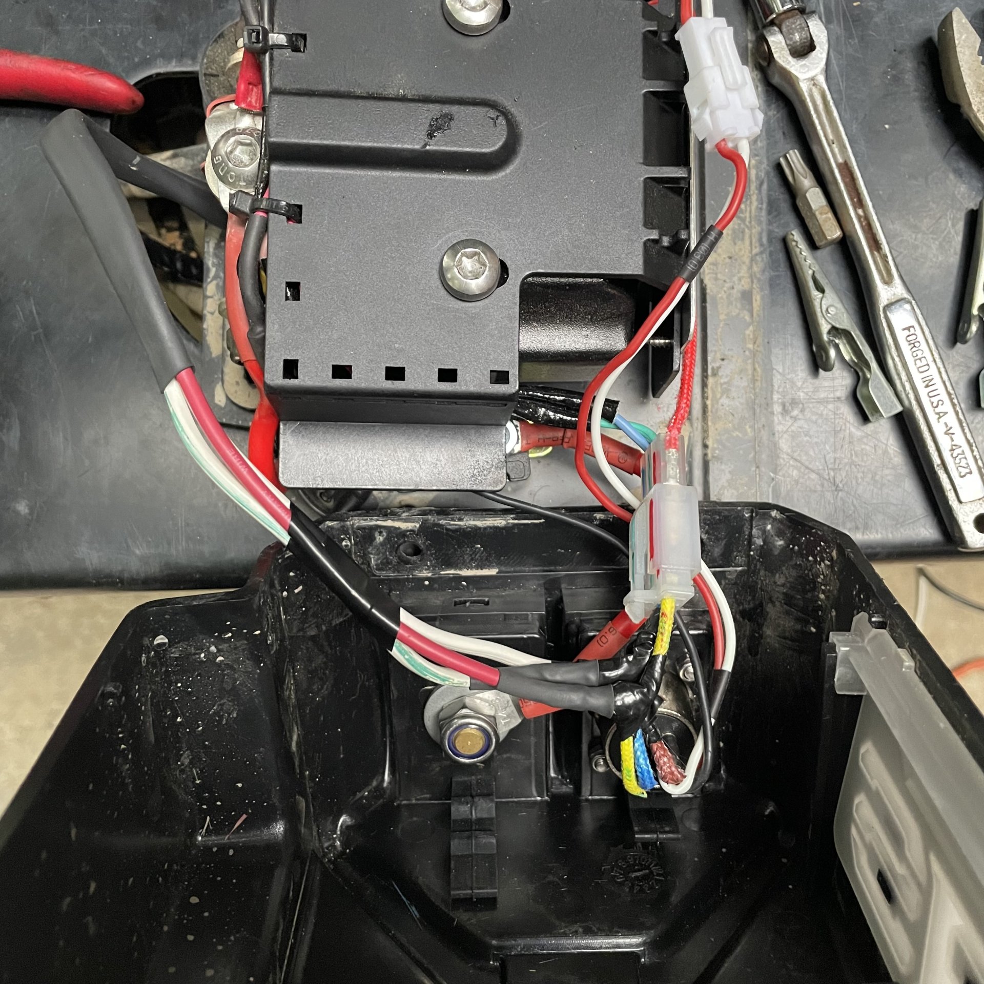

There are six total pins for the Smittybilt 12K XRC GEN3 winch handheld controller. The male XLR plugs into the female XLR connector on the control box. I drew a simple diagram of the pinouts both male and female.
Above: pinouts for male and female XLR connectors.
Table at bottom indicates wire colour for female (control box end) XLR connector. The colours change for no damn reason for three of the wires. You can see that I labeled where each wire lead terminated inside of the control box. I identified a "box" and a "sm. box." The "box" houses the solenoids for winch control and the "sm. box" houses the terminals that trigger the "SM" logo on the side of the winch when it is in use.
Here are the pinouts:
1: Black (blk) = ground (grnd)
2: Brown (brwn) = light blue = up/out
3: White (wht) = negative lead for "SM" logo light (7.5V)
4: Blue (blu) = green = down/in
5: Yellow (yllw) = red = 3A 12V positive lead for solenoid control
6: Red (rd) = positive lead for "SM" logo light (7.5V)
The transition between colours of pins 2, 4, and 5 happens with an opaque connector as pictured below. The female side of the opaque three-pin connector attaches to the female XLR connector mounted on the control box cover.
Above: opaque female connector for winch solenoid control wires (3x). In this photo I had already spliced my runs in.
I did not wind up using the "SM" logo light at all on my truck so I wound up leaving all of that mess untouched. Red and white small wires with white connector at top right in picture below are for the "SM" logo.
The important leads are 2, 4, and 5. These three are the wires you want to splice into with your run to the cabin.
From female XLR connector to the terminals on ASB100:
2: Brown (brwn) = light blue = solid white = terminal 5 on ASB100 = up/out
4: Blue (blu) = green = terminal 9 on ASB100 = down/in
5: Yellow (yllw) = red = terminals 4 and 10 on ASB100 = 3A 12V positive lead for solenoid control
Once I knew where everything was going I added some heat shrink to the three-wire run (red, solid white, green stripe) and routed it through the bottom of the winch control box as pictured:
Above: rat's nest
I soldered the three-wire run into the existing wire harness for increased durability and strength. Crimping here is not a good call, in my opinion. When you need a winch, you need a winch. It had better work.
The best part about this mod is that I can still use my handheld controller if I so desire. I have simply added an alternative solution for ease-of-use.

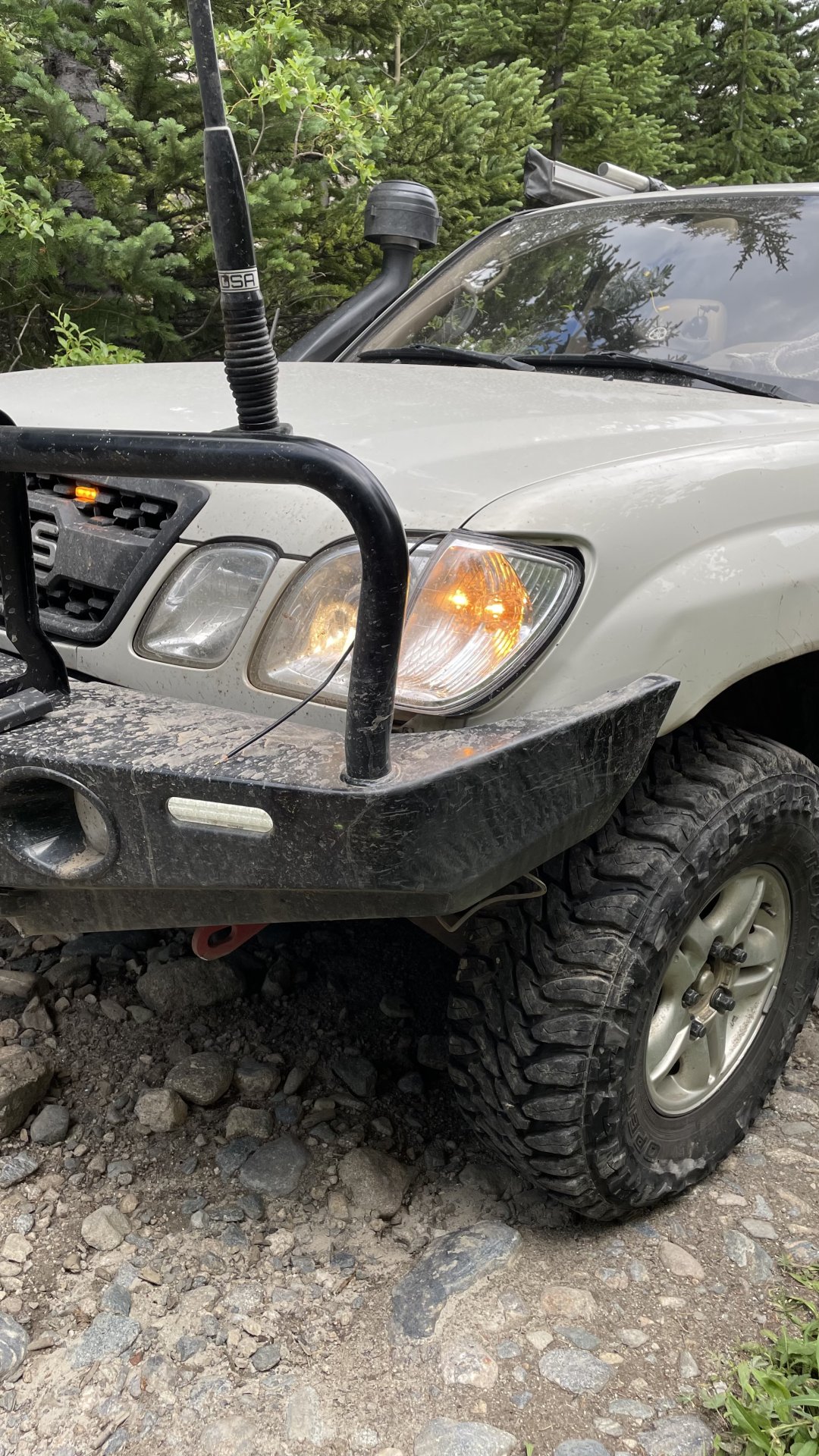

Some folks wanted to see this from the facebook groups so here’s a detailed look at the Ironman 4x4 front bumper for the 100 series
A few days ago I mentioned that my Ironman front bumper broke on an obstacle during my trip to Colorado.
Here’s a closer look at what happened so that you can prevent the same from happening to yours.
First three photos show the LHS of the bumper crumpling up above my fender. The RHS stayed underneath because the bumper actually fit under the fender (I complained to IM about a manufacturing defect - too big of a gap on the LHS - but honestly don’t care anymore, obviously).
The bumper hit the ledge and sheered two of the pinning bolts clean off. I wasn’t going fast, just a love tap. Notice the flex in the antenna, (photo 3).
Because only one side moved above the fender, the entire frame of the bumper bent under the load. In photo 4, you can see that the RHS is still flat with the bottom of the fender but the LHS is tilted forward about 15-20 degrees (notice the antenna and top of the bumper surface).
The final two photos show the multiplied damage (corner light displaced - it doesn’t really fit anymore, antenna cable ripped out, small fiberglass chunk missing (see photo 2 - it’s flying through the air).
As soon as you can, I recommend you drill out the holes for the through-bolts and add bigger hardware to prevent this from happening. I will be welding my bumper to the frame-mount (not to the frame) so that it all works as one piece. I’m tired of adjusting it after every outing.

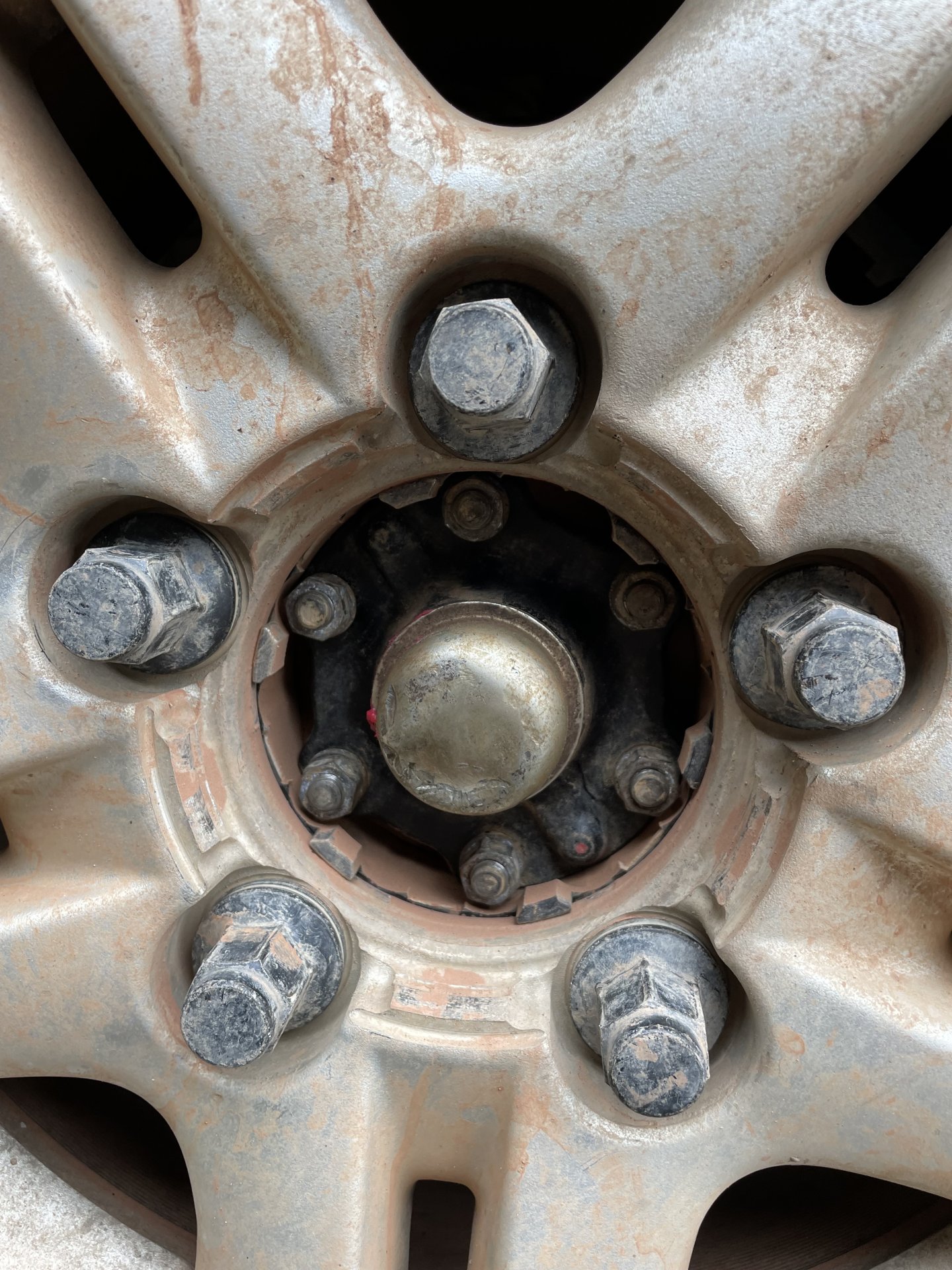

Here's an addition/update to a previous post about an emergency 2WD conversion when the front differential explodes on a trail.
As some of you may know, I blew my '99 2-pinion front diff on Poughkeepsie in Colorado this summer. I went with the traditional route of pulling the front driveshaft and the flanges. However, I noticed when I arrived home that my cv's were walking themselves out towards the diff away from the hub.
This created some potential for disaster as I just replaced my bearings etc, etc. If the back of the hub is exposed, water, dirt, and grime have the chance to enter from behind.
Previously I posted about some 'half axles' that I wanted to try out. (see post #22)
I am happy to report that this idea worked perfectly!
For those who may be forced to run 2WD for extended periods of time or for long road trips, I highly recommend finding some spare CV axles to chop up, sealing the hub from the back.
Ben's 3D builds makes a pair of emergency plastic covers in the event that the front diff goes out, but this method does not seal the rear.
The best part of this solution is that the user need not remove the flanges for it to work. Even better, one can completely remove the front differential assembly and still use the vehicle while it is being repaired or replaced.
For the diff-side, I threw in-board side of the axle into the diff to seal it from the elements until I can remove the diff assembly.
Notice below, the flanges are still in place.
On a trail, the driver needs to decide what the best way forward will be, but I would say that pulling the CV axles alone and replace them with half-axles might be easier than pulling the flanges. Disconnect the UBJ and TRE for enough flex and you're home free.
It might be safer to pull the flanges, however, so take this into account when on unstable ground.
