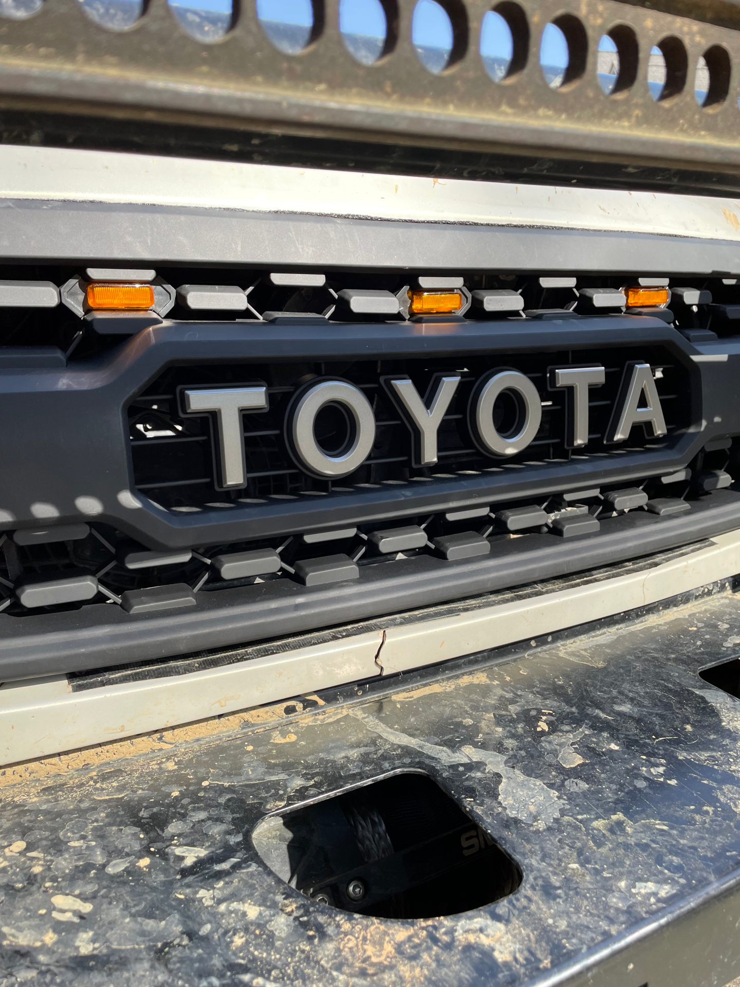

First up, Garage Alpha's new LX470 grille. Does not work with LC100
Full disclosure, I was sent this kit for free from Matt, the owner of OffRoad [GX/Prado/T4R] - https://garagealpha.com/collections/offroad
Kit was packaged in individual boxes for each component each with bubble wrap/equivalent for protection.
The pieces are made of fairly standard plastic and painted with a matte finish. The new grille feels more flimsy than the old but it gains strength when mounted with the metal brackets.
The old grille is mounted with a metal bracket which utilizes small metal fasteners to secure it in place. The kit did not include new hardware to mount the new plastic grille. I found it easier to remove the entire grille including all the 10mm bolts holding the metal bracket to the hood.
I used some miscellaneous screws I had lying around to fasten the grille to the metal bracket. The OEM fasteners are far too short for the 98-02 grille bracket. I get the impression that this new piece was designed for the late 2002 - 2005 LX470 exclusively but I made it work nonetheless.

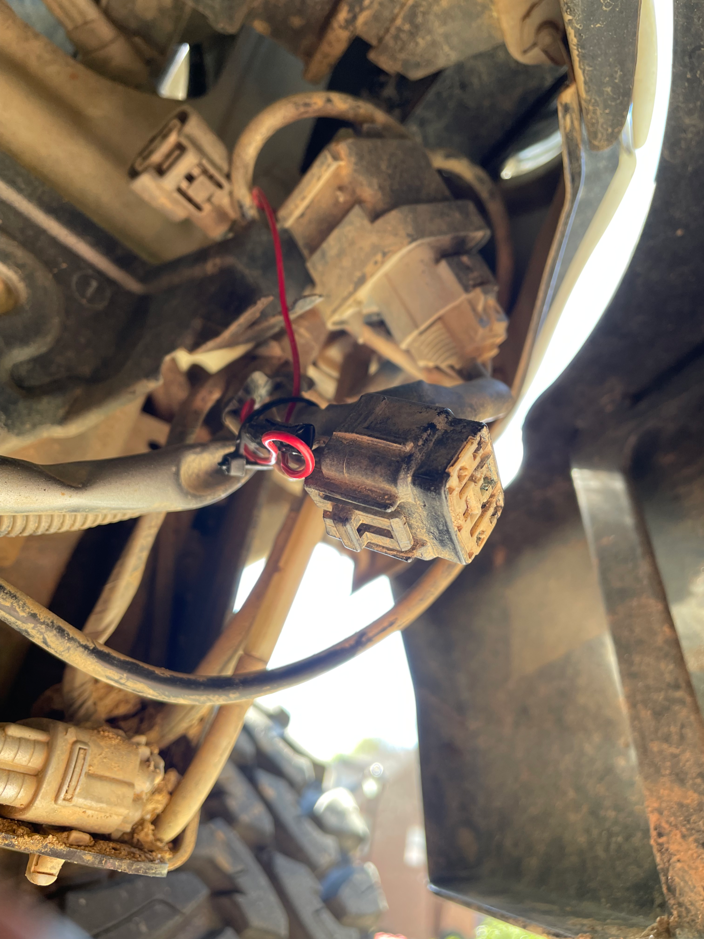

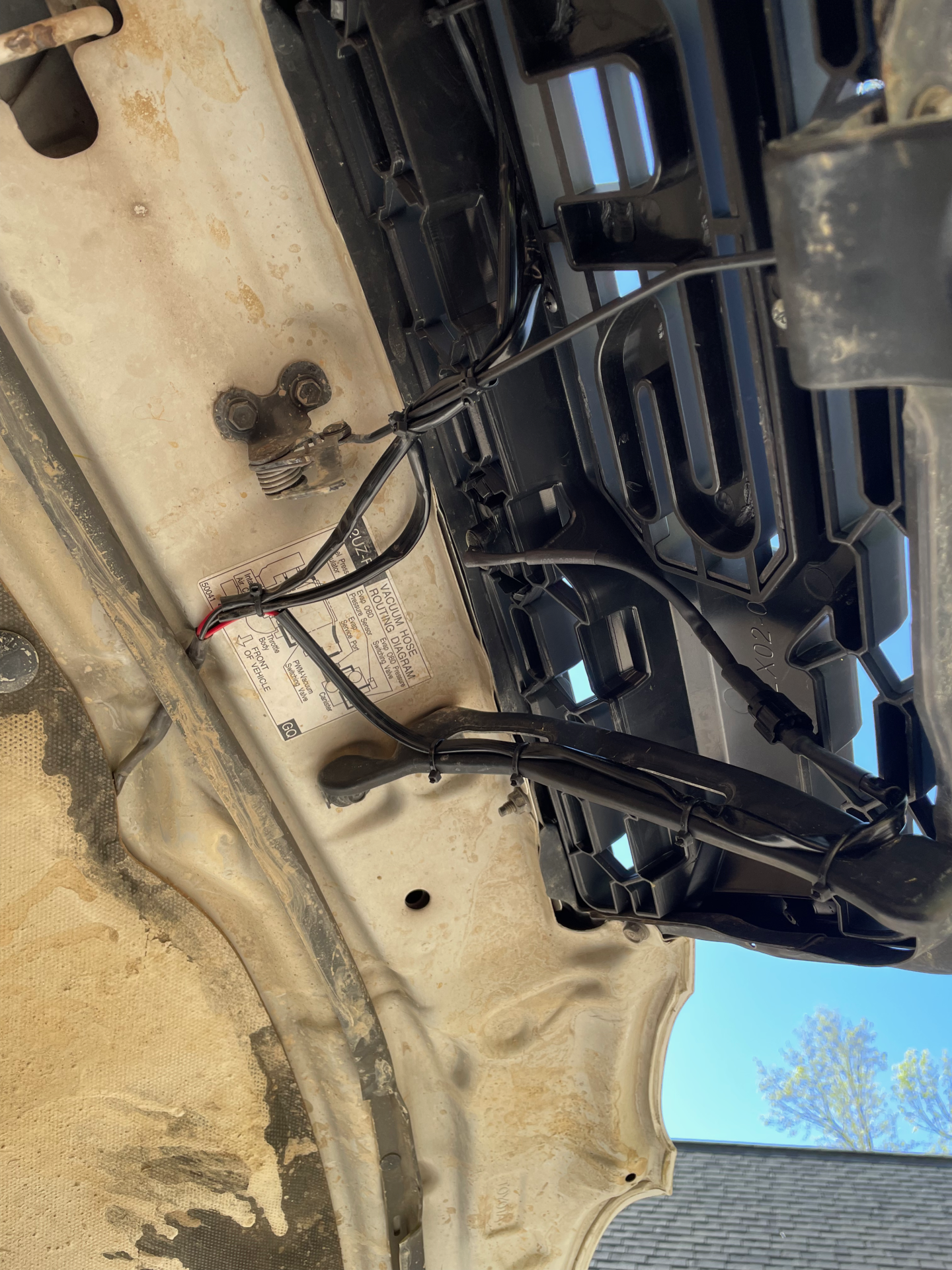

A wiring harness is supplied if you chose to include raptor lights in your order. The lights come with plastic brackets that snap very satisfyingly into the frame of the new piece. The nameplate is exchangeable with alternative badges (e.g. TOYOTA or gold/silver LEXUS).
I wired the lights to a random connector I had lying around below the washer fluid bottle. It has constant power so I installed a cut-off switch in the locker switch blank.
I removed the contact from the connector since it was filled with mud and such. I cut off the contact and soldered the red wire directly to the white 12V source. I chose this instead of directly to the battery assuming that this source is fused somehow. s***'ll buff out.
Nameplate option (TOYOTA):
So basically the grille is an aesthetic choice but it certainly looks good in my opinion. This part is obviously subjective.
