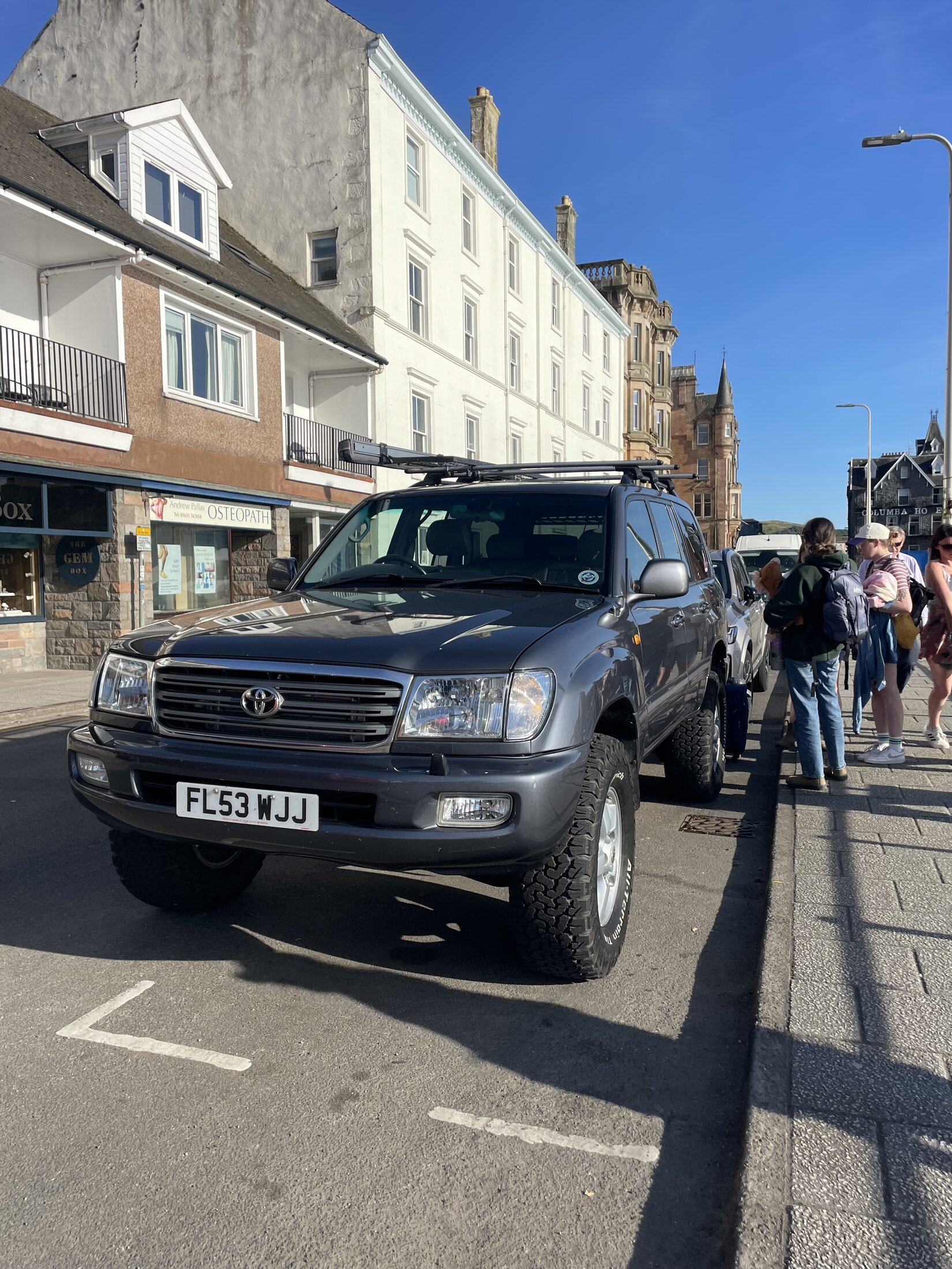

We're headed to Edinburgh, Glasgow, and many other spots I dare not attempt to pronounce. A pin-pal of mine, Paul has graciously offered up his 1HD-FTE powered HDJ101 to us while we explore the countryside. Who knows? Maybe I'll 2UZ swap his truck and pack up the 1HD in my carry-on 😂
Go check out his YouTube channel if you have a moment. Lots of good maintenance content and thick accents.
Gave him a sub :)
Party time! Gonna go test these on the rocks this weekend…
Did you spot any 105s?
When I was in AUS I was always trying to see under all the 100s if they were IFS or not. I only saw 1 while I was there, I think they are pretty sought after no matter where you are in the world.

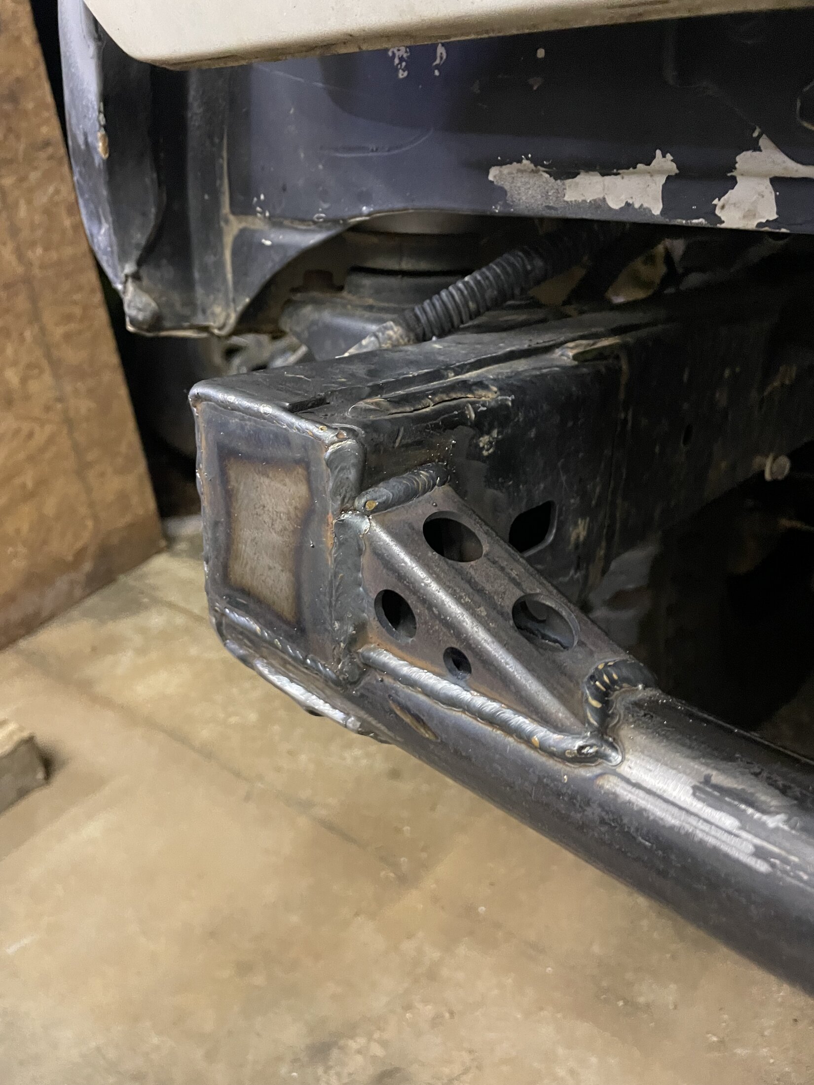

Center section complete with bling, high clearance (as high as you can get pretty much- short of cutting into the body and angling the frame but whatever)
Tested it on the rocks and it held the weight of the truck on a small rock. Pretty solid.
Grinder and paint…
