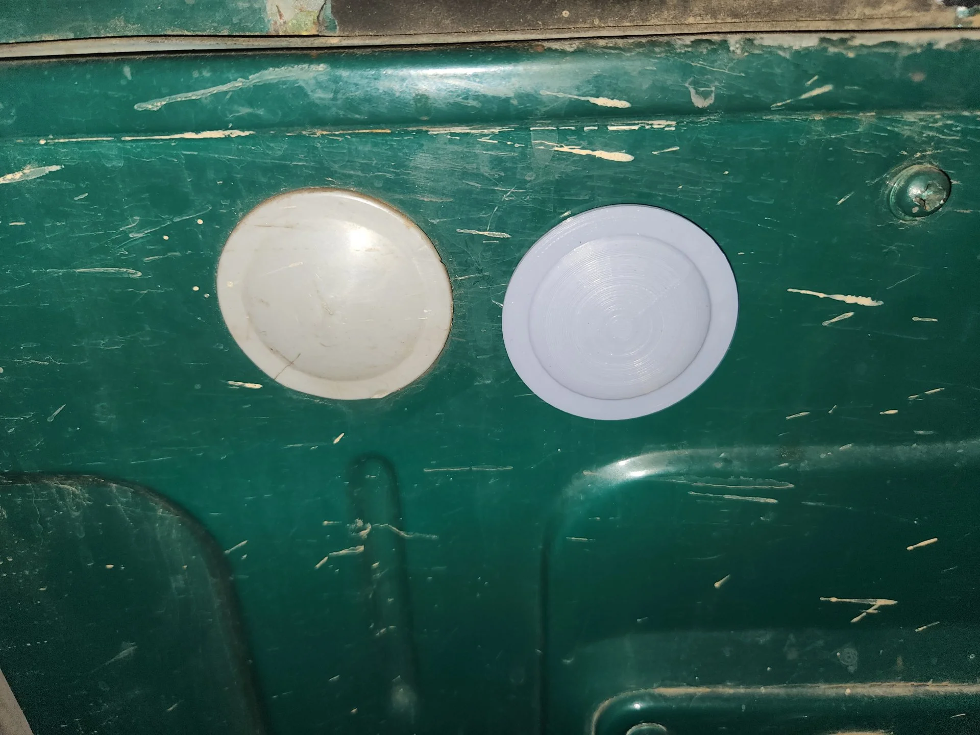

Still PLA, but getting there...
My TPU (rubber-ish) should be dry enough to try it out... will have pics in the morning. I know it will require a little post print processing, but hope to be close.

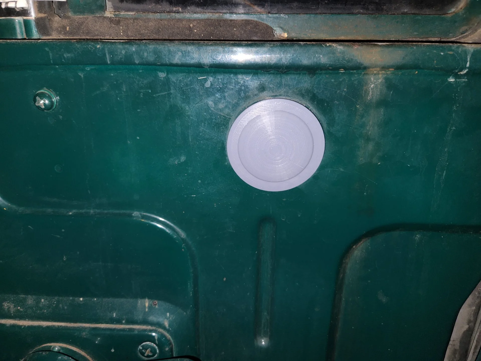

Was sent out of state for work over the weekend... got back this morning and this is where I'm at. I believe I can find a lighter shade of TPU, this is just what I had laying around. I'll print a couple on the higher resolution resin printer, but they won't be flexible...
They all look good to me !!!!! 👍 Very nice work
Thanks! I have some ideas to get it to the right look, but will play with it.
With the FDM printer, I can only get a resolution of about 0.1mm so you can really see the print layer lines .. with the MSLA (resin), I can go half of that.... 0.05mm. I should have a product in about 2.5 hours...

Here's the resin printed one. I can actually see the limitations of the design software... lol: it will only allow 64 segments on a circular object...
Here is the closeup between resin (on the left) and FDM printing (on the right)
