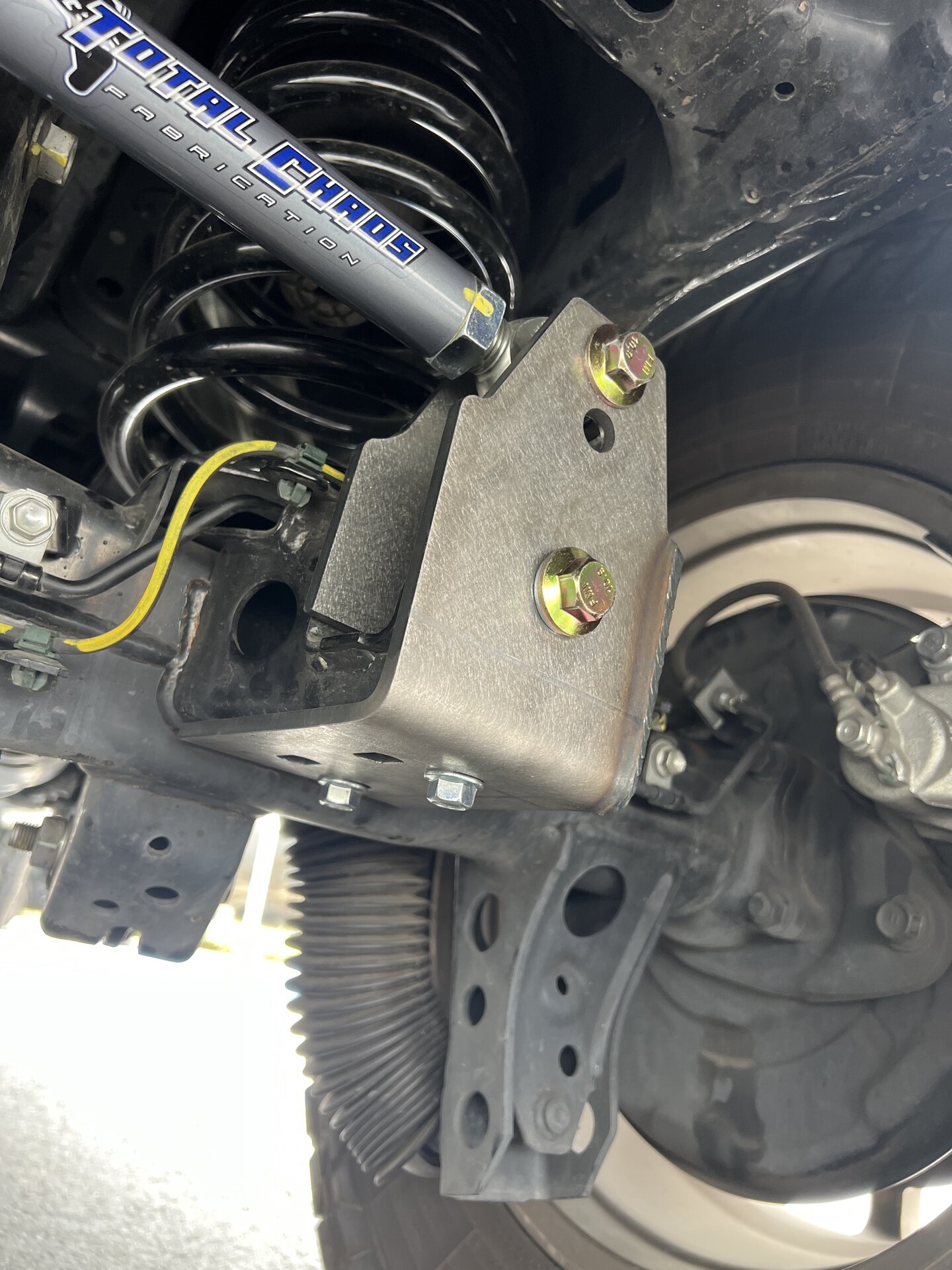

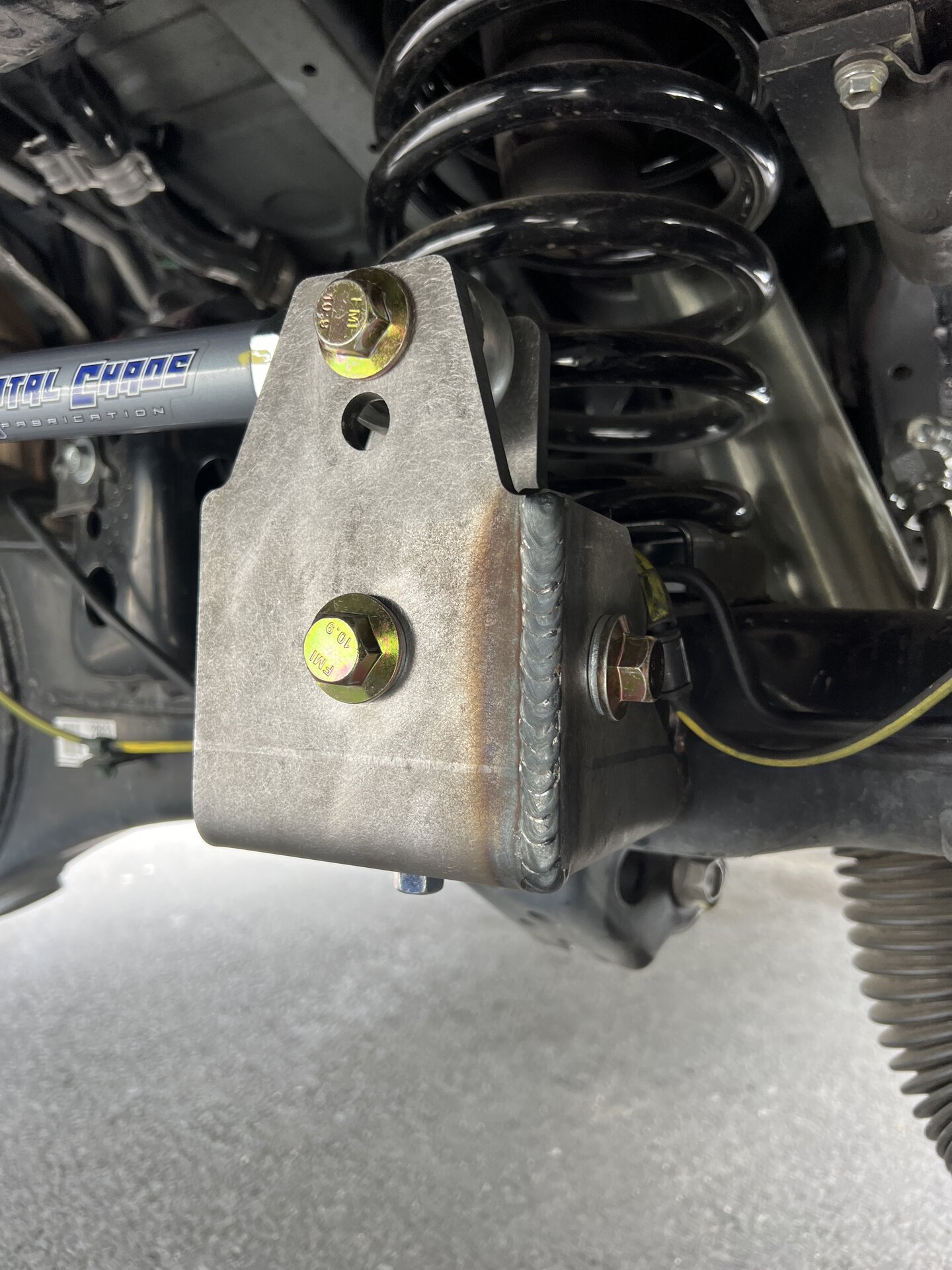

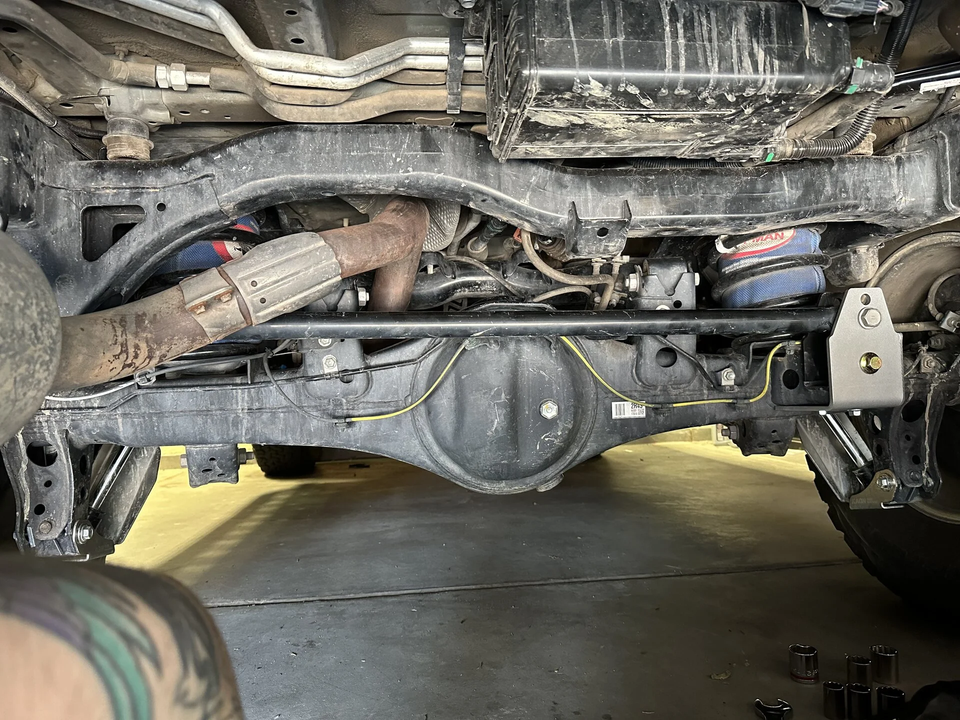

Here’s Some more pics. The part that I hate about this is now I can’t run my spare tire in oem location. I was about 3/16 away from it touching the trac bar prior to the bolt on trac bar correction kit. Now it touches it. 🥲. Oh well. Time to toss it in the cab or get me one of those hitch swing tire mounts.
I also want to mention that I’m 100% confident that the LX sway bar will have no issues bolting up to this. If you have an LX and live in socal and can meet me either in norco / corona or even baldwin part. Please reach out to me. LX version will come with an extra plate to shim the driver side sway bar to match the passenger side.
@drkdss Just found this post. You can disregard half the message I sent. I wonder if there'd be any inference with the 24 gallon long range tank.
There will not be any interference with lca aux tank.
Correct. Here’s some pics of mine with the 24 gal LRA. No issues.
What is interfering with the spare?
The bracket or the track bar?
I really need one of these, but would like to keep my spare underneath.
Trac bar. I’m running a 285/75/18 so it’s a 34.8” tire. It will touch it.
How much gap do you have now between your trac bar and the spare? If it’s 5/16 or more you will be good to go. The bolt on bracket just moves it back 1/4”. Which a lot of ppl don’t realize that actually make the bushing on the driver side more neutral as it’s more in line since the trac bar mount on driver side is behind the axle side mount by a good amount. So if we are talking about an oem style vulcanized rubber bushing, it actually relieves the twist.
You won't get this interference with the weld on option, it moves the panhard vertically up from the stock location.

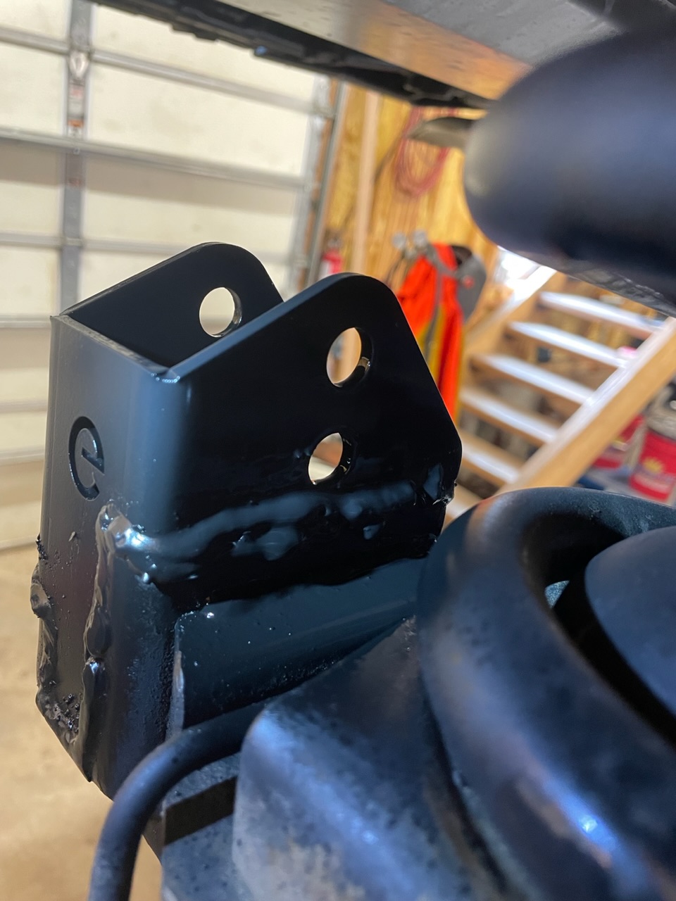

Confused by this. Did I miss something @drkdss? The bolt-on option moves the axle mounting point rearward as well? I've had my Eimkeith panhard riser in hand since November, just haven't had a chance to get it installed.
I have the @Delta VS 4-6" version on my 80 with 2" springs that net 3" of lift and it sits parallel. An absolute game changer so I'm excited to get my @jkeithw riser bracket on the LX.
Since the back bracket for the kit sits on the inside of the oem mount. The trac bar is technically 1/4 “ rear ward of the position it would be in the oem mount or to e weld on option. A 1/4” lol. It’s just what it is. So if you are running a spare tire that day is 1/4” away. There’s a chance that the tire will rub the trac bar ( I know you guys call it a Pan hard bar). And yes the bolt in one will as far as the bracket itself will not get in the way of anything else.
And if you want to get real scientific, if we talking about an oem style bushing or even a poly bushing. Bringing the trac bar more towards the rear will actually allow the bushing to work better as it’s more inline. When I say better def won’t feel it but say we do a cAD analysis, you will see it’s less stress on the joint. With that said you will never experience and issue either way. I’m just saying lol.
