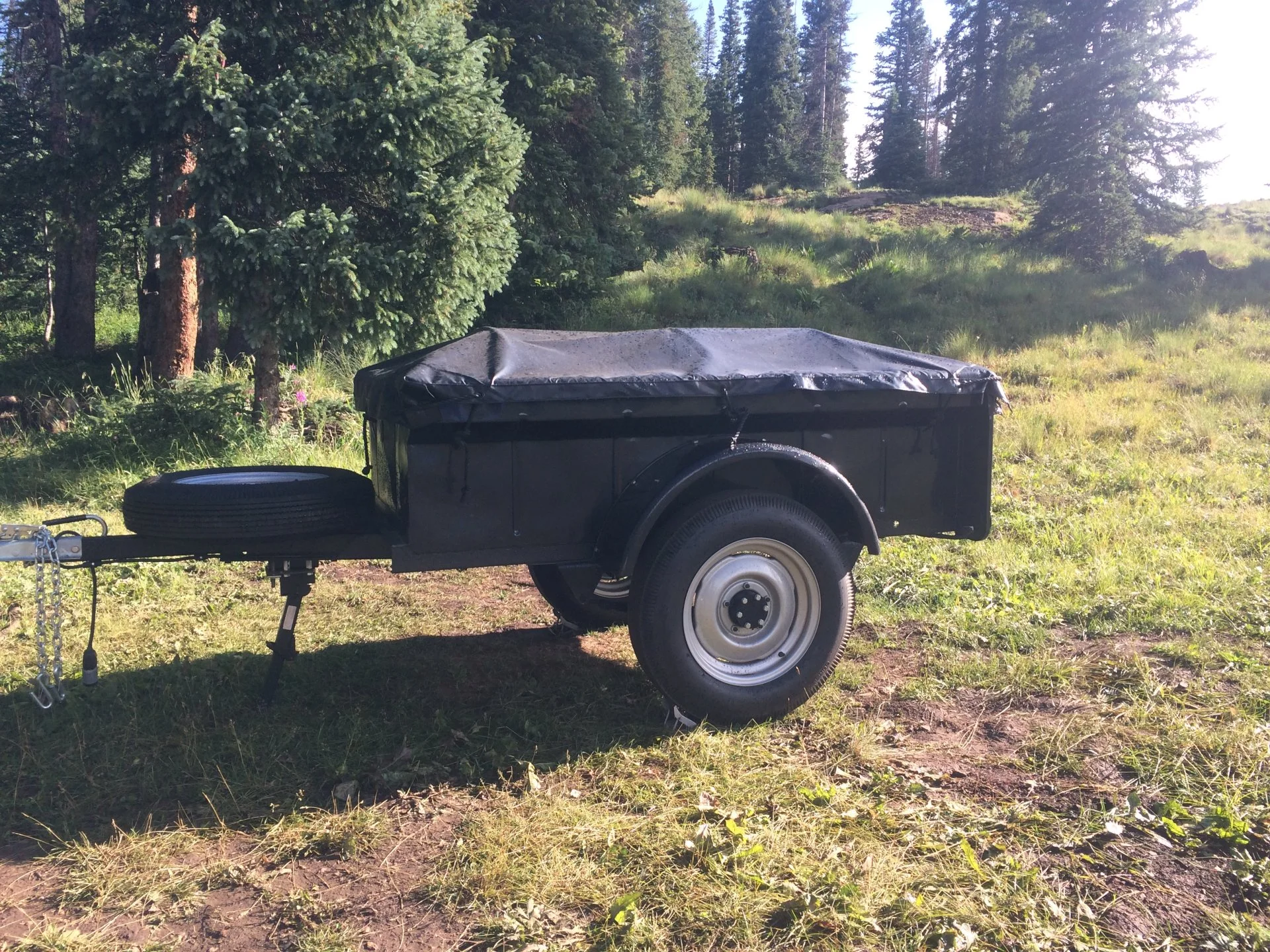

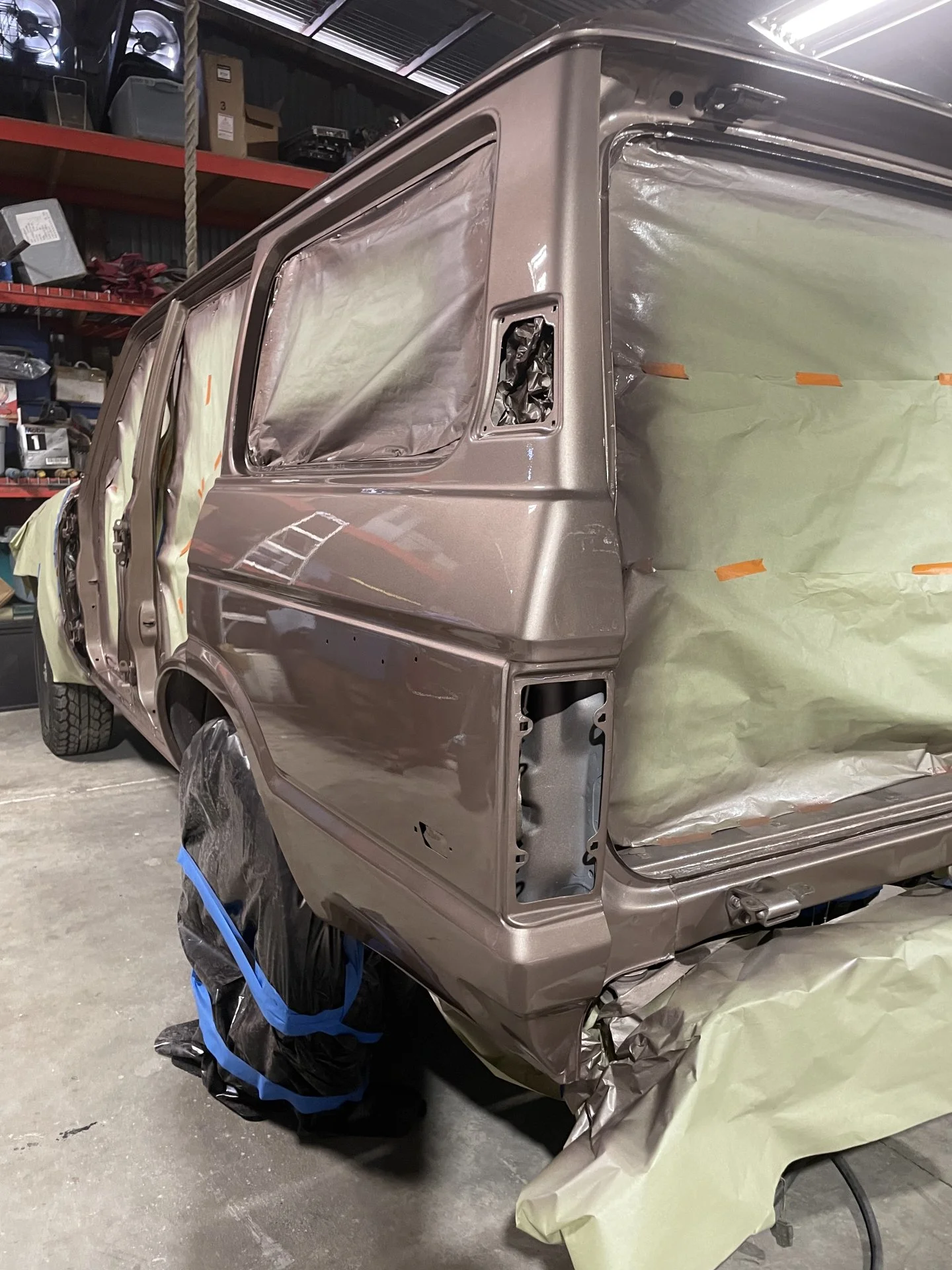

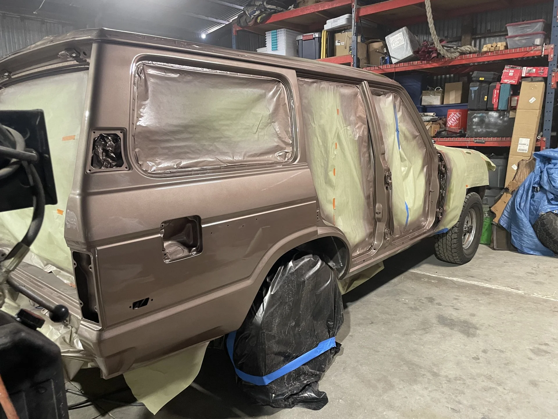

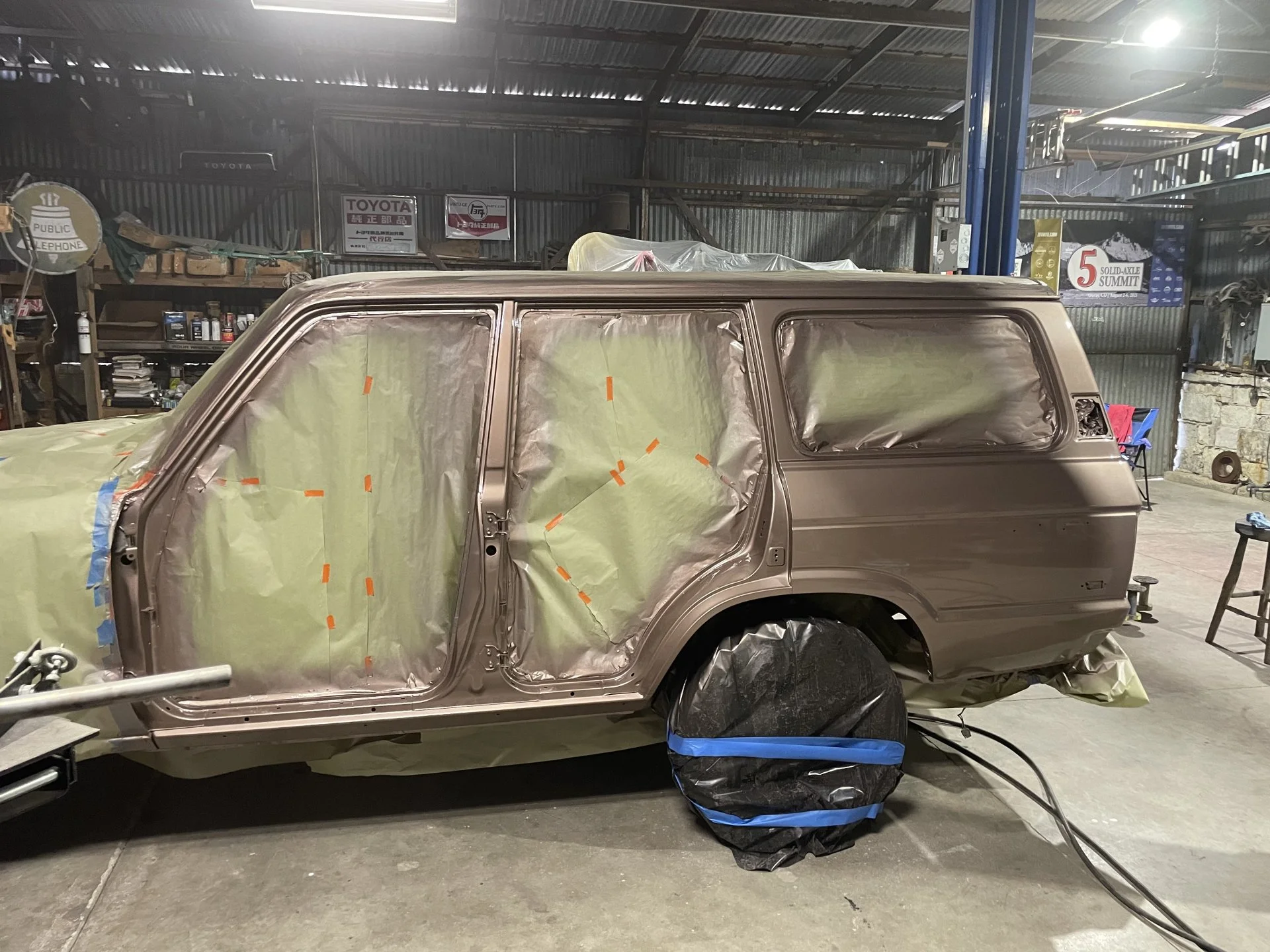

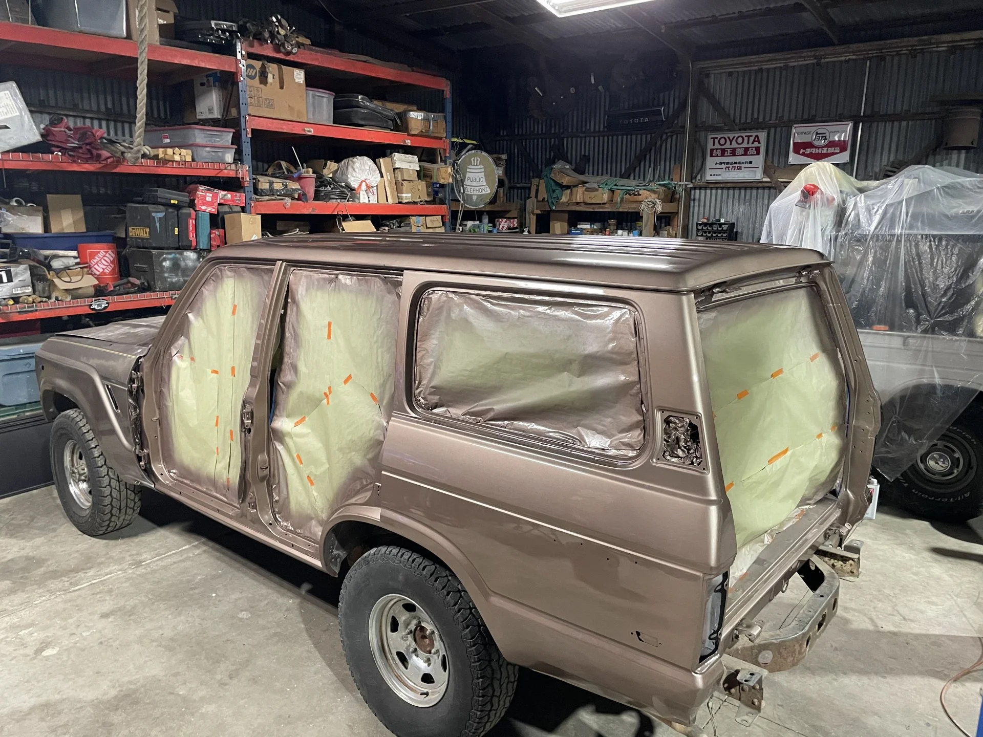

Anyone wanting to paint their own truck I can tell you the gun makes a huge difference. I’ve had this one for about 3 years and todays job took 2 coats of base and 2 coats of clear. When I used a Harbor freight economy gun on my blue 60 years ago it was almost double the coats to get the material I needed on the panels. And still had to do twice the work wet sanding and buffing to get all the orange peel out.

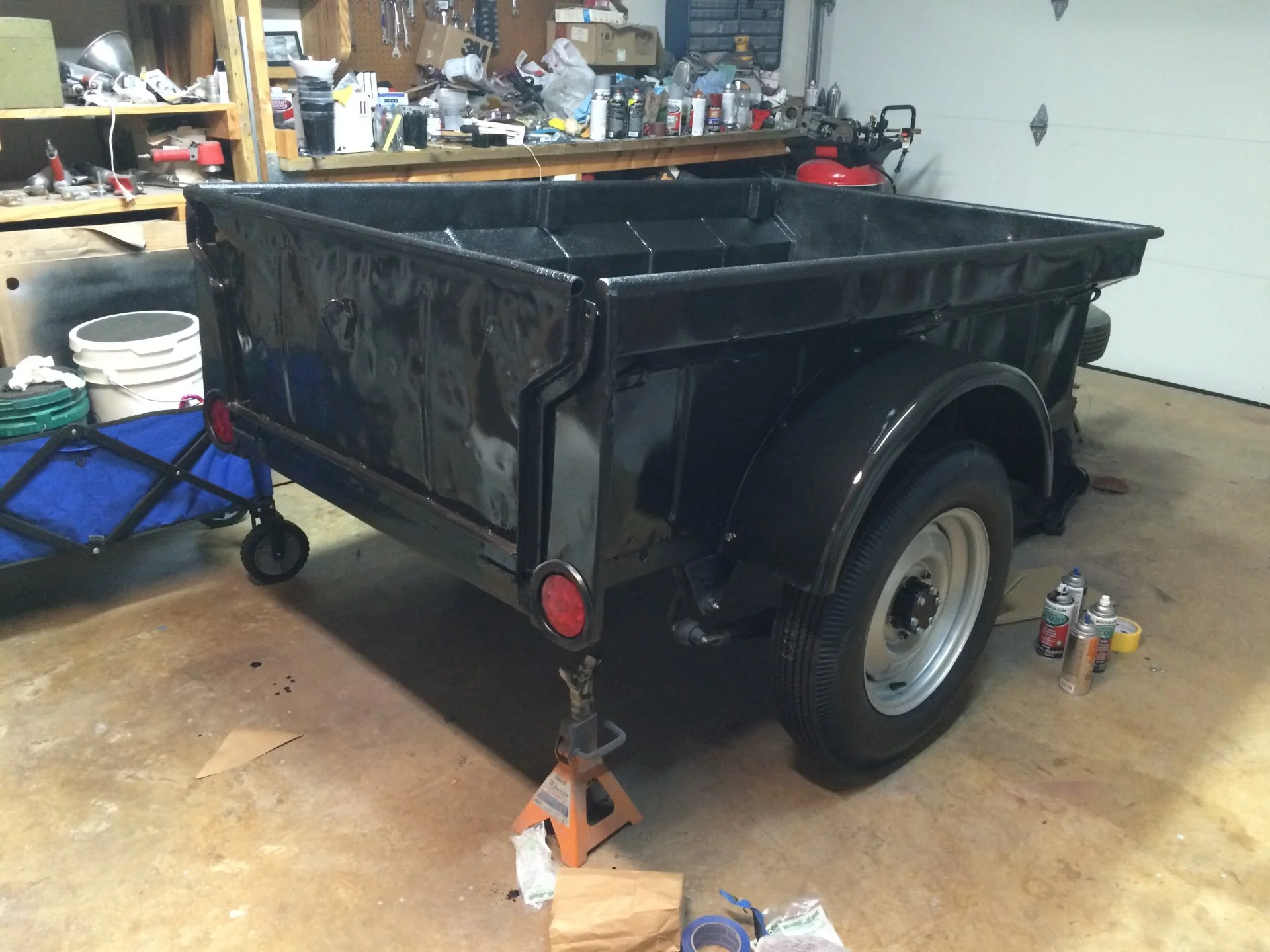

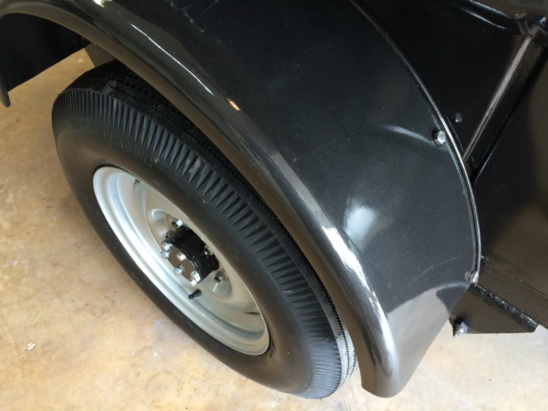

Yes sir. I agree 100%. That trailer is really cool. Paint looks great. Any plans to build a frame for a tent/camping. You’re welcome to hang out and and even participate in this job. As much work as it is…it’s my favorite thing to do. I learn a ton every-time I do this. Keeps it interesting to me. I have not mentioned the air, but you’re absolutely right. I have a big compressor but it’s not dry air. I need to get one of those charcoal filtration systems. I think about that every time I shoot paint but just have not done it yet. If I was painting a whole truck at one time my exposure would be a lot greater.I will second this (or third or fourth). I shot my Bantam trailer myself in metallic single stage using the HF stuff having absolutely no experience shooting anything in my garage. It worked out enough for me just being a trailer but it was clear right away a better gun and air supply would have made it better. No where near as good as your stuff. Its a metallic gunmetal but my gear couldn't get the flake going as well so kinda just looks black. You can see it in the light OK but overall.....just black. Would love to see how you do this in person sometime. I know I would get a ton of tips watching the magic happen live.
