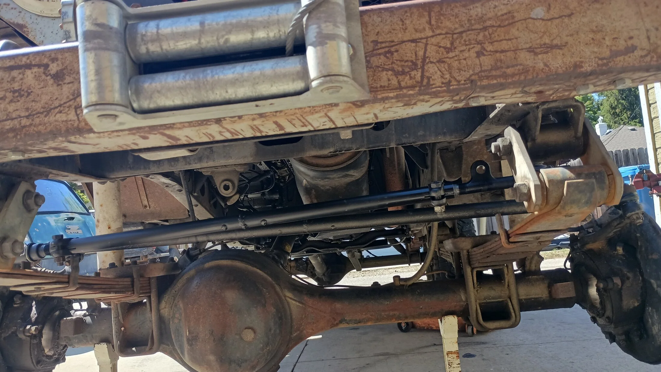

Used some flat stock to set my toe-in.
All done for now. Driver's side is still a bit close to the tire. Really need to bite the bullet and go to 17's and 37's.

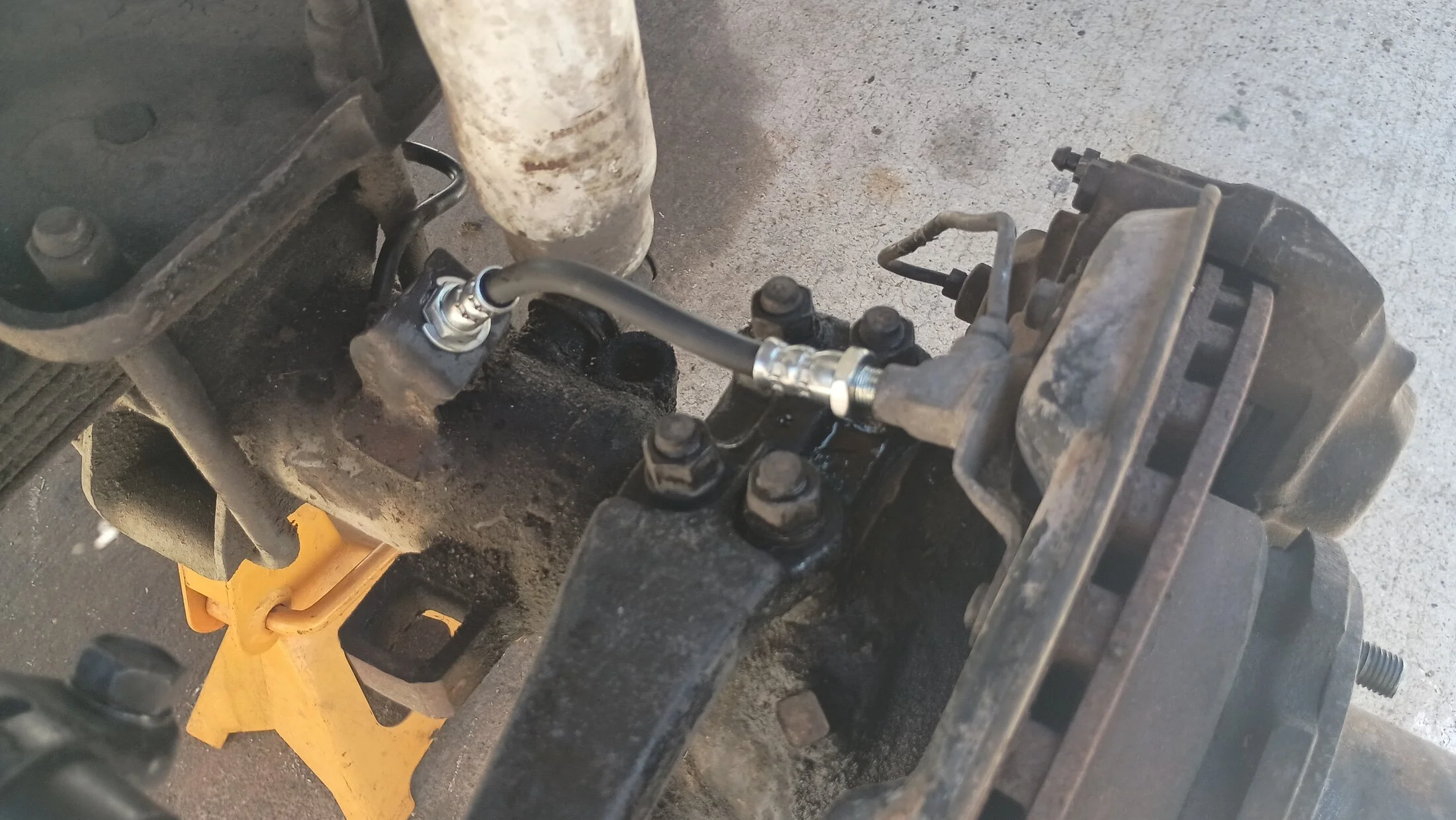

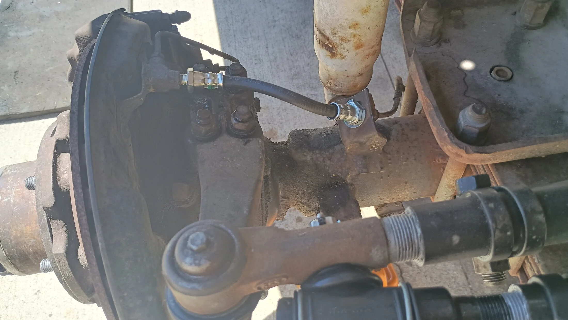

While I was working on the steering, I noticed the condition of my soft lines wasn't too good. Ordered some new lines from Rock Auto.

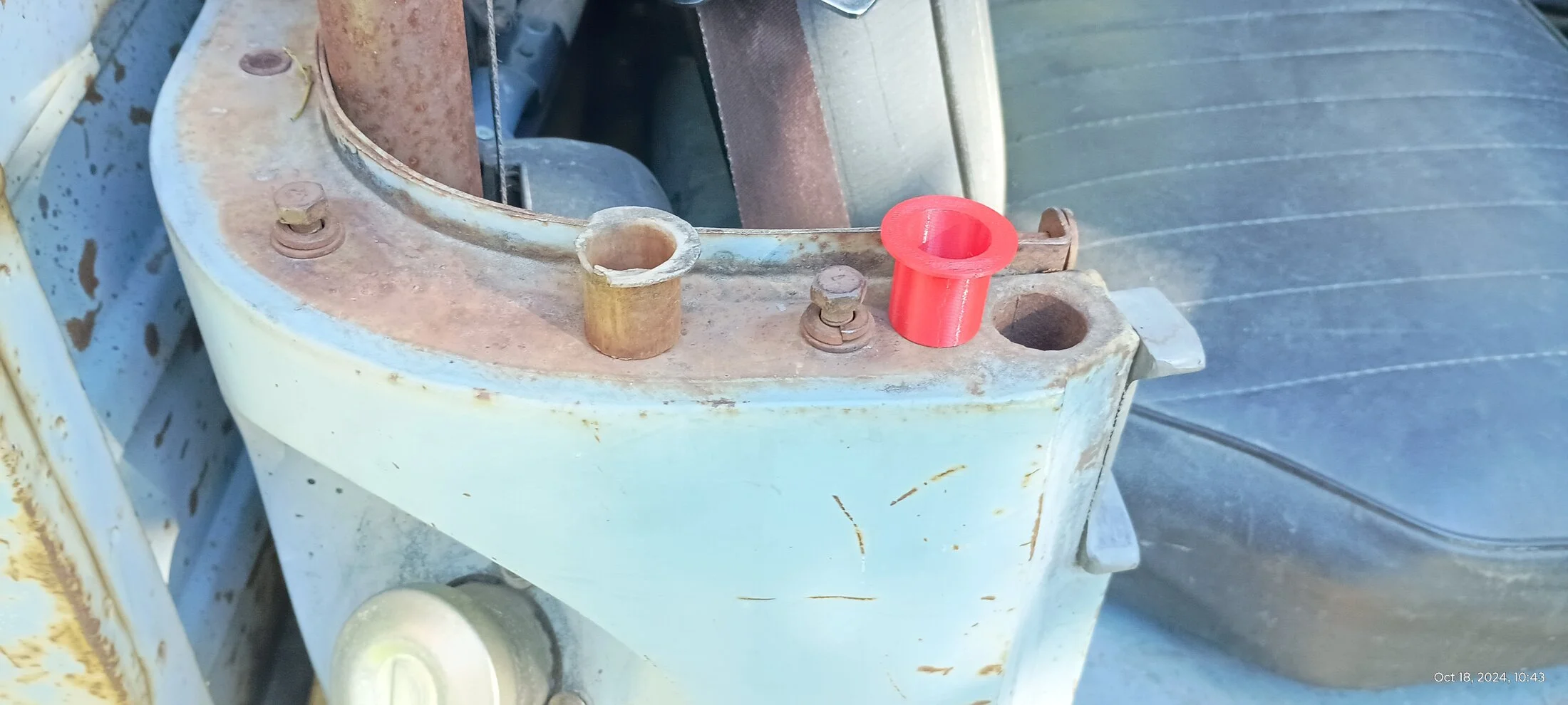

Put the top on for the winter. Last spring, after I pulled the top, I printed a new bushing...almost forgot about it. Found it on my workbench, I meant to test it out and print a few more in something besides red ABS, maybe a natural PET. Don't currently have access to a 3D printer though. I need to get one.
This fit nicely, we'll see how it holds up through the winter.

I seem to recall that Jim @Downey found an off the shelf nylon bushing for that application at McMaster Carr. He gave me a handful if you’d like to have one.

Send me the file. My son is in Meridian and has a 3D printer. He said he’d print some for you.
Thanks for the offers, I've got another source to print some more, won't need them until next spring.

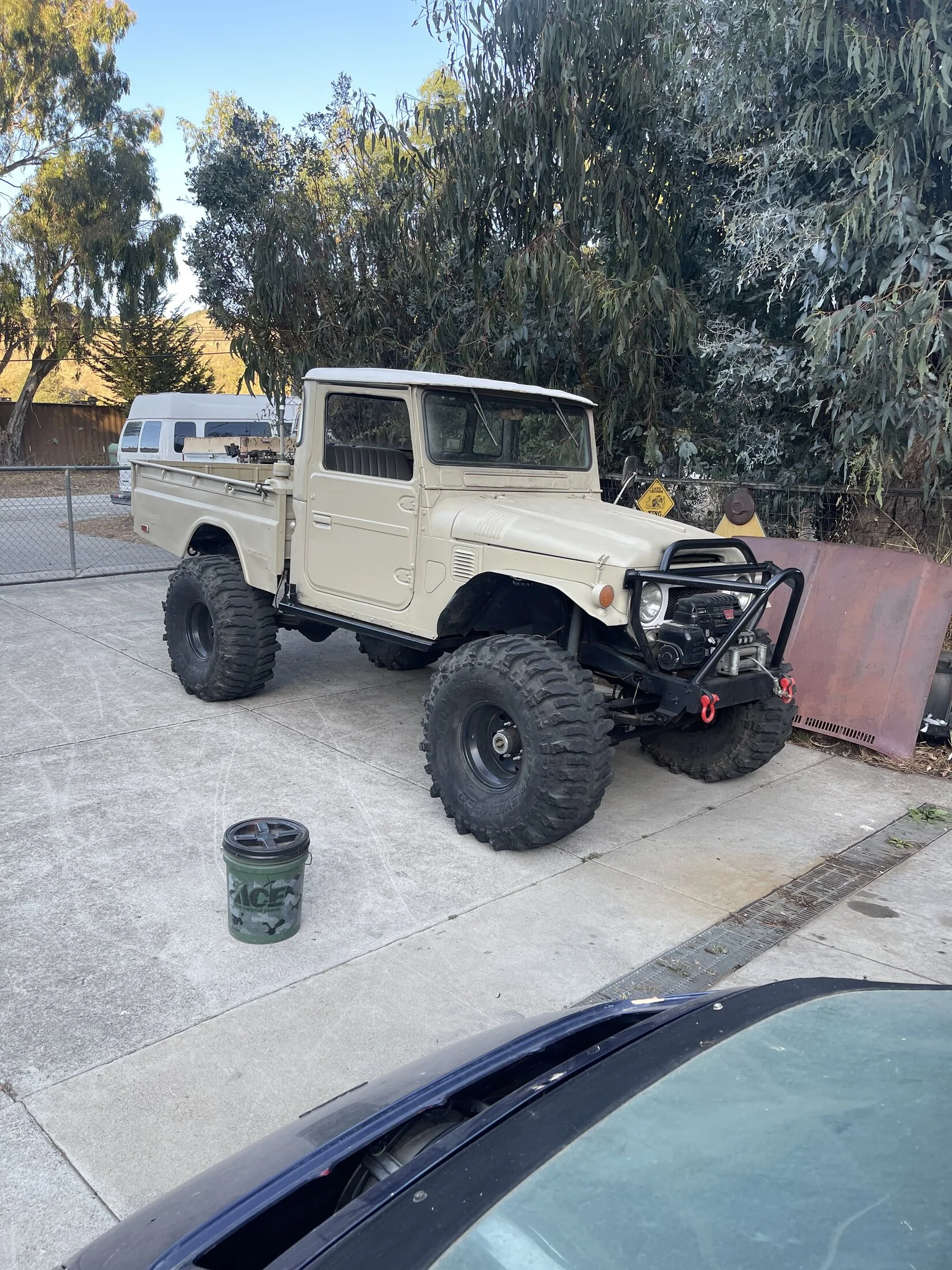

Finally found a deal on some 37x12.5x17's Cooper Discoverer STT Pros on Marketplace, mounted them to some tundra/sequoia steel rims. Had to use a 30mm spacer up front.
