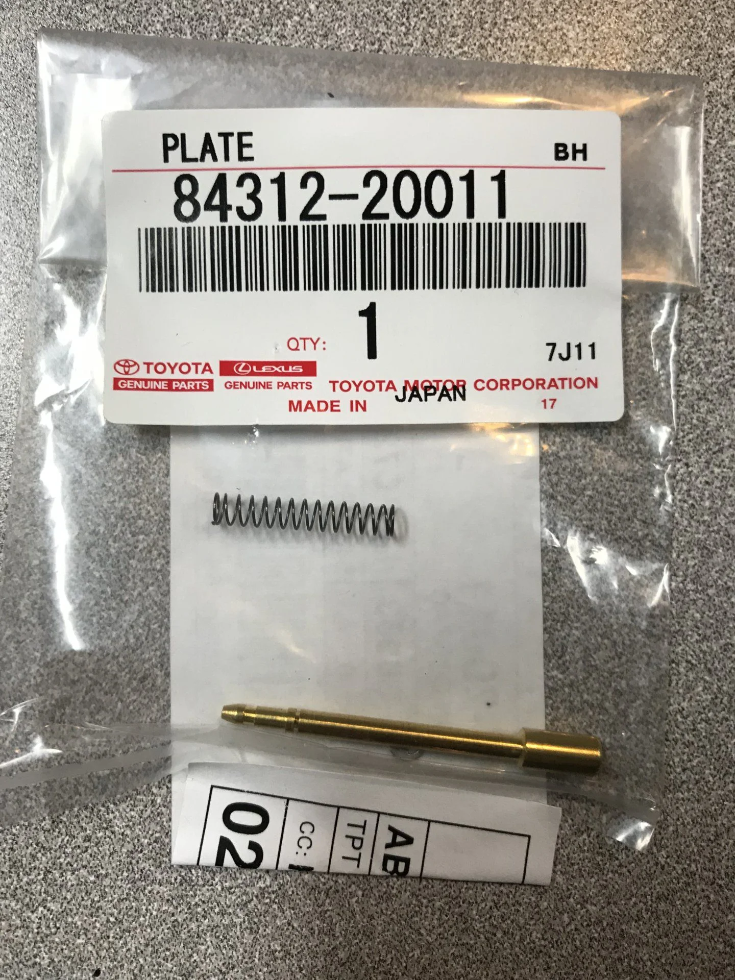

Found this post.
Need to order the horn contact pin, I think it's the same part number as the one on the FJ62. Need to take the clam-shell off and there's a cir-clip that retains it.
Quick follow up to the original post - just did this for my wife's 1990 FJ62; snapped a few pics for the sake of posterity...
The horn worked ONCE when I was troubleshooting, so I was pretty certain it was just the horn pin being worn. My suspicion's were right...took all of an hour to pull the steering wheel off, take apart the column, and swap out the pin.
That's a lot of honking!
Worked like a champ!
