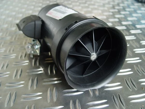

So what do I do? Well, I've thought about fitting the cyclonic pre-filter from the Toyota genuine factory snorkel for the 80 series (IE, the "bird feeder", as shown here:
The only problem is... well you know how I said I don't give a toss about looks? I lied. Damn that's ugly. I also worry it'll get snagged on branches in the bush. Technically it might be the best option to alleviate my concerns about dust though. I know I don't want the full 80 series factory snorkel though, that thing's not sealed properly for water, and it's just too fussy to fit. I'd probably get a Safari snorkel base and adapt it to fit this head. Or cheap out and adapt a china one from ebay. Either way.

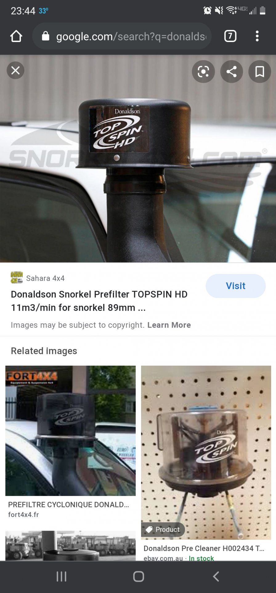

I've been having the same debate and have yet to pull the trigger on a snorkel. When I do, I'm going to use a Donaldson Topspin as a pre-filter. It's not the greatest looking option, but IMO, better than the OEM.
Thanks, I've seen them around but haven't looked into them very much. Any specific things that make you favour that over OEM? Just looks, or is there something technical? I don't actually have a clue how well the Toyota snorkel pre-filters work myself, I just assume they work well because.... Toyota.
i have had this topper and i really like it, the bottom has louvers like OP's inside fender prefilter....it makes the air going down into the snorkel vortex... i have NEVER thought a front facing snorkel topper was a good idea like so many have.
