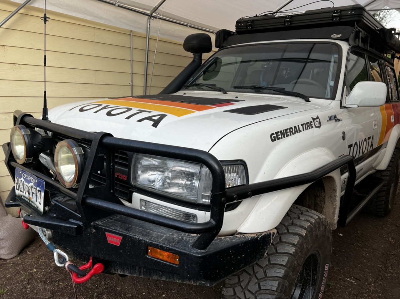

My bird feeder arrived today. Seems to be of decent quality.
That Toyota livery is 🔥🔥🔥
I've got one just like that on mine. Fit was great and template wasn't to bad. From the pictures it's the same manufacturer but I purchased mine about 10 years ago. Only installed it last year though. Still looks like new and is parked in the weather all year. I'm happy with it.
