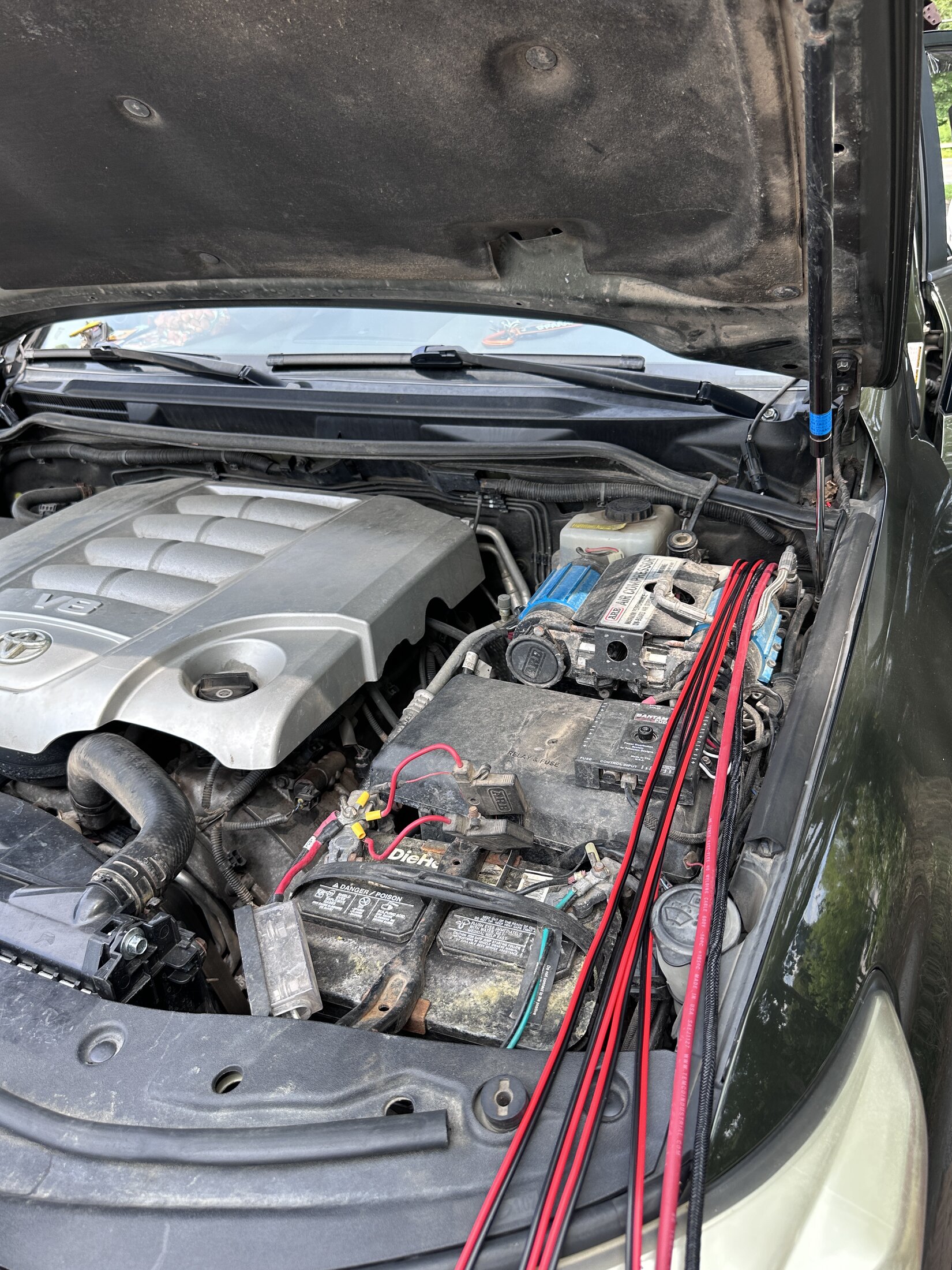

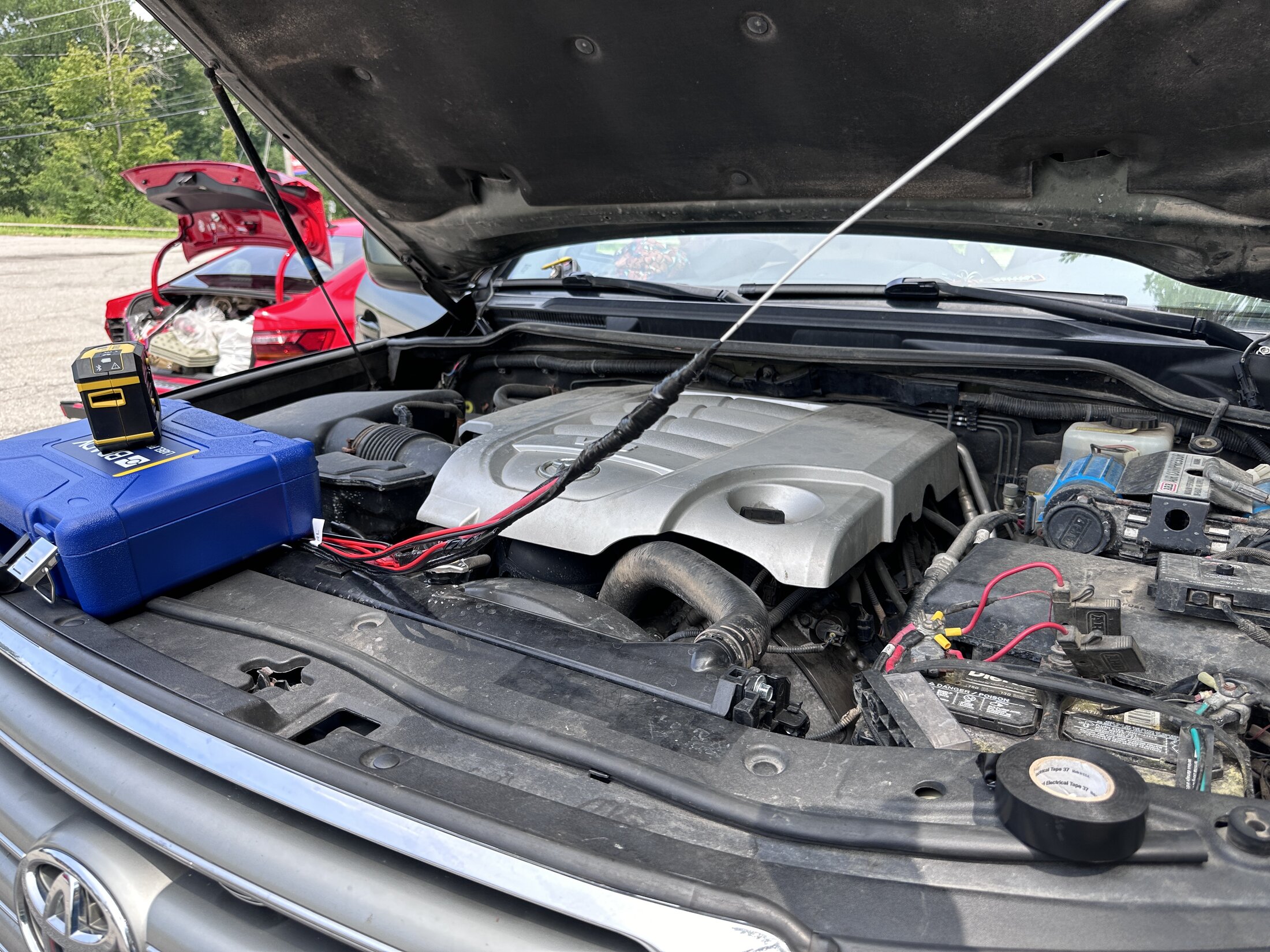

Alternator charger went on sale for $200 so I bought it. Temporarily hooked it all up to the Rav to make sure it all works and set up the app and update firmware. All pretty simple. Easy to set the charge rate from 100 to 800 watts. There also seems to be a reverse flow maintenance mode allowing trickle charging of the starting battery as well as a max (800w) charge reverse mode , though there is no battery type selection for AGM start battery. Potentially that might work as a way to maintain both the ecoflo and the start batter when garaged and connected to shore power via one device/cord allowing me to delete the 2 amp onboard charger I have.
The double 6 awg cable will be hard or maybe impossible to get through the firewall grommet. I think it will have to go under the truck and up through a floor grommet.

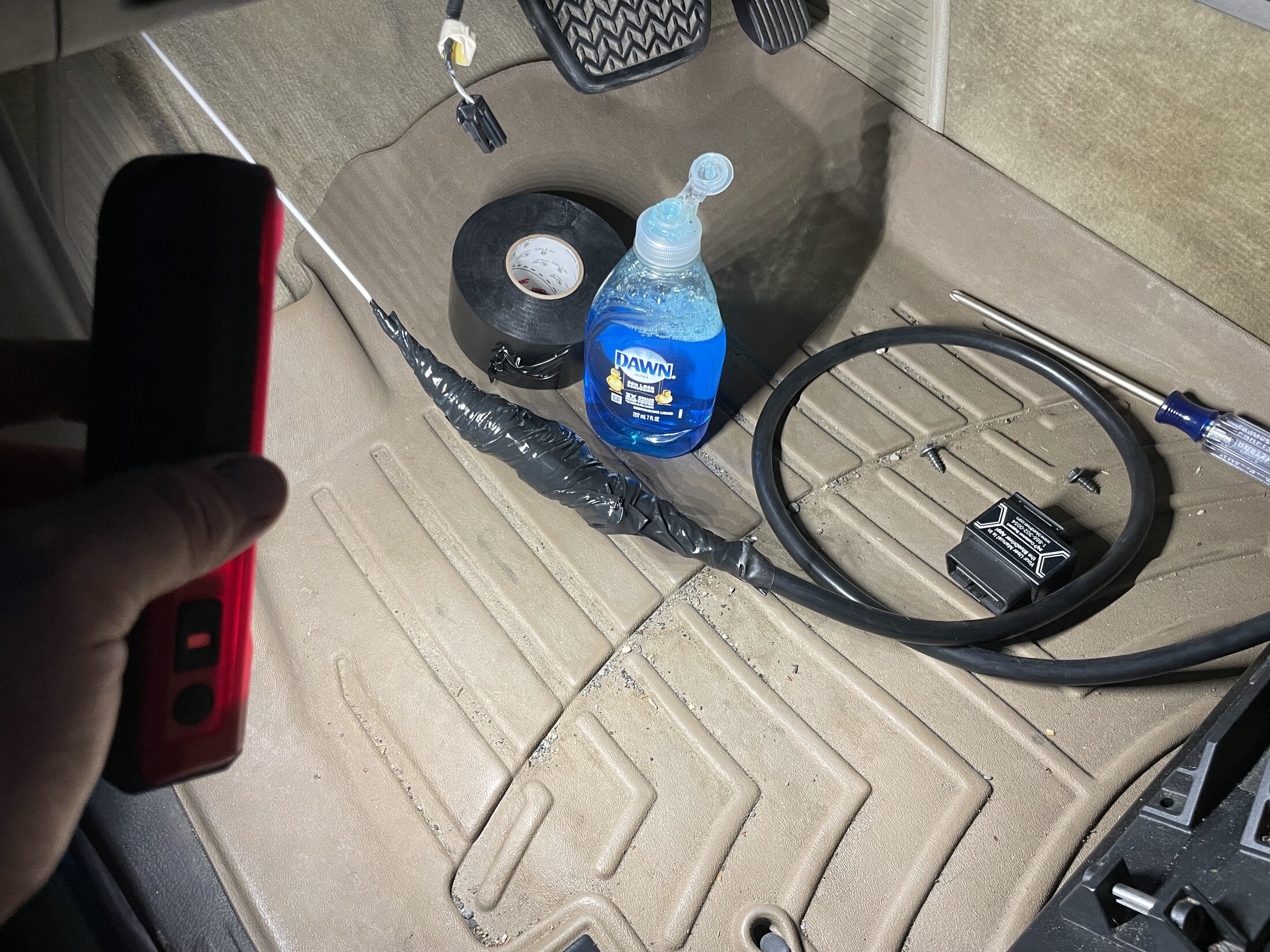

I ran 2 gauge wiring through the firewall grommet without any issues. The real difficulty is running it along the floor and through the B-pillar; that was a nightmare and a half. If you have the option to run it underneath, that'll be much simpler. You can pop it back in via the floor grommet that's below the passenger side storage cubby (I used that for similar needs).

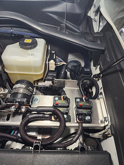

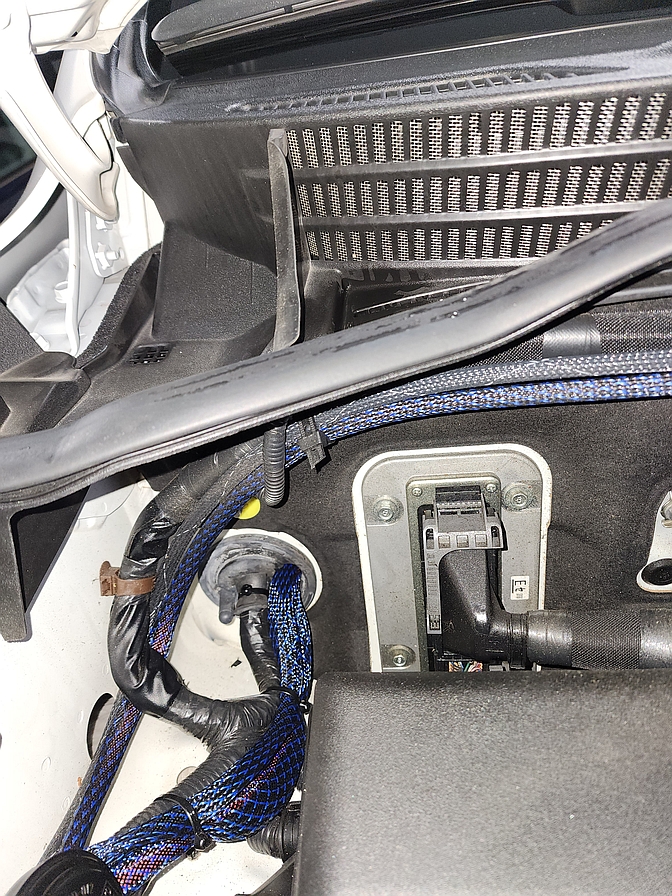

I got 6 GA through the firewall at the grommet location on both driver and passenger sides. The nipples on these firewall grommets are EXACTLY the size of 6 GA wire. I did this so I could have Anderson SB-50's and a cigarette lighter at the driver's and passenger's footwell to power all kinds of stuff. I did not thread the wires through the channel below the door to get power to the rear. Yet.
Passenger side: Both nipples are unused so if you want to strip off your wire loom you can go through each nipple you can do so with just slicing the nipple. I didn't do that. On the passenger's side I got 2 6GA with wire loom through. I did it by un-taping the center side opening up the grommet which is split from the factory. Once pulled I secured the grommet with a wire tie. This leaves one pristine nipple ready for piercing. Ahem. 😈 It's worked out fine.
Driver's side: The driver's side is a bit of a different story as the hood release cable uses up one nipple. I was able to get a single 6 GA wire plus a 12 ga wire through the unused nipple.

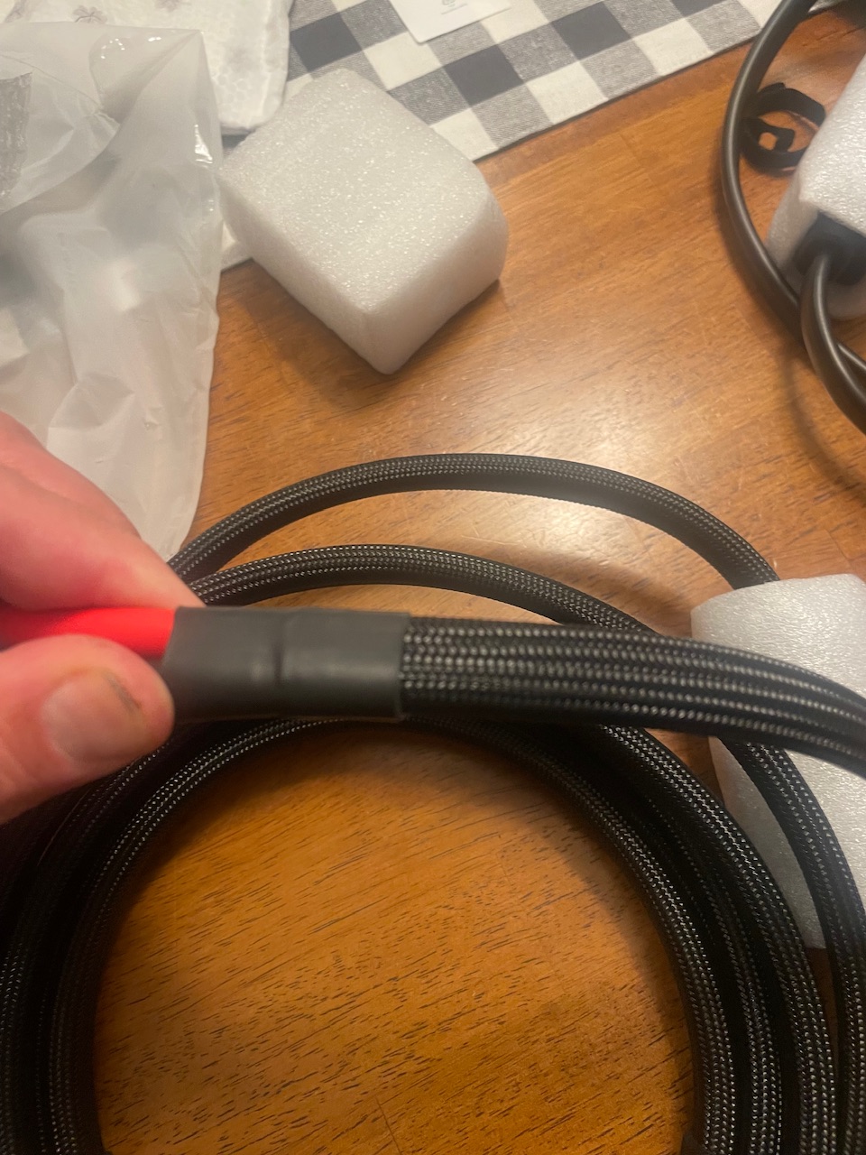

Probably not without destroying the covers as they are all molded rubber/plastic and appear to be "hermetically" sealed. The whole kit reminds me of Apple iPod/iPhone/iPad with proprietary connectors. I think you'd have to cut the cable and splice in butt connectors or terminal lugs to connect to DIY cable. You would for sure need to do this to connect a different DC/DC charger but that would not be hard to do. I'm sure part of the reason they do this is to force people to live in the Ecoflow product universe. To be fair, the stuff is meant to be plug and play for people who are not electricians.

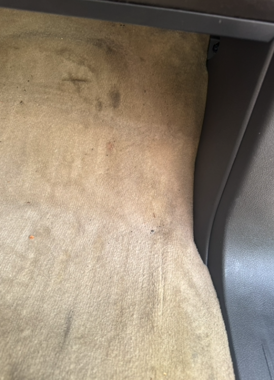

I routed mine under the front passenger seat. There's an easily-accessible opening in the carpet under the seat. I thread the Ecoflow cable into that opening and under the carpet towards the passenger side grommet. When I camp, I put the Delta 2 Max on the floor in the 2nd row.
When I'm not camping, the alternator charger and its cables just tuck under the front passenger seat.
This is a view under the passenger-side front seat. Behind those vents, there is a big opening in the carpet that the wire can go into.
This is the front passenger seat well. The Ecoflow cable is routing under the carpet towards the upper right corner of the phote, but it's undetectable.
