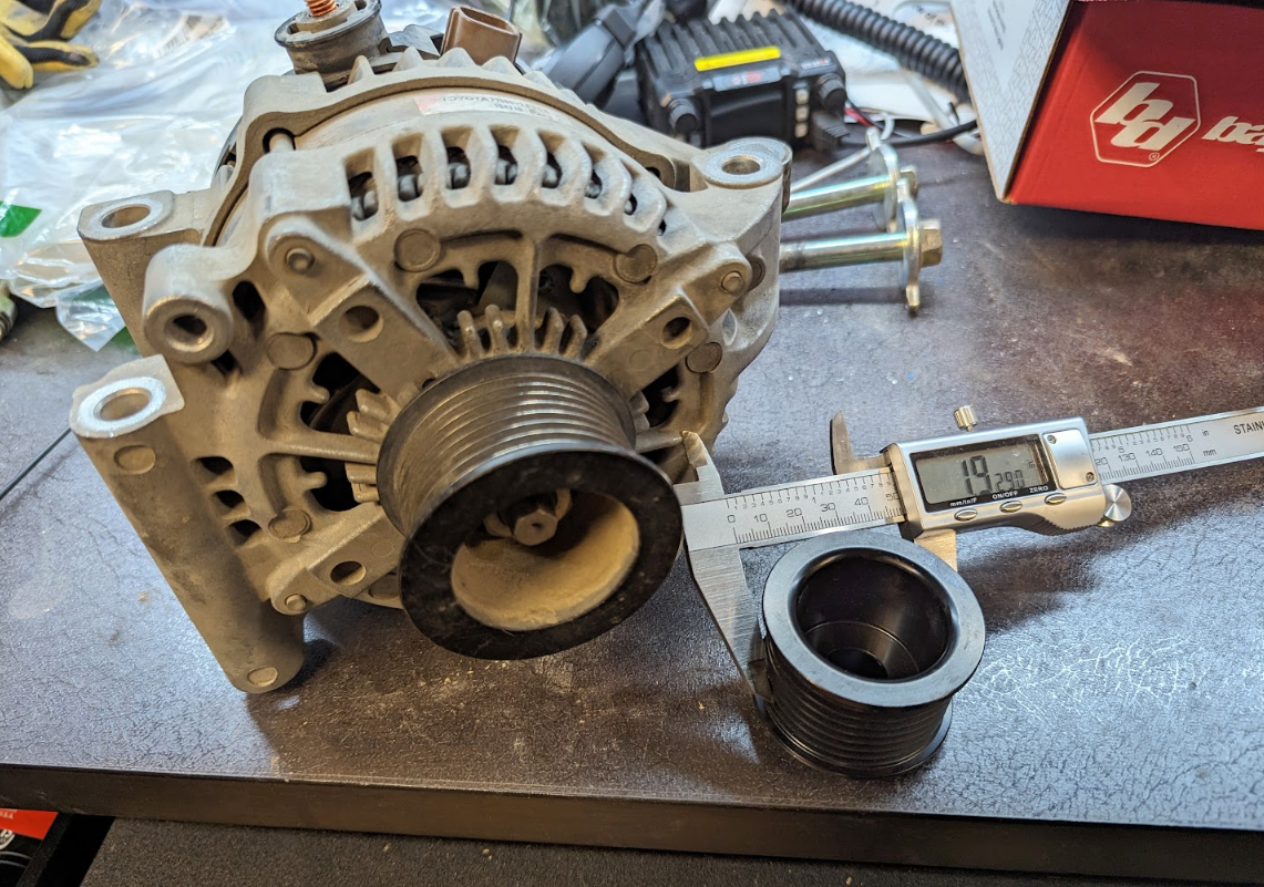

Is this addressable by brush changes or is it likely to cook the rectifier and/or voltage regulator?
And I assume your undersize pulley mod would help?
Edit: spelling
And I assume your underside pulley mod would help?
That was the goal. While I think it's a step in the right direction for a more loaded alternator, it's hard to say this is a complete solution. While more RPM is more potential power, there's the trade of higher RPM spinning the bearings and brushes more. Don't want them to become the next weak link. Time will tell?
For others joining in the conversation, may want to be cautious about drawing too much power especially at idle. This builds a lot of heat and surely will tax the built in alternator regulator. Mine was done at 168k living a life feeding 30-50A / 360W-600W in accessories, overlanding gear, and a travel trailer. Brushes looked great, but it wasn't holding voltage any longer.
