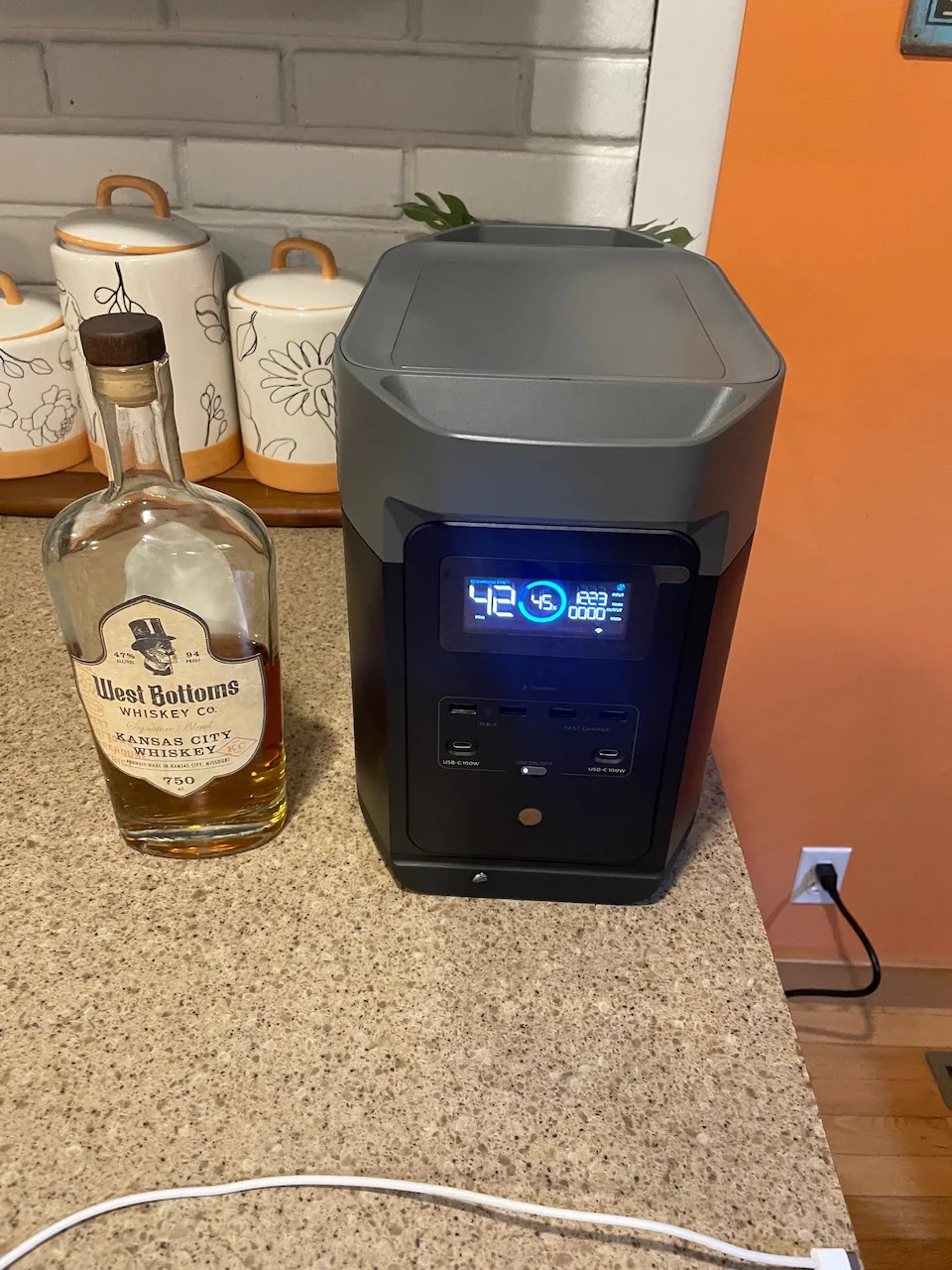

EcoFlow battery arrived today. It’s smaller than what I was expecting. Plugged it in to the wall and it’s charging at 1200 watts. I’m eggar to test this thing out.
Whisky bottle for scale only. ;)
