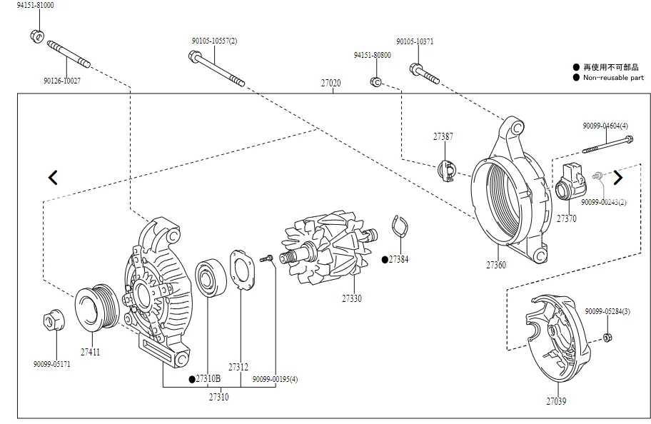

The regulator can be swapped. It’s the brown part that the harness plugs into.
Perfect. Doesn't look too hard to unbolt that part. Unfortunately, the part number isn't identified in the exploded diagrams? In reality, with the time and effort it took to get out the alternator, I just as soon replace the whole unit than risk a bad diagnosis to save money.
