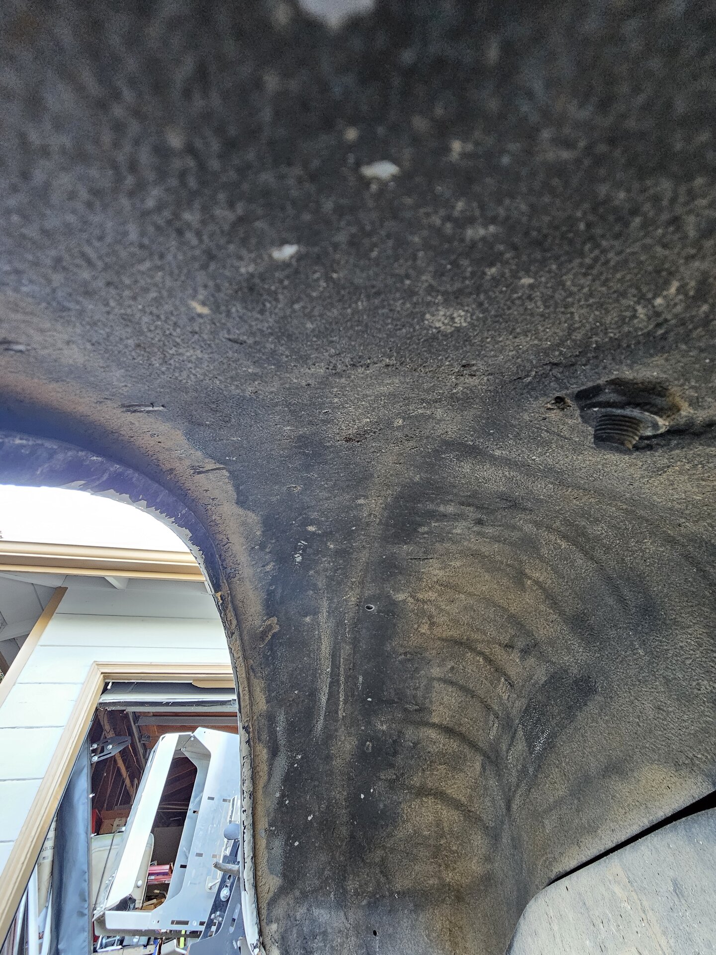

Tried rolling fenders with a modified roller.
Started to work then the cat plate broke.
So I picked up a hammer..
And bent in the lip
I think all I need is the lip bent in for the rears to tuck all the way in and max out on the tub.
Since I am not @Wermz or have 40s.
You could be ;)
If you can clear 37s with a lip roll, more power to you. Tire brand, wheel width, offset/back spacing, wheel spacers, bump stop length, all of that plays a roll in where the edge of the tire will impact the body. When i was on 37s i was 100% stock body and suspension, stock 4runner wheels with 40mm spacers, i had to cut the body a lot to clear a 37 in the rear.
You could be ;)
I'll keep trying
It's a bit of an experiment to try and fit 37s with out cutting..
The yokohama x-at 37x12.5x17 don't bulge out luje the falken mt of the same size.
0 offset rims so 4.75 backspacing
About a 2.5 in lift

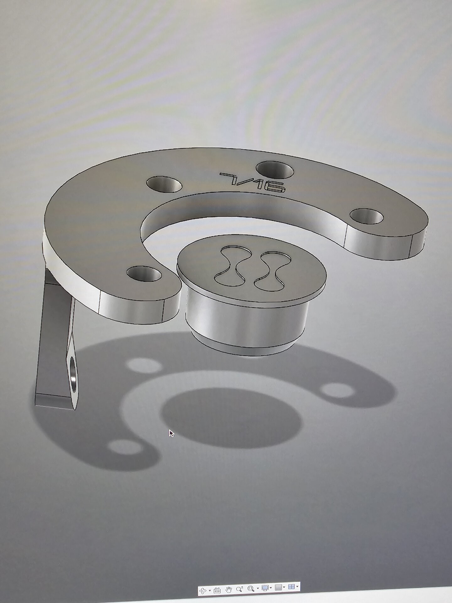

Power steering resevoir bracket has been made and fits perfectly. This mounts a chase bays res, psc to come

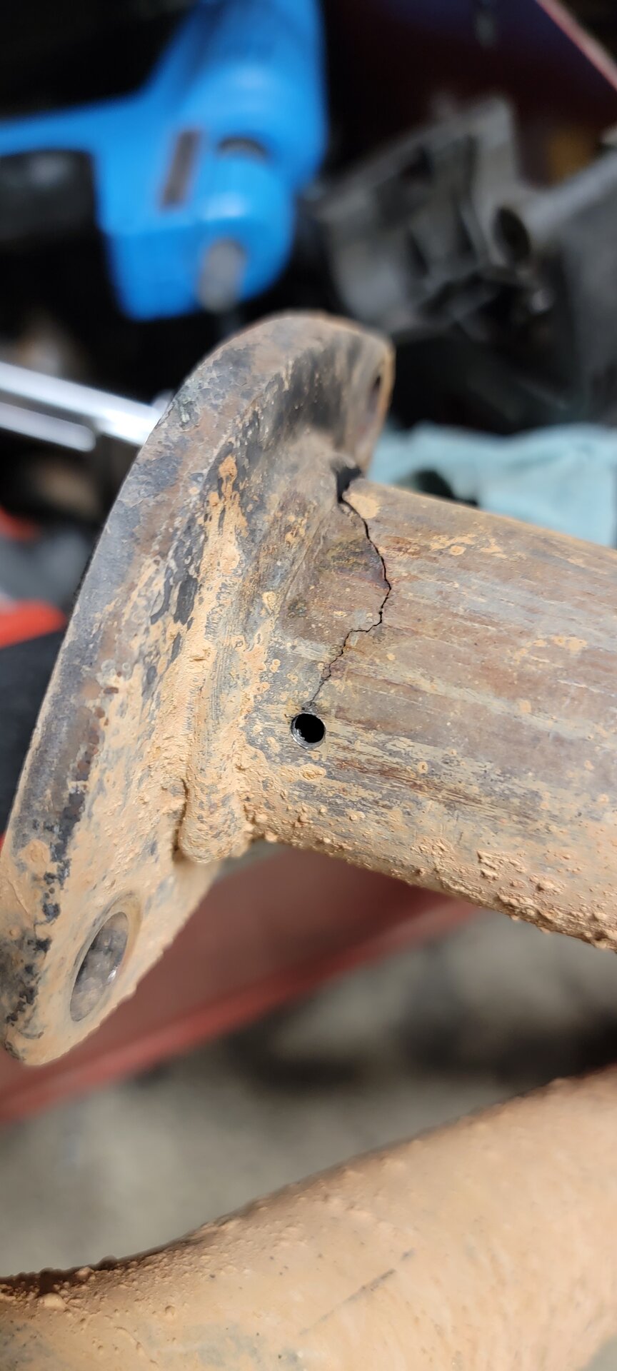

Went through the driver's rear axle to replace the axle seal and regreased. There was leaking all over the brakes and wheel. I had a hell of a time with the stub nut. Looks like I need a new stub shaft.

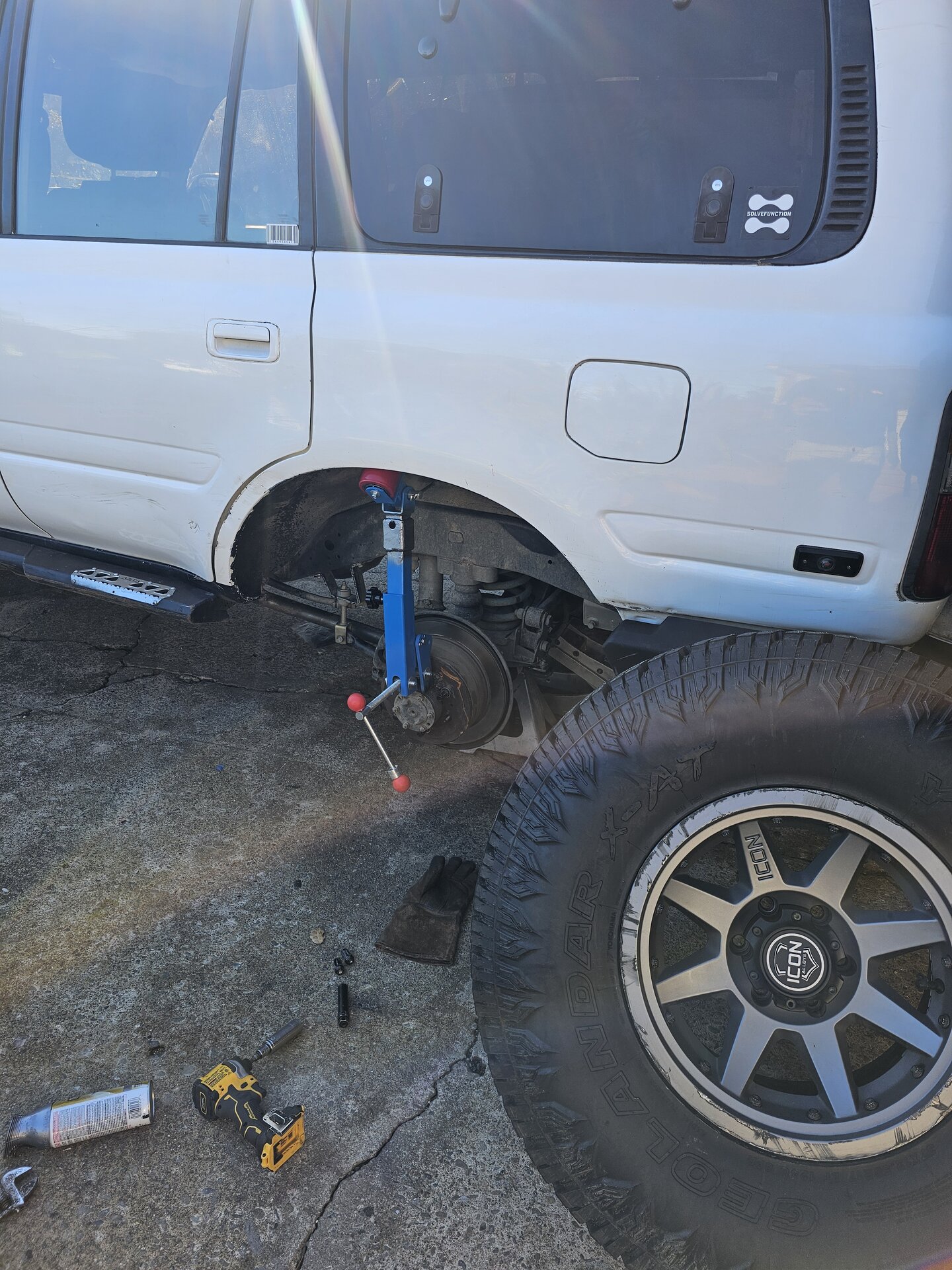

Rebuilt front axle seal, leaking into the brakes.

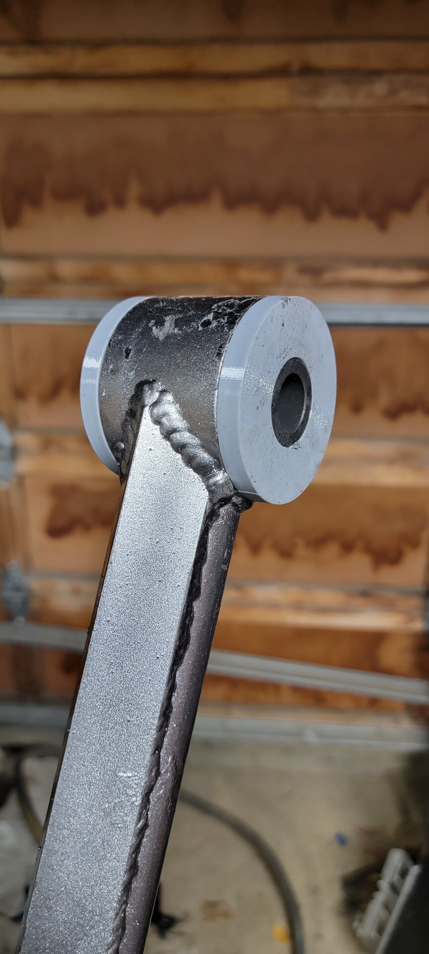

Installed @eimkeith rear lower control am brackets

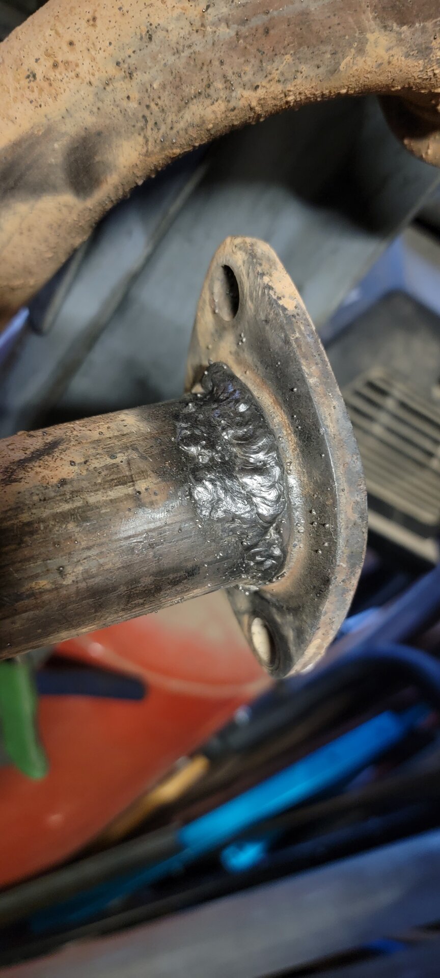

Then went to slick rock and fixed @jcardona1
With the bun trail welder.
