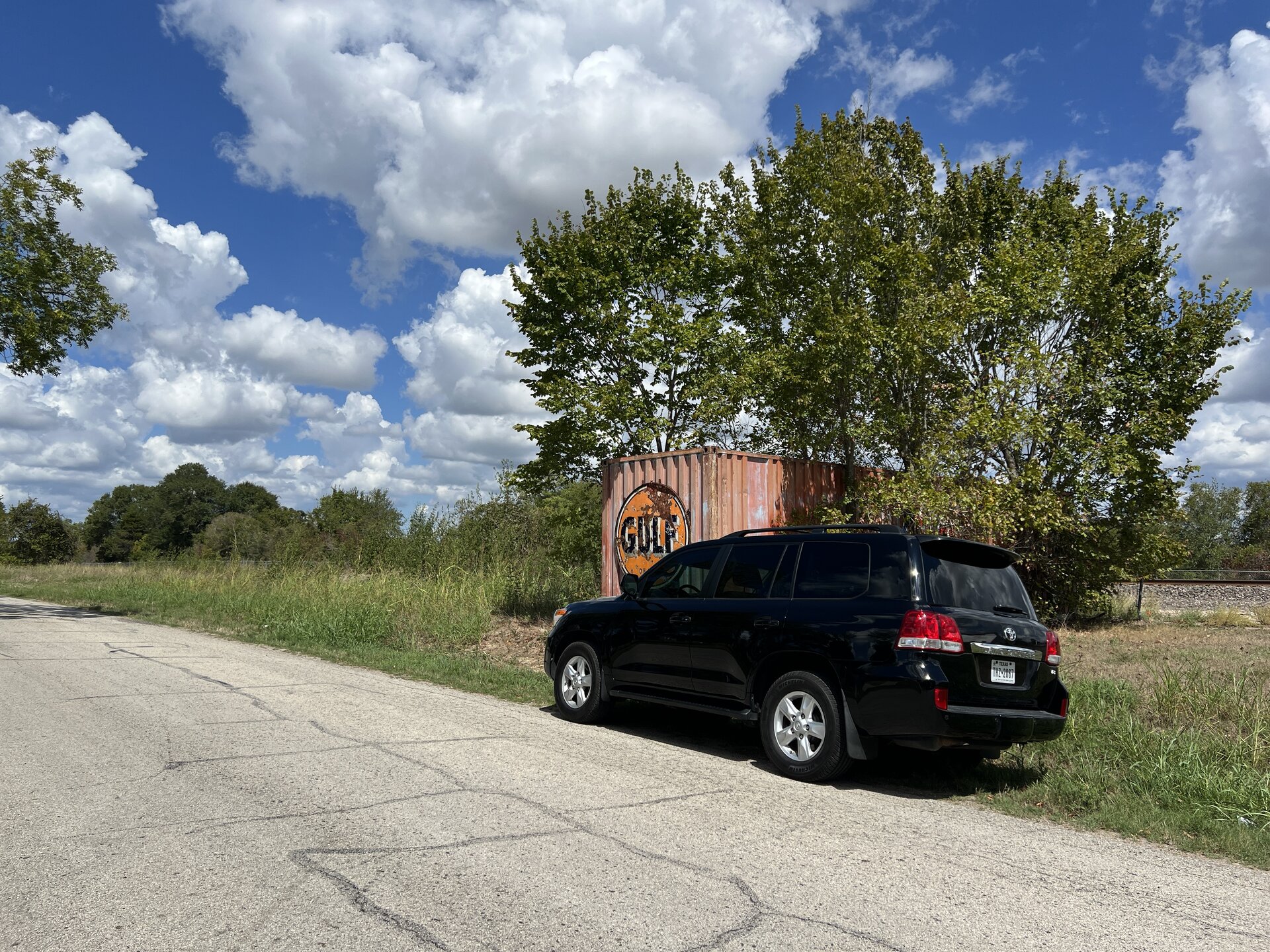

We paid low $20k’s for a high mileage 2011 and it’s a great truck. Staying stock so I can have a nice car for the wife and I can also tow. The 3UR is a monster.
