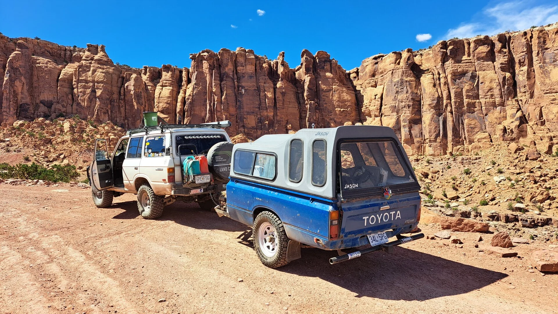

We've taken a ~2k lb mini truck bed camper trailer I made on 3k miles round trips the last 2 years in my 62 (V8) and I honestly don't notice it back there.

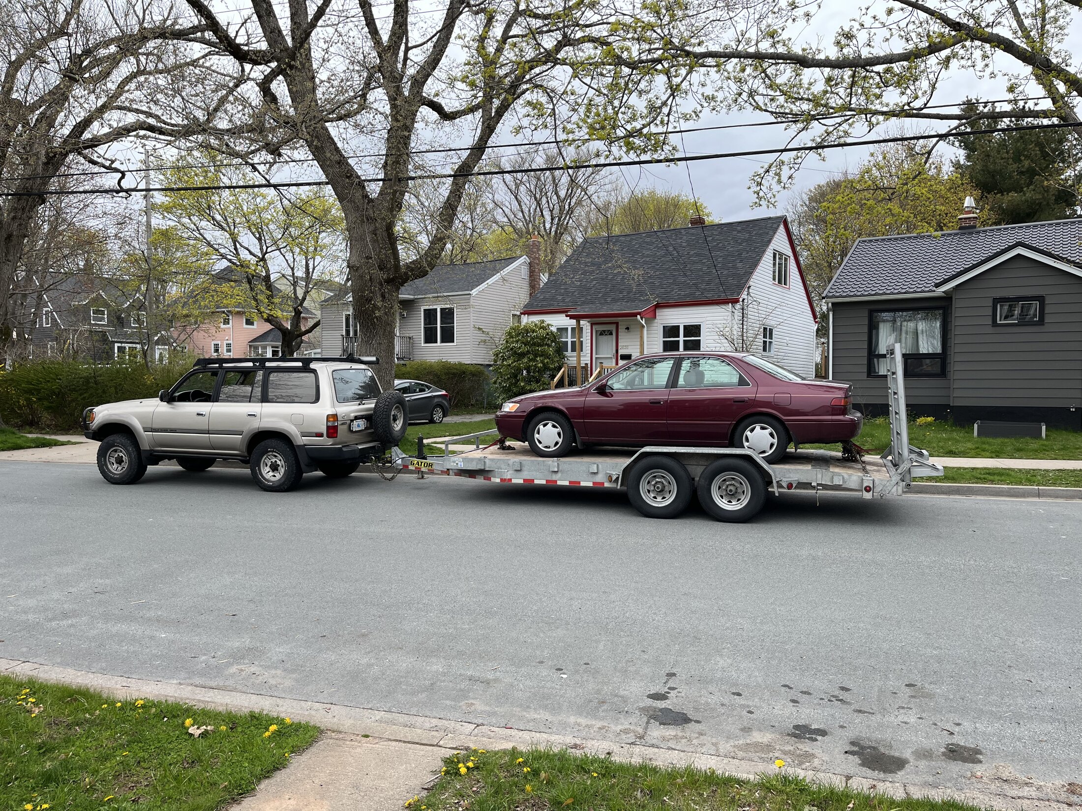

I haven’t towed with a 60 series wheelbase, but if the conversation is about powertrain I think it depends on your expectations - I’ve had two H150F-swapped 3FE powered FJ80s and I’ve towed all sorts of stuff with them. Most recently I towed a ‘97 Camry on a 2800lb float trailer (approx 6k lbs combined) on a hilly two lane highway. Was it fun? Not really. Did it do it? Yeah. I had to use the gears but I never dipped below 80kph. Locally it towed fine, and I’d do it again.

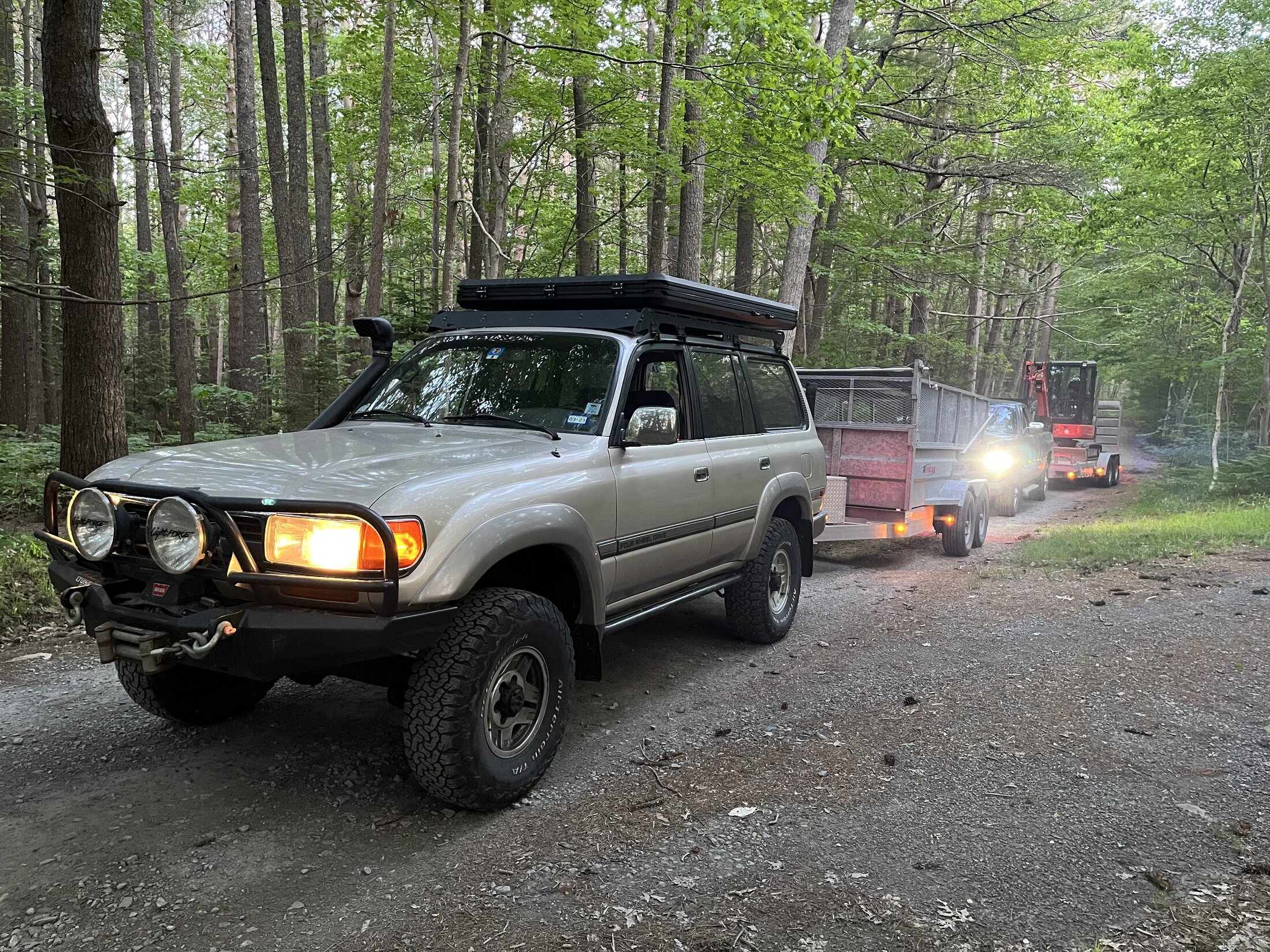

Also towed a 3k lb empty dump trailer, and then that same trailer with about a ton of boulders in it. Local roads, but towed fine. Anything 3k and under I don’t really bat an eye at, but again, my expectations are realistic. My 80 is also heavy, lots of drag and on 33” tires.
