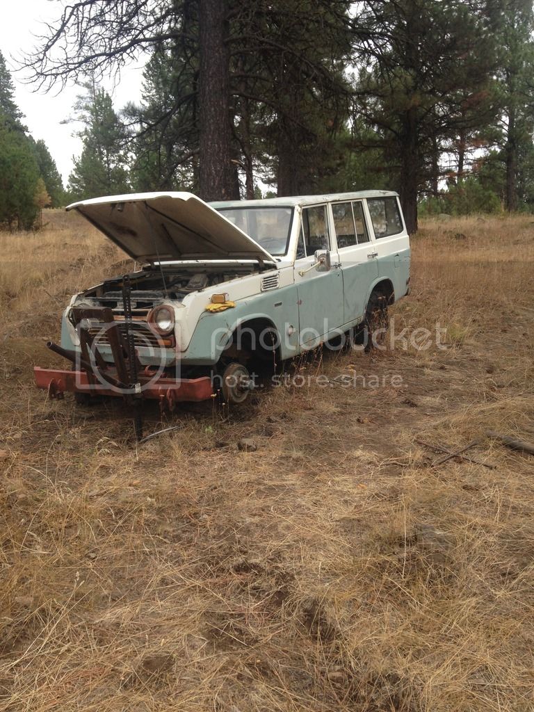

Morning guys, A couple of months ago I acquired a 1968 FJ55 from my nephew in a trade. The wife and I have loved the iron pigs from afar and getting this one way a dream It all started with my nephew telling me he found a landcruiser up on someones property. He expressed an interest in it, and the guy said he was going to give it to someone who never picked it up. The FJ was on the property when the land owner bought the property and he used it to plow snow. My nephew asked to have it and the guy finally said yes.

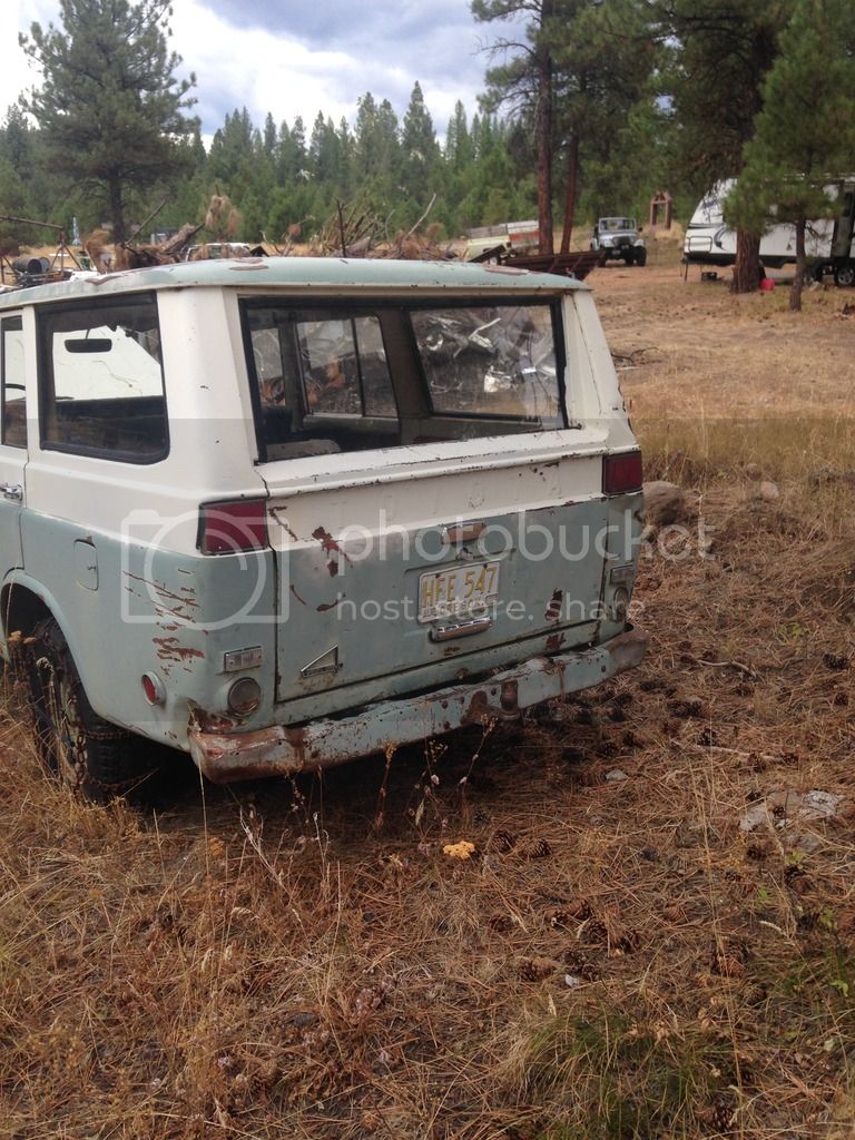

September of 2017 I went with him to retrieve it. Both front tire were flat and it had to be dragged onto the trailer. Getting it off proved to be a problem as well. we drove the trailer next to a tree, chained the back bumper to the tree and pulled away.

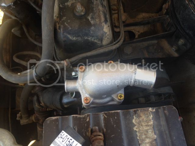

So far I've ordered the headlight trim ring from CruiserCorps and a new Thermostat housing from Specter, The housing was I guess cracked and replaced by a make shift cover without thermostat. I think it was only being used in the winter.
And it begins, I purchased a set of BF Goodrich tires in 235X75R-15. I wasn't sure about the original size, but that is what was on it. So now the FJ55 is up on all fours. I pulled the carburetor and drained the fuel tank out from the fitting that connects to the fuel pump. The carb had old dried up junk in the bowl. I think I'm going to need gasket kit as the carb is leaking fuel a little. It might swell up with some fuel and heat, will see. I ground off all the remnants of the plow system that someone had welded onto the makeshift front bumper. Its not the original but until one comes along. Took the time to clean out the interior of the junk and dirt that has accumulated over the years.
So how long did it sit, the plates tabs say 2000. But he could have been using it in the drive way until it stopped running. The roof a caved in by snow, so all the supports are bent. the roof also had a hole at the front in the middle so when the snow melted it went into the cab along the roof to where the windshield joins, all of that area including the visor mount metal is rotted out. so eventually I will need to search out metal to replace the rot.

Thanks, after going to town for some 50/50 I got the system filled up. It was facing down a slight grade and had an air pocket at the back, she burped a little and settles right down.
