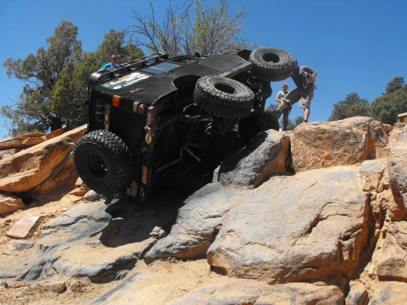

View attachment 3390775We are in different worlds. I might hit a gravel road but this picture terrifies me lol
