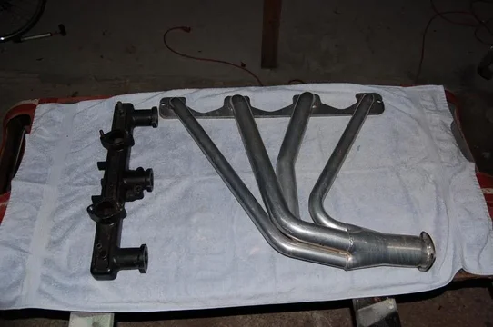

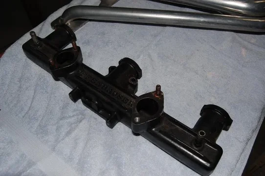

Pretty sure @ClemsonCruiser has sold off all his hot rod F motor parts but there was the dual side draft offenhauser manifold mod plus header that might get you a few ponies but def some bling points. Think he had coupled them with a few other bits n pieces.
Edit: guess I missed the date range and assume yours is newer than that.
Older info
