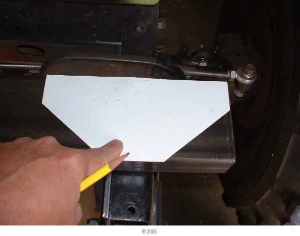

I cut and welded in the rear bumper (2x4x3/16), the ends were chamfered with the same pattern as the front bumper. I will cap the ends on this one as well.
Saddle mounts were made out of 2x3x1/8 square tubing to hold the Rubicon Express balls. These ball mounts are 3" in diameter, so I broke out the trusty hole saw and angle grinder. Tomorrow everything gets welded and will have pics of the new stance.
