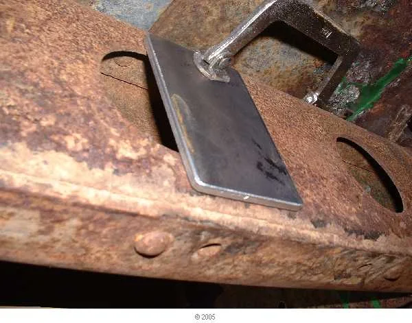

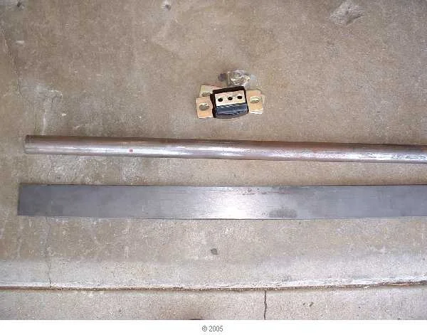

Today, I made my trans mount and welded in the motor mounts. The trans mounts I made out of 1 1/2" tubing, 3/16" plate and a new isolator from Energy Suspension. The pics tell the story better than I can, so here you go......
