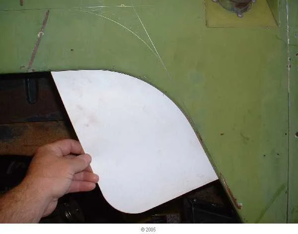

Today I cut the rear fender wells to make room for the longer wheel base. I tried to keep the factory radius on the cut outs, I didn't want it to look like a hack-job. I made templates from the original openings and traced them on the sides of the body. After tracing the front of the opening, I flipped the template over and traced a mirror image of the front onto the rear. Having laid them out on the body I was able to see how it would look before cutting. I retained all 4 body mount under the rear sill, using the outside mounts as reference points for the cuts. I had removed a back up light the PO had installed and that left a 4 1/2" diameter hole in the quarter panel. The metal I cut off I was able to use as filler. Anyway here are some pictures from today.
