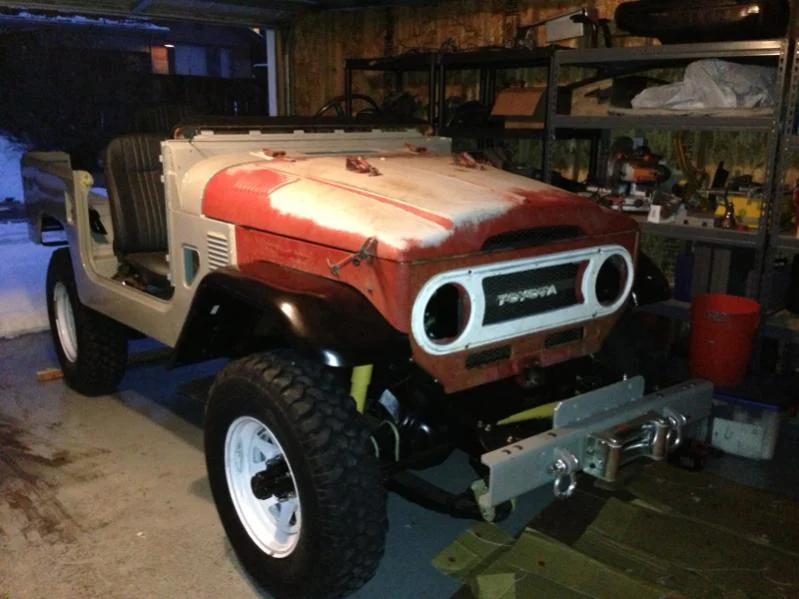

Your rig is looking great! i assume the bezel is jut on upside down for contrast, right? You'll swap it around as a finishing touch?:grinpimp:
Broth how hard is lining up the panels? I'm nowhere near there. Is there tips or tricks you've picked up so far?
It's a royal PITA! I still don't have them lined up right. I should have had them fitted, blasted and painted by now. I took a break from it.
I got the rear brake line and clutch line attached as well as the clutch master cylinder. No pics. Took a break and took the wife and new pup up the Argentine pass trail to the Waldorf mine and the Santiago ghost town. I needed some motivation. The front fender panels are driving me mad!
Attached a few decals. I bled the brakes and clutch lines! So close to taking this thing for a spin around the block! I have given up on the CCOT fenders. I bit the bullet and bought a new OEM passenger fender from Toyota for a 1979-1983 FJ40 the drivers side is discontinued. Should fit? Then I will be on the search for a unobtanium drivers side fender or maybe repair my original fender on that side. Perhaps the drivers CCOT will be be a doable process after I have one side all squared up. We will see.
