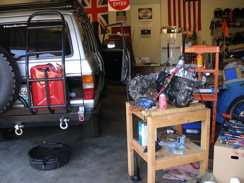

Now that I put a couple thousand miles on the new engine/tranny, the transfer case gasket started leaking. I checked the thru bolts and sure enough they were loose. There are 7 bolts and you can only access 3 or 4 from outside. So, gotta pull the tranny and reseal it. then I can tighten the offending bolts

View attachment 333000View attachment 333001View attachment 333002
