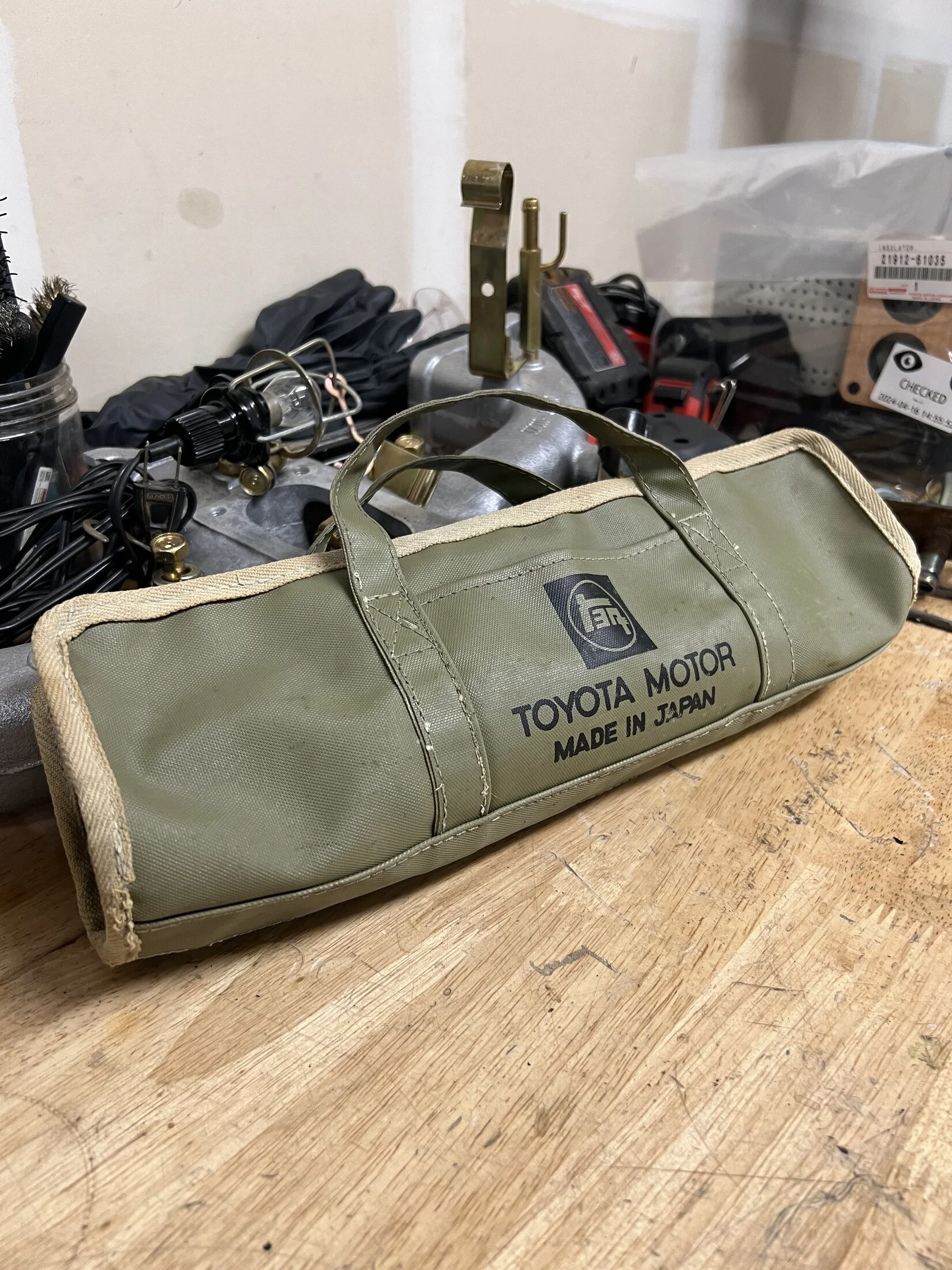

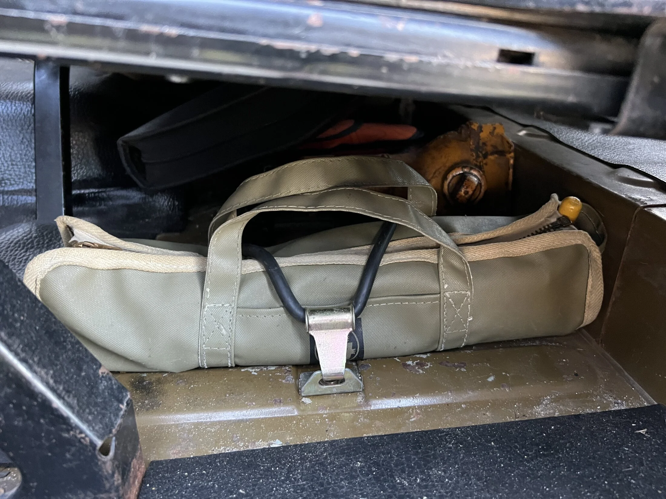

Yet another stint overseas, but this time I came back to toys 😎. The new oem tool roll is great but I had it stuffed so I finally find an oem zip bag, it all fits much better.

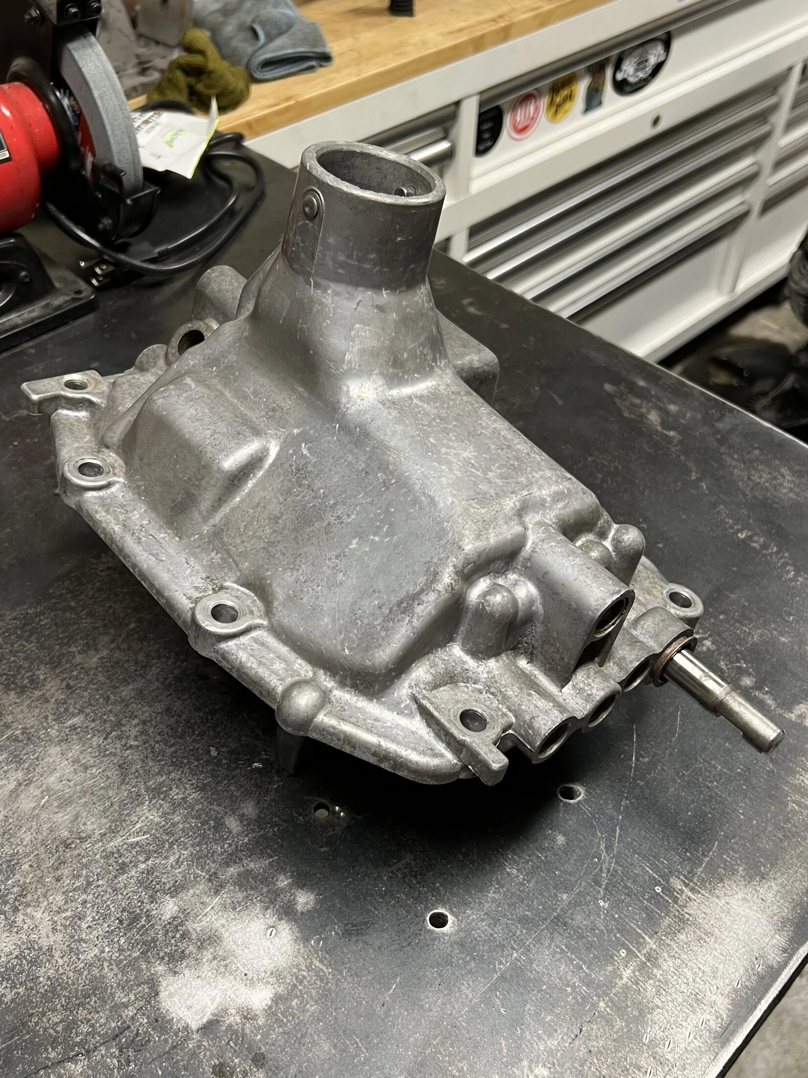

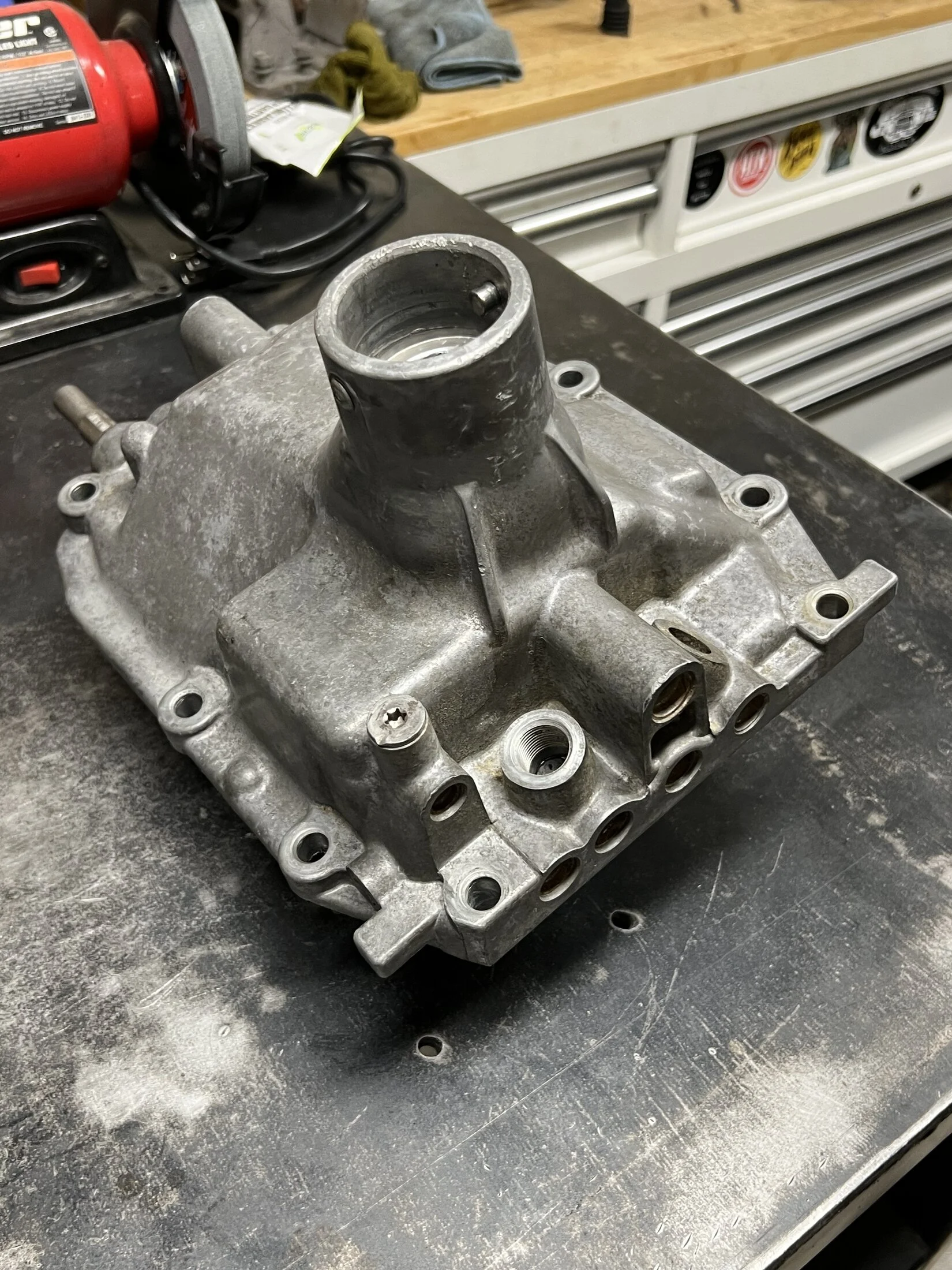

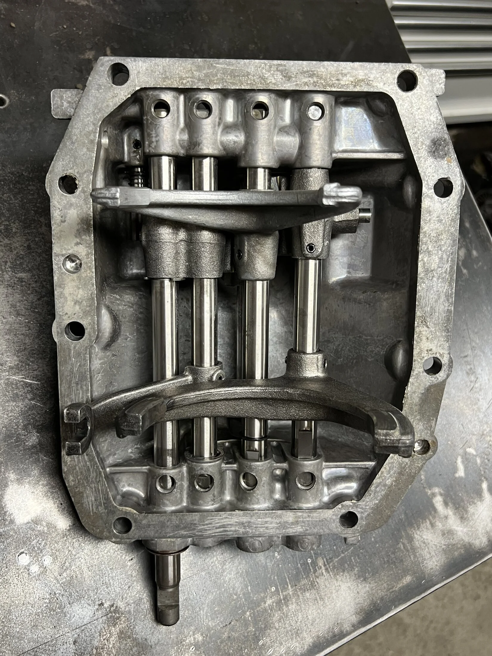

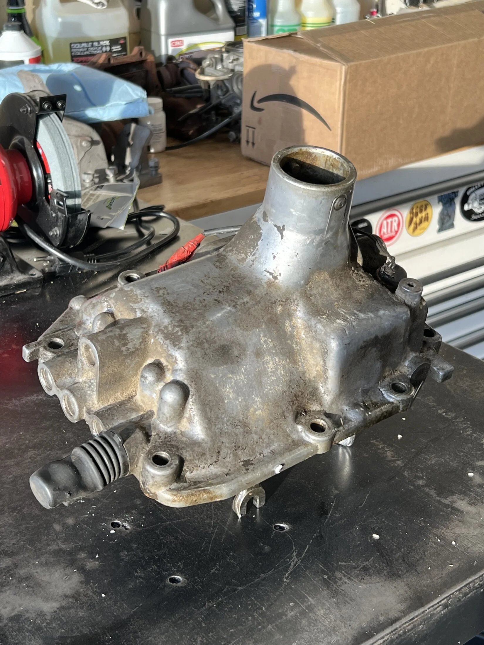

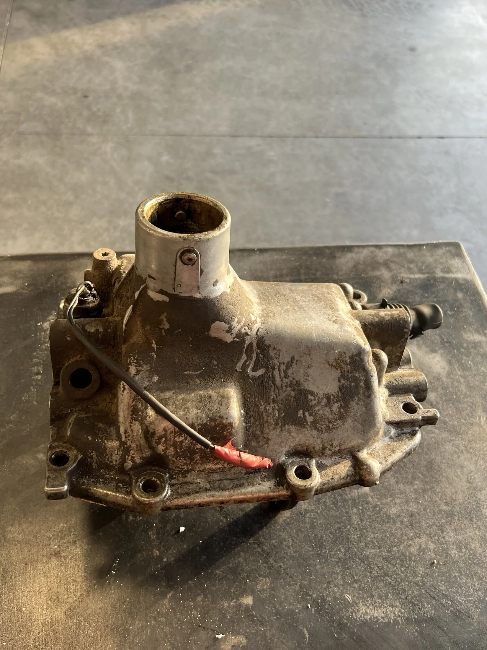

Then the 40 series h55 lid arrived. Idk what else to hunt for now….maybe a 80-84 full float rear axle to pair it. Once my replacement switches arrive for the ultrasonic I can dip it and clean it up.
Wow, I can’t believe you found one!
That is awesome!!!

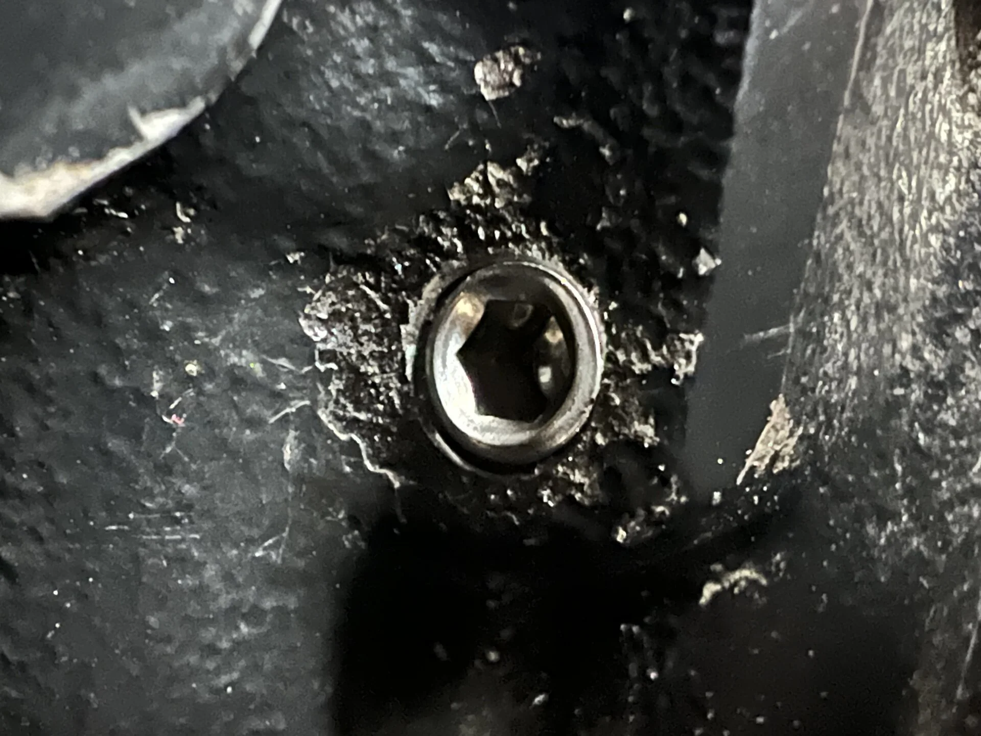

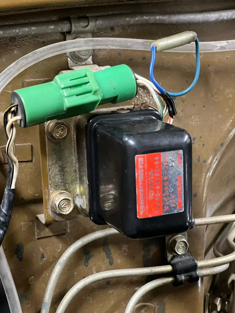

Had a little downtime and @The Machinist let me park in the garage while it snowed to do the galley plug and finally found a -60100-84 VR and bolted it on, along with some prettier zinc hardware.

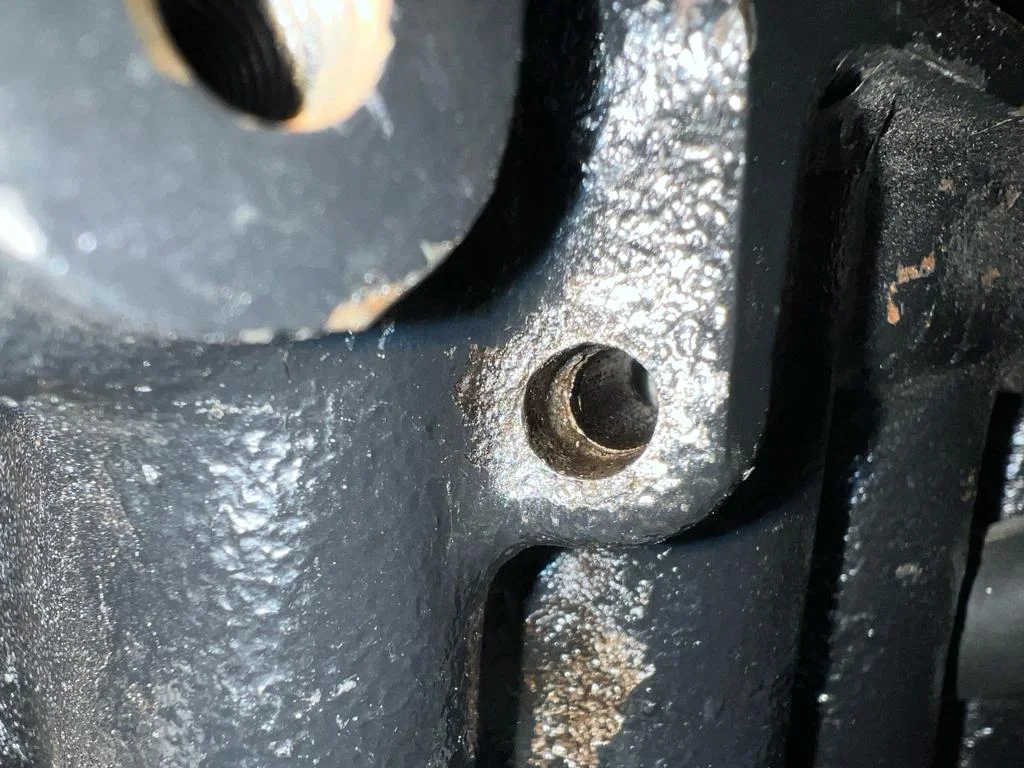

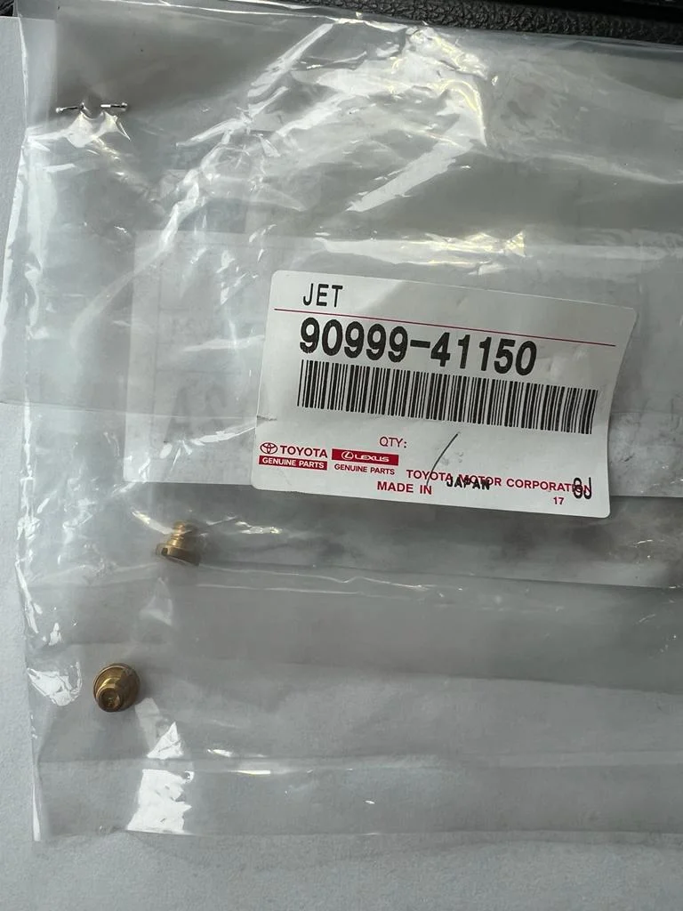

Galley plug was quick and easy, it had been weeping for 6 months very minimally so of course I chose to wait until winter.....I might get a 12mm set screw instead of the 10mm as I prefer the flush fit. @Ackcruisers made a good point that the 150 jets are disappearing so I snagged the last two in USA stock....maybe that is all that is left? Amayama says NLA, we'll see. I used one a few years ago but never remember much difference, so I'd like to try 150/220 again....plugs are a little more gray than tan/gray so we'll see.
Did you convert from a SS VR back to point-type?
Dropped into ultrasonic - much cleaner now. To the shelf it sits until I wrap up the Ram and decide/locate the rear axle.

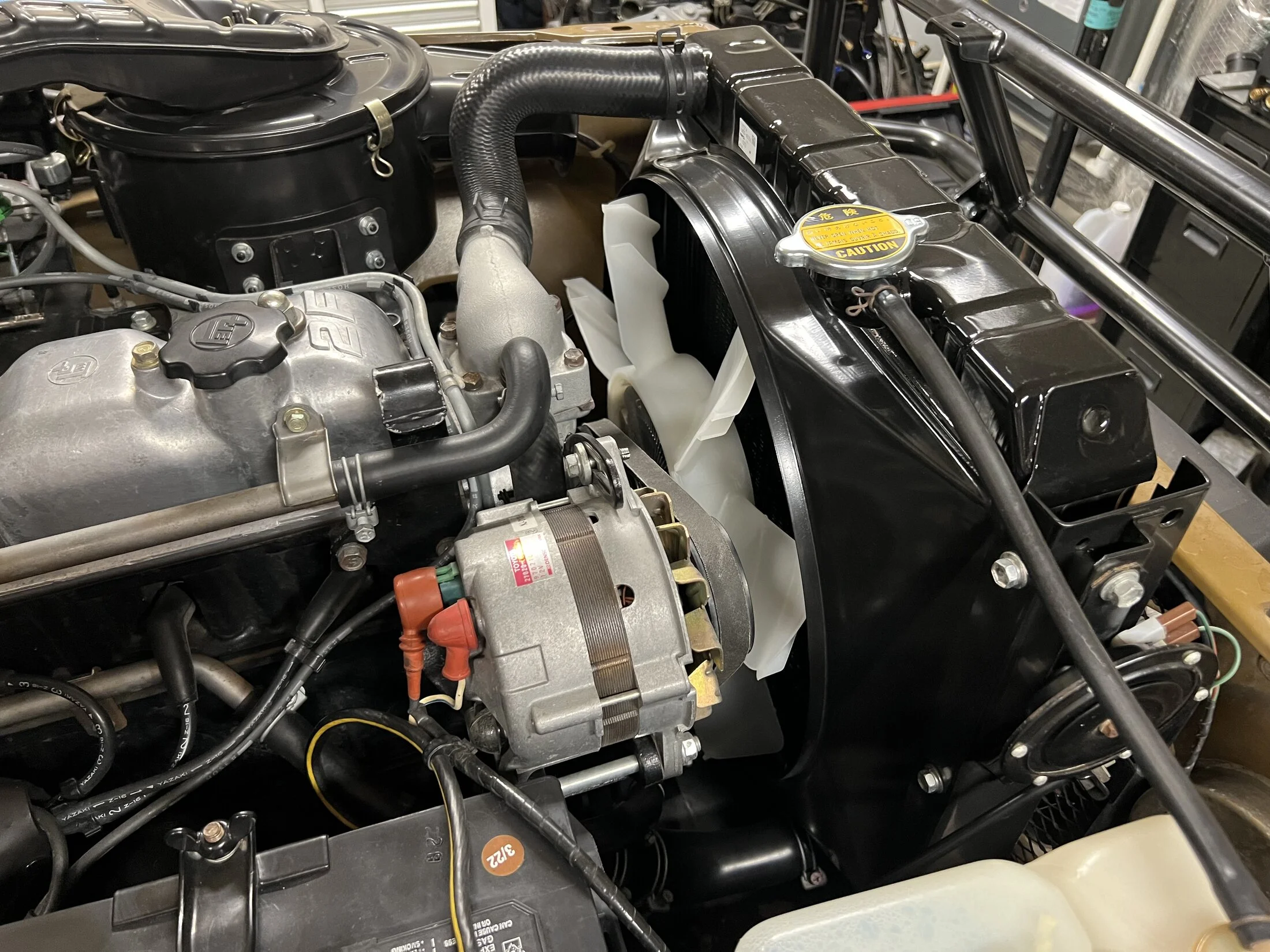

Been doing some maintenance lately….two were sort of annoying…
1. Radiator replacement, my genuine oem sprang a leak at the seam so I had to warranty it through Toyota. Got it all installed and done. Pretty boring stuff, just a bit of cleaning.

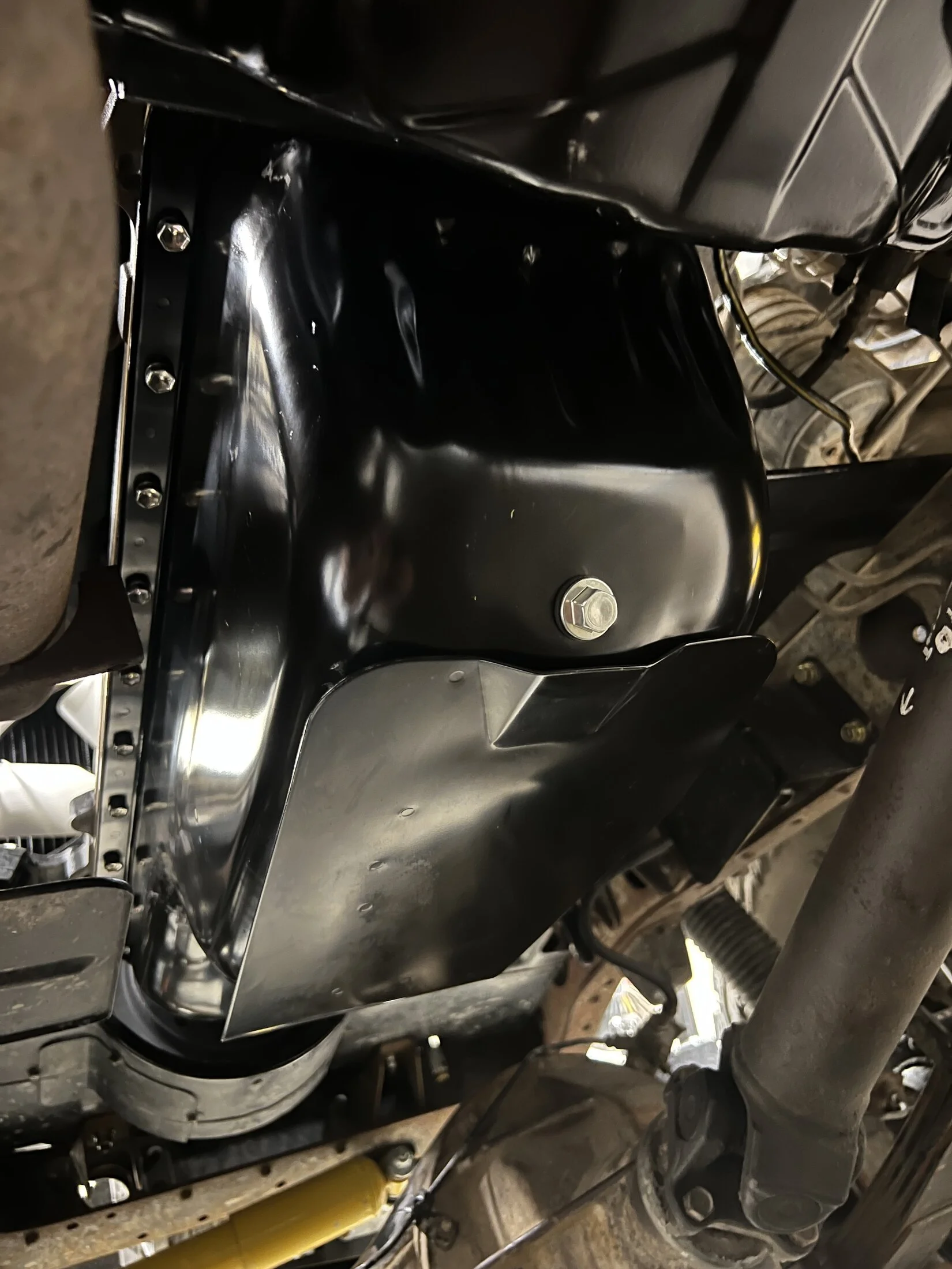

2. Oil pan replacement. Should’ve done this when I had the motor out but I was cutting costs. The skid plate would drip a few drops every few nights and would leave a mist under the chassis so it was time to swap to a new one. Mellow afternoon swap, love how easy they set in place.

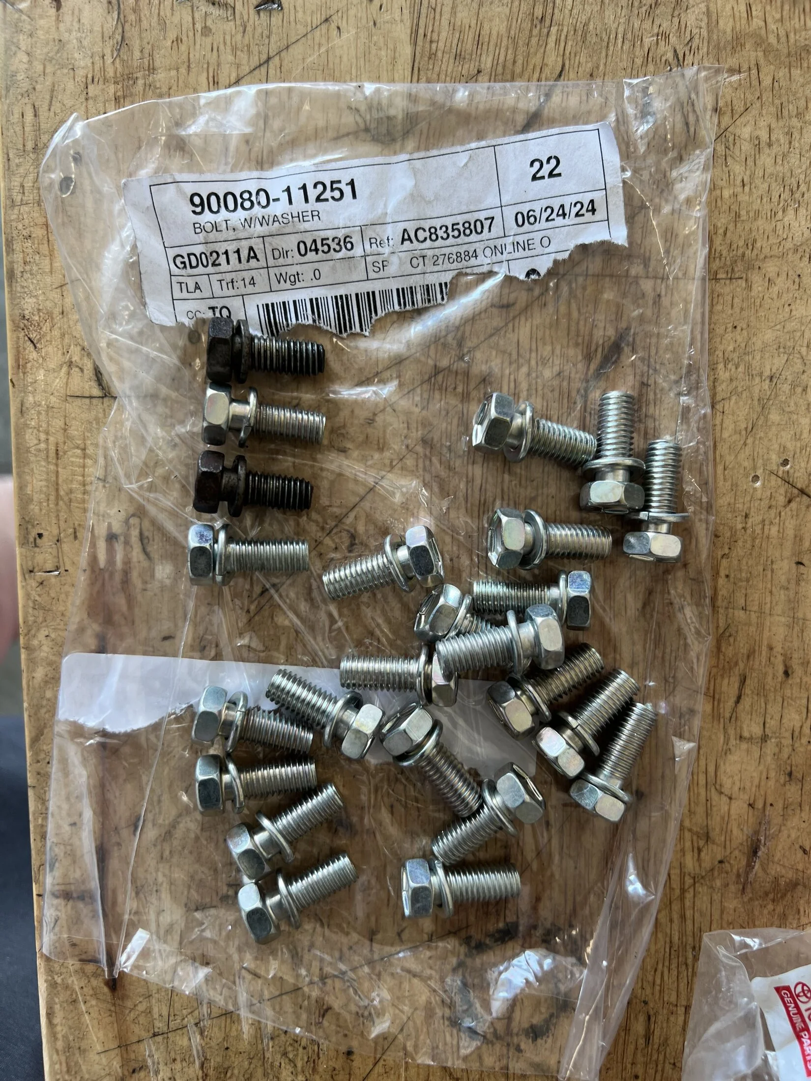

Been covered a few times but a comparison of factory bolts to the best available option. Courtesy @OGBeno and cruiserdans findings.

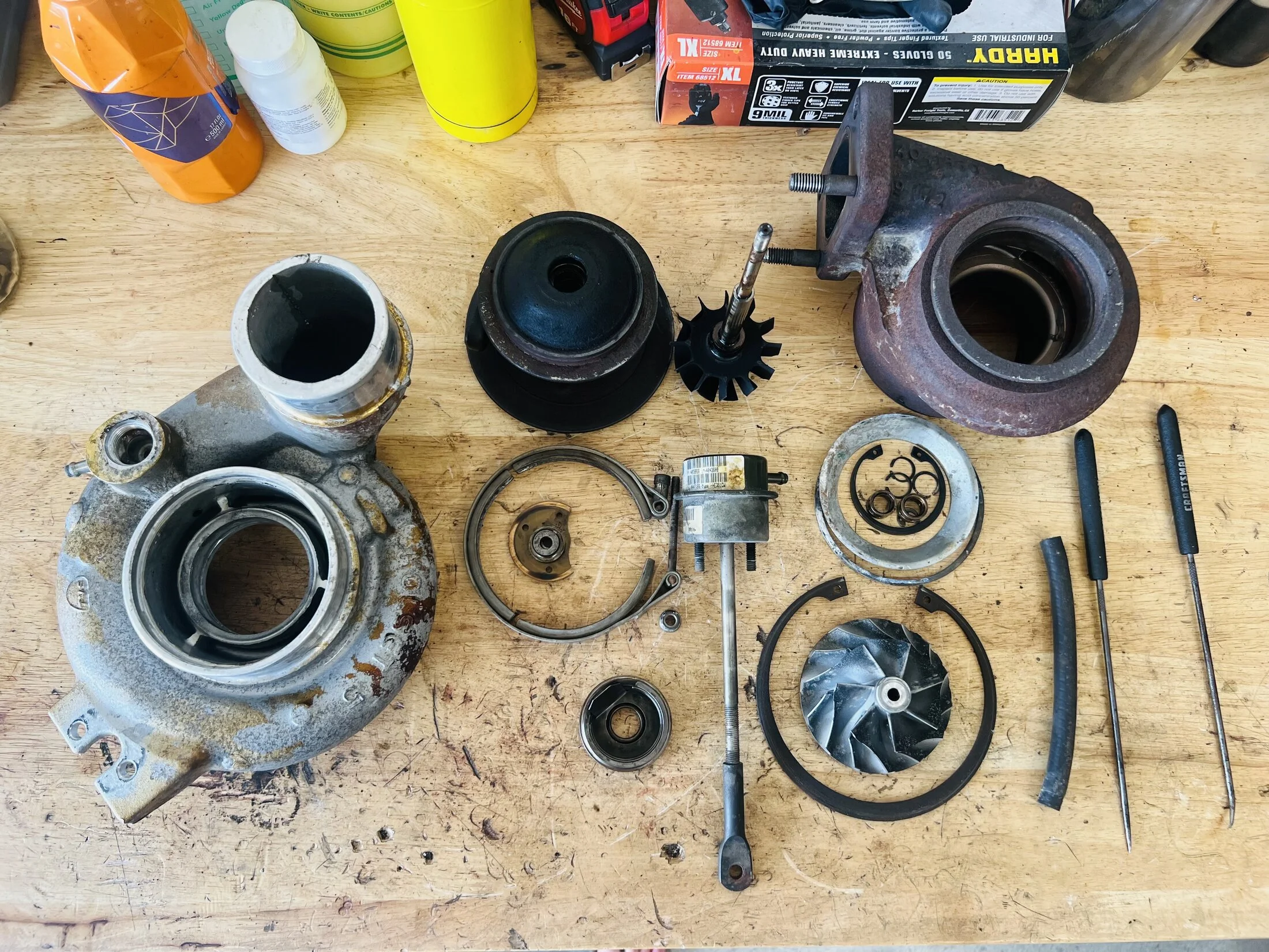

3. Rebuilding the HE351 for my impending 12v swap. Cummins makes parts buying as easy as Toyota and I love it. Now I wait for parts and vapor blast / cerakote.

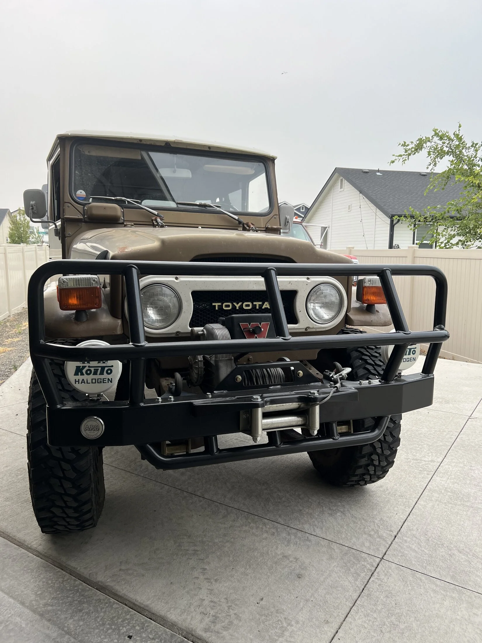

4. Oh and I slapped on the Arb a few weeks back and wired in the Koitos. I love these fogs - so bright and super nice cut off. Couldn’t recommend them more! Paired with new Yazaki bullet connectors and we’re stylin.
