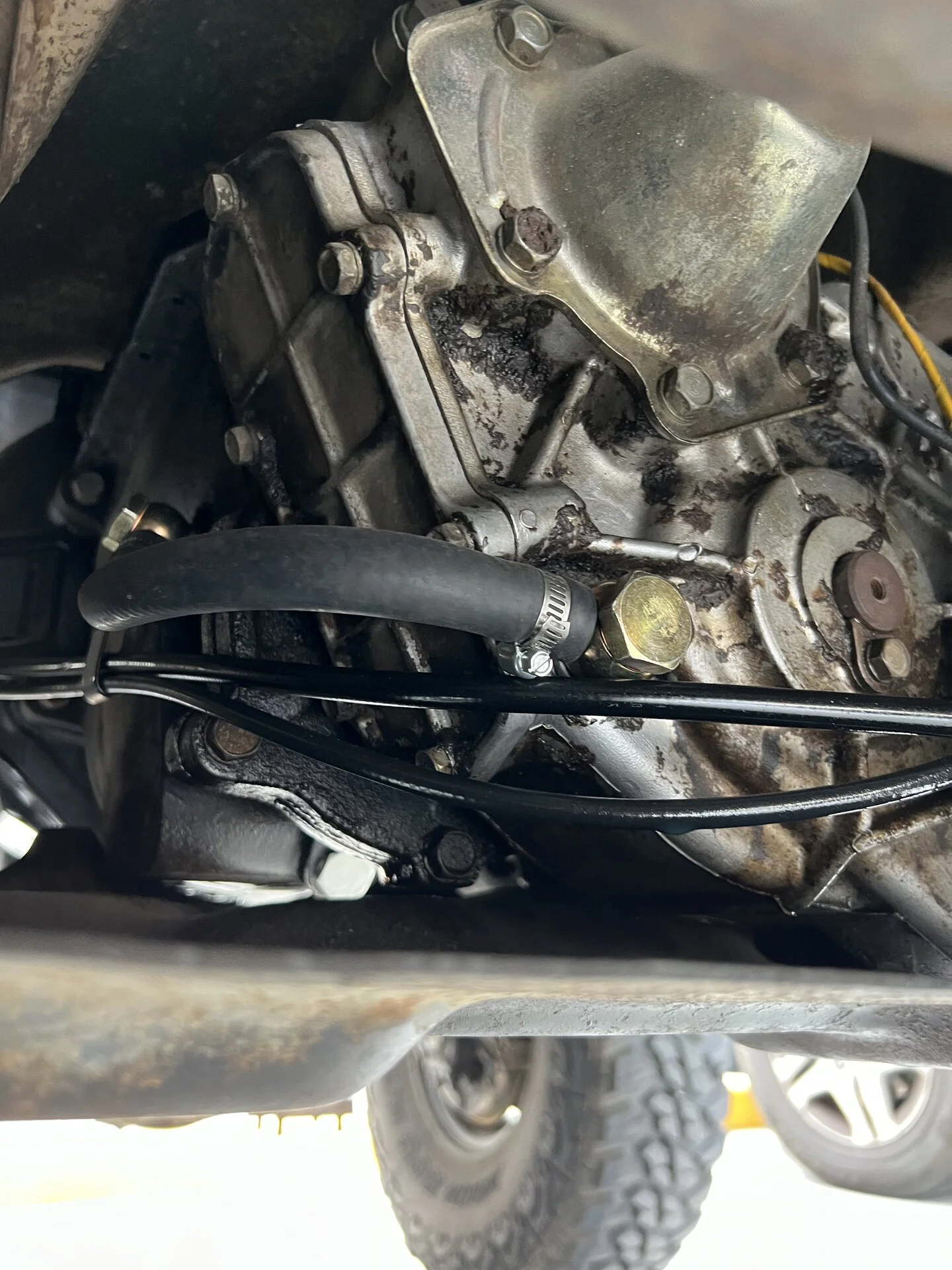

Forgot I never posted this a while back, realized tcase leaks into trans so I whipped up a bypass. $20 banjo fittings and a spare piece of hose and it’s done. I’d like to get some oem spring clamps at some point but it’s fine for now.

How would I know if the tcase is leaking into the trans?
I believe that one way is to remove the fill plugs. If gear oil gushes out, and the other is low, a transfer is likely occurring. They should both be full when there is only a slight dribble from each fill plug.
Pull the trans fill plug - if fluid leaks out the seal failed. Then check tcase fill plug for fluid level, should be low if trans is overfilled.

open the fill port on the side of the transmission - if oil comes pouring out - the transfer case is pumping

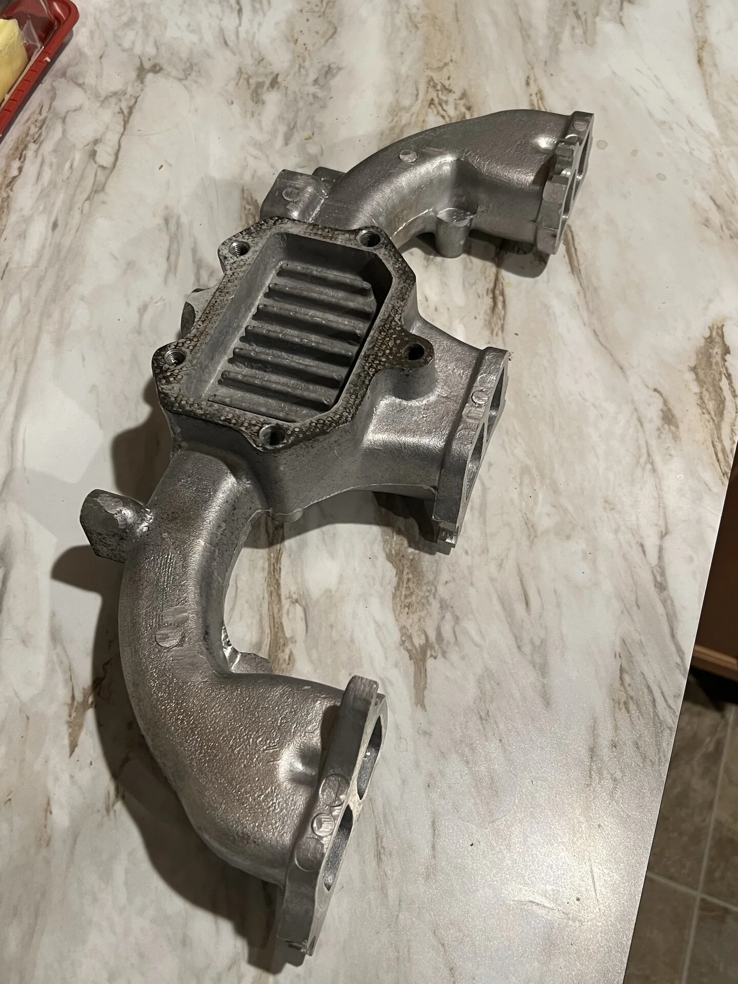

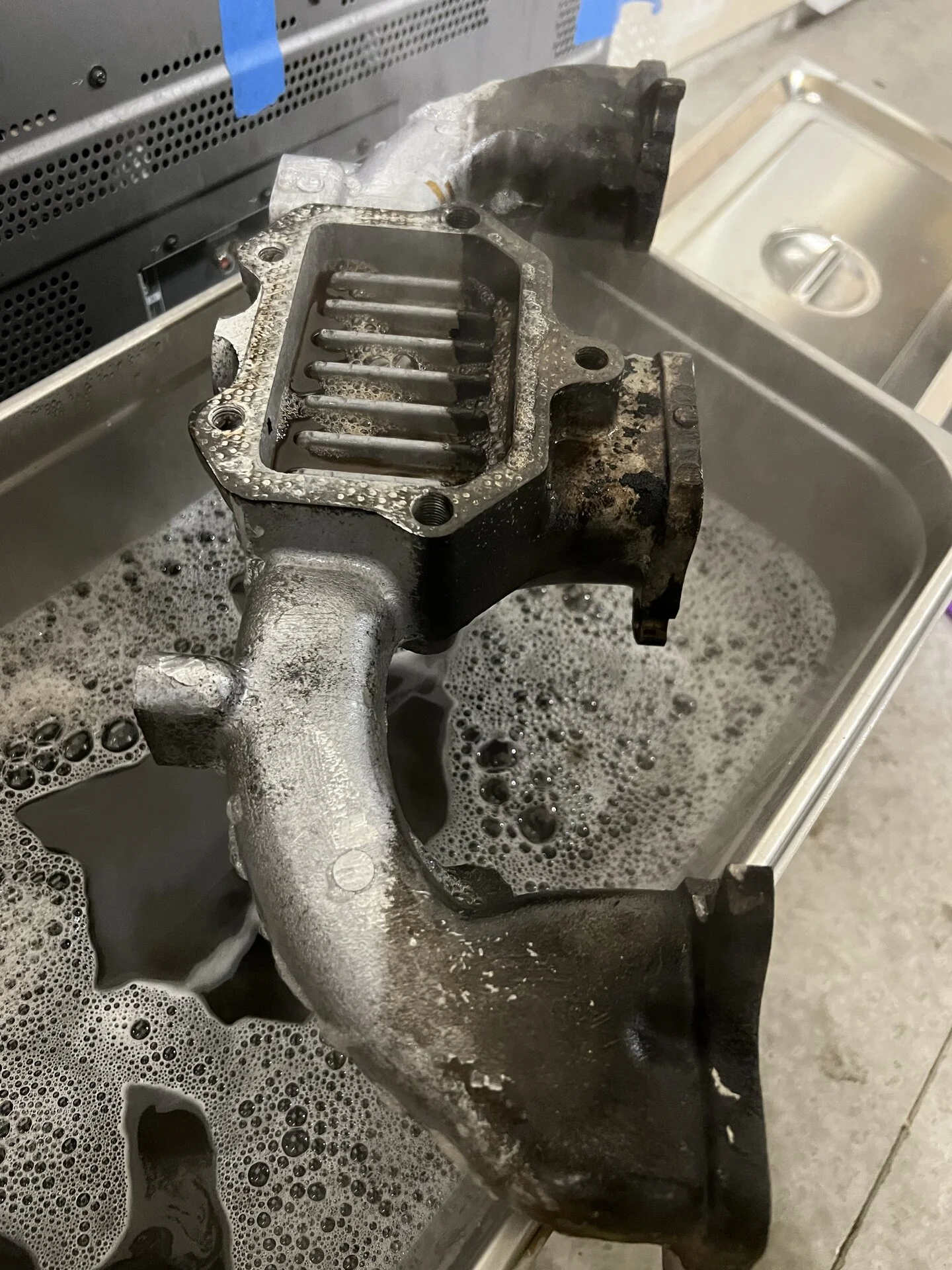

Fun with ultrasonic tonight on my…soon to be replacement manifold assembly.
So I googled “very large ultrasonic cleaner“ (which I’m assuming is needed to clean a manifold) and I think I paid less for my ‘65 cruiser than for one of those, except for the Amazon Chinese knockoff ones. Wow.
Chinese is all you need for a hobbyist.

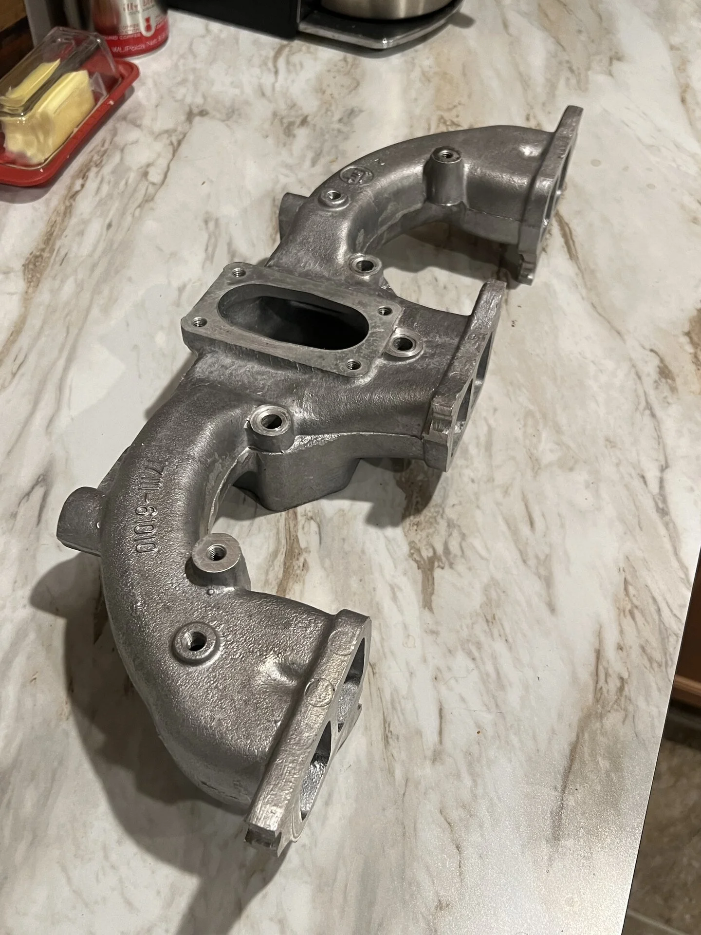

All done now. I love how the interior gets completely clean as well.
Mattressking, what's your favorite brew for ultrasonic on aluminum? I have a similar size unit, and I haven't found any cleaners that will leave aluminum that shiny, most will dull the finish.

I had access to a small one for carbs, I was never impressed.

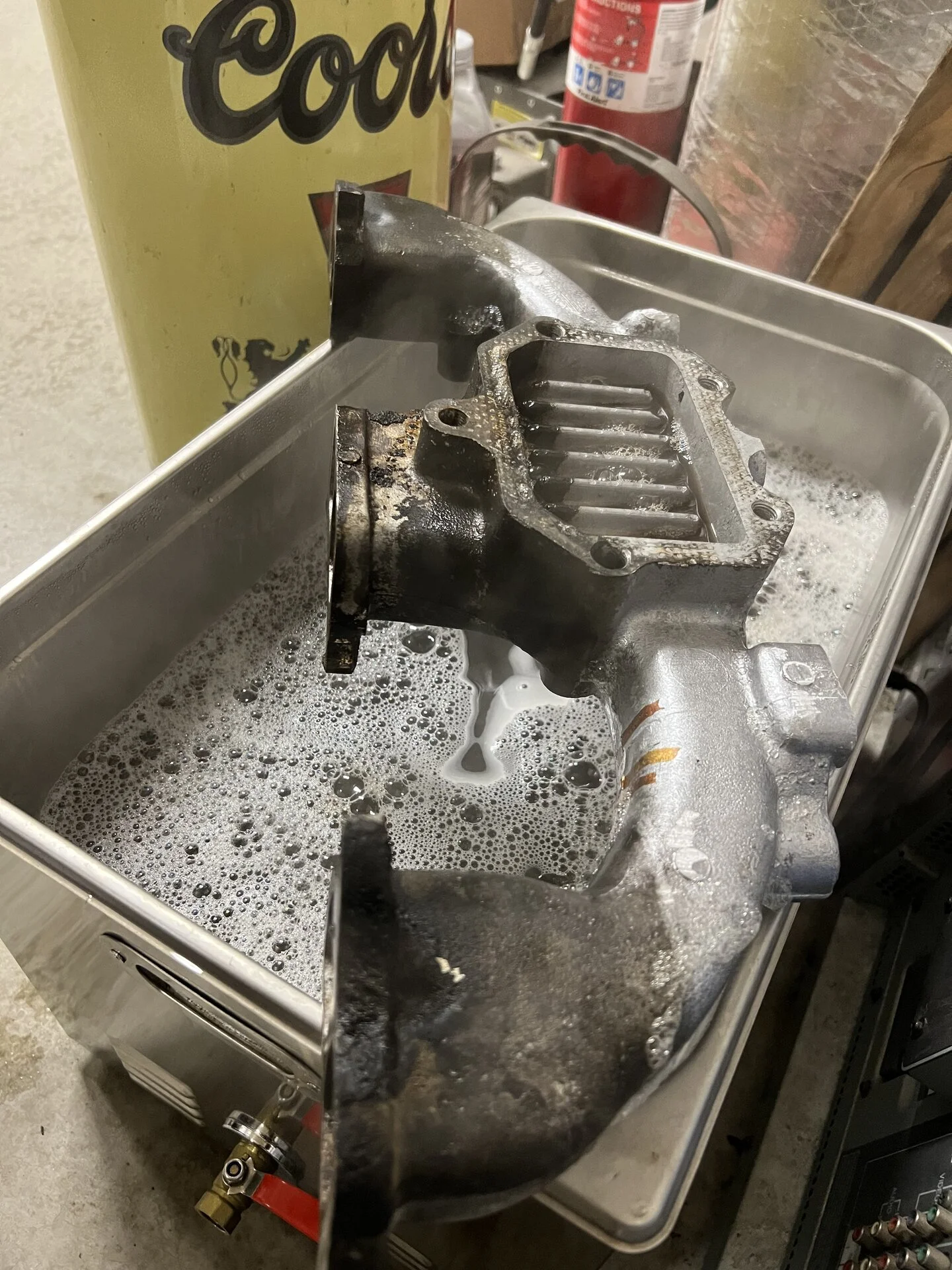

That one wow. How long was it in the ultrasonic?
I think overall 1.5hrs. I had to flip two times to get the entire manifold immersed so it took longer for that.
Distilled water and simple green pro HD right now....I also need to test aluminum brightener for trucks and the professional chemdip as well, just haven't got to them, simple green does pretty well and is easy cleanup.
Just a heads up, be careful with any simple green on aluminum with the exception of the aircraft grade stuff. It can corrode aluminum if not completely washed off or left on too long.
Learned this when I was restoring vintage aluminum travel trailers.
Correct - don't use simple 'green'. You have to use Simple Green Pro HD which is blue and safe for aluminum - I and the bottle don't recommend 50/50 mix; 60/40 or 70/30 is best.

If I'm lucky I will swap the manifold over this weekend and put on the new zinc parts....we'll see how froggy I'm feeling.
